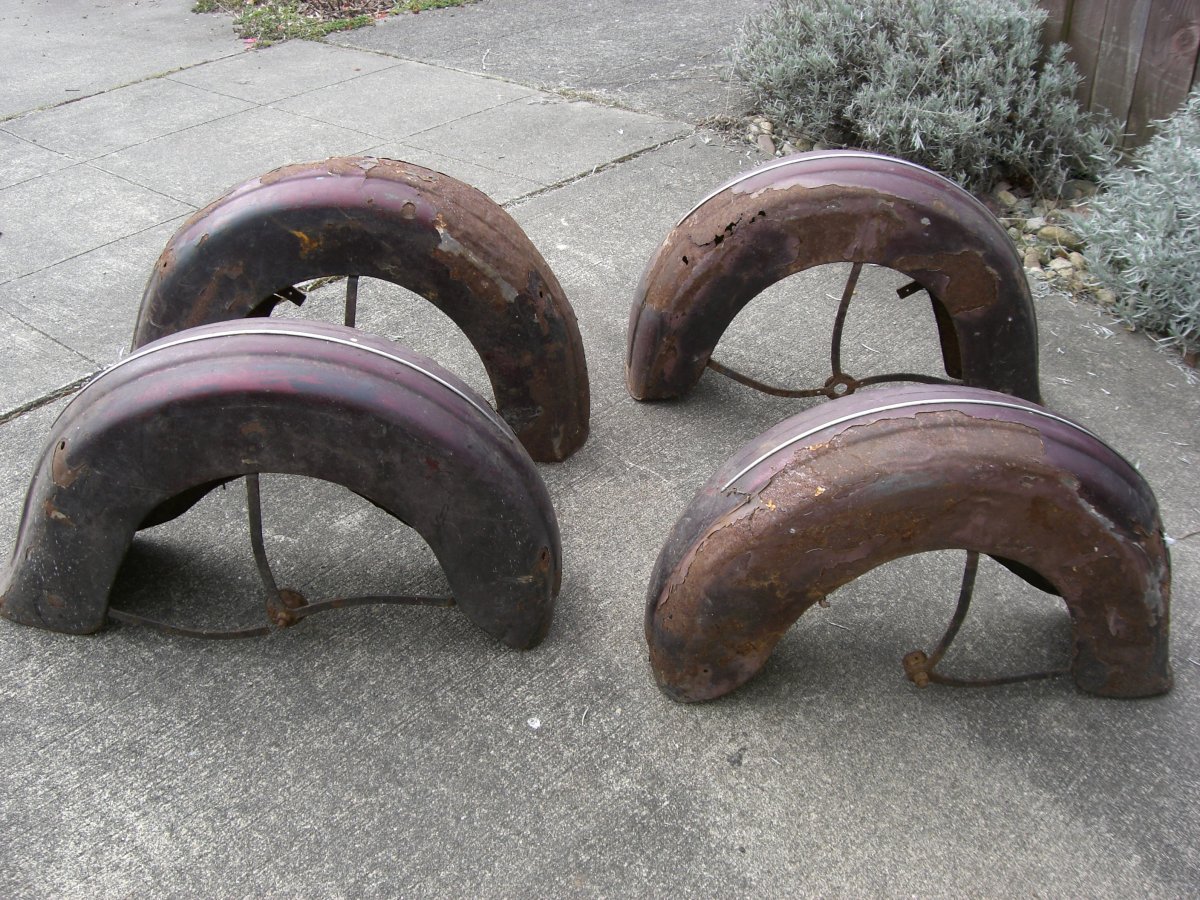

  19. ClarkH
    Joined: Jul 21, 2010
    Posts: 1,573
    ClarkH
    Wow, this is cool stuff. @Squablow, I've seen Tuckers in person, but have never even heard of the Carioca. Very cool concept, even if it is "far out" of my period. :D Stogy, thanks the mockup with the different rears--and the Trimotor!
    It's been a long time, so I dug out the fenders for another look. It's kind of interesting. They are clearly factory and unaltered. There are two pairs, and their profiles are similar on the outside, but different on the inside. The raised ribs are much wider than you'd expect, when viewed head-on. The bad news is that two have serious damage, and each of the bad ones is from a different pair. :(
    Here's one of each; note back.
    Here's a view of the raised ribs--again, this shows one from each pair.
    They sure look like they're from the same manufacturer. So either trike/servicar rears from similar years/models, or maybe some kind of wild four-wheeler? The speedster was built in the Ballard neighborhood of Seattle by an employee of Hill Machine. For decades there were two wrecking yards nearby, just north of the Ship C****. (One finally closed just a couple years ago--my brother, whose shop is nearby, bought their wrecker.) I'm sure the old Mercury body came out of one of those wrecking yards, and probably the fenders as well.
    oliver westlund, loudbang and Stogy like this.
