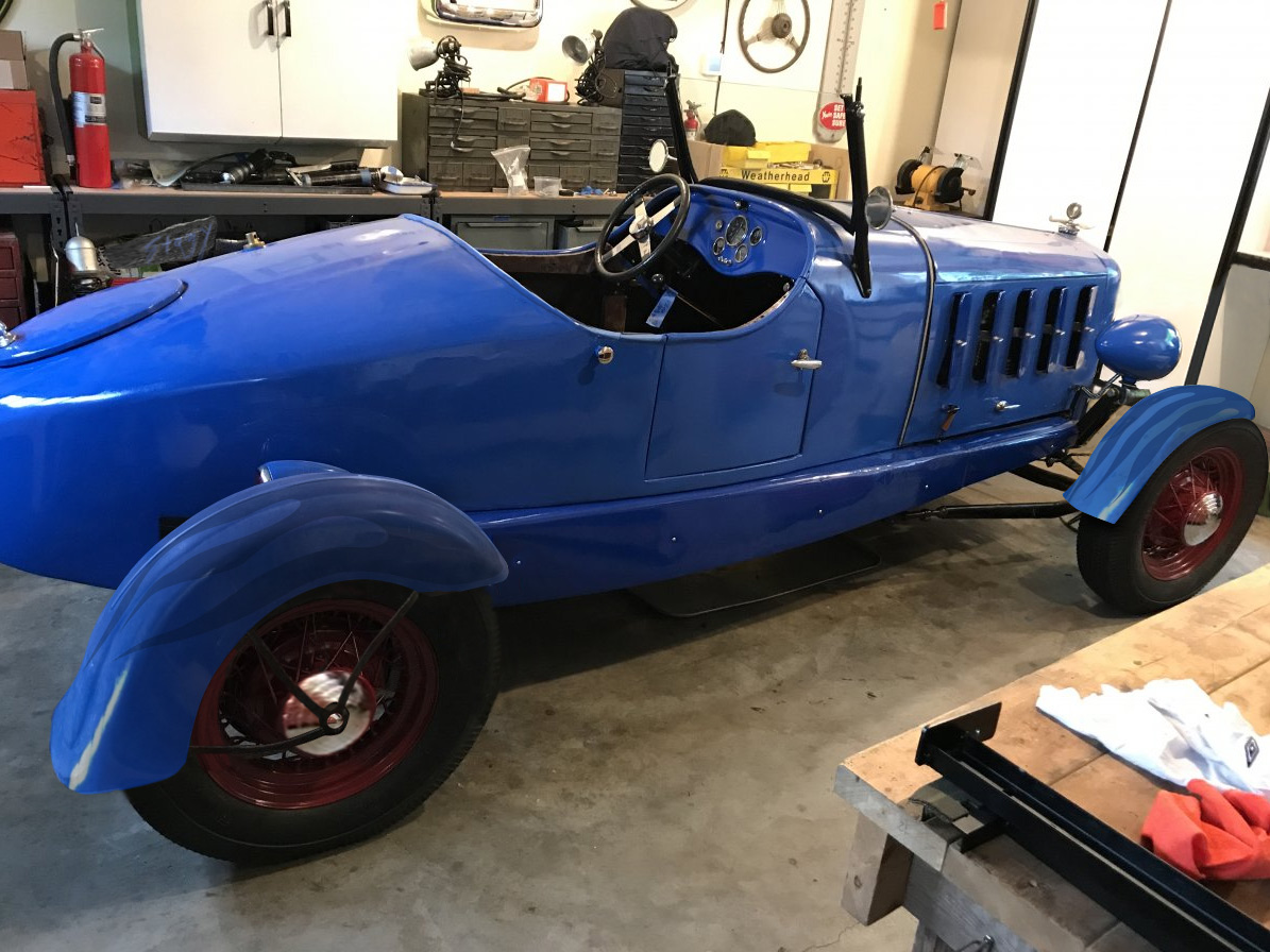

    And then there's that. :D @25mercury, I always enjoy pictures of your car. It is beautiful, and looks to be quite original. The Mercurys I've seen are split between fenderless and the thin stock-style fenders. Nothing with big wheel envelopers like these. Although there is a well-known one in Sweden running Model A Fenders.
    This is still in the long-term thinking phase. These fenders intrigue me, and clearly intrigue others, so noodling on this is time well spent. But I promise I won't fall into the "I have them so I might as well use them" trap.
    Also, just fyi, there is someone (ahem:rolleyes:) in my household who is very keen on fenders. And apparently they have to be "swoopy."
    Nope. I'm taking it with me. :p
    No question they would have to attach to the backing plates.

    It does have a nice coffin shape

    I could definitely get behind cutting the fronts off similar to how the roadster pickup on the last page looks, and eliminating a bunch of rot and issues in the process.
    Using the "original" fenders is going to mean having to take them off to change a tire which would be a pain, but the allure of their unknown history and flowing shape, and their connection with this body really speak to me. Again, easy for me to say that, when I don't have to do any of the work, but still....
    They don't get much swoopier.

    Hmmm. Fenderless...

    With the fenders on the car .. take some masking tape, & tape off various curves for cut lines. Obviously, the results are numerous.
    Bobbed, cropped, halved, trimmed .. whatever. Hell maybe the fronts don't match the back. Figure it out.
    I like the fenders too. The easy way out is no fenders. No thinking needed. It is what it is. Easy peasy sh*t, to chunk 'em in the trash.
    No challenge there.

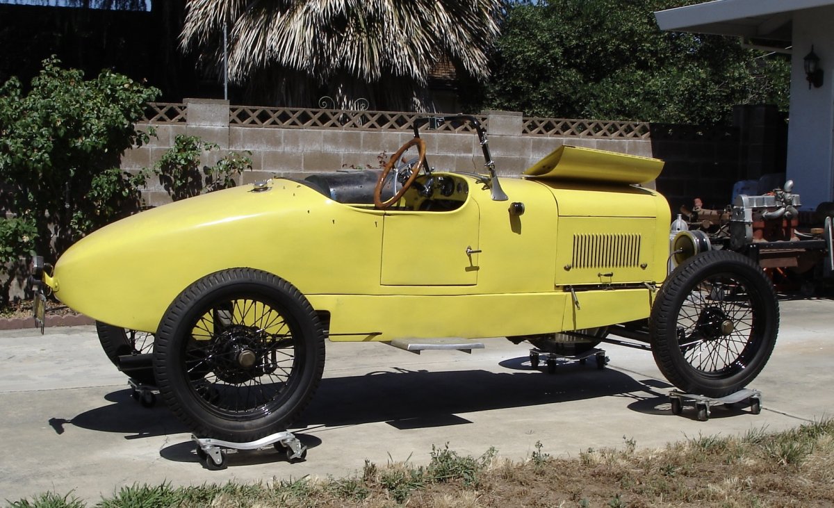

    The yellow fenders are '30s trike. Got them at the Portland Swap Meet four or five years ago. Spotted them in the first hour of setup day, in the booth down the row from me with a $200 price tag. Belonged to a nice guy named Dave whom I've gotten to know over the years. Before I could even make an offer he said, "If you'll use them on that crazy bug of yours, just give me $50."
    The have a nice little flip at the back.

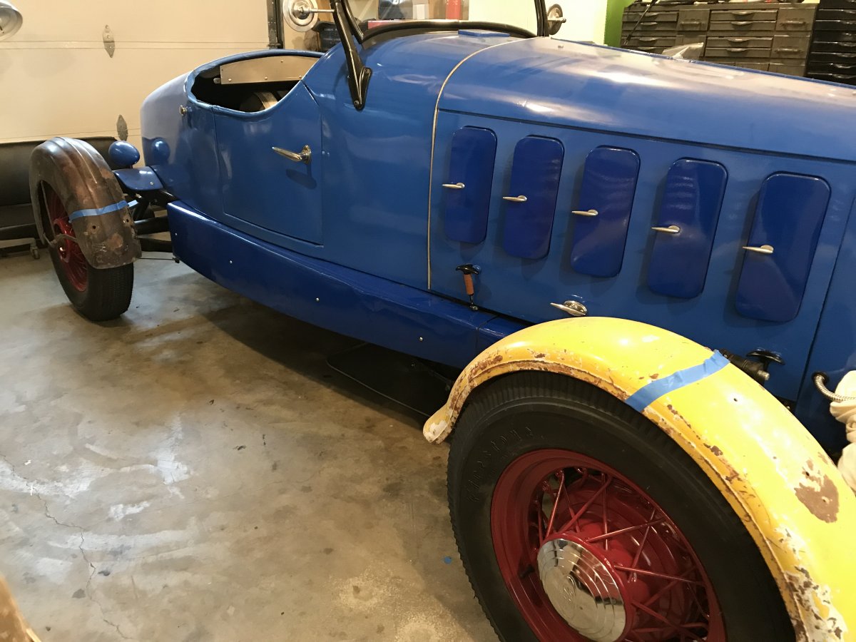

    I’ve also made some progress in resolving the mystery of the fenders. I'm not talking about the intriguing burgundy ones, sorry to say, but rather the yellow “trike” fenders (which I also think are kind of cool).
    I started my investigations by removing the remains of the heavy steel mounts that somebody had gas welded to them. The s**** bits weighed in at more than 6.5 lbs!
    This was the first time I’d ever taken a real close look at the things, and it was interesting. At some point, these fenders had support braces on both sides, and later the outside braces were cut off. You can kind of see what I mean in this pic—the brace p***es under the fender and is crudely cut off.
    Then I noticed that they are asymmetrical on the inside. By which I mean, they are not a mirror of each other. You can see what I mean in this side-by-side pic showing the insides.
    Obviously, that’s not how a trike or servicer manufacturer would have designed it. So then I looked closer and realized that not only had the braces been cut off of the outside, but the entire outer edge of each fender had been trimmed as well.
    At this point, I was intrigued enough to being some serious online sleuthing. It actually didn’t take long to get a positive ID—these are prewar Harley Davidson sidecar fenders. 1937, or thereabouts.
    I’m guessing at some point somebody had a pair of these that they wanted to use on a trike (or maybe a trailer, given the crude brackets I had to cut off). So they trimmed the outside of one and the inside of the other and called it close enough.
    The fender details were a perfect match for what I found on HD fenders for sale online.

    So there you have it. It doesn't bring the fender debate any closer to resolution. But I think it’s pretty cool.
