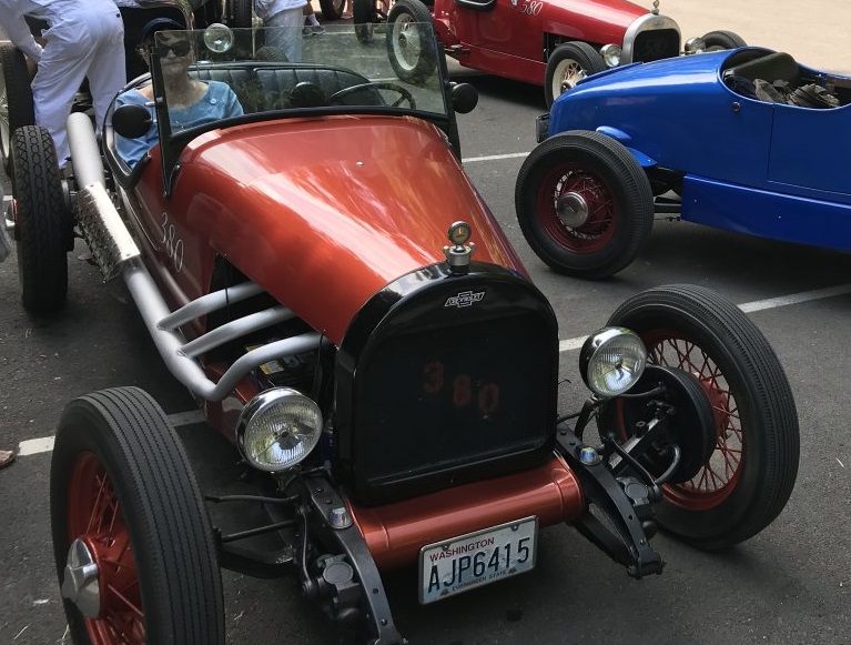

    Saturday, the car and I got our first really big test.
    180 miles running with a group of speedsters, including this 4,000 ft climb up Mt. Baker. How about that sheer drop? You better believe, I was mentally reviewing every suspension and brake attachment during that climb. I figure if she didn’t overheat there on a hot August day, she’s not going to overheat.
    Nice group of people and some really cool cars. And we ran them hard. The Mercury performed great. Had a rear main leak that cleared up after 100 miles (I figure the rope seal finally swelled) and by the end the water pump was starting to growl. But that’s minor stuff. All in all, ran like a champ! And I’m totally digging the windshield for long runs.

  21. Kume
    Joined: Jan 23, 2010
    Posts: 1,007
    Kume
    A couple of interesting looking Chevrolet speedsters there. group forward.JPG
