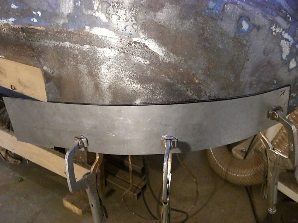

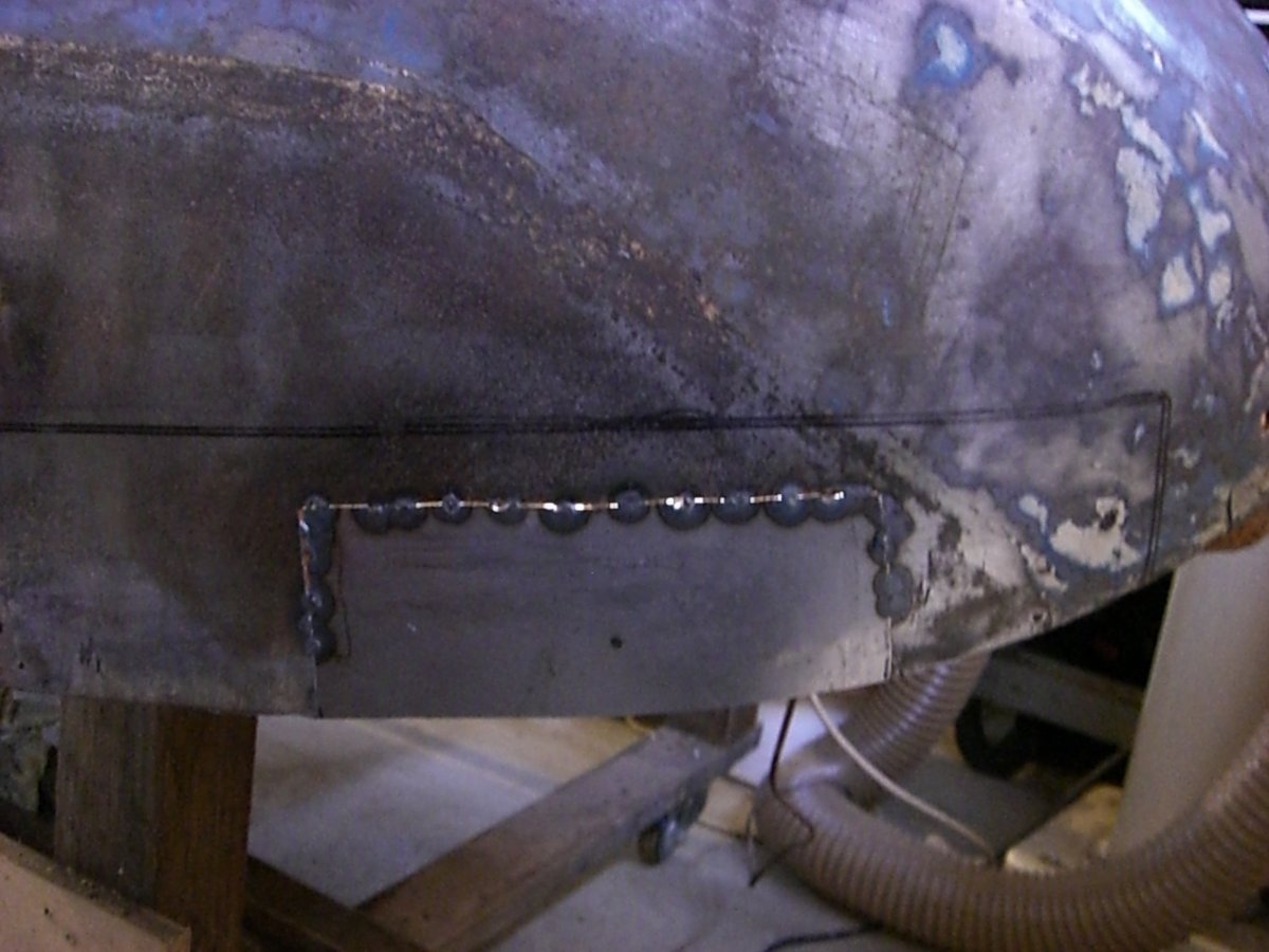

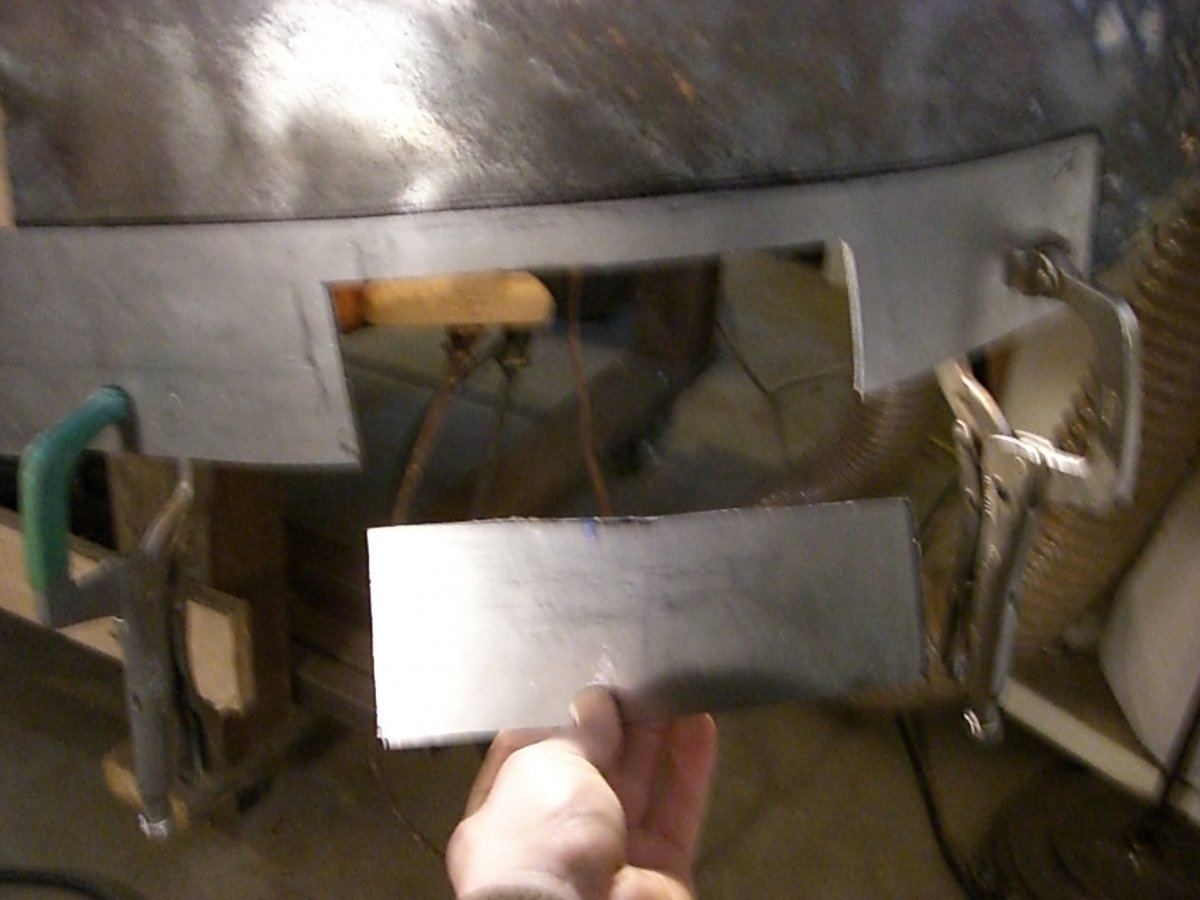

    Back to bodywork. With the cowl squared up it was time to move on to rust repair. Most of the damage was in the rear, due to condensation running down the curved back. You can see how the trunk extends below the body, a perfect spot for water to pool. The trunk floor was rotted out, as was the forward trunk wall, and the vertical perimeter of the tail section was Swiss cheese pretty much all of the way around. I cut away the rotten trunk floor and got started on the sides of the boat tail.
    This was my first-ever attempt at patch panels, and I almost didn’t post this part because my welding is…well…not exceptional. :rolleyes: You can find MUCH better examples on the HAMB—I know, because I studied them.
    But one of the things I learned on this project is don’t be afraid to plunge in, so here goes. Maybe it will inspire some fellow amateurs. The basic process:
    1) Roll a curve into a sheet of 18 gauge using my DIY English wheel (a stump and Maglite).
    2) Clamp the curved sheet over the damaged area.
    3) Cut the sheet and damaged area simultaneously so the patch is a perfect fit.
    4) Clamp the patch in place and back with copper.
    5) Weld slowly (from the inside if you can) with .023 wire—tack tack tack wait…tack tack tack, wait…
    6) Smile when you see that nothing warped.
    I patched the tail in a series of sections, I think it was 6 or 8 total—it depends on how you count, because when I was done and had the hang of it, I went back and redid the first two.
