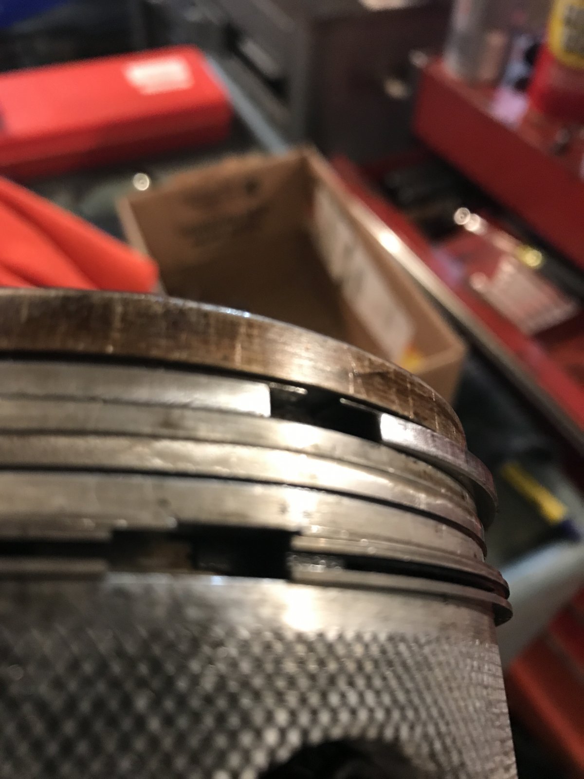

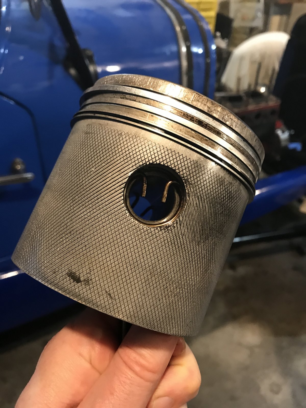

    OK, enough with the dancing. Celebration’s over. Back to the task at hand. A couple days ago I finally got some time to pull #1 piston. This was the hole with the cleanest piston top, but the dirtiest spark plug.
    The results were inconclusive.
    No obvious problem, like broken or stuck rings. One thing I noticed is that the top piston ring and bottom ring each have a super-thin companion ring. You can just see them here at the top of the groove.
    I’ve not seen that before, but lord knows there’s lots of stuff that I haven’t seen. But it occurs to me that maybe those rings are supposed to be clocked, and having the gaps line up might create a path for oil?
    Or maybe I’m grasping at straws…
    The pistons are each stamped with a "1" at the top, which I'm taking to mean .100 O.S., a common Model A bore size. My good calipers and ****py Chinese Bore Gauge seem to confirm this. My ****py Chinese Bore Gauge also tells me the taper is OK.
    Still three pistons to remove and examine with much dirtier chambers. I’ll keep you posted.

    Knurling is an enlarging operation...
    Sloppy bores?
    Could the problem in fact be valve related...
    Staggering rings is absolutely essential as you are implying...

  5. ROADSTER1927
    Joined: Feb 14, 2009
    Posts: 3,288
    ROADSTER1927
    Your top ring has a spacer above it and that should not be there. The width of the ring is to narrow. They also do not look like they have enough tension on the cylinder walls but I could be wrong. I would remove them and check them in the cylinder. Keep them in order and the right side up. Gary

  6. ClarkH
    Joined: Jul 21, 2010
    Posts: 1,571
    ClarkH
    Yes, the pistons are knurled. I'm still processing that, but it's not ideal. Plan is for new valves and guides. I can feel a little wobble in most of the valves. And new ones are cheap.
    Thanks, Gary. That top ring spacer had me baffled, so this is good to know. I'll check them like you suggest, because it's all useful information as I try to suss out this engine's overall status. Plan is for a hone and new rings.

  8. rwrj
    Joined: Jan 30, 2009
    Posts: 878
    rwrj
    from SW Ga

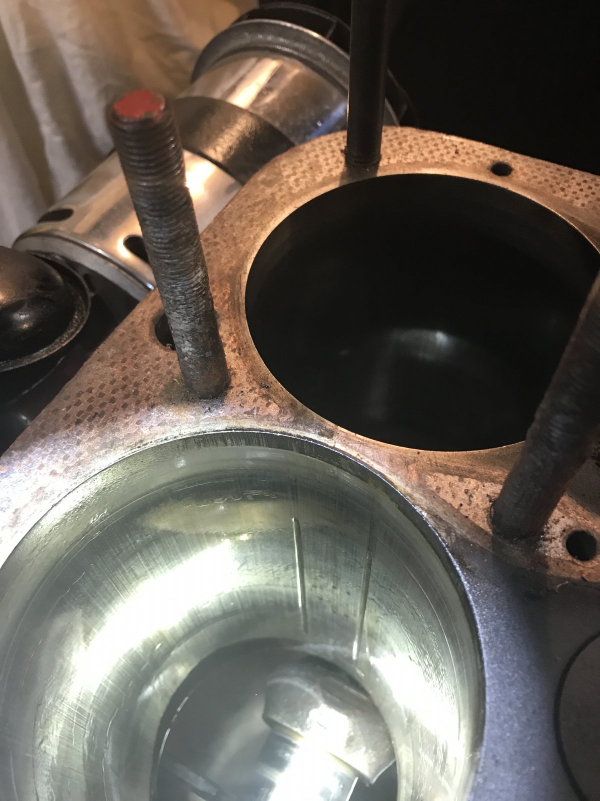

    Maybe I missed it, but how do the bores look? Any hatching left, or smooth, or longitudinal scratches?

  9. Dedsoto
    Joined: Jan 7, 2014
    Posts: 375
    Dedsoto
    from Australia
    I've ***embled engines with the rings staggered, put 10k miles on them and pulled them to change compression or make other changes and the rings quite often have lined themselves up

    Oh damn @rwrj, you are prophetic. I pulled #2 piston today and got the bad news.
    That’s #2 on the left, #1 on the right. Note the absence of retainer rings for the wrist pins on #2, and the wrist pin flush with the outer edge. The wrist pin has scored both sides of the cylinder walls badly. It’s going to need a sleeve.
    Don't know why I didn't see this before. I guess I was fixated on taking it one cylinder at a time. It's just like when I found that counterbalanced crank last week--I totally missed seeing The Great Big Thing That’s Staring You In The Face.
    Well, at least it answers the question of what's causing the smoke. I'm bummed, but I keep reminding myself that I knew there was a likelihood of finding something like this. So now my “simple” in-car ring and valve job looks to be morphing into a pull-the-engine overhaul.
    Ah well, the car gods giveth (crank and cam) and the car gods taketh away (scoring). I’m taking a brief mental break to mull options.

  18. Homemade44
    Joined: Feb 7, 2007
    Posts: 561
    Homemade44
    Normally when a piston is knurled only the lower end of the skirt is done. You will need new pistons when you rebuild the engine and the correct ring set that fits the piston you use.

  20. ottoman
    Joined: May 4, 2008
    Posts: 341
    ottoman
    from Wisconsin
    The extra thin rings you see are used to save worn out piston ring lands... there is a special tool that cuts the worn ring groove oversize and the thin spacer rings resets the up/down ring clearance back to factory specs. Was a pretty common repair back in the day... I installed a lot of those in my time. If I remember right they were always installed under the ring not on top as in your pictures.

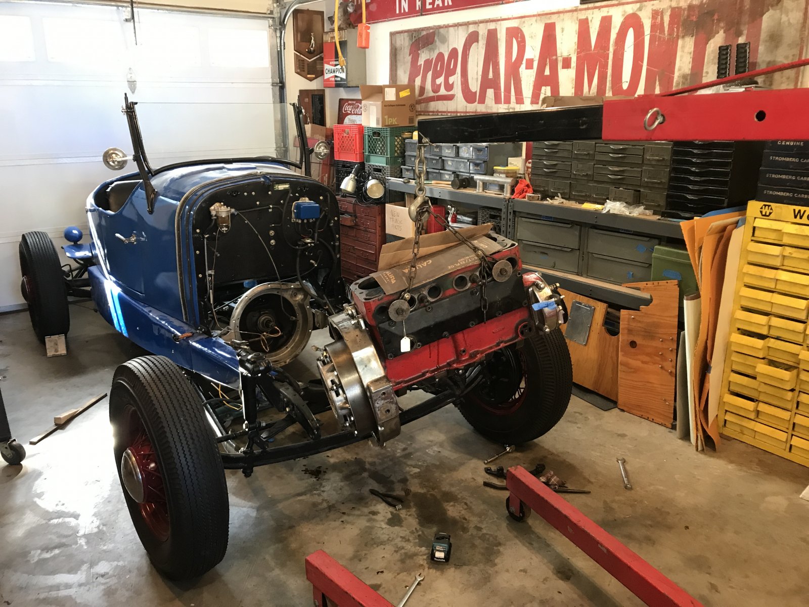

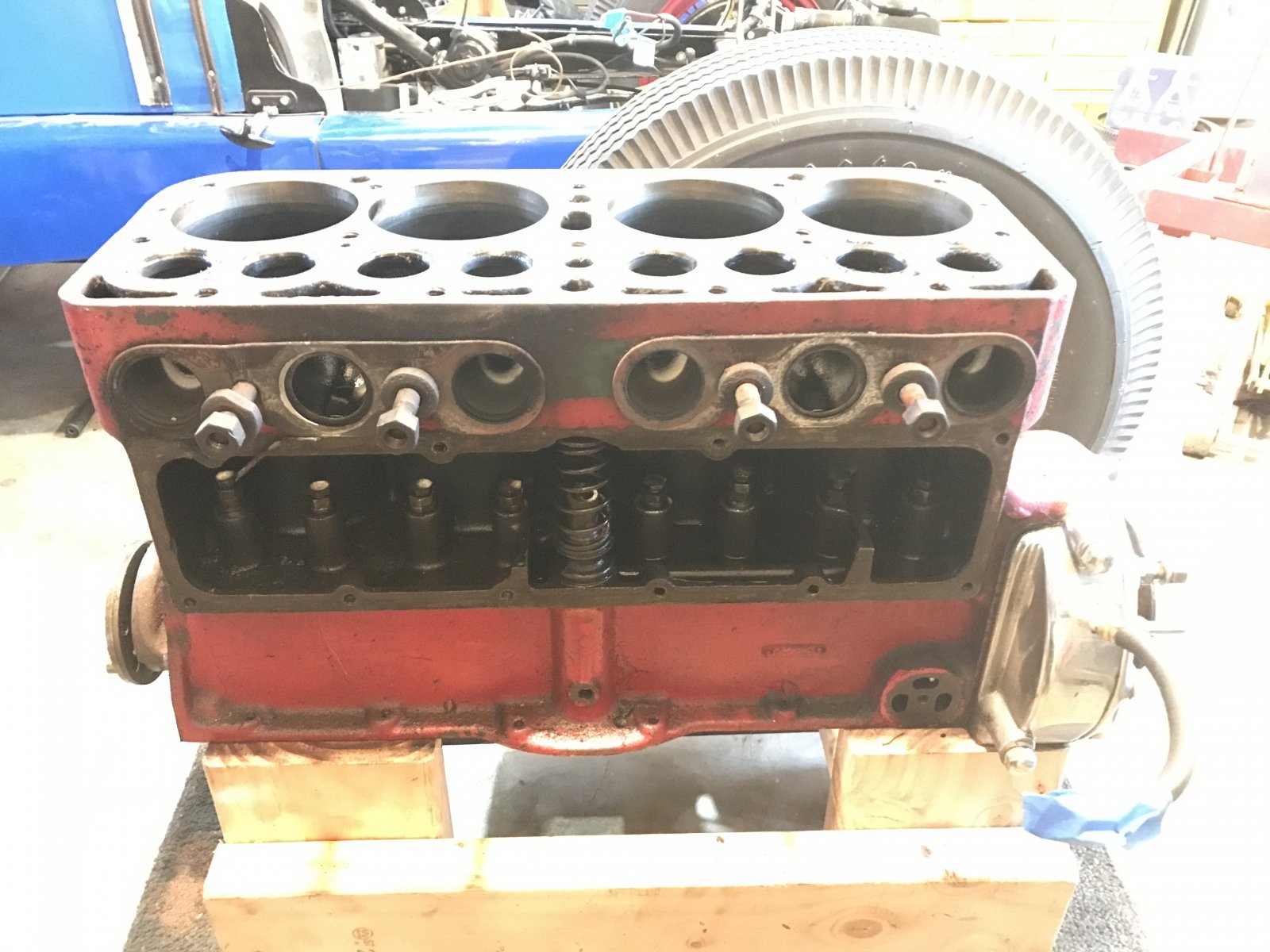

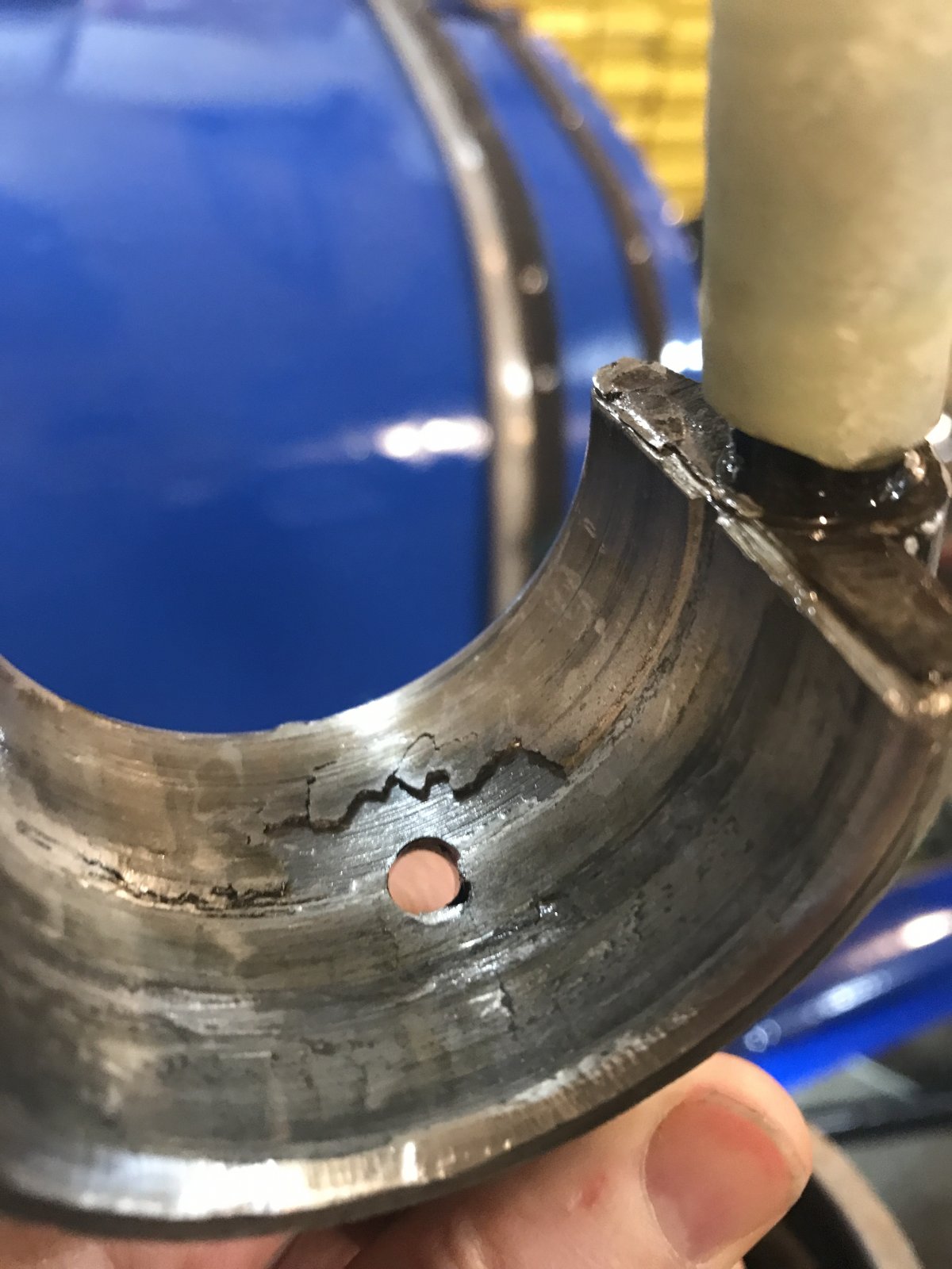

    Catching you all up on my progress. Pulling #3 and #4 pistons provided further validation that all of this needed to be done asap. Specifically, the babbit on #3 has failed.
    Fortunately, it apparently hadn’t reached the point of damaging the cool counterbalanced crankshaft. But it was only a matter of time.
    I’m speculating #3 was replaced at some point. It had different sized nuts (5/8 socket as opposed to 11/16 on the others). It also had 3 shims, whereas the others had only 1 each. Shims are used on Model A con rods to take up slack as the babbit wears. I’m speculating somebody replaced this single con rod and didn’t mic for tolerance and/or didn’t understand the purpose of the shims. Net result, it was ***embled with too many shims, which made it loose and the babbit got pounded. Not that it matters, that’s just life in the world of old Model A engines.
    Anyway, no turning back now. Engine had to come out.
    I’m now in the process of tearing it down. I found it easier to pull the valves sitting on a stool with the engine on a cradle. I’ll move it to the workbench next to get at the cam and crank.
    As expected, I found several loose valves, so the guides need replacing (was going to do that anyway). The valves themselves were a mishmash of at least 3 aftermarket manufacturers; probably each replaced only as needed. Four of the head studs have been re-tapped to 7/16 (stock is 3/8). You know, just more old Model A engine stuff.
    Ever onward!
