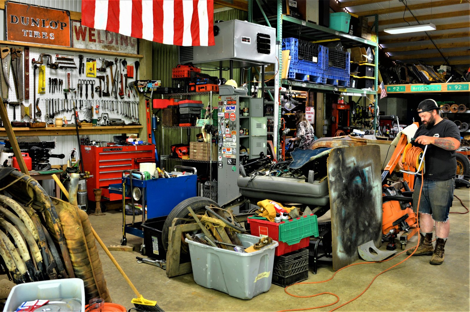

    Its pretty cool to know, that there is a one stop shopping place, that can deal with all of your four banger flat-head needs, when you really need prompt service !
    Bravo Matt !

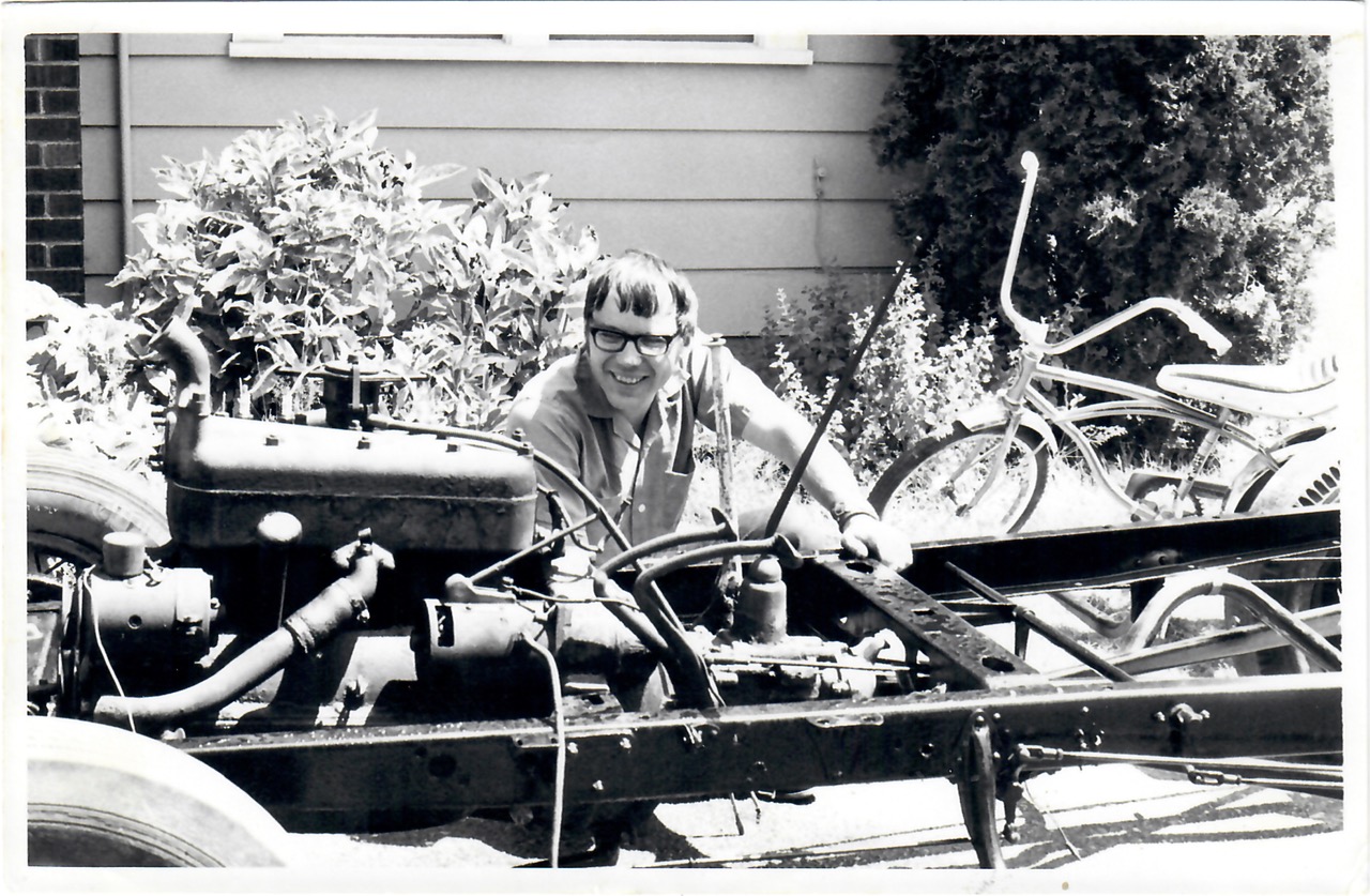

    I’m going to start out with a little tribute to my dad, who p***ed this year. It was dad who got me and my brothers started in the old car hobby, so he’s directly responsible for the joy I now take in this speedster. That makes him “on-topic” as far as this thread is concerned. :)
    Here’s a picture of dad working on his Model A project, probably shot around in 1969 or ’70. That’s my super-cool stingray bike in the background.
    Dad was an engineering professor at the University of Washington, and this is one of the few photographs of him in which his shirt pocket does sport the requisite pen, mechanical pencil and slide rule. The ch***is pictured was actually dad’s second Model A. His first was on old jalopy he shared with two high-school buddies in the late ‘40s. I honor that with a framed magazine cover from 1950 that perfectly captures the flavor of this bit of dad’s automotive history. (Many thanks to the @The37Kid for sourcing it for me.)
    The framed magazine is adjacent to a Hubley die-cast model that dad gave me for Christmas, shortly after the above photograph was taken. The model car exhibits all the flaws you’d expect from something ***embled by a 7-year-old, and I love it. It was my first build, after all. :)
    Anyway, dad had a good life and a peaceful ending, and probably would have been mortified at having a fuss made about him on the internet. So let’s move on to the speedster.

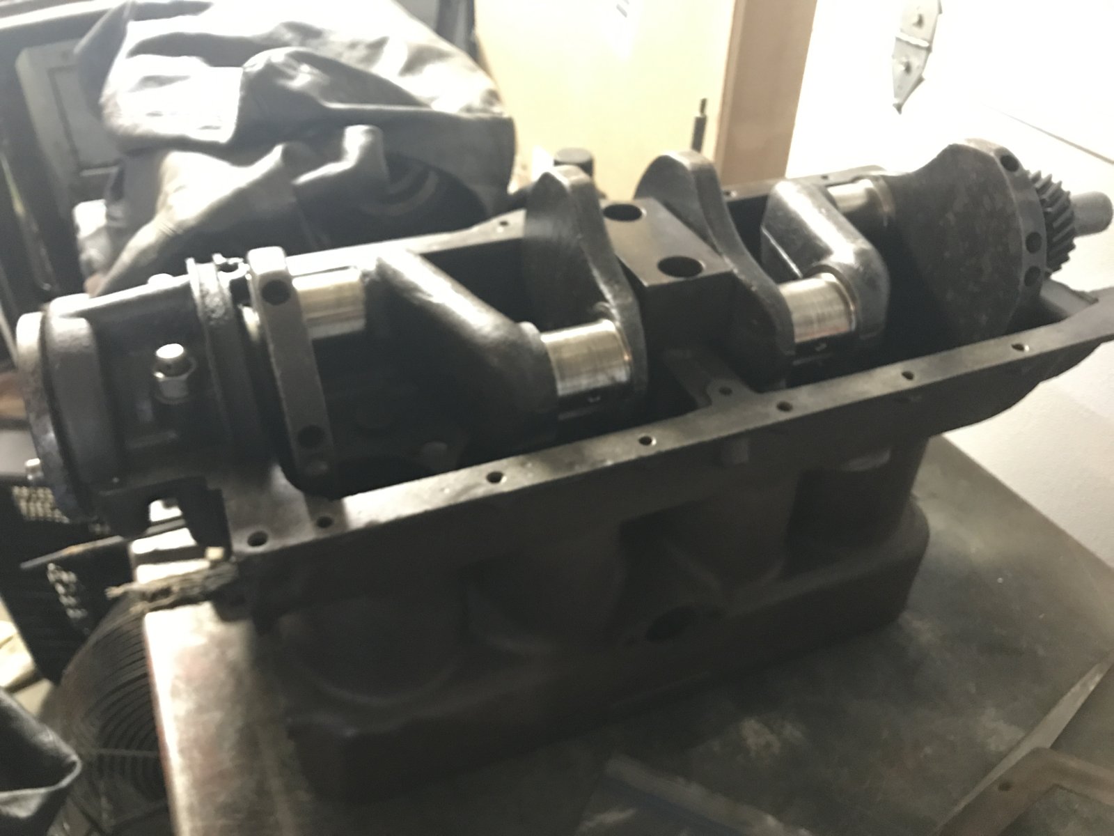

    With the winter build season on us, the speedster is slated for a Model B engine. This is something I acquired long ago from the vast @Hitchhiker collection. It was earmarked for my truck project, but plans there have changed (I’ll post something about that on my truck thread soon). Here’s a shot of the B block wallowing in the temporary chaos of my shop (I’ve got to get this truck cab out of here and onto the ch***is so I have room to work).
    This B engine has had some work done. It’s been drilled for full-pressure oil, the steam holes have been filled to accommodate an aftermarket head, and it’s been given a seriously beefy center-main cap.
    All the babbit appears to be fresh and within tolerance. However, beyond the counterbalanced crank, con-rods and pistons, it is missing everything. So I’ve got some parts collecting to do. Which is always fun—one month to Turlock!

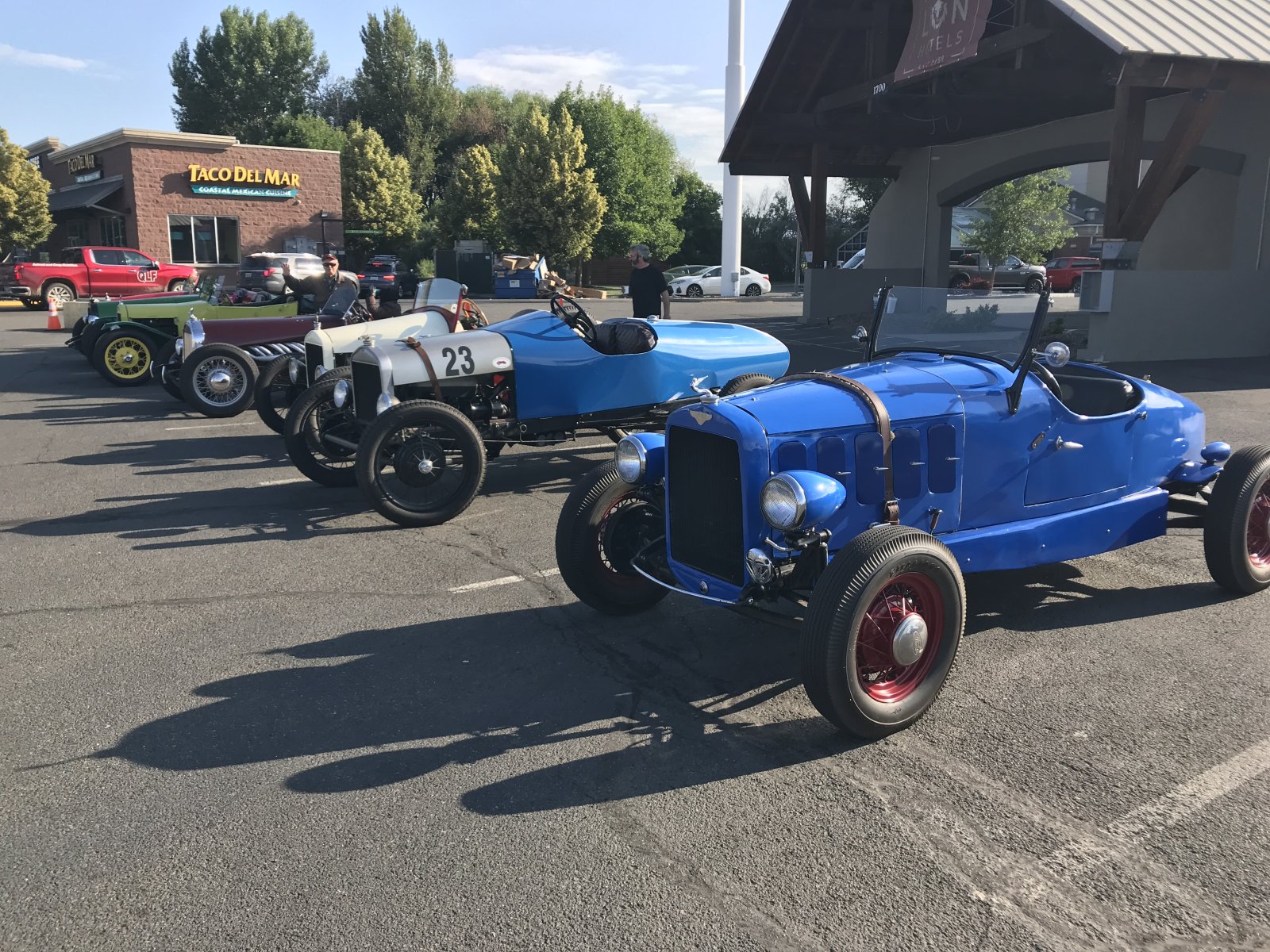

    The speedster had plenty of power going us Stevens P*** (elev. 4,062 feet), but was not happy, with the temp needle climbing dangerously as we reached the summit. She ran cooler coming down the mountain, only to blow a hole in the exhaust manifold gasket. Fortunately, while annoyingly loud at speed, an exhaust manifold leak is inconsequential.
    Here’s Clementine (that’s her name) at a lunch stop in the Bavarian-themed town of Leavenworth, sporting her new leather hood strap.
    Next up was Blewett P***. This time, trouble didn’t wait for the summit; the needle pegged about half-way up the 4,100-foot climb. With the daylight failing, we loaded Clementine onto The Trailer of Shame and followed everyone over the p*** and into Ellensburg, our first night’s stop. A little investigation revealed the source of the overheating problem: My home-made 2-piece generator mount had loosened up. You couldn’t see it at idle, but at speed the generator would “float” and tilt, preventing the water pump from turning properly.
    Next morning, with the day’s outdoor temperatures expected to push 90 degrees, we set out nice and early to get a jump on the heat. Here’s a shot of some of us staged at the hotel.
    The car ran great all morning, nice and cool, with the drive made even more pleasant by some foam ear plugs. At roughly the 200-mile mark we reached the Columbia River, where we planned to rest and regroup. As I pulled into our designated break spot, the car died suddenly, and I ended up coasting into a parking spot. Hood open, we cranked it over to investigate and saw gasoline gush out of the carburetor. Ugh. But hey, good news! I had a spare Stromberg stashed in the truck, all ready for a roadside repair.
    Ric got the carb changed in record time, earning nods of approval from the club graybeards gathered around with cokes and ice cream. Then I started it up and heard that telltale sound we all dread:
    Thwocka thwoka thwoka thwoka thwoka
    The graybeards all groaned. “Shut it down!”
    Rod knock. Probably been coming on for many miles, masked by the exhaust leak. Frankly, it wasn’t a surprise. I’d hoped that little used engine was up to it, but in my heart I knew I was rolling the dice.
    Anyway, that was that. We loaded Clementine onto The Trailer of Shame, and I finished the trip riding in the air-conditioned cab of the truck, shooting the **** with my brother and sipping cool drinks while our fellow open-car enthusiasts enjoyed the 90-degree heat.

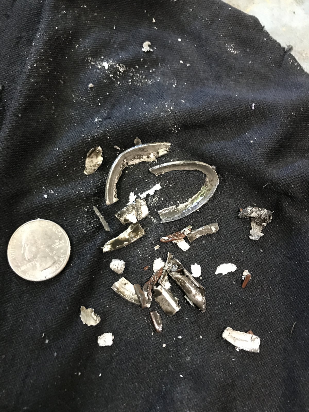

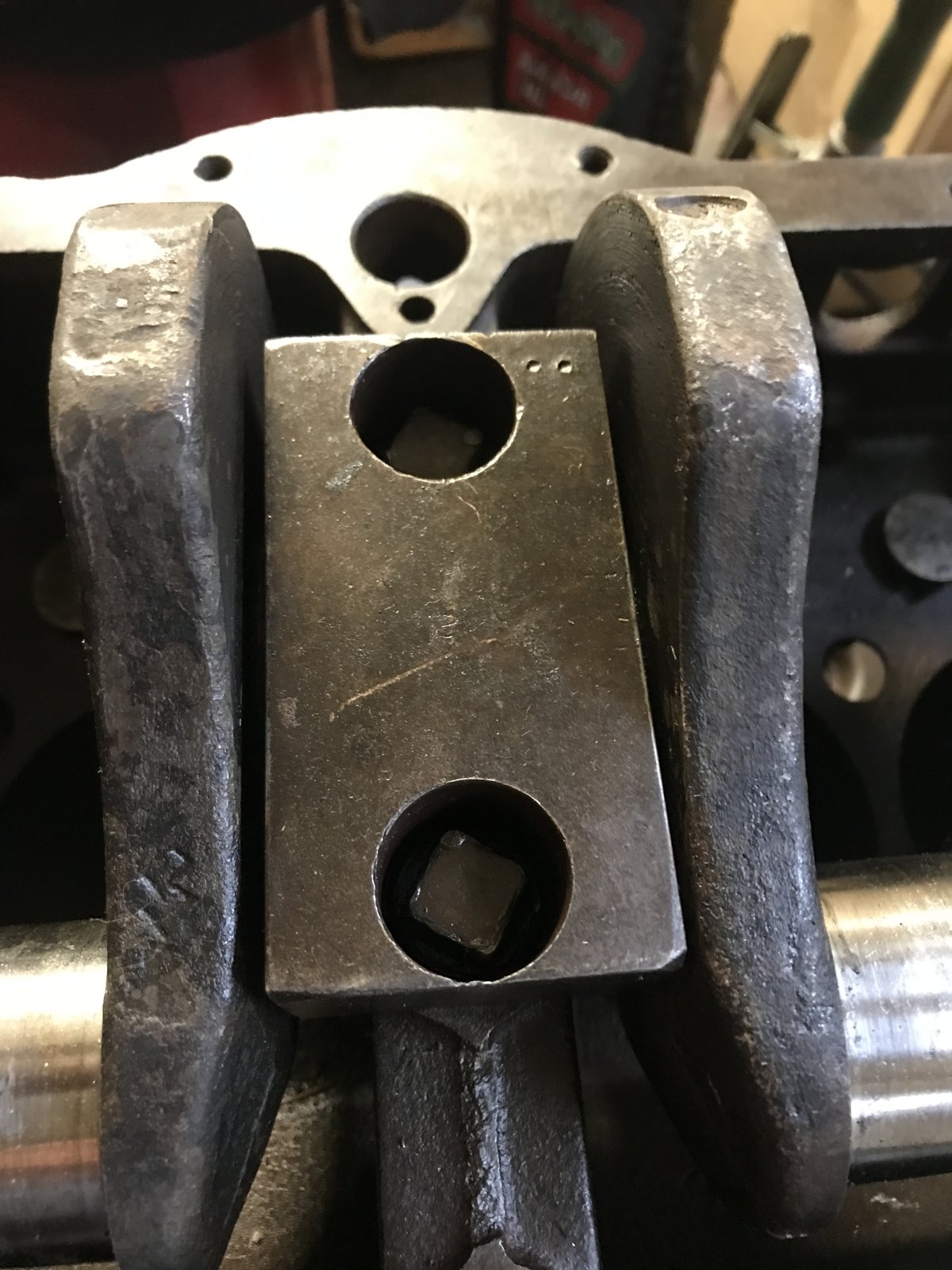

    After returning home, I removed my oil pan to check everything out. I figured if I was lucky and it was just one con rod, I could replace it with a used one and save my summer. Identifying the culprit was easy: I jiggled each rod end and one clearly had play. Pulled the cap and sure enough:
    So far, so good. Crank looked OK and I’ve got lots of old rods with adequate babbit. But then I sifted my fingers through the dark oil in the drip pans and came up with this:
    Holy broken babbit, Batman! There’s a US quarter in the picture to give you a sense of scale. That’s a lot more babbit than came off this rod. And lord knows how much of it has traveled through the oil galleries. Clearly, this engine was well past a short-term fix.
    So that was it for summer driving. In the ensuing months I’ve kept an eye out for a good motor on the West Coast (i.e. that I can pick up), but all I’ve seen are more pigs-in-a-poke. Ads that simply say “runs” don’t fill me with confidence. Heck, this engine still “runs.”
    A few months back my brother put me onto a good machine shop, and they’re willing to sleeve my original A block. So unless a fresh engine drops out of the sky, that work will begin next month. I like these guys: My first encounter with them was for redrilling a flathead flywheel to accept a smaller clutch (for my pickup project). Soon as he saw the flywheel, the chief machinist started reminiscing about all the Ford 3-speeds he’d blown up with his old Mercury. Yep, these are the guys I want to work with.
    Anyway, I hope you’ve enjoyed this odd little story. And with luck I’ll have cause for more interesting posts soon. Thanks to everyone who follows this old thread of mine, and again, Merry Christmas!
