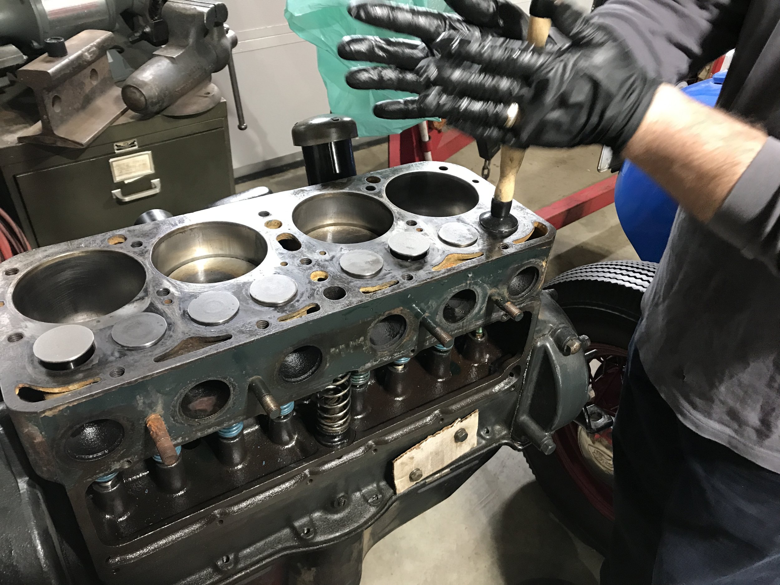

    Eventually I found what seemed to be a great candidate in central Oregon; an old rebuild that had never been run, loaded with high-dollar speed equipment. It had come out of a show car, and was now on an engine stand, ready for inspection. I put down a deposit and @Hitchhiker and I killed a day to go get it. But on inspection, it turned out to be a race-prepped motor—no shims on the con rod babbit. And it was an early crank (no counter balance). Not what I wanted for this old tourer.
    But in a twist of fate, the trip inadvertently led me to an engine. It seems several weeks later, Hitchhiker was telling a mutual friend about my hunt for an engine, and related the story of our 700-mile wasted day. Well, it turned out this friend had a B engine he’d taken in trade 15 years ago, and had been saving it for a “maybe someday” project.
    The engine was local and mine if I wanted it, but it had some obvious issues (notably a cracked head), so we both agreed it needed a full inspection. What we found was a mixed bag. On the bottom end, the engine was clearly a fresh build, with excellent babbit that was still in tolerance and had all of its shims. The oil pan and dipper tray had signs of ancient rust-through that had been fixed with JB weld. When we removed the cracked head we found a long-blown head gasket and a goopy mix of what we took to be gelled up stop-leak of some kind. We also found that it had been pinned in the usual crack zones, which our friend didn’t like but I took to be a good thing, since it looked like a professional repair. Some of the valves had been replaced, others not, and a couple of the “nots” could be wiggled more than we liked.

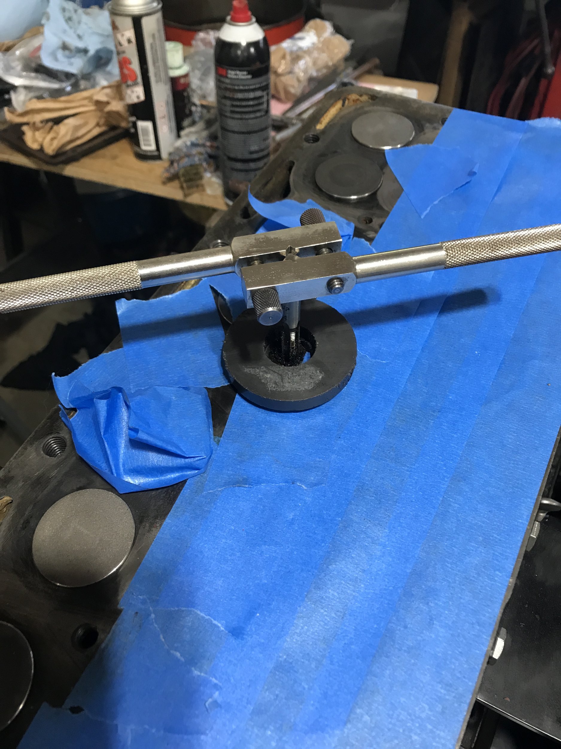

    Replaced and lapped all the valves.

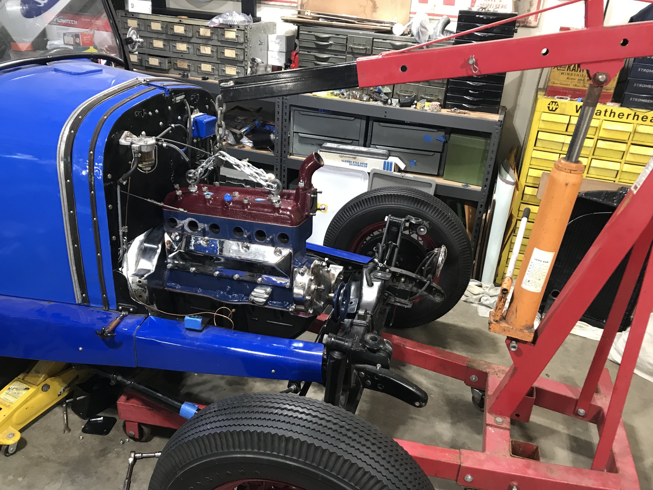

    After eight months of abject clutter in my garage, I finally got the engine installed and everything hooked up.
    Then a couple weeks ago, my brother came over for the big day. We installed the distributor, unstuck a float that dumped gas all over the place when the electric pump primed the carb, and finally fired it up.
    It runs great, as shown this video, which I call Six Seconds of Fury.
