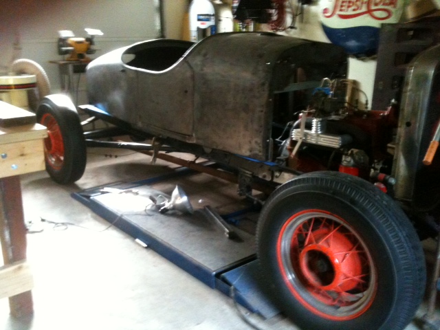

    With the floor in place, the body was now a stable, integral unit and ready for a test-fit on the ch***is. Ta-dah! Although I’d done a lot of measuring, it was still a huge relief to see everything lined up as I’d hoped. And best of all, I thought the car looked great!
    The cowl is longer than that of a Model A, but it’s also much lower, and with the steering column rotated down about 20 degrees it fit perfectly. I modified the steering box using Vern Tardel’s method: I cut the flange off the box mount, chamfered the edges, repositioned, welded back into place, then replaced and honed the bushing. The only difference is that instead retrofitting the flange to an F-1 box, I reaffixed it the original box. (I did NOT do this with my little MIG welder, by the way. I have a neighbor with a TIG welder, and he’s happy to do any welds for me that have a safety aspect.)

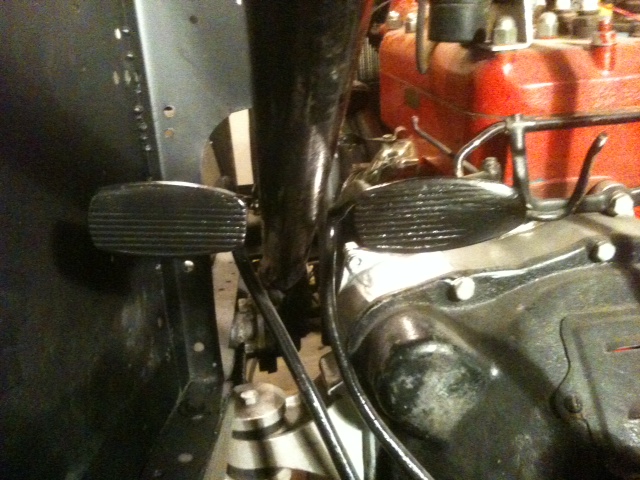

    Here’s a ****py picture that doesn’t show much.

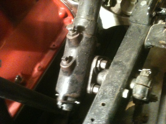

    Repositioning the steering column meant that it now had to p*** between the clutch and brake pedals instead of over them. So the pedals had to be tweaked for clearance. One day I came home to find a message from a retired contractor friend on my answering machine: “I left something for you in your back yard.” Here’s what it was:
    This called for another gift bottle of wine.

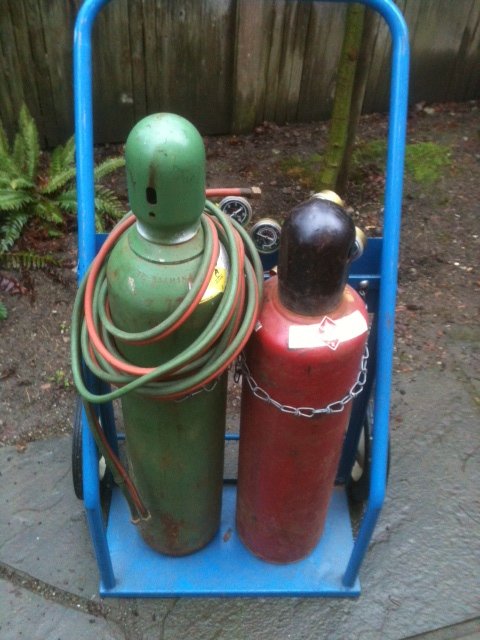

    The oxy/acetylene setup with a rosebud tip made it easy. I made a form from s**** wood, heated the pedals and hammered them into the form. Took just a couple tries to get right. Once they fit, I heated and twisted the pads back to square, and trimmed the outer edge of the clutch pedal so it wouldn’t hit the cowl. (The change is kind of sublte, so hard to see.)
    I did all this torch and hammer work in the driveway on a metal workbench. There was a lot of smoke and fire and banging. I still get jokes from the neighbors about “The Village Blacksmith.”
    While I was at it, I put a couple bends in the gearshift, so it would clear. It’s not elegant, but I figure nobody’s going to notice once it’s fitted with my awesome HAMB gearshift knob. :) Also, I regard it as temporary: I have a ’39 transmission bought off the HAMB that I hope to use someday.

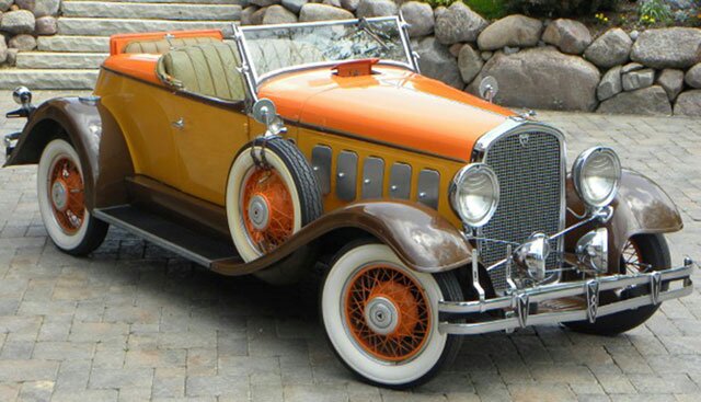

    Pretty sure you are correct about the hood - either '31 or '32 LaSalle. The Buick side panels are similar, but the top is quite different. Looking awesome by the way!!

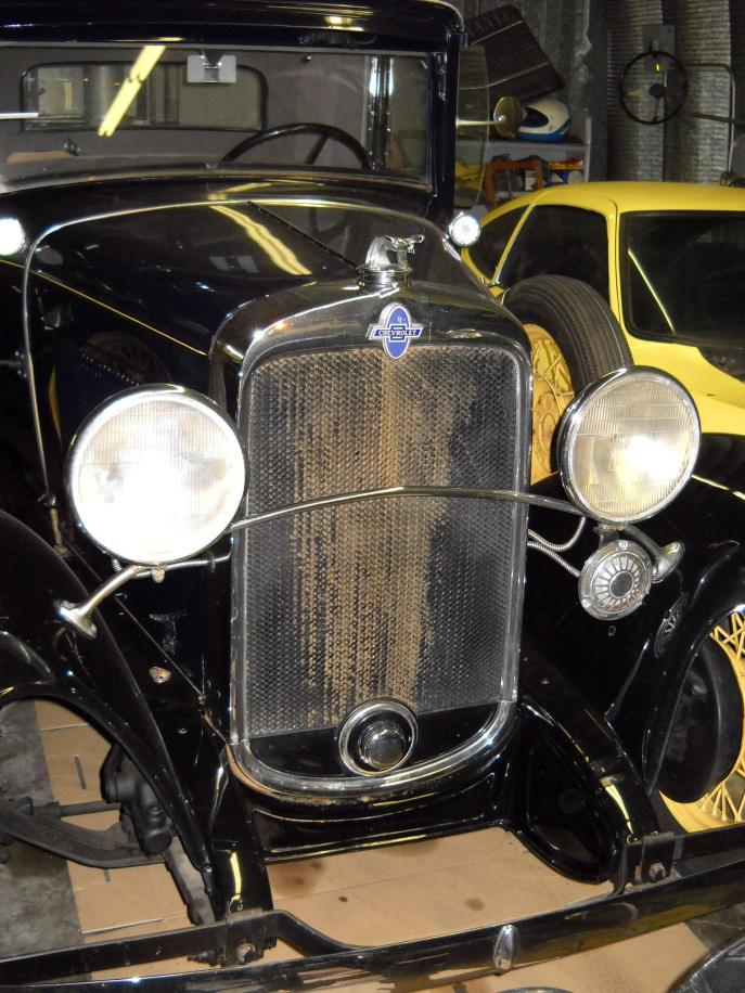

    if you are looking for a cool grill that will fit in the same place as a Model A grill, check out a 31 Chevrolet grill.
