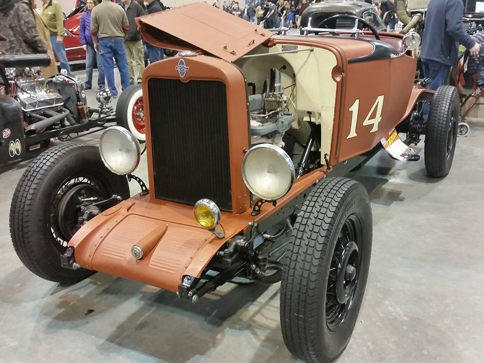

    So here’s a little more information on the mockup.
    There’s several things going on here to make that long hood fit. The cowl band has been moved back, and the hood actually overlaps the cowl about four inches. Weird, but it works. A drawback is that I’m pretty sure the rear vent door on either side won’t be able to open.
    The radiator is moved forward 4 inches and down 4 inches. A benefit of doing this thread retroactively is that I can kind of gloss over my missteps. So I won’t show the three pairs of failed support brackets I made and threw away before I finally got it right.
    With the radiator lowered, the upper hose interferes with the fan. I’m going to see if I can get away running without one. If not, I’ll find a solution. (I promise, no electric fan.) I also need an adaptor box to get the lower hose up over the front cross-member. I hope to do this soon—I think it’s been long enough that Ron at Greenwood Radiator won’t hide when he sees me drive into the parking lot.
    In this mockup, the rear fenders are sitting on hockey pucks. I’m still kind of torn between fenderless and fendered. These are not the fenders the car came with—I got these at the Portland Swap Meet. I was told they’re off an early ‘30s trike. I also have a spare tire ring I could cut up for the front.
    Here’s a picture of the fenders the car came with.
    These are asymmetrical—the inside is lower than the outside—so I ***ume they came off a trike or sidecar. They’re kind of neat, but I don’t like the way they wrap around so much. For me, the look is too “heavy.” I want to see the tires.

    Did you take pics of it mocked up with the original fenders? They're really pretty on their own, curious to know what they'd look like on the car.
    slv63 and volvobrynk like this.
  9. I agree that those fenders are too "heavy." I like the yellow ones better; they cover the tires without overpowering the car.
    ClarkH likes this.

    There is something about them old fenders that looks right and there is something that looks wrong.
    I think that two off the heavy with a larger inner arc, that would ligth them up and a pair of yellow ones in front will give the best era vibe.
    But a mock up will tell you.

    Thanks for the feedback on fenders, guys. I think the yellow ones are the way to go. Bob, that's some really nice work in that link you provided; not quite in my current budget, though. Down the road I'll post some pictures in its various configurations, just so everyone can see. (The fenders are buried in a shed right now.)

    Thanks Gary. Based on everyone's feedback, I'm convinced a commercial shell is the way to go. That painted shell look "right" in this picture of your speedster. Plus, the flat top mimics the look of originals for these cars, and they can be tweaked for fit. It's amazing how many ideas you guys have given me in just a few days.

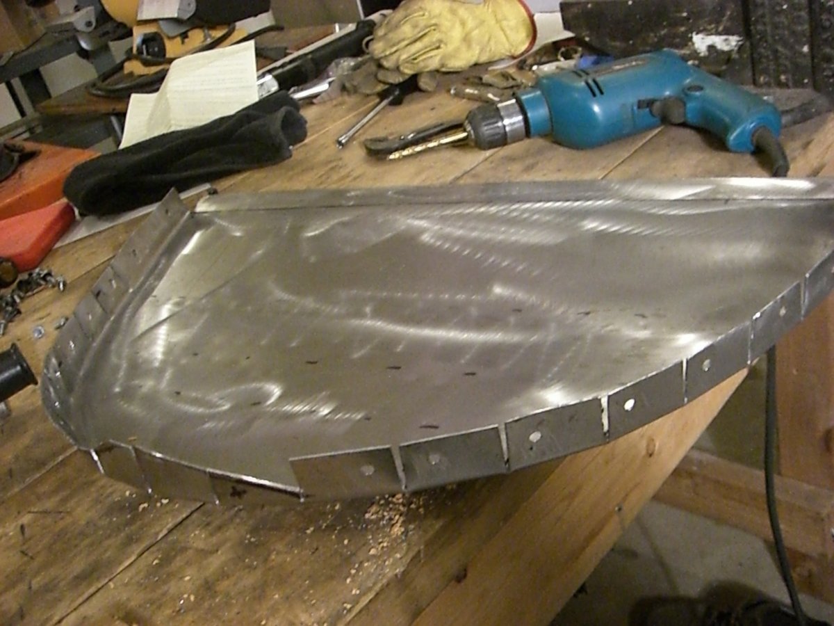

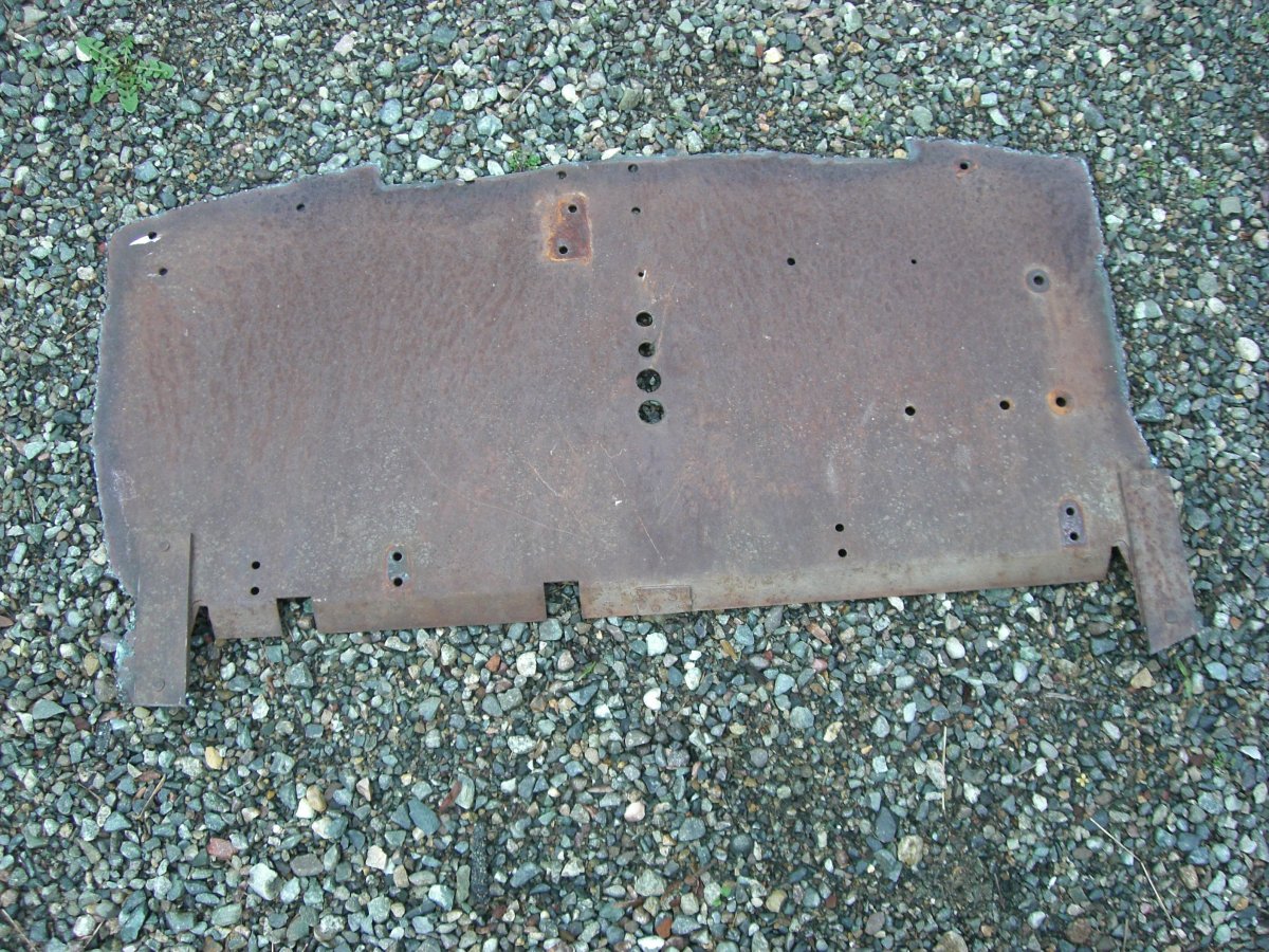

    Before I did the trunk floor, I spent a lot of time looking at HAMB threads by very talented people showing how they form body panels. As always, I came away with a lot of good information and an inferiority complex. :confused: But I pressed on.
    The original trunk floor was so far gone when removed that it wouldn’t even serve as a template. So I made one out of cardboard, transferred it to plywood and cut my form. Then I cut out the sheet metal, clamped everything together and made some relief cuts around the perimeter. Then I commenced hammering.
    I made the panel from 16-gauge, which I realize is overkill. But I didn’t want it to oilcan. Plus, the body is made from something between 18- and 16-gauge all around. This probably explains why it survived so long in its damp storage environment. Having blown my share of holes practicing on 20-gauge, I knew welding 16-gauge to 16-gauge would be easier for me. (And now, if I decide to store it in the bushes for a few decades, the next owner will have more to work with. :rolleyes:)
    The panel was too stout for my DIY English wheel (stump and Maglite), so I used a shot bag and mallet to put the curve in it. My first try was close, but about a quarter of an inch too small. I made a new form and did better on the second. Here it is in place—obviously some tweaking left to do, but you get the idea.
