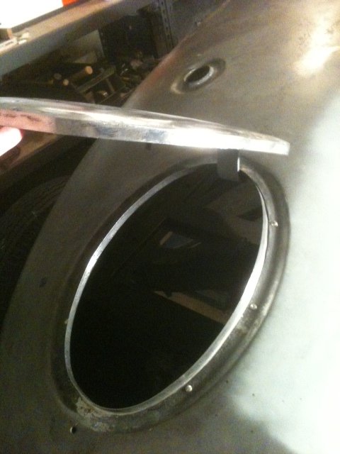

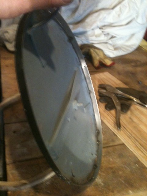

    With the holidays over I’m back at work and my build posts have slowed down. Which is OK, since I’m getting close to caught up on current progress. But I’m committed to getting the car on the road this summer, and will keep the HAMB updated frequently.
    Also over the holidays, I finally made progress on fixing the deck lid (aka, “toilet seat”), something that’s been bugging me for a long time. In the previous build, the original deck lid and trunk opening were trimmed and leaded together to make the tail section smooth. I separated them early on and set them aside, figuring I shouldn’t do anything until I could study an original.
    I recently got to examine an original. Here’s what it’s supposed to look like:
    The deck lid pictured above is actually a reproduction. I’m told somebody made a short run of these a while ago, but finding one is hopeless. To fix mine, I made an oval shaped form out of plywood and ringed it with a half-inch wide section of 16 gauge. Then I cut out the center of the form so I could lay it over the deck lid and tack the new lip to the edge. Finally, I removed the form and welded it completely.
    To fix the lip I made a form and hammered out the basic shape, then dollied and filed everything smooth. For now it’s held in with screws while I get everything fitted.
    Here’s how it came out. Still some filling and filing to do, but I’m pretty happy with the result.

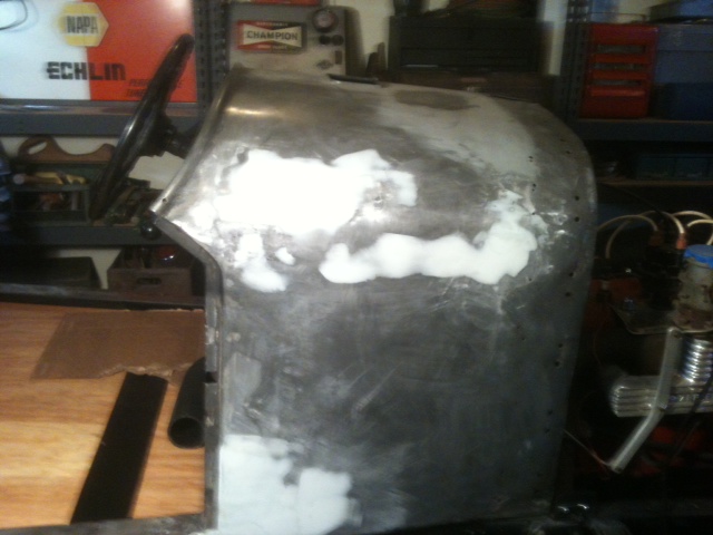

    I’m reaching the final stages of bodywork. I’ve gone as far as hammer, dolly and file will take me, and am using All Metal and Rage and for the final touches. It’s too cold out to paint, but I should be ready when the warmer weather returns. I expect I’ll run it in primer for a time until everything’s finished.

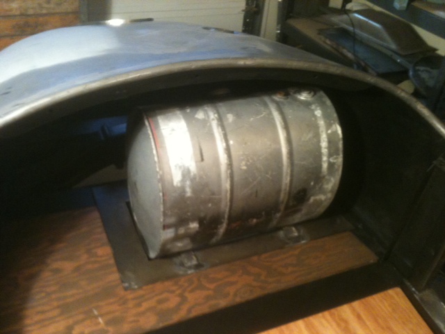

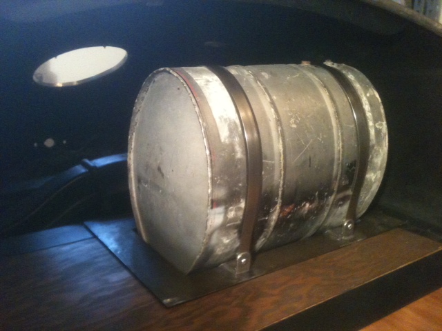

    Also, I made a good start on the fuel system last week. The fuel tank fits in the tail section behind the driver’s seat; there’s an inlet built into the tail section. I spent a long time looking for a tank that would fit. I didn’t want anything modern, local swap meets were a bust (nothing but big leaky T tanks), and the reproduction stuff was all the wrong size. I’d reached the point were I figured I’d have to use a little temporary tank for a while when this cool vintage aluminum tank popped up in the HAMB cl***ifieds:
    The size is almost perfect. When placed in the car, the tank’s fill neck is slightly above the fuel inlet on the body. But this was easily fixed by cutting a hole in the floor and lowering the tank a few inches. Here are some pictures of the cradle I made out of 1/8” s**** from a local salvage outfit (torturing my little jig saw in the process):
    The support brackets are 12-gauge bent by hand over a form.
    So there it is. The tank fits nicely and I can use a standard fuel inlet hose with a 45-degree bend, and yet is still high enough to feed an electric fuel pump. I expect to finish the hold-down straps today or tomorrow, work-permitting. I'll post some pictures when done--I promise not to let an entire month p*** this time!

  18. loudbang
    Posts: 40,346
    Cool tank any idea what it was made from? Looks like a small 55 gallon drum or something.
    ClarkH likes this.

    It's made of aluminum, and the guy I got it from thought it was military/aircraft. It certainly has the look, but there are no markings on it. I see what you mean about looking like a mini oil drum, but those pics are kind of deceiving. Here's a side view that show's its oval shape better. I did the math, and it holds about 12 gallons. Whatever it came from, it's cool.

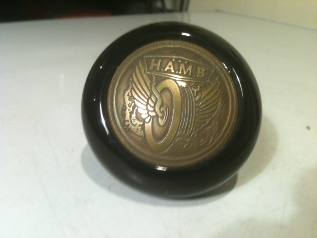

    I don't know how I missed this thread before now, but it just became my favorite. This is what dreams are made of, man. You are doing a great job and indeed, the hotrod gods are with you. I can't wait to see the final product but in the mean time I'm enjoying the hell out of the journey.
    Oh yeah, I'm feeling very prideful about your choice of shift knob. :)

    Thanks for that, Saxman. I'm honored to qualify as a "favorite." The gearshift knobs you created are pieces art--I absolutely love mine, and am fortunate to have gotten one. As a bonus, the winged design is evocative of the Mercury Body logo--at least in my eyes.

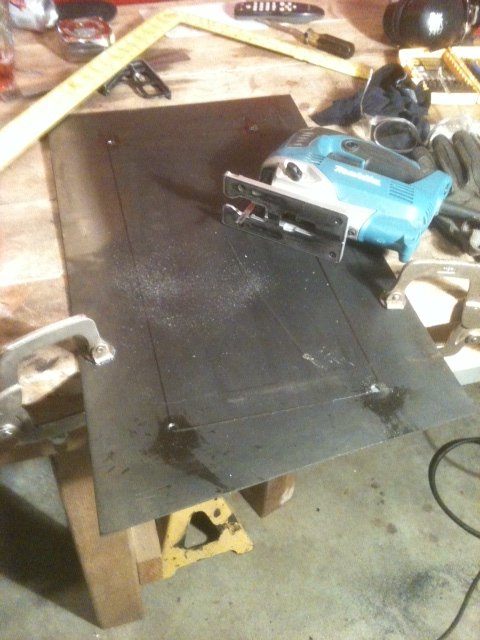

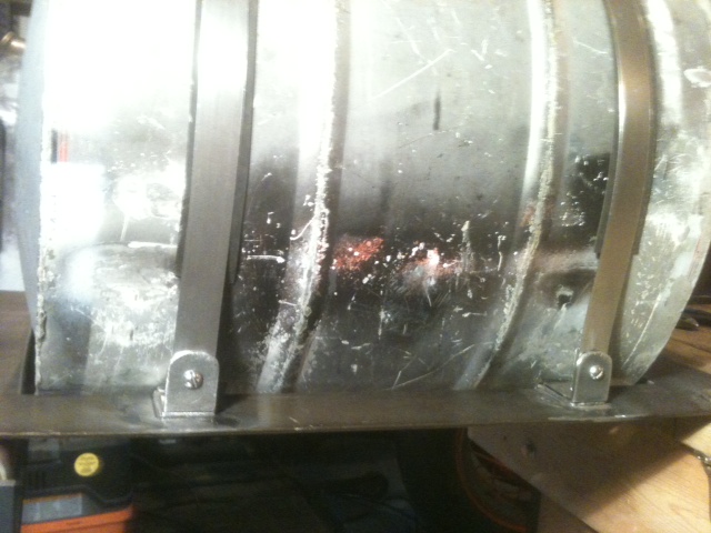

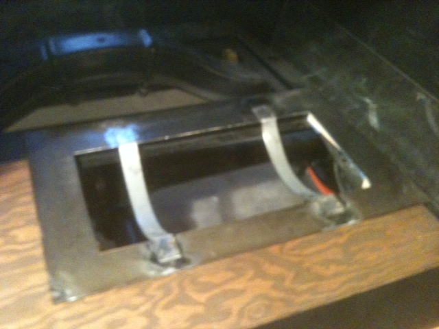

    A little progress to report. I finished off the fuel tank supports last night. Welded some brackets to my base, made straps from 22-gauge, and pulled everything together with turnbuckles. The strap material was cut freehand with a jigsaw, and it took a bit of time with a hand file to get them smooth and square. I crimped 1/8” plate in one end and rod in the other to keep the straps from tearing out. The turnbuckles are a little small, but should be OK. I may check out the local marine stores to see if I can find nicer stainless ones. There’s a thin rubber band between the straps and tank, which I’ll align more neatly when time comes for the final install.

    Nice clean gas tank install...I would suggest some kind of rubber gasket between the aluminum tank and the steel straps to cut down on the corrosion from electrolysis.

    flatford: Didn't he just say he had rubber under the strap?
    "There’s a thin rubber band between the straps and tank, which I’ll align more neatly when time comes for the final install."

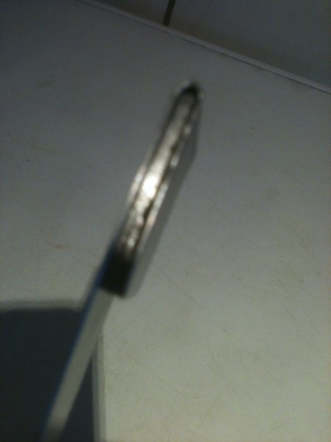

    Thanks for the the compliment on the install. It's hard to see in the pics, but I did put some rubber in there, both to prevent corrosion and provide a little cushioning.
