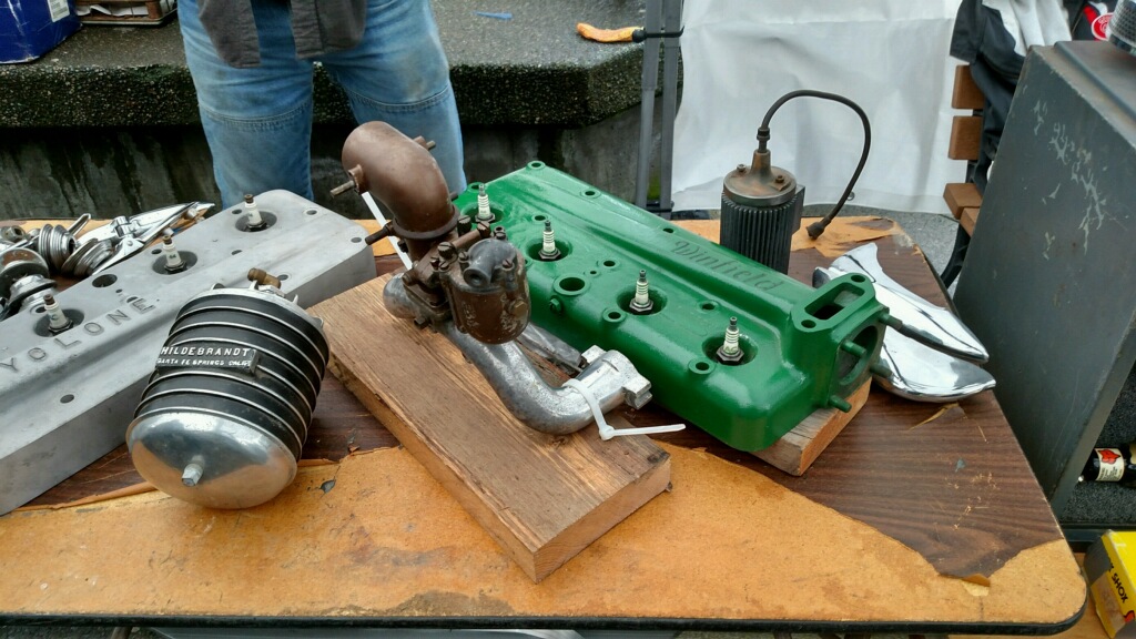

    But the BIG Puyallup find—which I did NOT buy—was a guy selling a Winfield head, intake and S-carb. Yowza!
    I actually grabbed Matt (aka Hitchhiker) out of his booth to go over and take a look. There was no serial number, but the head had very small chambers—Matt speculated it was an 8:1 that had been milled. WAY too much for my little stocker, but very cool to see. My quest for a yellow head continues…

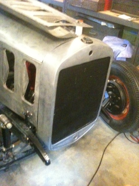

    After Jim Ford very kindly did some work on the commercial shell he sold me—moving the neck and filling some holes—I finally got it in place and mocked up. To make it fit my standard A radiator, I had to tweak the radiator’s support brackets a hair (cut, bend, tack) and also file a couple slots into the base of the shell. My “custom” radiator support brackets had to be extended 3/4" to fit this wider shell. So the long hood got even longer!
    If you look close, you can see I put an old Motometer on there, just to dress it up for the photo. When painted to match the car, I think this will look more "speedster utilitarian" than the stainless p***enger shell I started with. I’ll strip the shell this weekend, and also take care of a few other things. Progress!

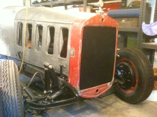

    The radiator shell is now good to go thanks to Scotch Brite and the miracle of mol***es.

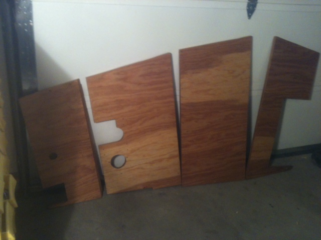

    The marine plywood floor pieces are now fully trimmed and varnished. Five coats.
