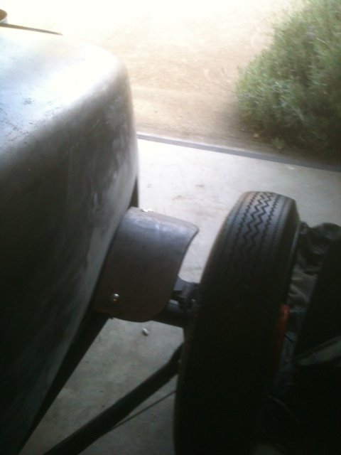

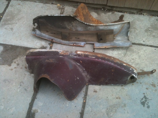

    Thanks for all the interest, everyone. Here’s a recent little problem-solving exercise you might like.
    As I said in my response to Volvobrynk last night, I’ll be running fenderless for a while. This introduces a visual problem, because the wide rear of Model A frame extends well outside the boat tail. Without fenders to hide them, the frame corners look awkward, and sort of kill the flow. Here’s what I’m talking about:
    The proper approach would be to pinch the frame, but that’s a bigger undertaking than I’m ready for. Right now I’m about getting the car on the road. Plus, the frame corners are a good spot to mount my taillights. So what to do?
    The solution presented itself at the Portland Swap Meet in the form of this 1936 humpback deck lid (a score at $10):
    After stripping and de-rusting, I butchered the thing:
    Then traced a template:
    And finally cut myself two matching covers for the frame:
    Installed it looks like this:
    And here’s how it looks mocked up with a taillight:
    OK, it’s not exactly stunning metal work. Nothing like, say, sectioning a ’54 DeSoto. ;) But I think it looks good and will serve until I’m ready for fenders. I like the rolled edges—much better than anything I could have hammered out with my shot bag and stump.
    Of course, in the final version, the light will be supported by something more elegant than the hockey puck seen here.

    Hmm... Honestly, I'm not sure how I feel about that frame cover but it works for now. I would probably think about something along the lines of a modified splash apron. A cut up 40's/50's truck cab corner could give you a rounded end cap for the rear of it, the side could be formed with some "body english" around a pipe. Just some food for thought.
    ClarkH likes this.

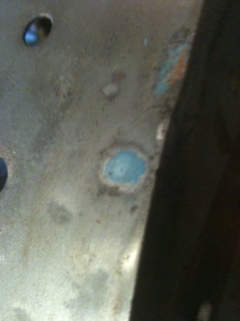

    Funny you should ask. Here's a picture of the last remaining flecks of blue paint, which I believe to be the original color. My wife's reply to your comment? "I look good in blue." So now it seems there are two color choices in the running, green and blue.

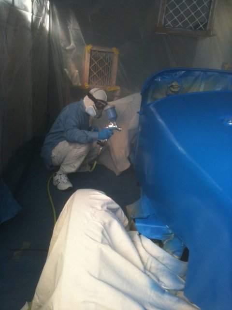

    Thanks for the positive comments, everyone. What you see here are the results of traditional DIY driveway painting. And there’s no way I could have pulled it off without the help of my good friend Steve, a professional painter who did cars for many years early in his career.
    Here’s the rest of the story on Operation Blue. I expect this will provide more than a few chuckles for the experienced, but I think there’s some useful information for people new to this.

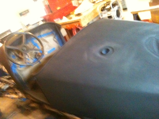

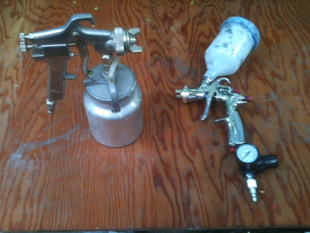

    My original plan was to run it in primer for a few years. Never having used a spray gun in my life, I used those 2K epoxy rattle cans where you pop a ****on to mix the activator with the paint. Thankfully, I knew from Hamb research that I needed to etch the metal first with Phosphoric. The 2K cans spray nice, and you apply them just like a spray gun in long overlapping stokes, not the rattle-can whoosh-it-everywhere approach—learned that the hard way.
    When I was done, I rolled it inside and just kind of stared at it for a while.
    Frankly, all I could say was, “Ugh!” The damn thing looked like a charcoal briquette.
    Try as I might, I was having a hard time imagining myself driving it that way for a couple years. And I was pretty sure my wife hated it, but was too nice to say so. Screw it, I decided. I’m going to paint it. It was another of those decisions where I didn’t quite know where the journey would take me, but I had 6 weeks of decent weather left to figure it out.
    So I ordered the paint (color chosen by my wife—no surprise there) and also a 10 gal/2hp air compressor. I got a brand called “California Quiet” that totally lives up to its name—no sense annoying the neighbors any more than I had to.

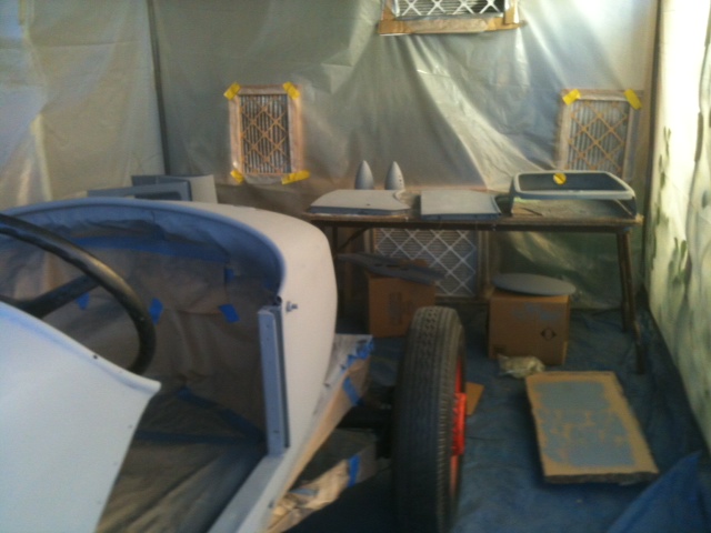

    While waiting for everything to arrive, I enclosed my carport in plastic and installed 2 box fans and 2 industrial blowers, shielded with furnace filters. I also poured over Hamb threads and Youtube videos. Finally the big day arrived, and I chose a few less important pieces for my first try at spray painting.
    Well, it was a disaster. I didn’t even take pictures, I was so disgusted. The old general-purpose spray gun I’d borrowed didn’t flow paint worth a ****, and even so, the compressor couldn’t keep up. The solution was a LVLP gun (low volume low pressure), which are expressly designed for use with smaller air compressors. Cost under $100 with a regulator, cleaning kit and extra tips and needles.
    Gun on left = bad. Gun on right = good.
    Steve came by and gave me a crash course in working with the gun, and also convinced me that when it came to primer I could sand my way out of most problems. It went great. I put down a nice thick coat of build primer and figured I had everything under control…

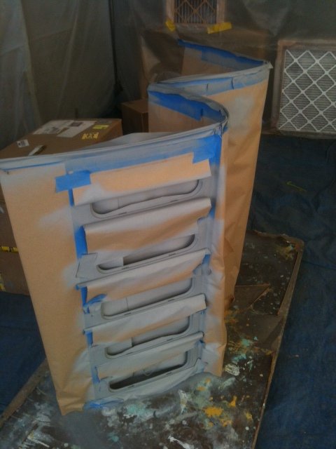

    ...that is, until I blocked it and discovered I had a long way to go. I wound up shooting three coats of build primer, and came to grips with the usual amateur issues along the way, such as…
    Unexpected low areas to fix:
    “You missed a spot…”: touchup:
    Checklist after checklist of stuff to deal with:

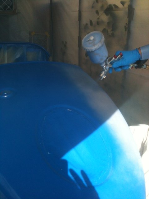

    Finally, the car was ready for color. And God love him, Steve took a day off to come over and shoot it for me. By now I knew damn well I did not have anywhere near the talent for a color coat. If it hadn’t been for Steve, I would have had to load everything on a trailer and take it to a pro.
    Remember when I said I figured I had six weeks of good weather to do this in? Well, I more than used them all up in education, rework and prep. By a miracle, we managed to grab the last 70-degree day of the year and took care of the body and parts in one extended session.
    That’s Steve in the pictures. He was amazing to watch in action. The guy is ambidextrous, shifting the gun from hand to hand as he works across the car. The gun never stopped except when he would pause at the end of a panel to check the reflection. He laid the third coat on so incredibly thick that I was cringing in fear of paint runs. Not a one.
    Here’s the final tally. We painted the car body and 20 separate parts. All told, each got a layer of epoxy sealer, three coats of build primer (one gallon), and three coats of color (one gallon). Seven weeks transpired from the day I decided to go for it until the day it was done. Toward the end of that time I was obsessed, sanding and painting in my sleep.
    I couldn’t be happier with the results. Sure, there are a few imperfections here and there, but nothing you wouldn’t expect from a 90-year-old metal car that spent 50 years in the bushes. Overall, it looks good.
    So there’s the story. And I still can’t believe it. She’s BLUE!
