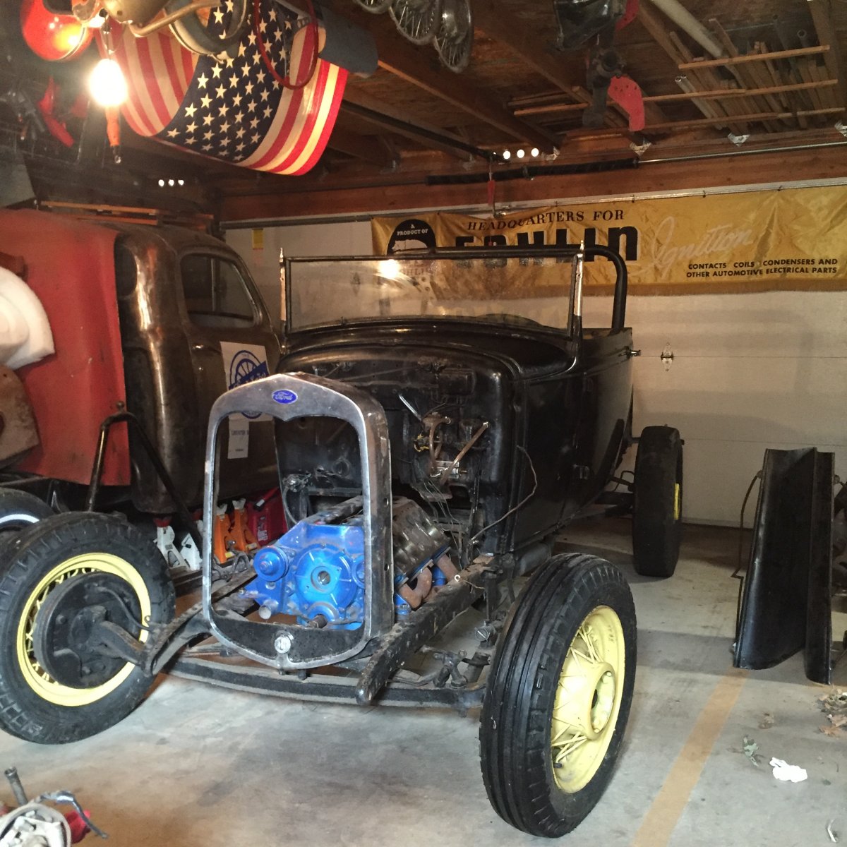

    Got the Coupster home this morning:

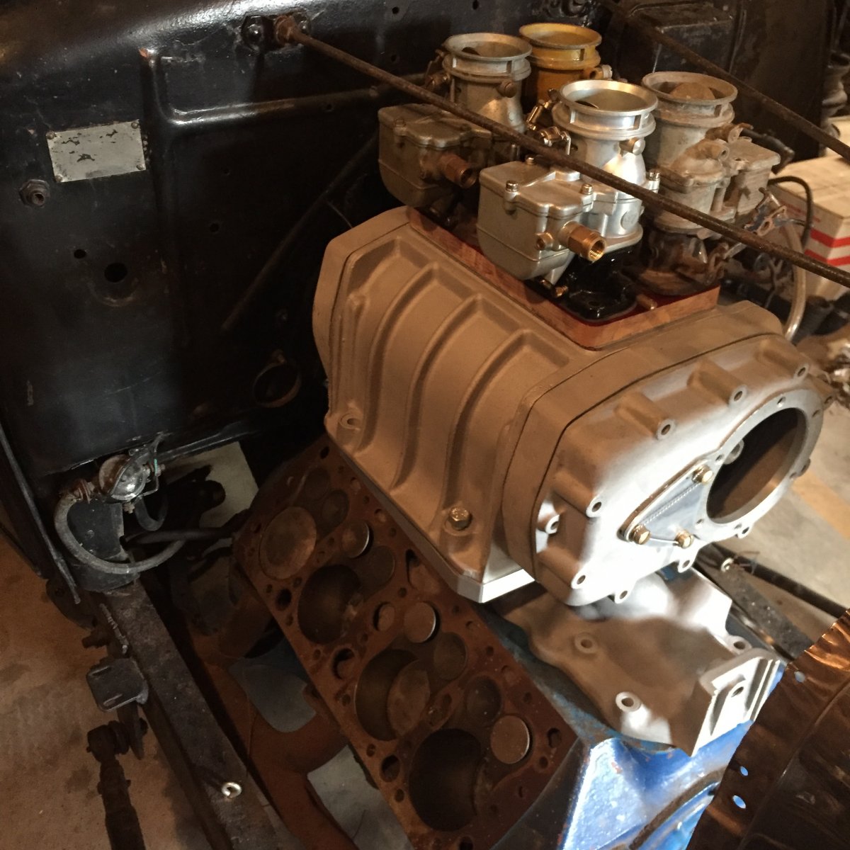

    And just for a laugh, I threw one of my other projects on top of the block, for a laugh, or not...

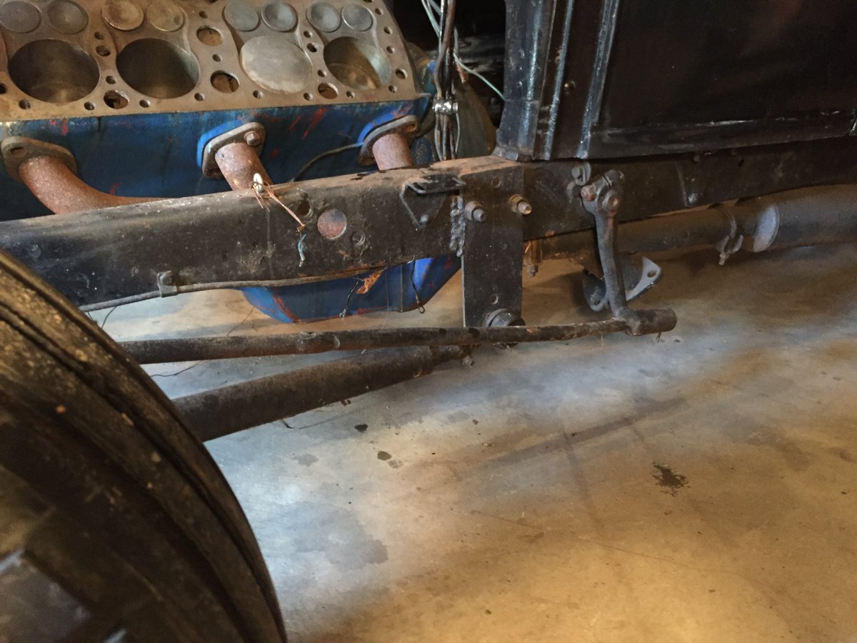

    The exhaust is Belond style tube headers feeding straight back into tubes that run to the rear of the car through a pair of "cute" little gl*** packs. Just under the cowl are big dumps with block-off plates.
    Street Roadster Cl*** rules (from the 1958 NHRA book) stated, "Must be equipped with mufflers suitable for street use. Headers, with a maximum of two head pipes per car, will be permitted, but exhaust system shall be so constructed that mufflers remain on car at all times. Header plugs or by-p***es may be open during compe***ion."

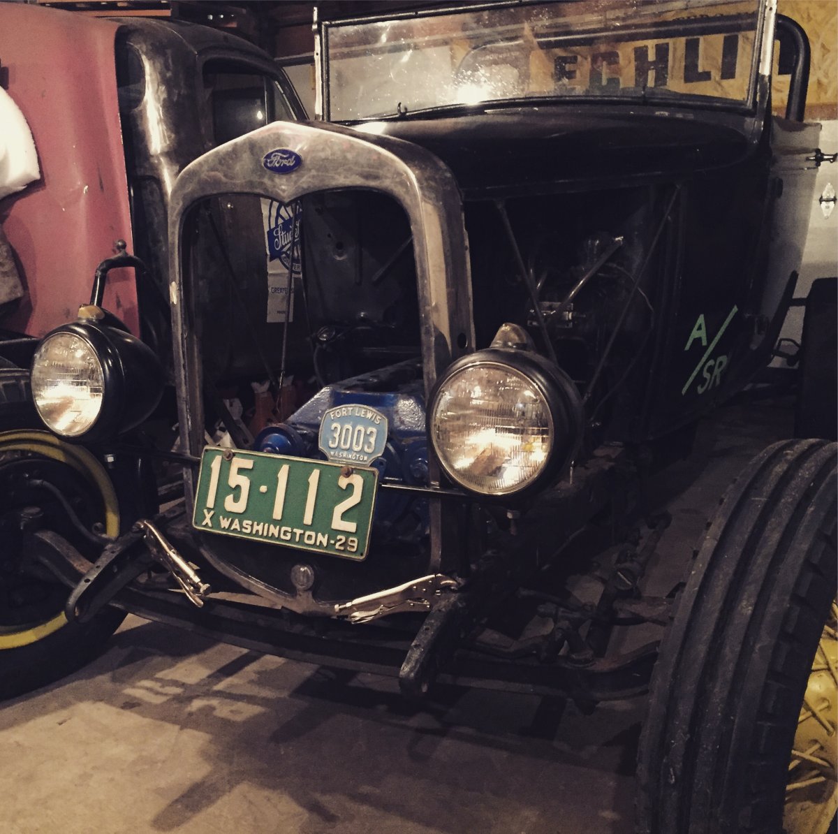

    Borrowed the headlights of my Tub, and threw the hood on for some mockup fun...
    ...not to worry guys. These headlights are far too big and early for the car. I'm on the hunt for some small King Bees and early aluminum stands.

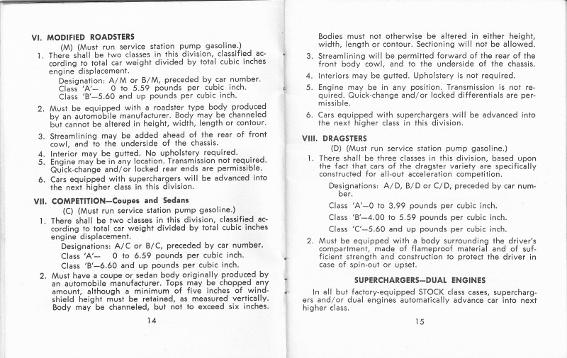

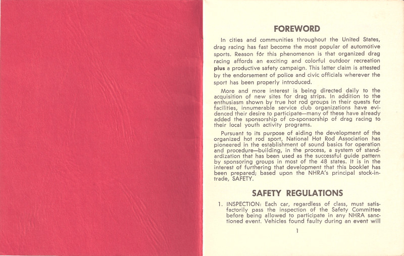

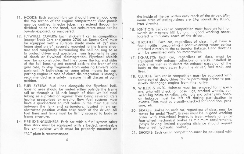

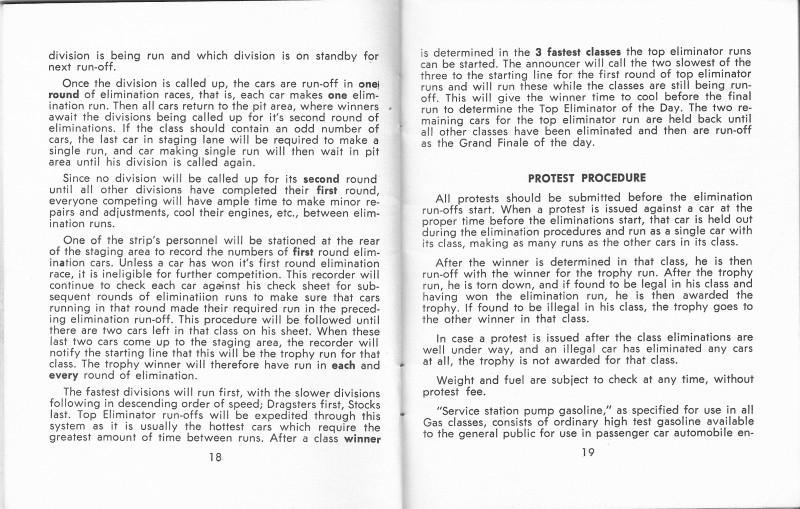

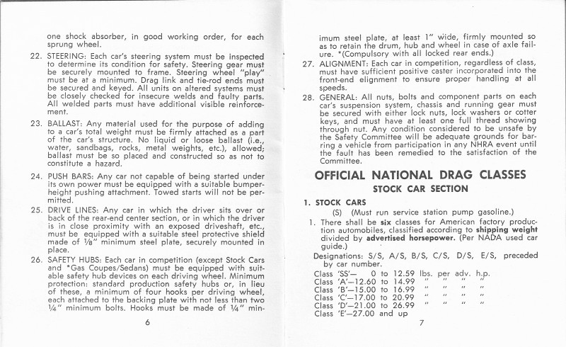

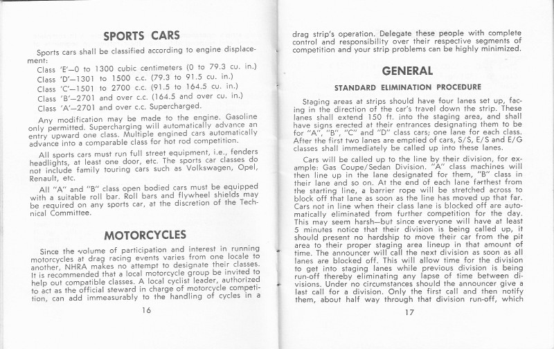

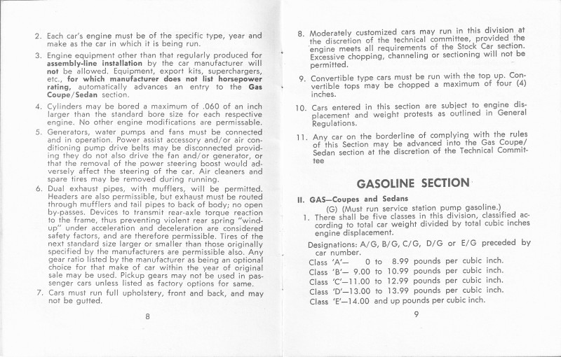

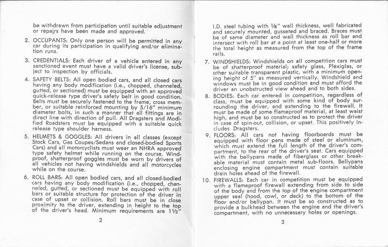

    Here's the 1958 NHRA rulebook:

    As you can see, the cl***es as most guys came to know them were really in their infancy in the mid '50s. Specifically to our case, there were only three cl***es where an open bodied car could run, Roadster, Modified Roadster, or Street Roadster, and in those cl***es there were far fewer engine cl***es. C/R, C/SR, or any other Flathead/Inline specific cl***es didn't show up until 1960.
