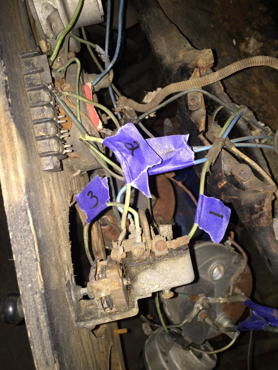

    Today's other big push was to get the dash pulled, and behind it all cleaned out.
    After seeing all the former seat padding packed in the old gas tank, I was expecting some interesting finds, and I was not disappointed. Behold, the Coupster's previous owner...
    The previous resident was less than kind to the wiring and wood dash panel, both of which must have been tasty.
    So, I tagged and bagged everything back there, just to be safe...

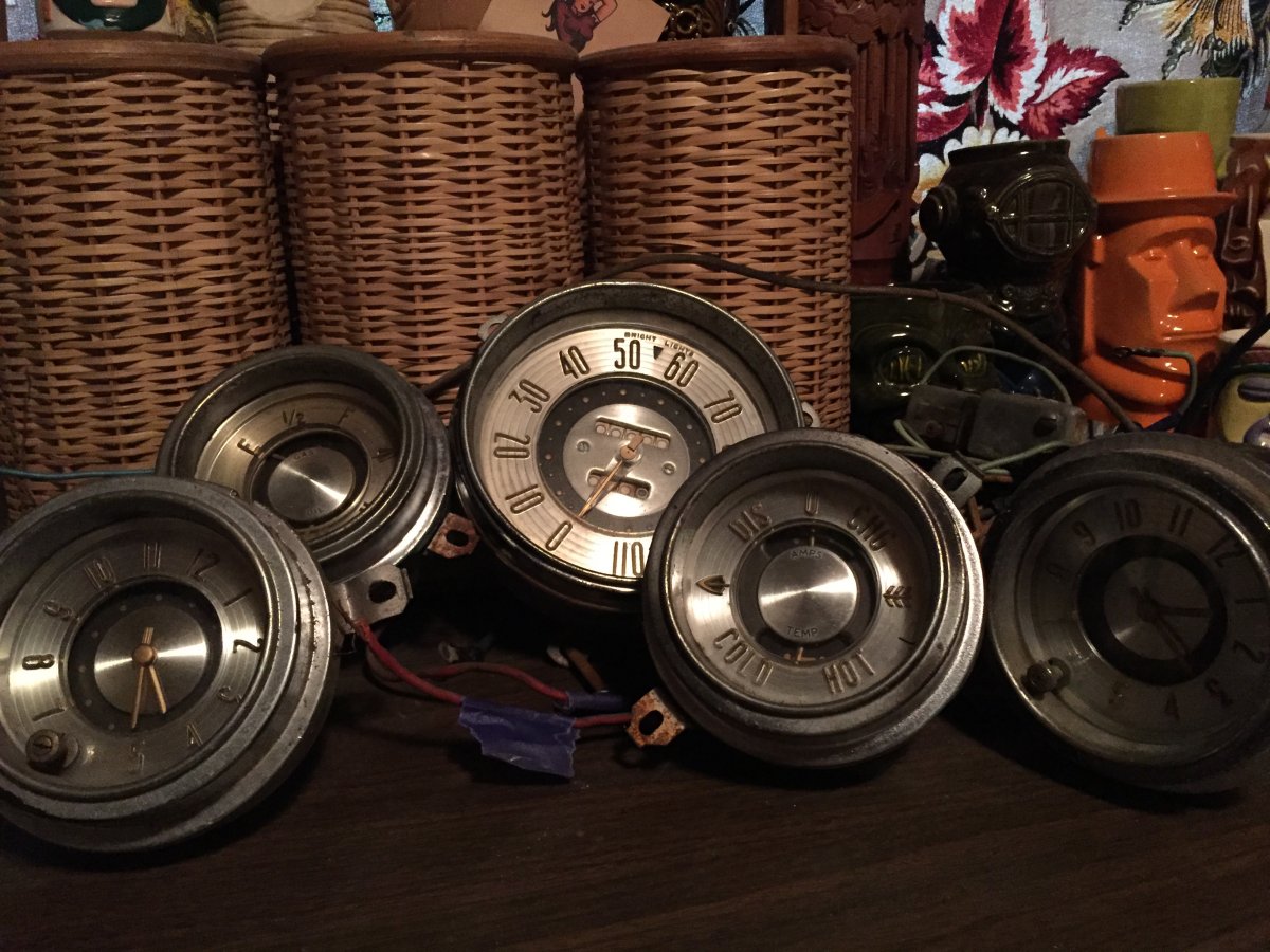

    ...and extracted the set of 1949 Buick gauges:
    While I remake the tonneau cover, I'll be making a new dash panel before putting everything back where it came from, but with fresh wiring.

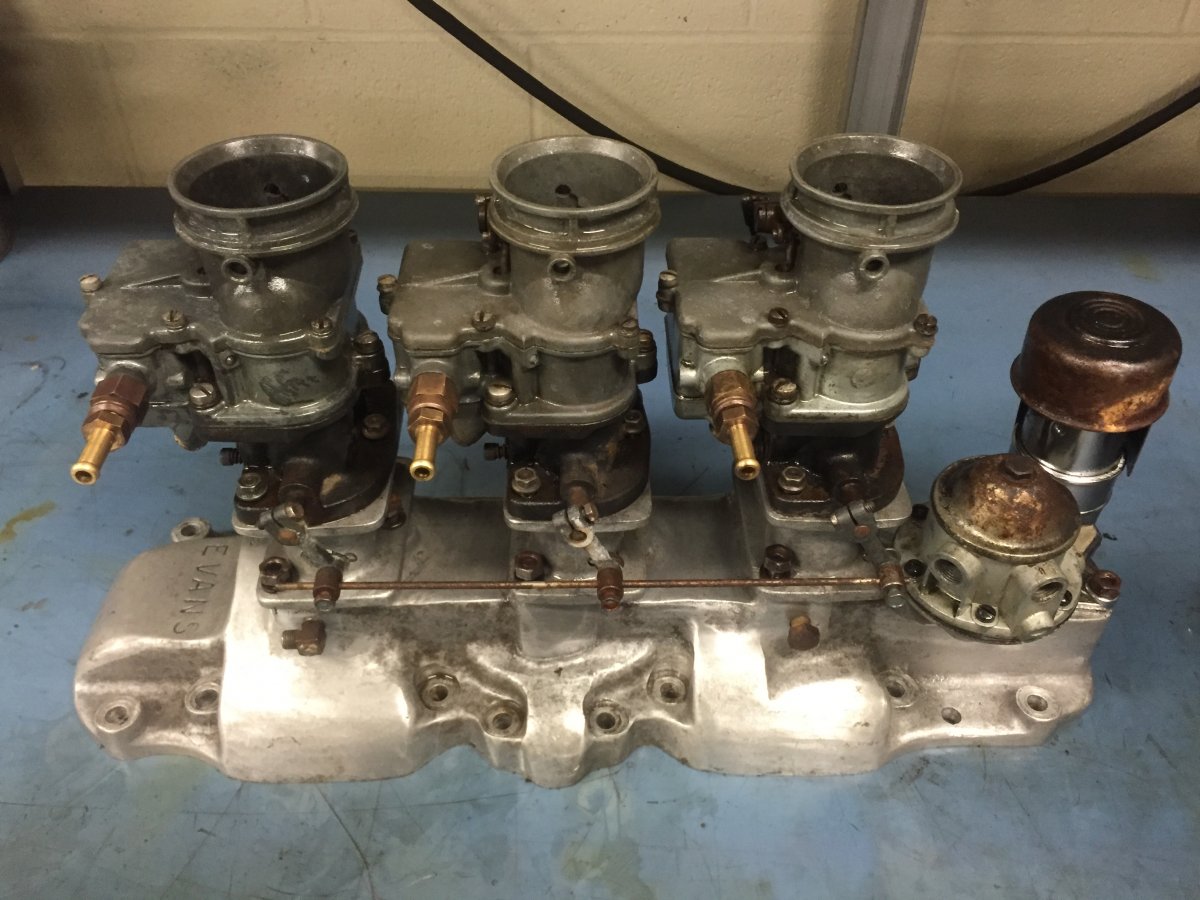

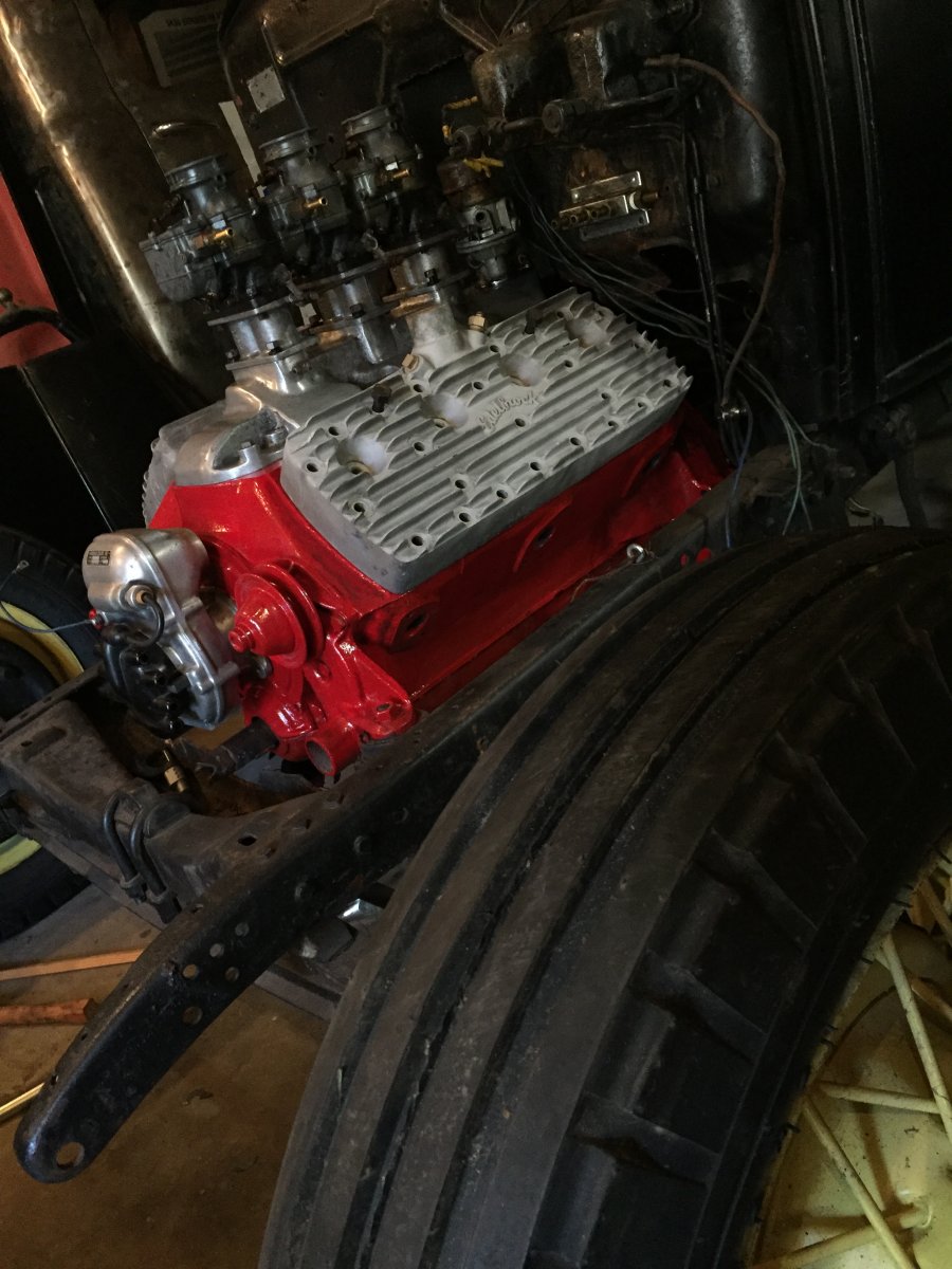

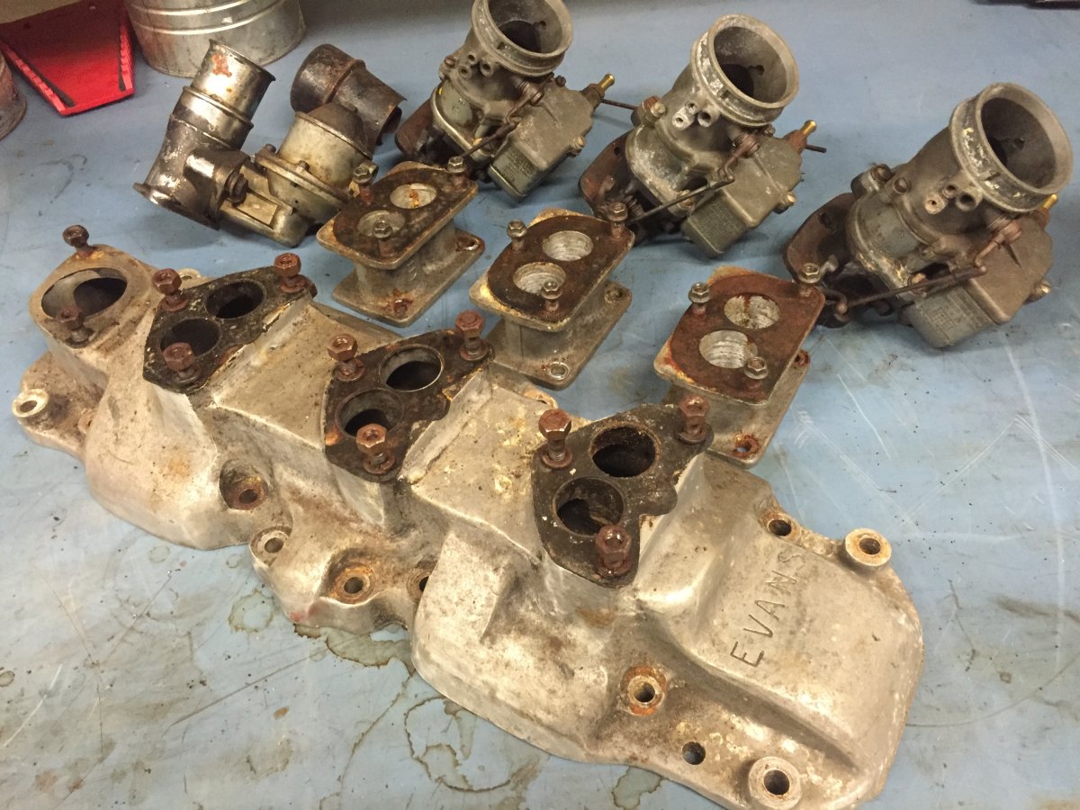

    Tore down the original induction...
    ...and put it back together again...
    The Evans three pot manifold, Offenhauser risers, Stromberg 48s, and the fuel pump spent a day in the ultrasonic cleaner. Got most of the big stuff clean without making everything look brand new, just what I am going for.
    And while I'm waiting for some carb and fuel pump rebuild kits, I hung everything on the motor for a little mockup:
    I'm just a cam, and the aforementioned rebuild kits away from breaking in what should be one pissed off little flat motor.

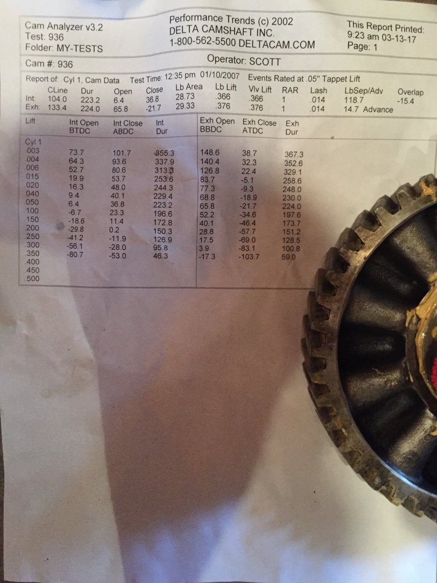

    And, speaking of cams, rather than use the blower/alky bump stick that was in this shortblock, I've decided to run a Potvin Climax. Provided that I can get someone to grind one for me.
    Marshall ended up with several Potvin Eliminator cams from the same source as this car, so I can ***ume that the previous owner liked Potvin's offerings. And I can say that I do too. The .425 lift of the Eliminator might be a little too much for the valve pockets on this motor, so it's slightly littler brother should do the trick.

    I ordered my Potvin Climax cam today. 284-duration and .400" lift should make for a fun ride.

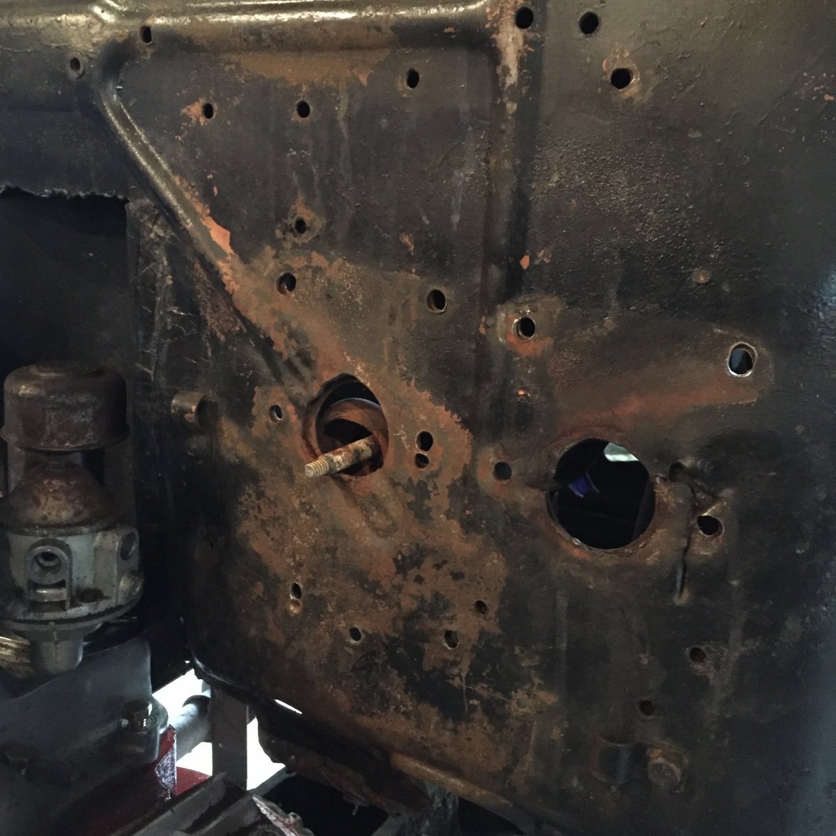

    While I wait for that and the few other engine parts needed, I decided to start tackling the more mundane mechanicals, starting with the brakes and hydraulic clutch. Behold, the 1950s "quality" firewall mounting...
    If it doesn't fit, just drill another hole. At least they put a doubling plate on the backside.

    rob-redm
    looks like they did a fine job...

    I put up another thread specifically to try and figure out that cam. @Bored&Stroked chimed in there, but we can bring that conversation back to this thread...
    I am having Schneider Racing Cams grind me up a Potvin Climax on a new billet, as Delta didn't have what I needed. I'm just playing the waiting game on that one.

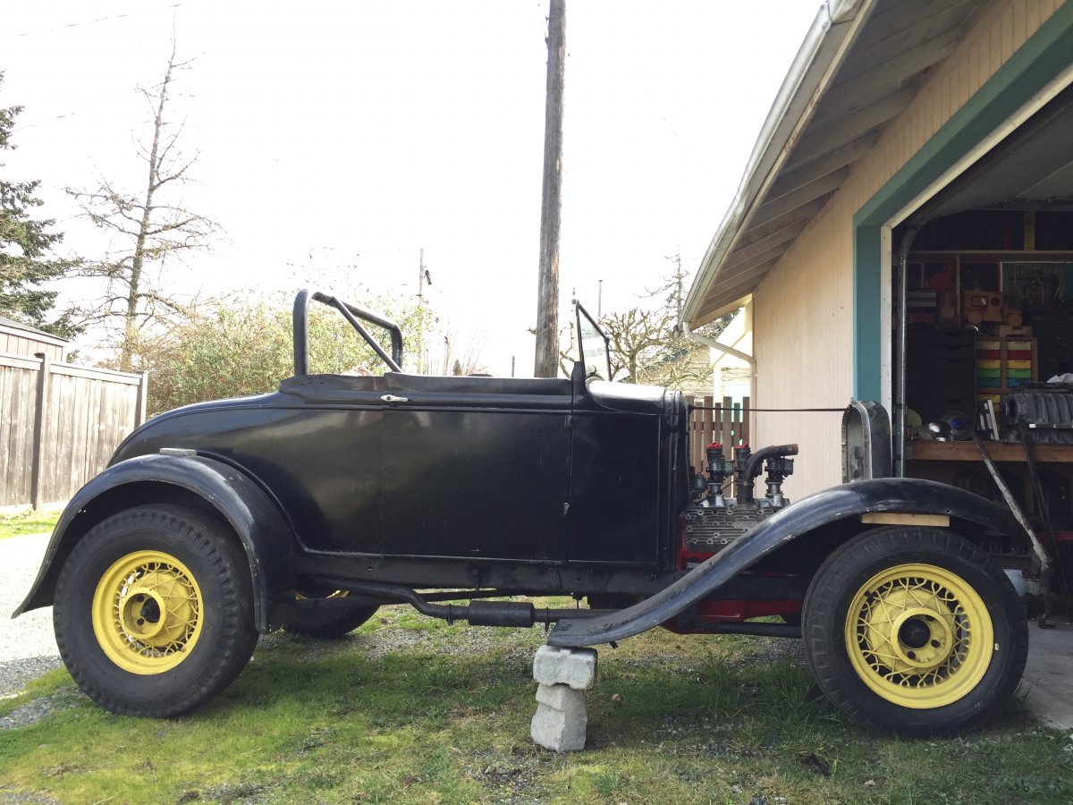

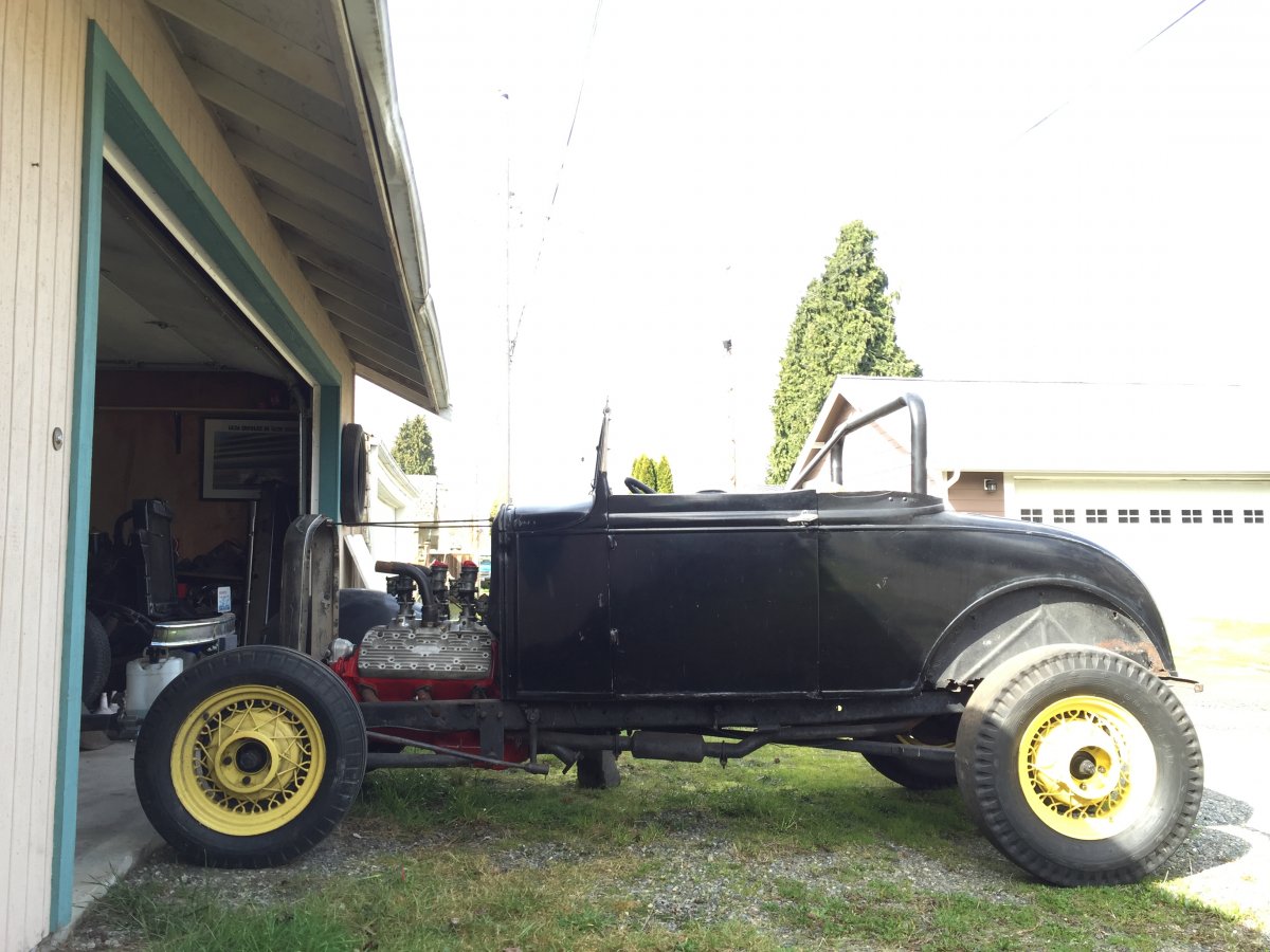

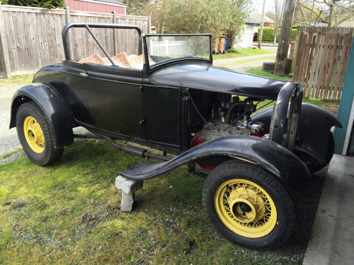

    Instead of actually getting something productive done, I decided to take advantage of a rare sunny morning and roll the Coupster out of the garage for some mockup fun.
    No fenders...
    With fenders...
    And with every piece of tin that the car came with (except the aprons)...

    Now comes the big question: fenders, no fenders, bobbed, other?
    I think for now, I'm going to proceed as if I'm putting the original fenders back on it. I haven't figured out running boards or aprons yet, as the braces were torched off, presumably a LONG time ago. Maybe it ran with or without for SR, or R cl***es respectively.
    Failing the full fendered outcome, I have put together this set of previously bobbed rears and cycle fenders for the front...
    Seems to me that this would be the next logical progression of the car, had it continued racing. It will also give me the option of making the car 'mine' without actually changing anything original to the car. And I love the bobbed look.
    So, maybe instead of choosing one path, I give myself three options...

    Thank you Evan for letting me come take a peek at the Coupster today... I vote full fender, but you have some other great choices... Yes it was crudely built, but was well thought out . it's race car plain and simple and wasn't built to be a beauty queen ... Can't wait to see this on the road again... doing what it was built for. Drag Racing !
  26. loudbang
    Posts: 40,346
    One more vote for full fendered

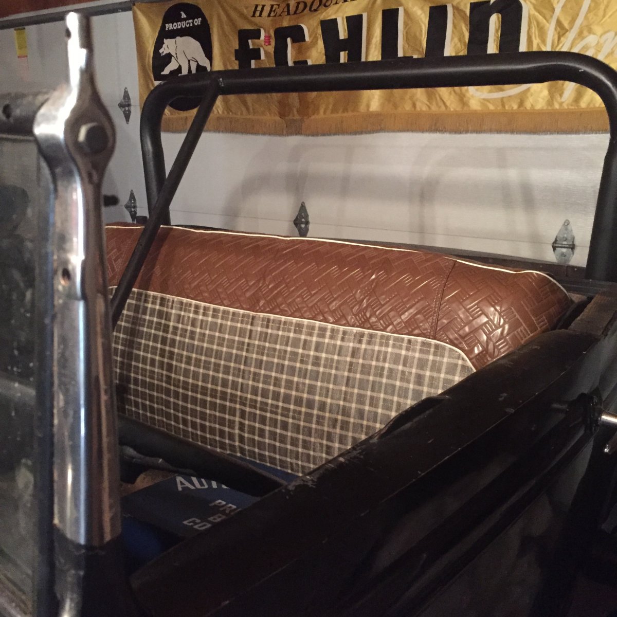

    Mamma needed me to run interference with the kids today, so no garage time. Instead, I set up shop in the dining room to get the upholstery work started.
    Here's one of my helpers:
    And the eventual result:
    I only got the seat back done, as you can't expect much more while also wrangling a two and a half year old and a seven month old. That, and I still need a good seat bottom spring. Small victories, right?

    Dean Lowe
    If it were mine, and I had the bobbed rear fenders, no question, I would set it up like this.
