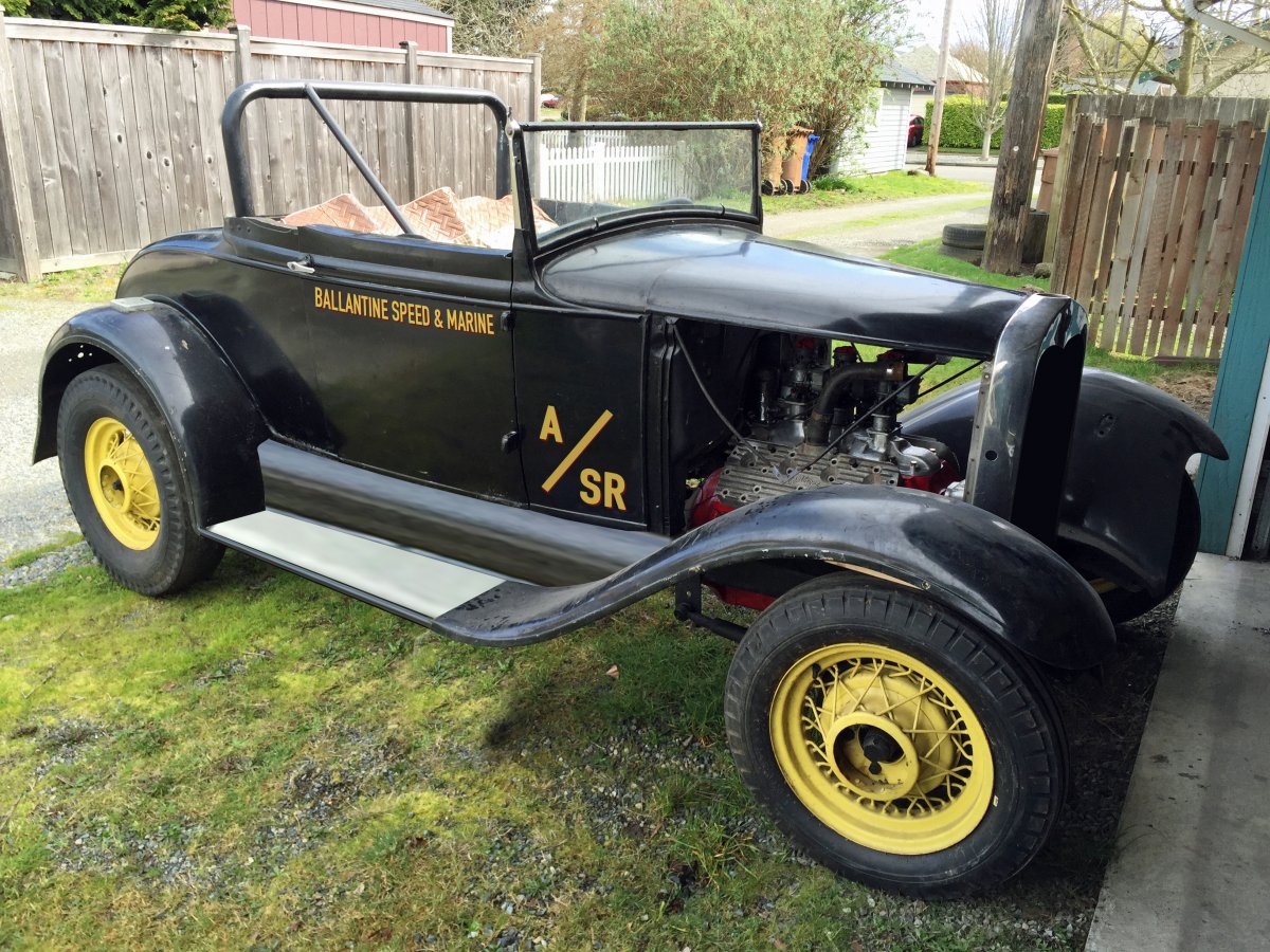

  1. Kind of hard to tell from the photos but I think that in addition to the very desirable KH wires you also have a 32 heavy axle.
    If I was you I think I would clean it up mechanically and run bobbed fenders on the back only per SCTA Bonneville rules. I would also get it registered for the street. The only thing that is incomparable is the rubber and possibly the cam.

    Yes @Bib Overalls it does have a '32 heavy axle. Uses Model A perch pins and 1937-40 Spindles.

    Little photoshop addition of aprons, boards, and lettering...
    ...like i said before, I am going to move toward full fendered, but with a stop on the bobbed route along the way.

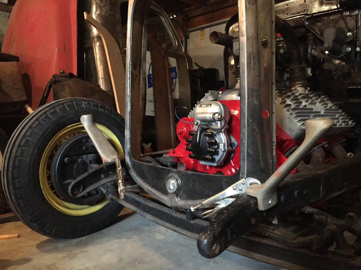

    bobbed roof I say bobbed fenders..... judging from the time period I would guess they ran the cycle fenders and a set of kingbee headlights ...any evidence on the front backing plates of the cycle fender brackets?

    No evidence of ever having cycle fenders up front. There are some brackets on the rear that lead me to believe that if they weren't running bobbed rears, they were at least planning to.
    There are some extra holes in the front frame rails that almost line up with the mounting holes on some early cast aluminum headlight brackets that I have (not from this car).
    The fact that the running board brackets were torched off, and then the area was painted over, lends credence to the fact that they intended to run bobbled or fenderless. But, this like the roll-bar/tonneau conflict may have been one more thing that went unfinished in the final iteration of the car before storage.

    Here's the headlight stands that I have squirreled away...
    ...which may or may not make it onto this car.

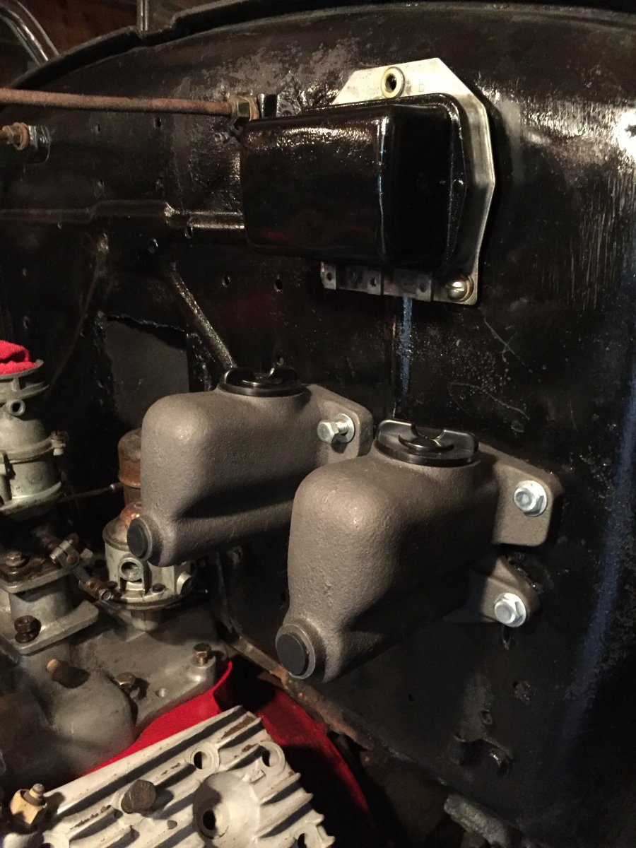

    On to more functional business, I got the original voltage regulator cleaned up, new master cylinders in the mail, and cleaned up the firewall in its brush-painted glory...
    I still have some shimming to do to the master cylinders to get them sitting right before plumbing them in. Also, I'm trying to find original style metal caps for them.

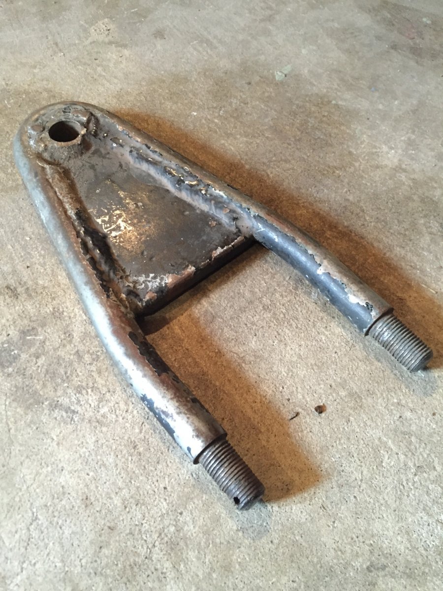

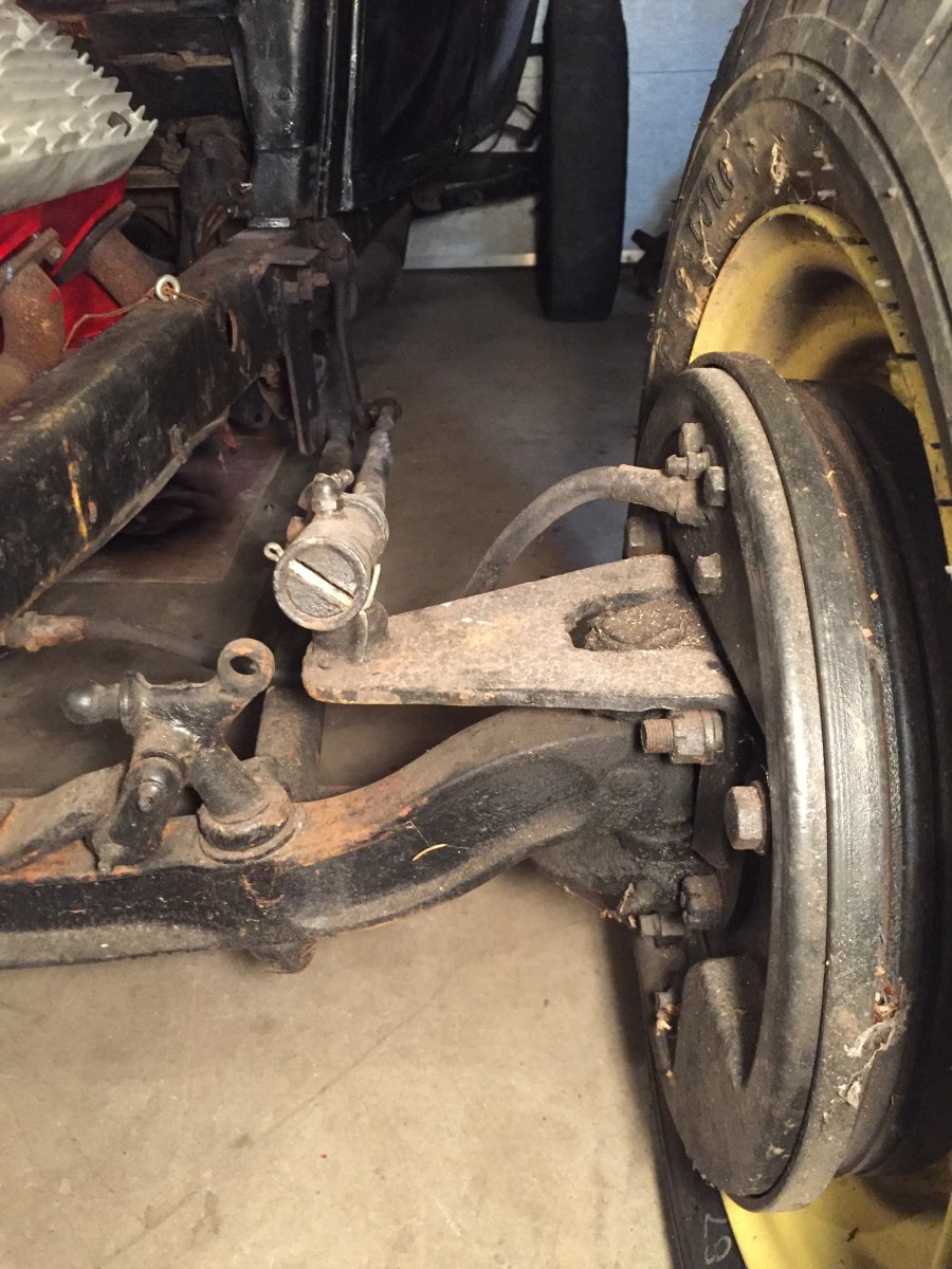

    And then we come to the front end. Specifically, getting the wheels turning before a full turn of the wheel. Step one is rebuilding the drag link which has more slop than a cafeteria sloppy joe...
    And since the well worn ball on the steering arm was welded on, I needed to find a more fixable solution. Enter this old arm...
    Okay, okay. It's not the original but it is an old one, made with a stick welder, and it was painted black at one time. It fits the bill for me, and uses a standard tapered-seat ball. Now, if only I could find my balls...

    wonder if you'll be able to put the link under instead of on top with the new one so it's not on such an angle...you can just see the spring in that picture I didn't realize it was riding right on the axle I bet a reverse eye spring could be thrown on as a necessary concession to prevent wear on your axle

  12. Hitchhiker
    Joined: May 1, 2008
    Posts: 8,507
    Hitchhiker
    I think he'll have to cut on the perch pin if he does that. At least I did on my pickup. Though I have a dropped axle, etc.

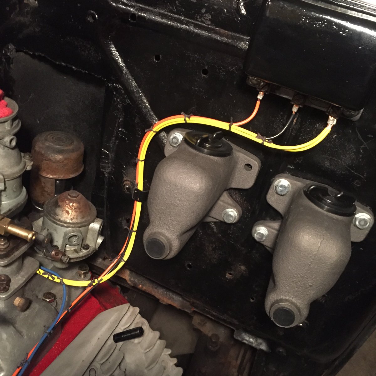

    Chugging along, a little at a time. One deviation from the original 1950s 'quality' is going to be tidy wiring...
    ...it's just one of those things that drives me crazy.

    looks nice, but the wiring is so bright & shiney and new.. LOL... should have gave you the old wiring harness from the 51 Woodie... HA HA ! @Rainier******

    They do kinda stand out, don't they? As an aircraft mechanic, there are just some things I can't abide by. Untidy, wires is one of them. Restraint is really hard.
    I was real close to going with cloth-wrapped wire, but since the original stuff was plastic insulated, I figured tat I'd stick with it. After a few sessions of oil fumes and outside running, I'm sure they'll subdue some...

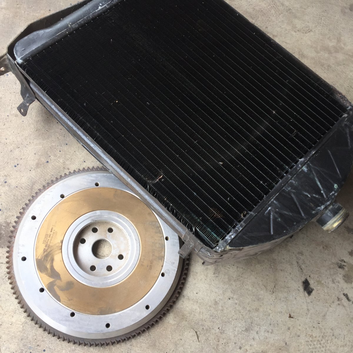

    Since I will be in certification cl***es this weekend, and I can't go to the Portland swap, I blew some cash today...
    Got a good '30/31 radiator that has already been converted to flathead V8 outlets and inlets, because I needed one. And I got an NOS Schiefer/Albro flywheel, because why the hell not.

    The metal caps on those 50s Ford master cylinders are really bad to corrode and seize into place. Having been thru that myself, I'd stick with plastic. Go thru an old Ford salvage yard and you will see that most of those master cylinders have a stuck metal cap, ruined with the middle twisted out of it and the cap still in place.

    I ended up with a couple NOS caps that are now on the car. It will be a 90% dedicated track car, and it will be living inside, so I am not worried too much about corrosion.
