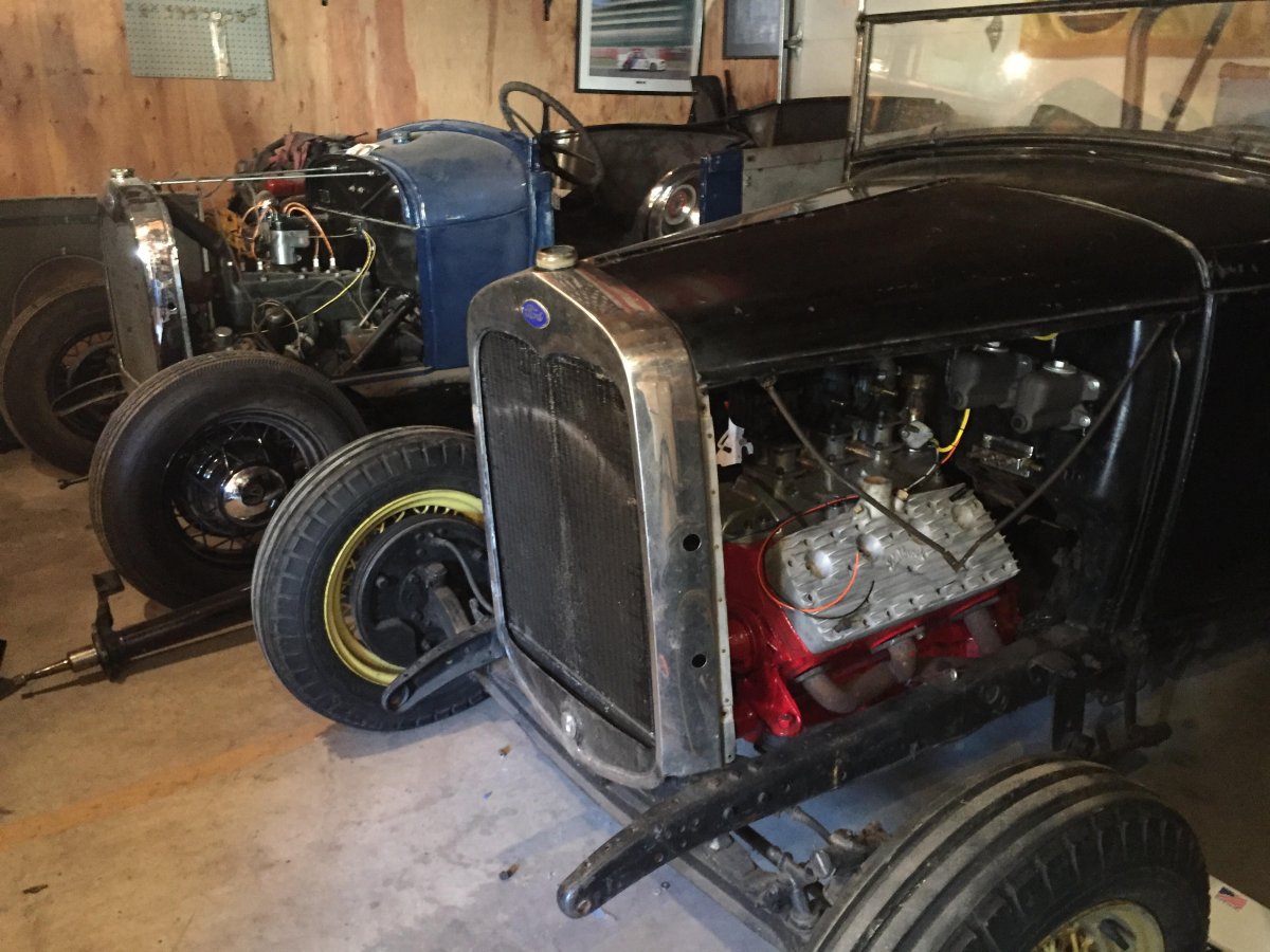

    No real progress, work, school, and the family have ben taking up most of my time lately. And I'm still waiting on that cam. I did manage to re-arange the garage yesterday. Now both my Model A projects are side by side and much more accessible...

    I see a fuel block mounted on the fire wall.:D and correct brake fluid resv. caps... nice.... were is the truck hiding at ? @Rainier******

    I swapped spots between the Phaeton and the Truck @rob-redm it's just out of frame to the left.
    The Fuel block is the original Segal one, cleaned up and re-mounted.
    I got my engine hoist back from the friend that was borrowing it, so once I get a spare hour or two, I'll be yanking the engine and ******. It'll get a fresh '39 box with '41 guts, the Albro flywheel, and a new clutch n' pressure plate. Then plumbing, while I wait for that damn camshaft...

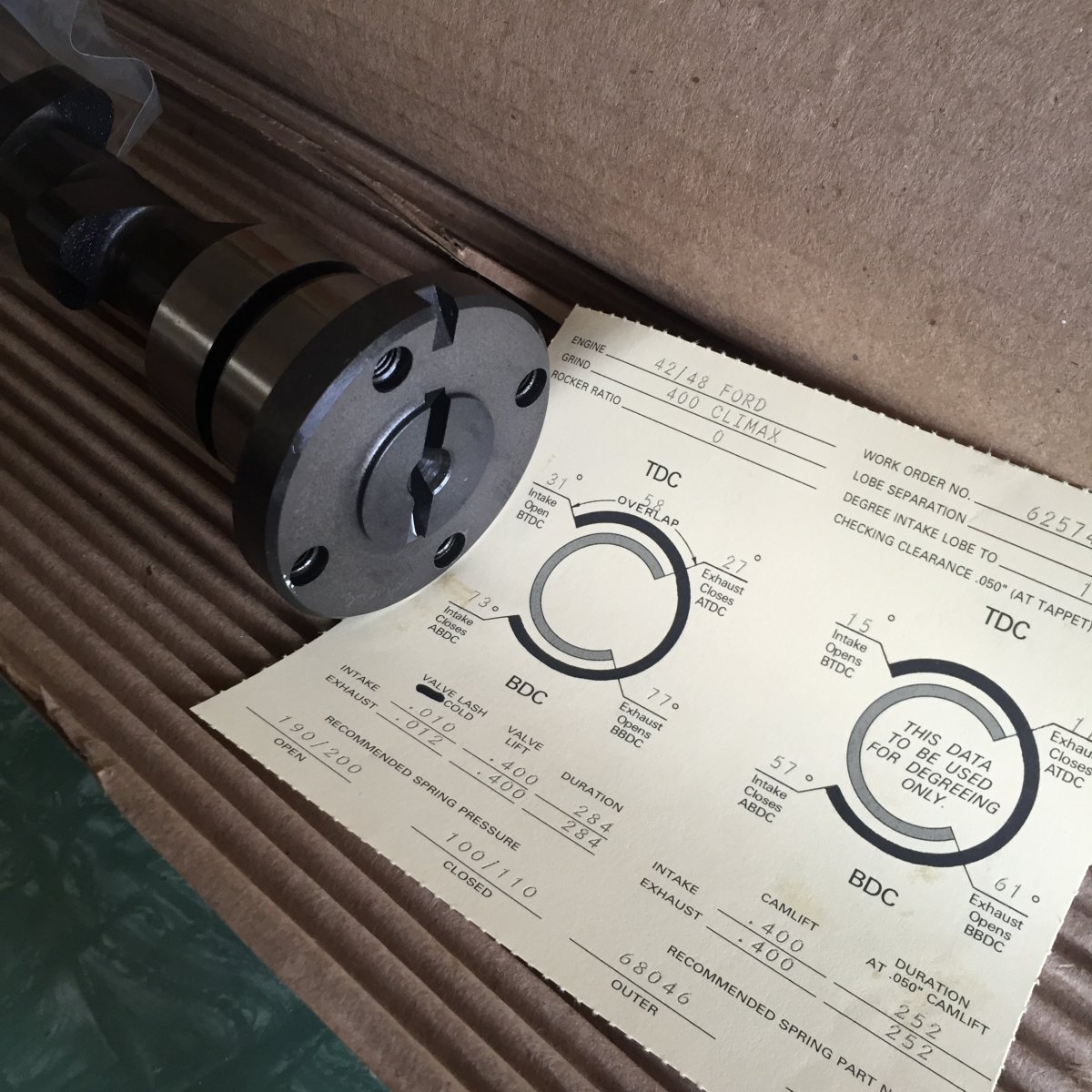

    Well, the wait is over...
    This little bump-stick was waiting on my porch today. New cam billet ground by Schneider Racing Cams of San Diego.
    Potvin 400 "Climax" Advertized Duration: 284* Intake 284* Exhaust, Duration @ .050": 252* Intake 252* Exhaust, Lift: .400" Intake and Exhaust, Overlap: 52*, Lobe Separation: 113*
    Should be a wicked little cam. The guys at Schneider were adamant that this is NOT a street cam, and said that this was the first new one of this grind that they had done in at least 30 years. The delay was claimed to be from a damaged master that had to be re-done.
    Now there's no excuses but mine to get this little mill fired in anger...

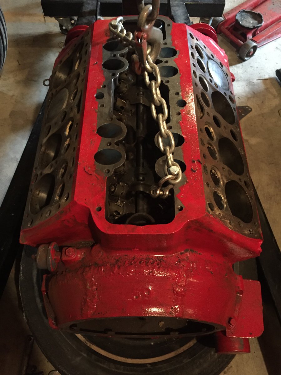

    Engine's back out...
    Thrash is imminent.

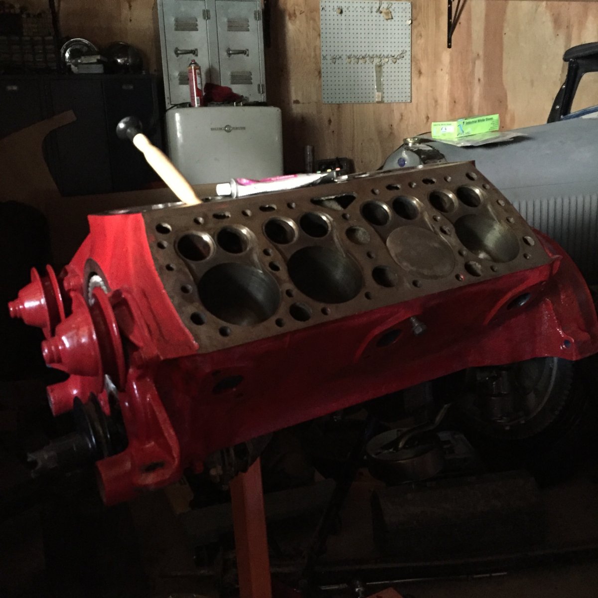

    Getting closer. The bottom end has been blown apart, and re-***embled...

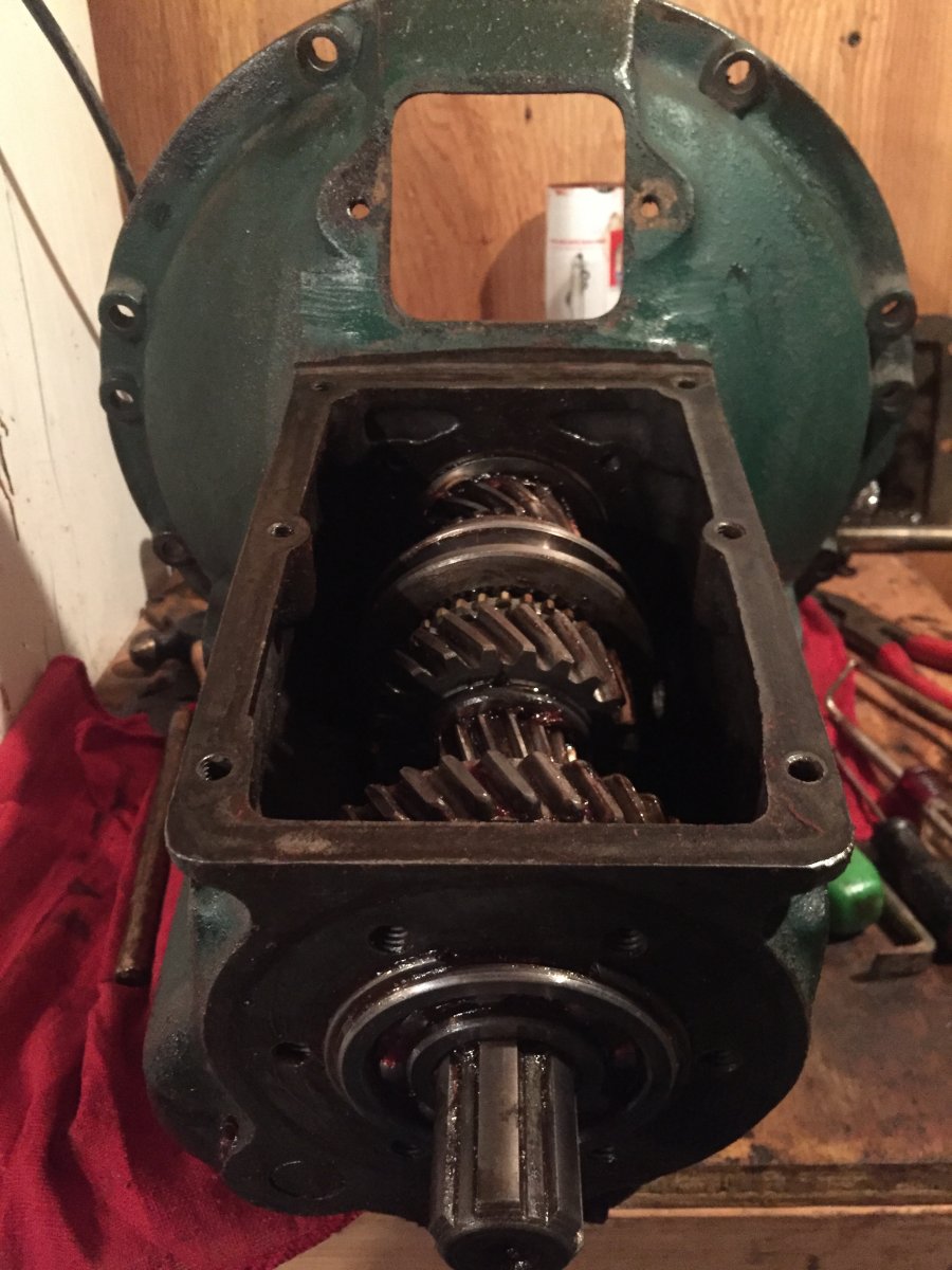

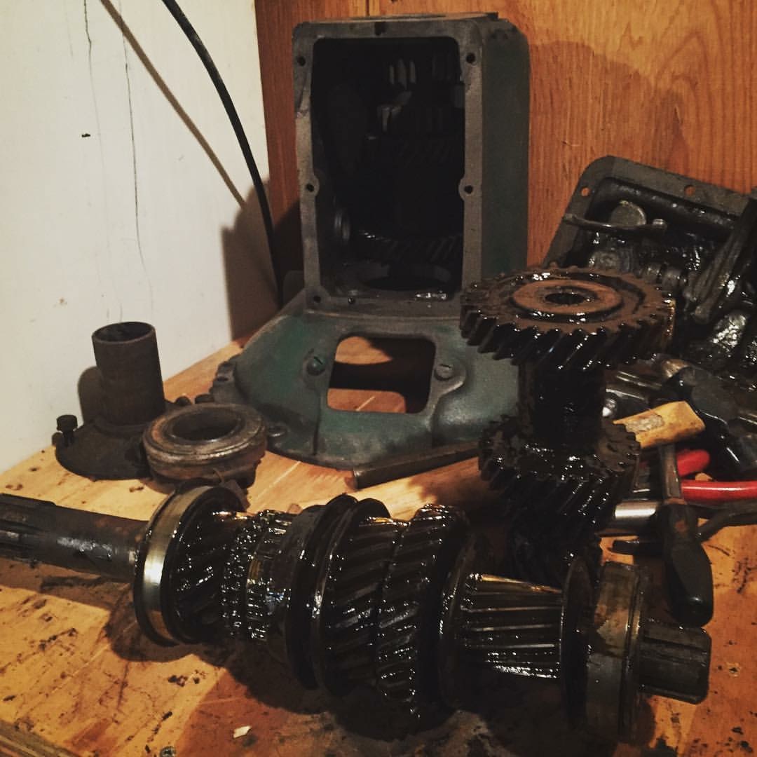

    And to replace the Coupster's original waterlogged '39 box, I pulled all the guts out of a '42 side-shift, and shoved them into a good '39 case...
    Now I just gotta get the valve train built and installed, put together the top of the motor, get the clutch and pressure plate installed (I'm waiting on new bolts), marry the engine and ******, and throw the whole mill back in between the frame rails. Then it's cam break-in time...

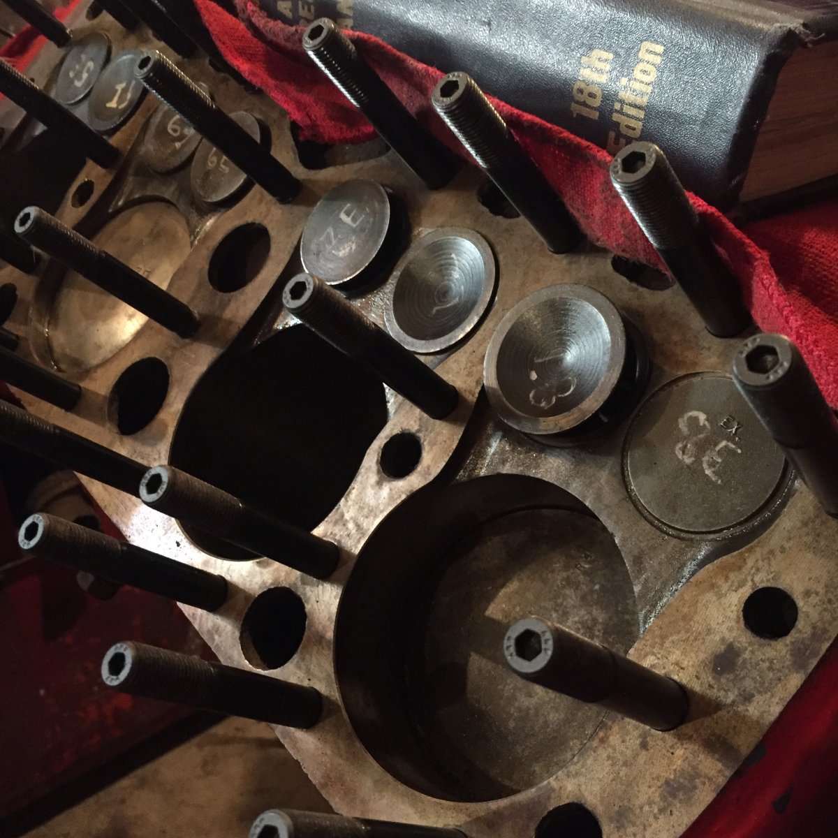

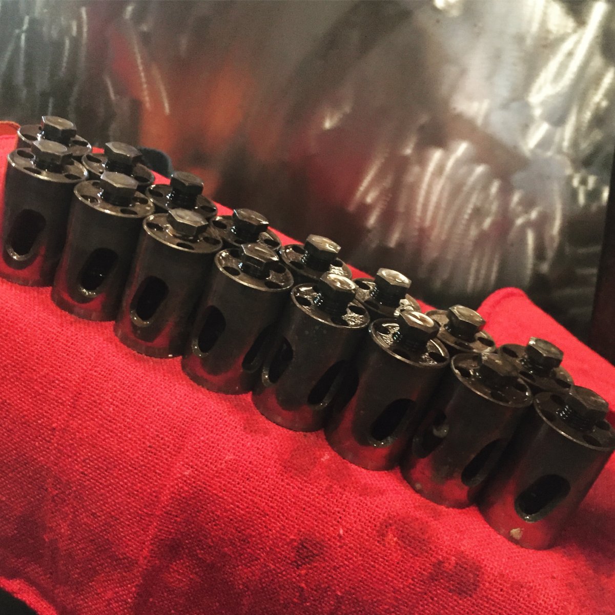

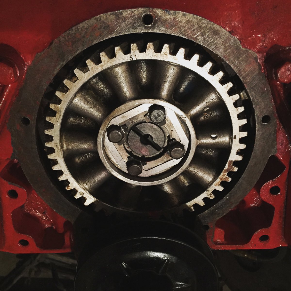

    The cam is in...
    And I cleaned up the original Johnson lifters that came out of this block. They've never been run...

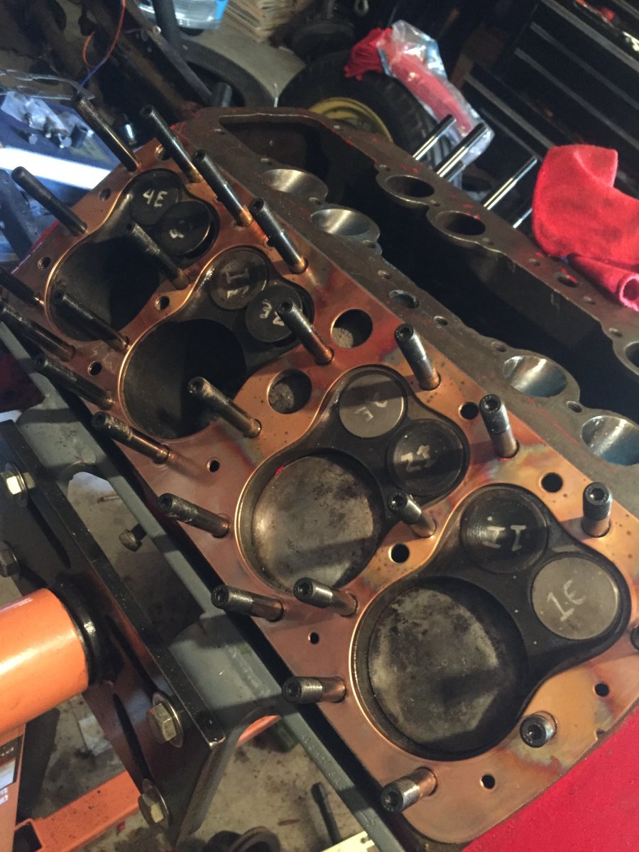

    Chugging along. Making those valve seats shine...

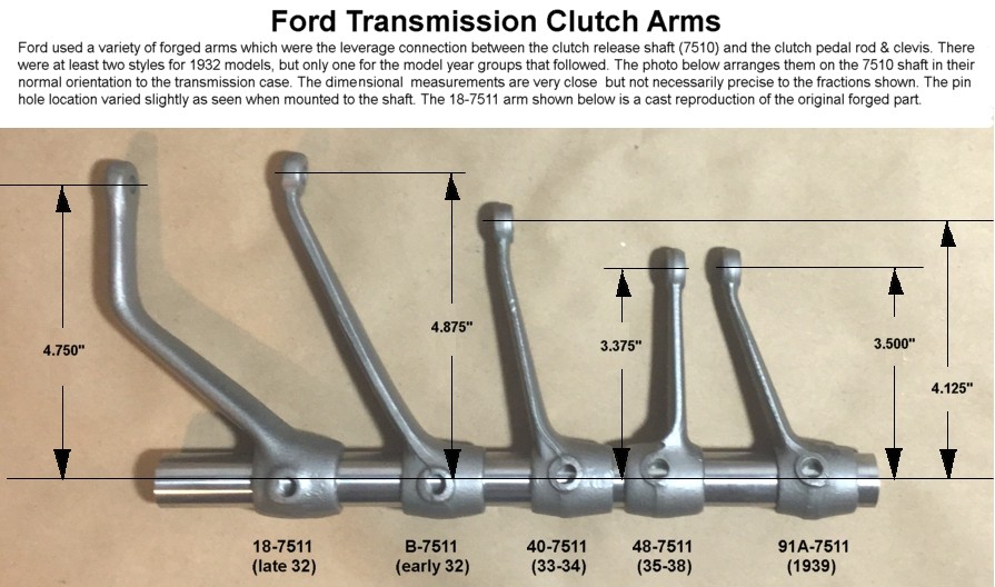

    How is the hydraulic clutch leverage done in this? Does the gearbox have the rotative arm in it or a fork type arm? I'd like to see some pictures if it has rotative type arm..
  15. Wicked thread, thanks Rainier******
  16. RainierHooker
    Joined: Dec 20, 2011
    Posts: 2,031
    RainierHooker
    from Tacoma, WA
    It's all apart right now, but I'll try to explain, until I can get pictures...
    It uses a 1932 lever-type clutch arm with a pushrod coming off of it and going strait back to the slave cylinder that is mounted on the transmission crossmember.
    This picture showing the different clutch arms is from Van Pelt Sales:

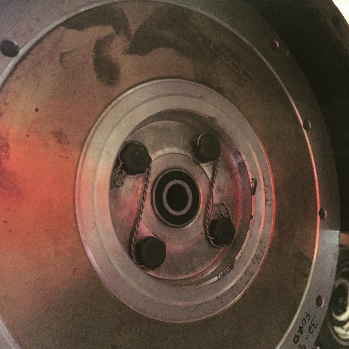

    More progress on the engine. The Schiefer AlBro flywheel is in and safetied...

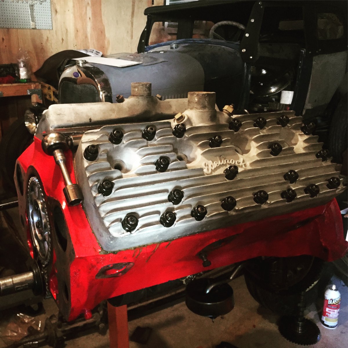

    ARP studs...
    Initial timing set at 24-degrees for the Harman Collins Mag...
    Copper Head Gaskets...
    And where I got before my camera ran out of battery...

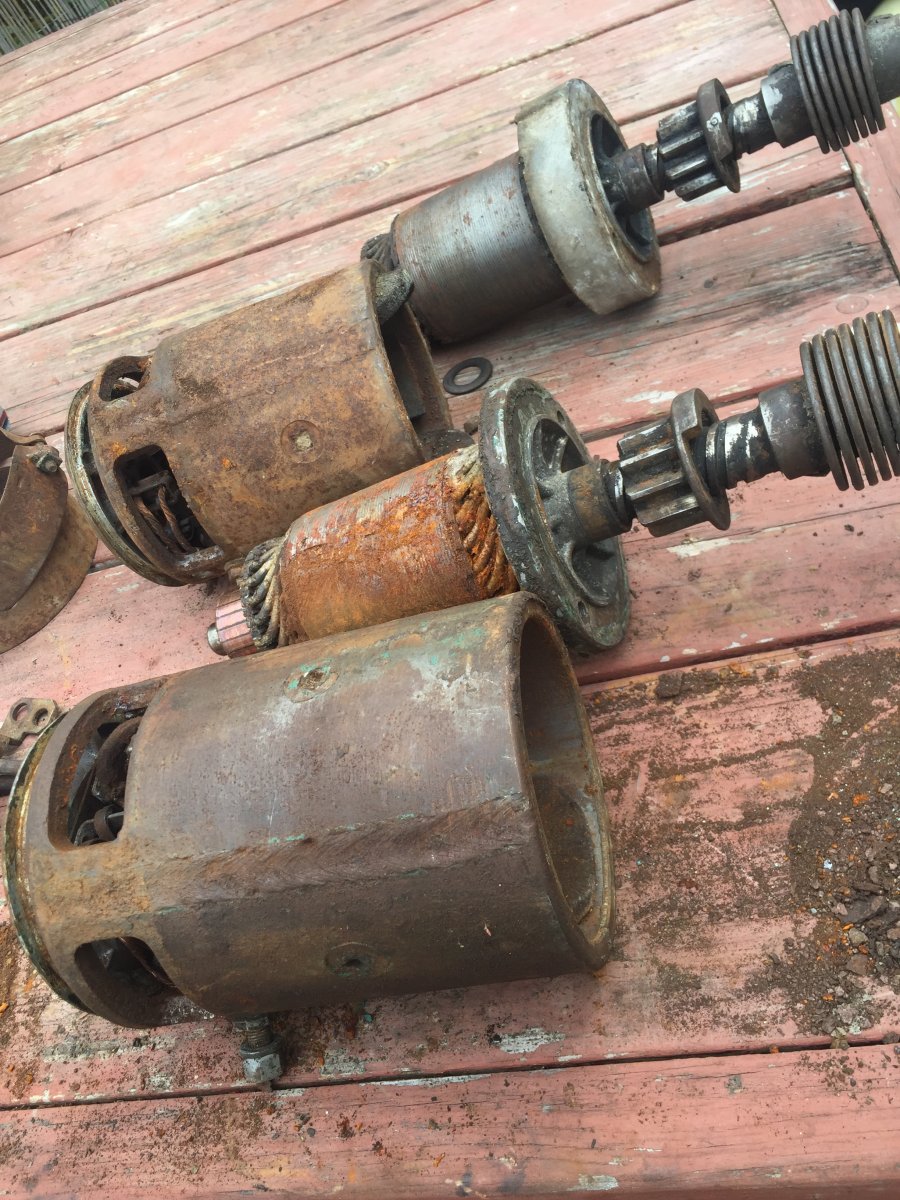

    Bottom end is all together. Heads are on and torqued. Water pumps are back on and the Mag is mechanically timed. Just gotta throw the pan back on, mount the pressure plate, clutch, and ******. And make one good starter out of these two...
    ...then we should be ready to make some noise.

    After my last post, I needed a few small bits in order to ****on up the transmission build. I ended up buying a package-deal of Early Ford transmissions and transmission parts...
    ...with all the parts, I ****oned up the ******, bolted it to the motor and dropped it back in-between the frame rails
