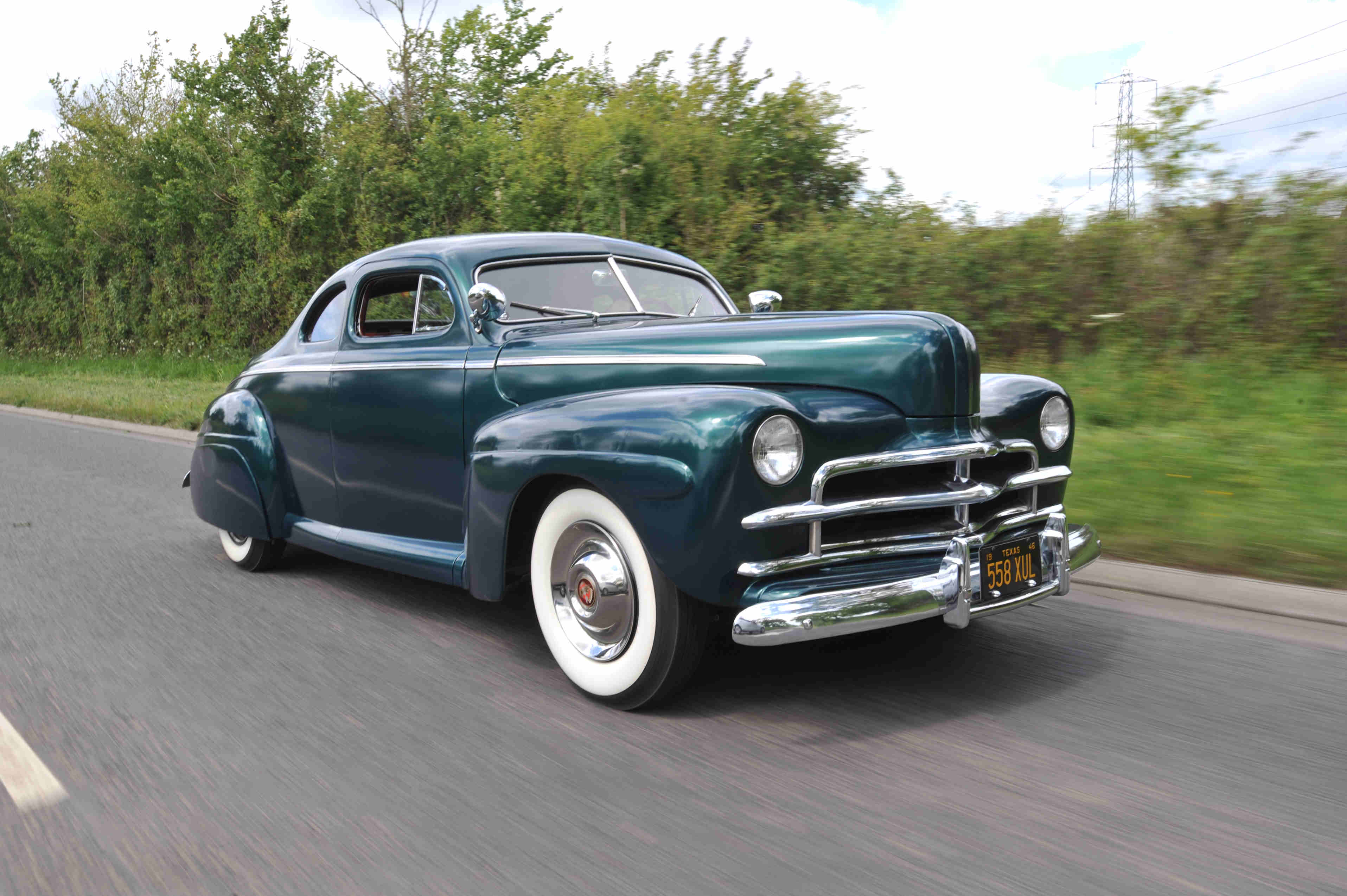

    No so much sinking as it was shifting the entire roof forward. The idea was to maintain the same rooflines and perportions without distorting the shape of the 1/4 windows. Called a "mild chop" but 5" were taken from the b-pillar.

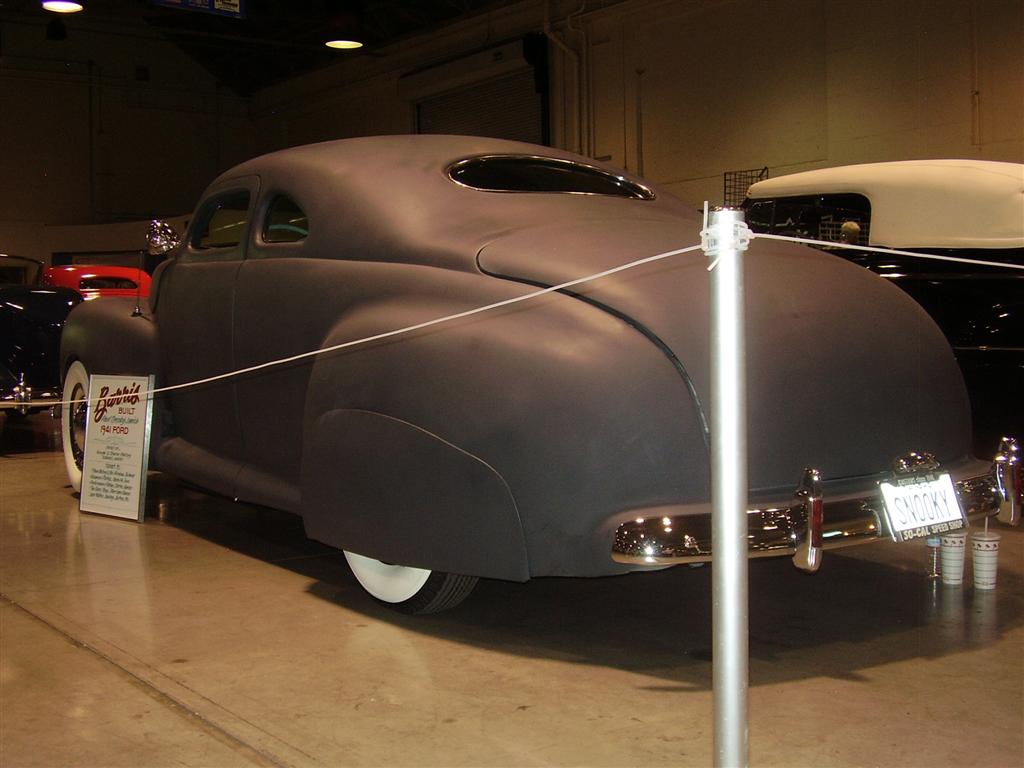

    And here is the real deal, 41 Ford Barris Snooky Paul Janich. That was at the GNRS 2011 at the Custom building. No words...

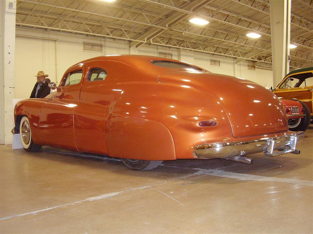

    The club coupe in the top left corner is the Throtle kings car, notice the 47 lower front fender trim, looks good, the other is musicos car, here you can see the diference between the club coupe and the business coupe.thanks for posting all the pictures stephan.

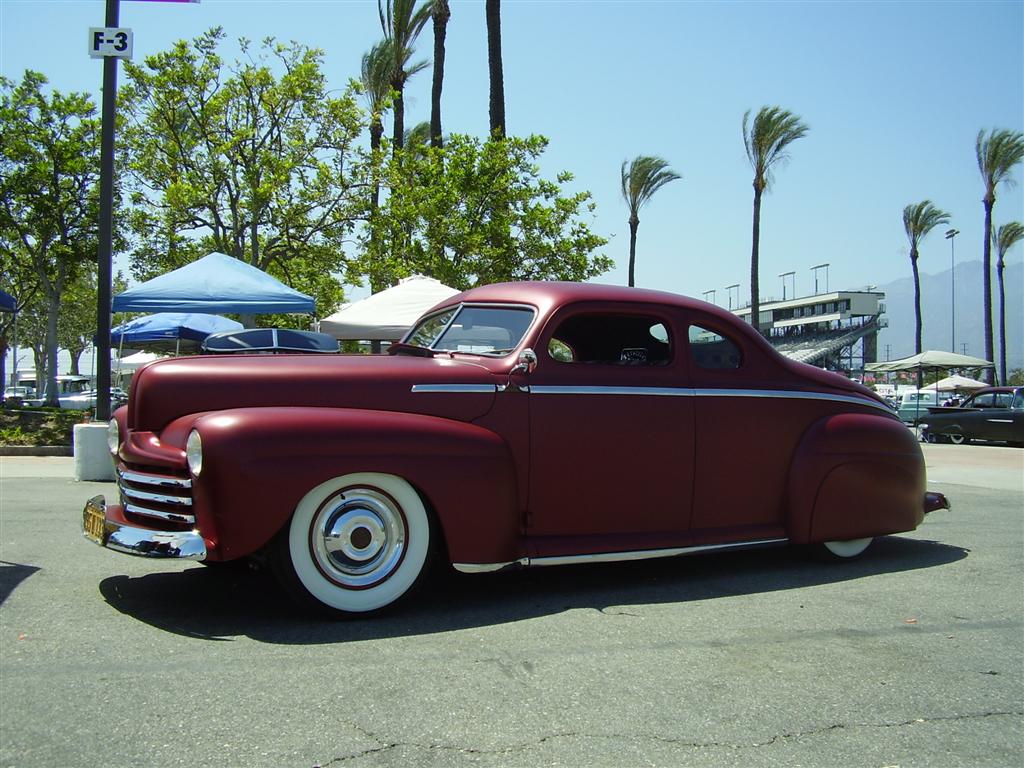

    Santa Maria last year!

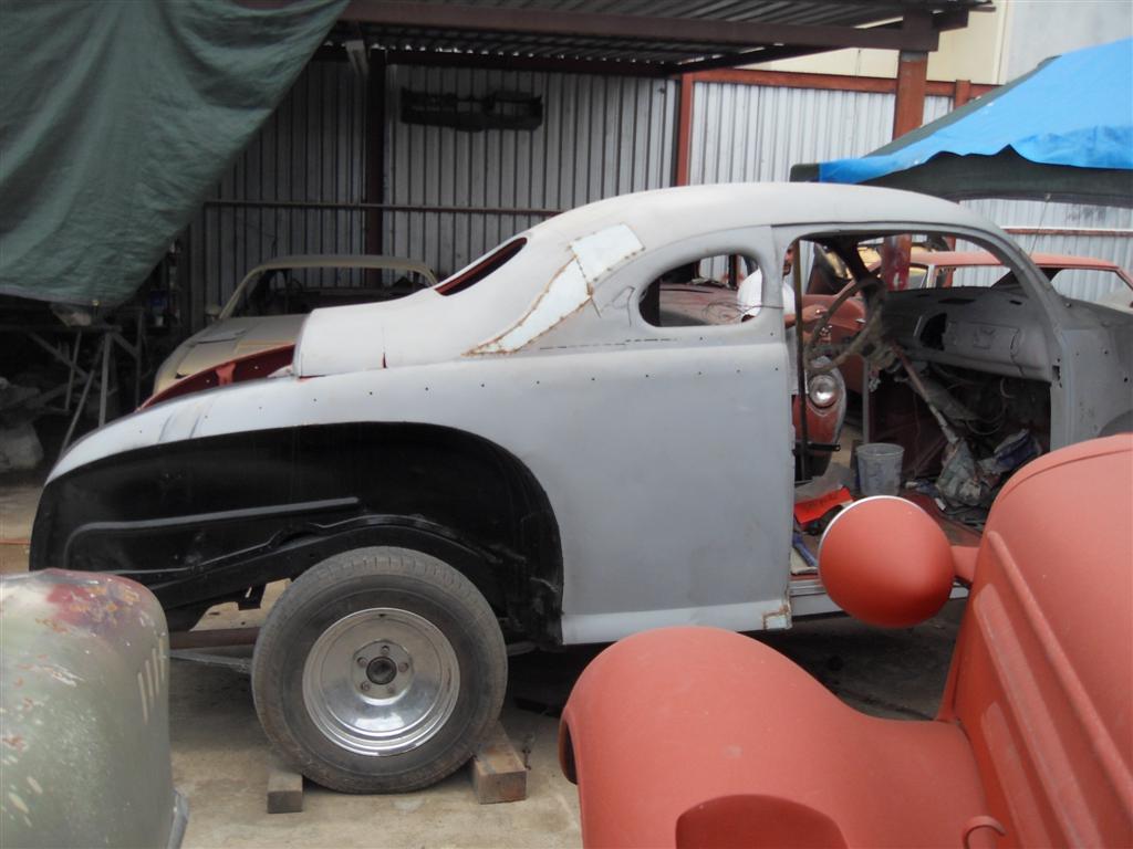

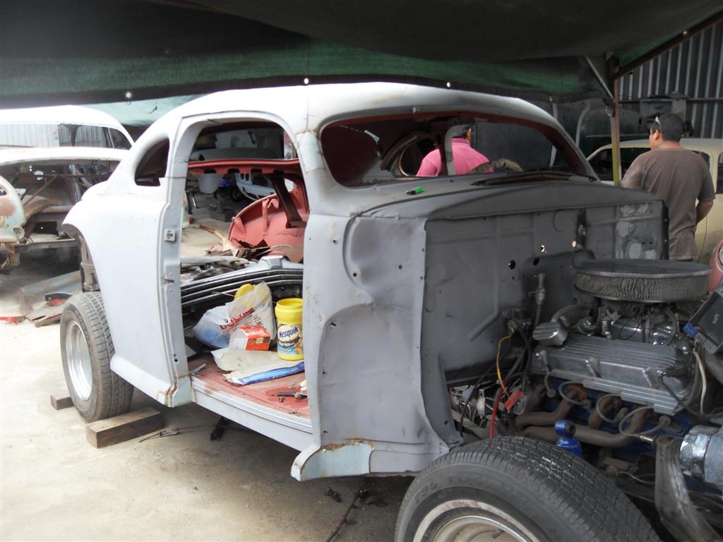

    here are some pictures of my buddy Sergio's custom shop in Tijuana, I met Sergio in the mid eighties, I was setting up a restoration shop in Tijuana for a friend of mine, sergio was just a kid back then and we brought him on board to fab and change out rusty floors and do convertible conversion on hard tops, since a kid , though he never had a pasaport to visit the states, he always loved customs, I would bring him the old tex smith books on how to chop cars and custom books with pictures of cars that Barris, ayala, gene winfield, watson, and bill hines had done. we started building a bunch of 49 to 51 mercs back then , and we did a couple of chops, later Sergio opened up his own shop that you see pictured here, nothing fancy here , ox acedelene bottles with a 0 tip so the heat don't get away, a hamer and dolly, a flour sac full of sand to shape what ever panels he needs to make and an angle grinder with a 4 inch cut off wheel, goes to prove you don't need a fancy shop with expensive tools to build a custom.

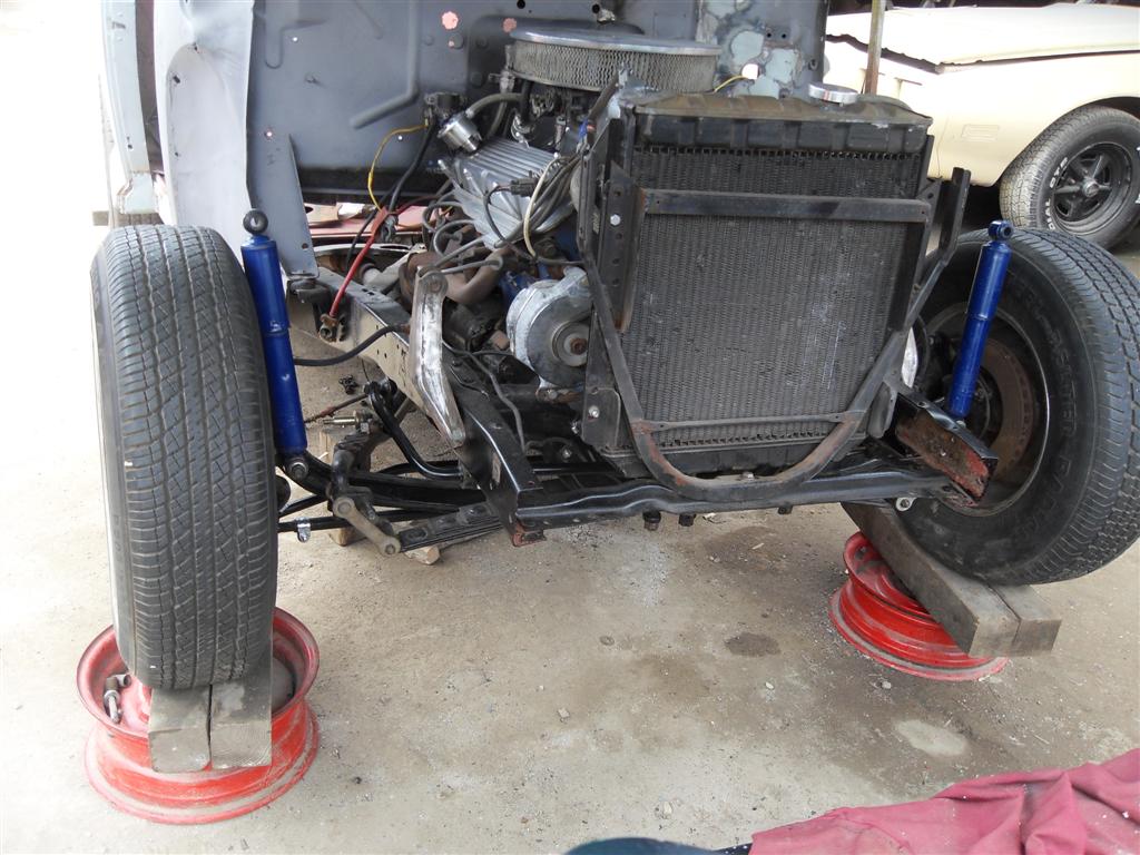

    After I stripped the body with a friend of mine of all the old paint and rust, I brought the car to sergio, the first thing we did was fix the street rod chasis pictured earlier, it had a mustang two unit on the front that had been installed by Igor. the front half of the frame had been ruined so we decided to cut all that gay **** right off, we repaired the frame with a stock front section I had laying around. I installed a stock 48 front end with the only modifications being a reversed eyed spring with longer shackles to lower the front end.
    The motor and ****** mts were all wrong so we reset the engine to the correct position and installed a stock steering box back in. the stock exhaust on a 289 or 302 motor are but ugly, so I wanted to keep the headers that were on the engine, so we slid the stock steering box mt a few inches back and made a simply coupler to the 59 caddy collum.
    The easiest engine and ****** to install in a 41 to 48 ford is a 289 or 302 engine, they dropp right in and you don't even have to split the wish bone.The only modification to the stock frame is you have to pull out the bottom plate on the x-member and rework it so it becomes your ****** mt and your new wishbone cup support.
    Though the 289 or 302 engines and c-4 ******s are non traditional, they are the easiest ones to install and you don't butcher the frame.
    The radiator is a stock v-8 early mustang unit and bolts in to the original core support with the aid of a simple bracket pictured here, these radiadors are only aboat a hundred and sixty bucks brand new.

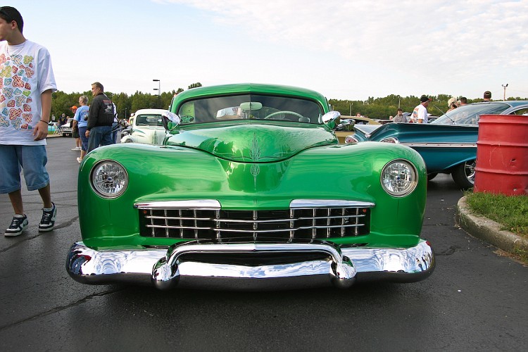

    Pretty sure not everybody's taste, but the tan one was done back in the day, before the popular style that we all copy today was established. I think it started out as a 41 Ford. There is a ton of work in the green one.Over the top crazy, I like it. Radical custom.
