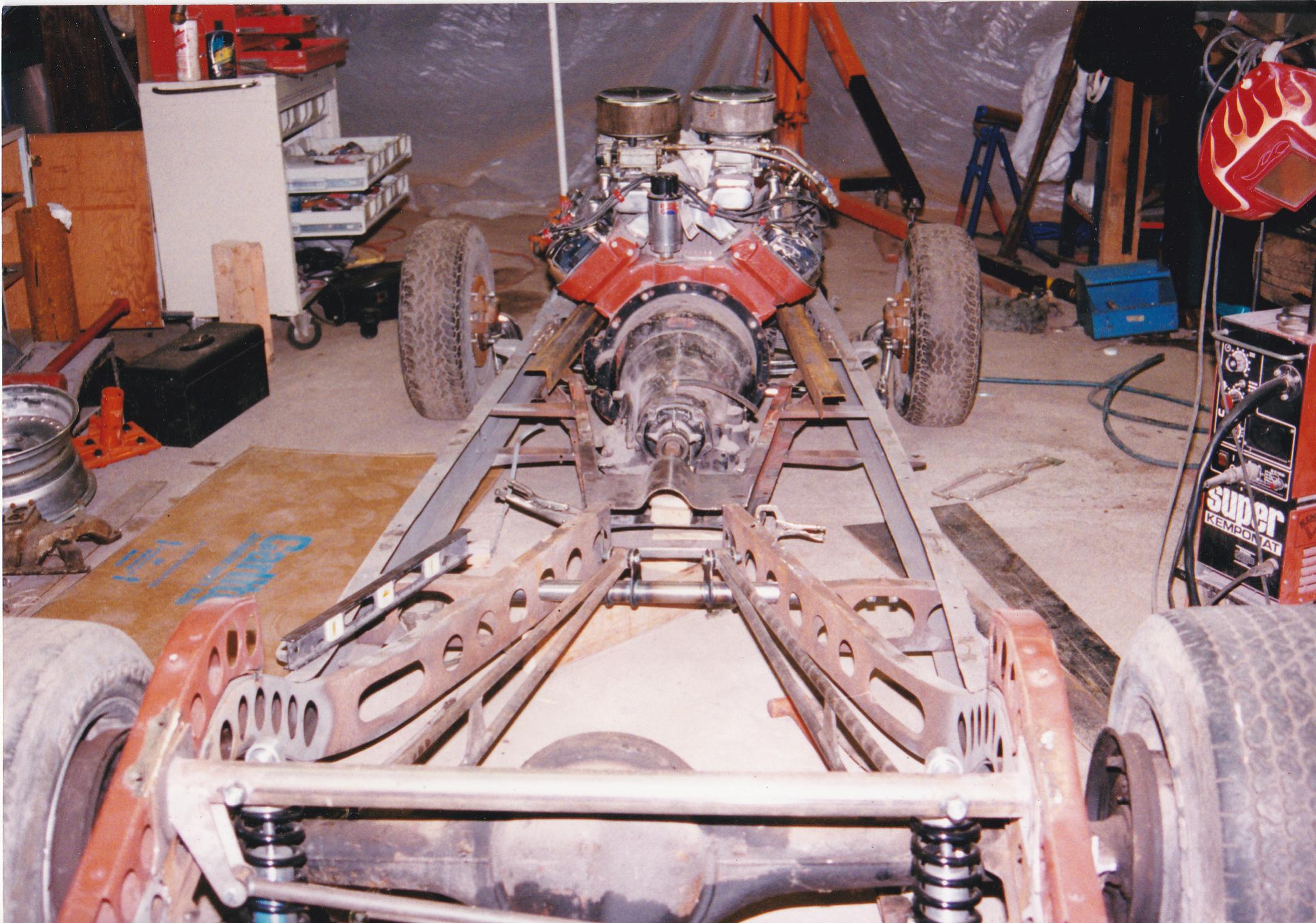

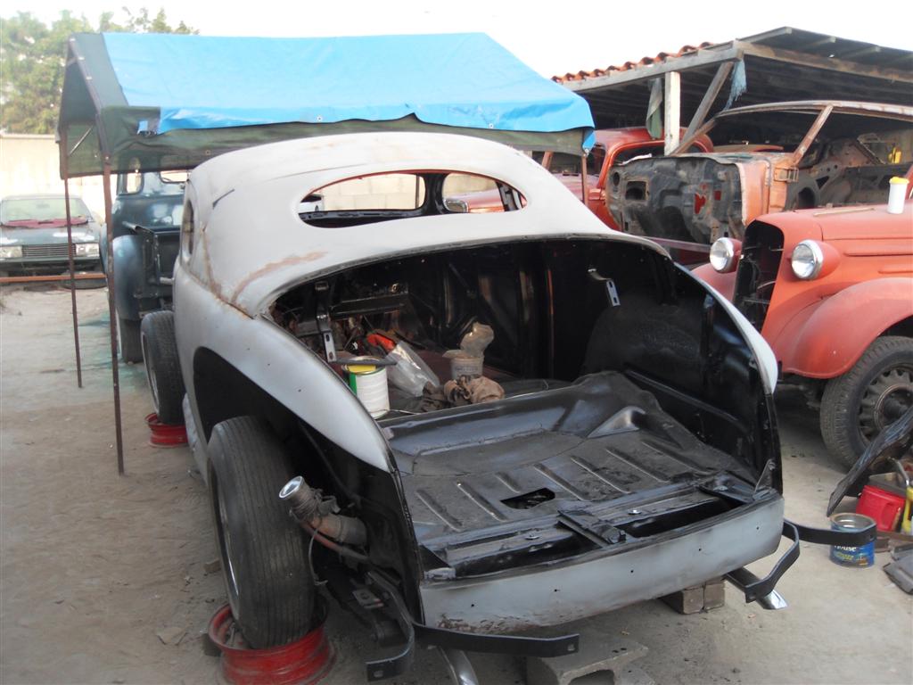

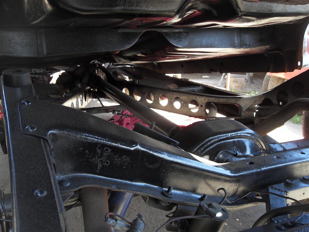

    Here is the lastest pics, there is the transmition and wisbone ball mt. by using this, the chasis is completly stock,, thats one advantage of usesing a 289 or 302 and a c-4 ******, also the firwall is stock and the clearence for the fan is perfect, no gay *** electric fans on this car, stock 46 brake pedals are used with a small power booster and a dual resavior, pedal is in the stock location and no modification of the floor or the stock transmition floor cover.
    Ya the crunch is on, trying to make it to Penneys show, dead lines are extremly stressfull but are positive because they push you to get the car done, and if you make it, they give a strong sence of achievment afterwords, June is the busiest month of the car show season, and it ****s not having a car to drive to them.

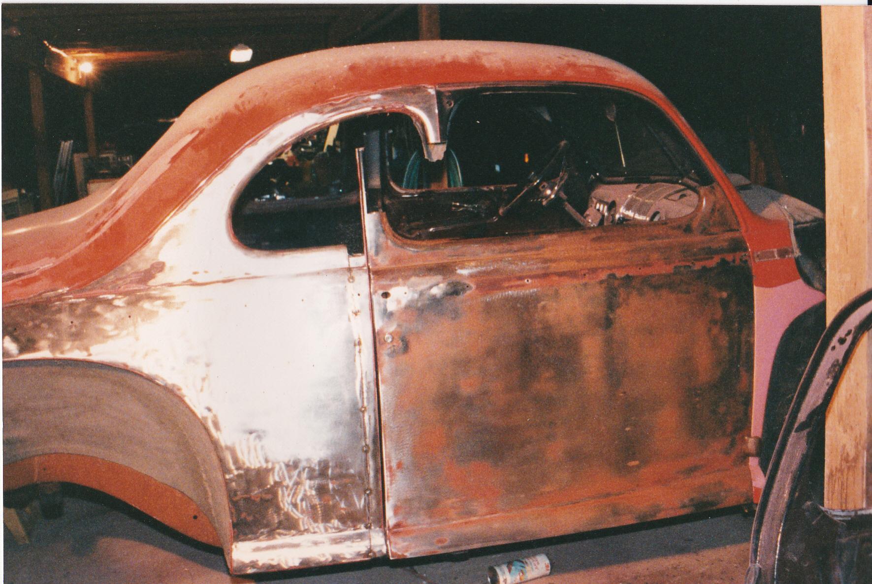

  6. actually this is probably the best Olds install I've seen. most try to flow the moustache
    this pointed hood and smooth fenders work very well. the fat *** I'm referring to is really the area above the rear fenders. I spent a month sitting and looking.
    if you look at the other photo I posted of my car. I don't claim it's right, but it was the solution to the problem that I had with my build. the tail light holes in the fenders were lined up even with the bottom edge of the deck lid. this was done in the early ninties and I am still working on the final look.

  7. I almost bought a 47 Merc conv. Amazed how longer the hood seemed

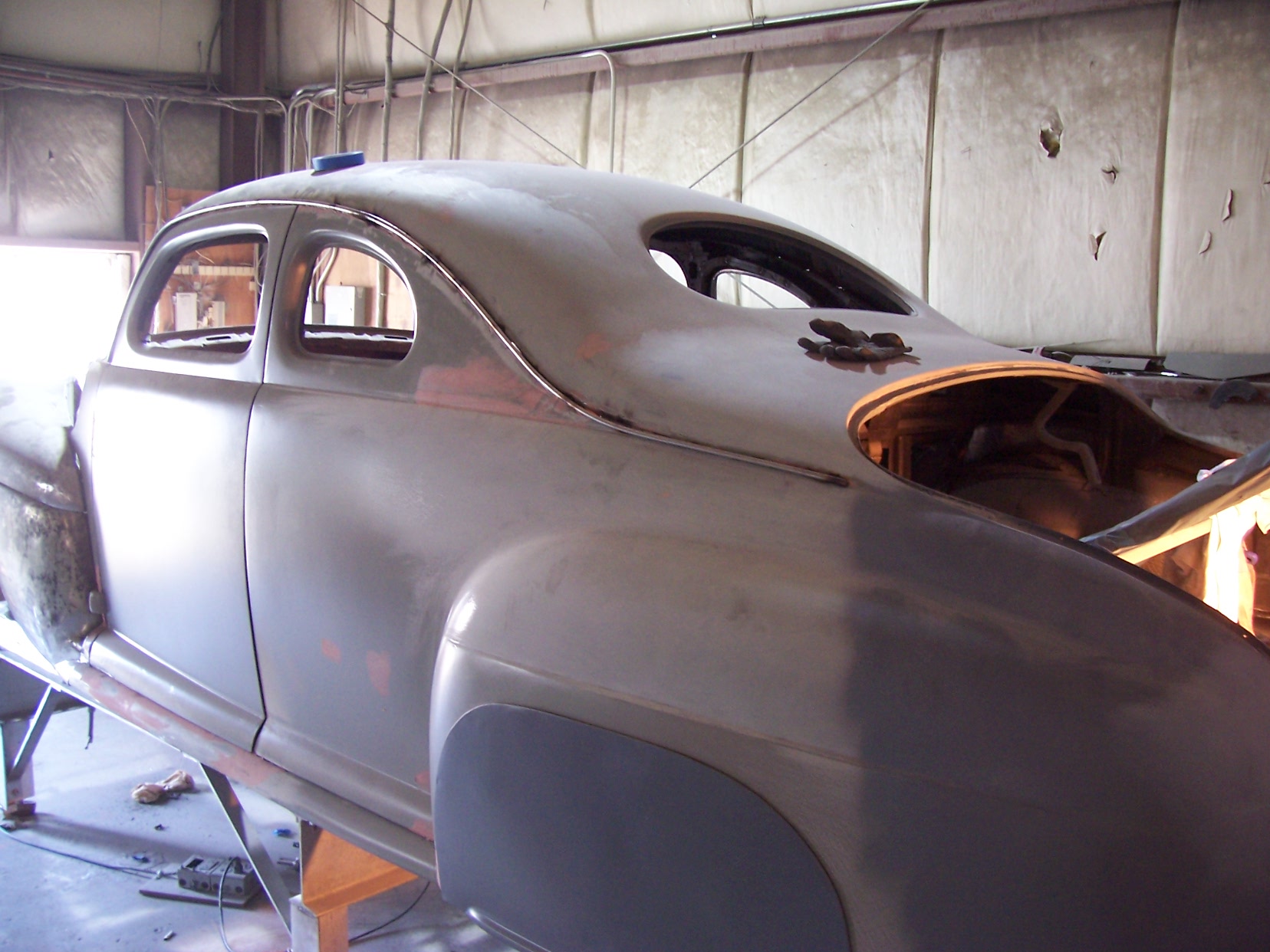

    I agree no name, I like the way they continued the hood on the chopper's car, it fill's up an otherwise large area above the grill, as to the area above the rear fenders, I have seen several cars that have pancaked the decklid and lower sail pannel, on my car , we had to modify the lower corners of the sail panel to keep the rear corner roof lines flowing, I hope I don't get in trouble once I bolt on the deck lid.

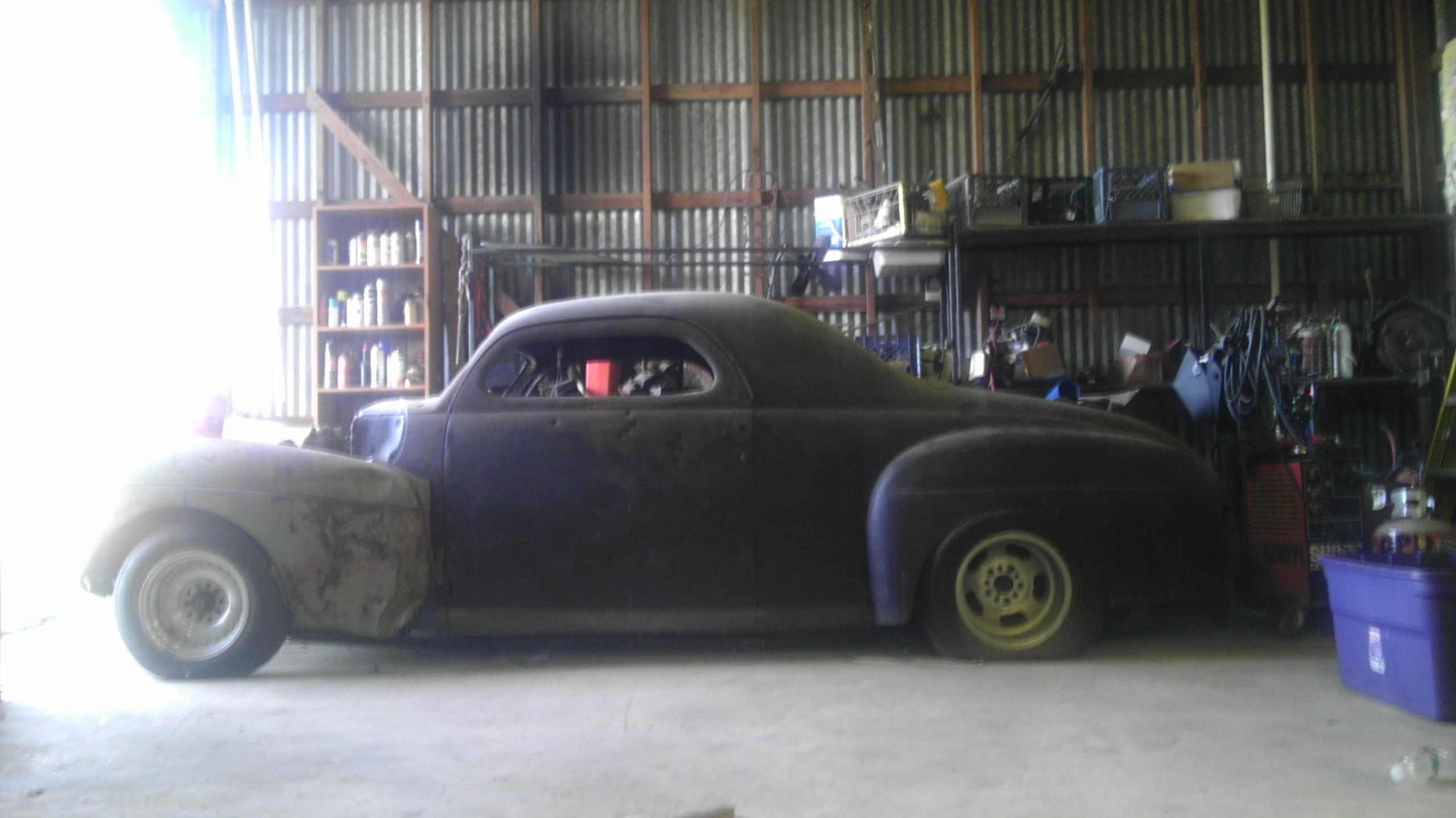

    I got a call from a friend asking me for a front clip for a 46 ford business coupe, my friend told me that he just bought the car from a guy in alpine that had owned it for a long time, but it was missing all three fenders and a hood, so I sold him the missing parts for the car. A few weeks go by and he called me again and asked me if I would be interested in purchasing the car from him, the price was right so we struck a deal. Weeks go by and my fellow club member Ben fields tell me " man some guy just bought the 46 that sat next door to my grandpa's house in alpine, man I was going to buy that car and build it some day" so he told me how him and our other fellow club member Mikey had played in the car when they were just little tots, so I told him that if I ever decided to get rid of the car, I would let him know.

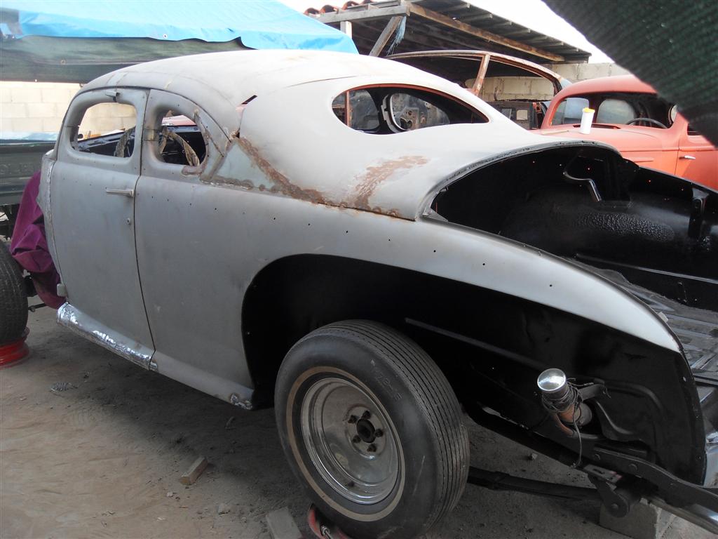

    A few years go by , and my friend Auzi pete was chopping Grease Machine's 41 plymouth, so Pete ask me " Miguel , why don't you let me give that thing an evil chopp?" so we struck a deal and Pete started laying out the chop.
    As time went by, Mikey came over for a visit to check out the chop on the 46, Mikey was'ent much of a custom guy, for he liked hot rods, but he did have a soft spot for chopped 46 coupes. He ran up to the coupe and uttered " man now your'e never gonna finish this car, it's just going to sit and rot with the rest of your project cars, but I could tell by the gleem in his eyes, that he like the car and was challenging me to finish the car."
    Another seven years went by, and I finaly decided to get the car done, Mikey p***ed away a year ago and I have always regreted that he never got to see the car that had been his play pen as a kid finished, Pete calls me every couple of weeks from Auzi and always ask me on the status of the car, and how he wants to finish the chop he started. Recently he has mention to me that he plans to come out in November , so he can finish the chop,but I answered " No Pete , I have a better idea, me and you are going to cruize in that car when you come out ".
    So I guess I have a lot of motivation to finish the car and I hope I can make Mikey prowd of his play pen.

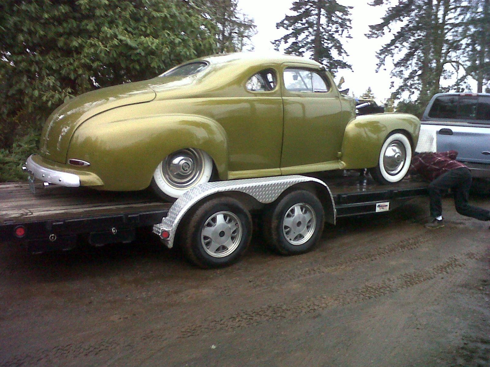

  12. the color is from one of those rolling toasters made by Nissan.
  13. bennydog
    Joined: Dec 22, 2009
    Posts: 57
    bennydog
    from Corona
    :D Well I still like it.. Its like a lime gold.. do you have the name of it?

    Well I brought my buddy tono on board, he works at a restoration shop I set up in the late eighties for a friend of mine, he usually works on big clasic cars from the thirty's and is an ace body man, he still does lead work , peck and file , and is great at heat shrinking wadded up panels.
    Back in the day, most of mexico's best body men came from mexico city, reason being, till the late 70's, you could'ent import bondo , so you had to learn the old sckool way, him and his brothers are secound generation body men and painters, Tono started doing body work when he was just 8 years old, I can't afford to have him do my body work in lead, so bondo will have to do, and he only uses a light skin coat to finish up his work, I'll try to post some updated pictures soon.

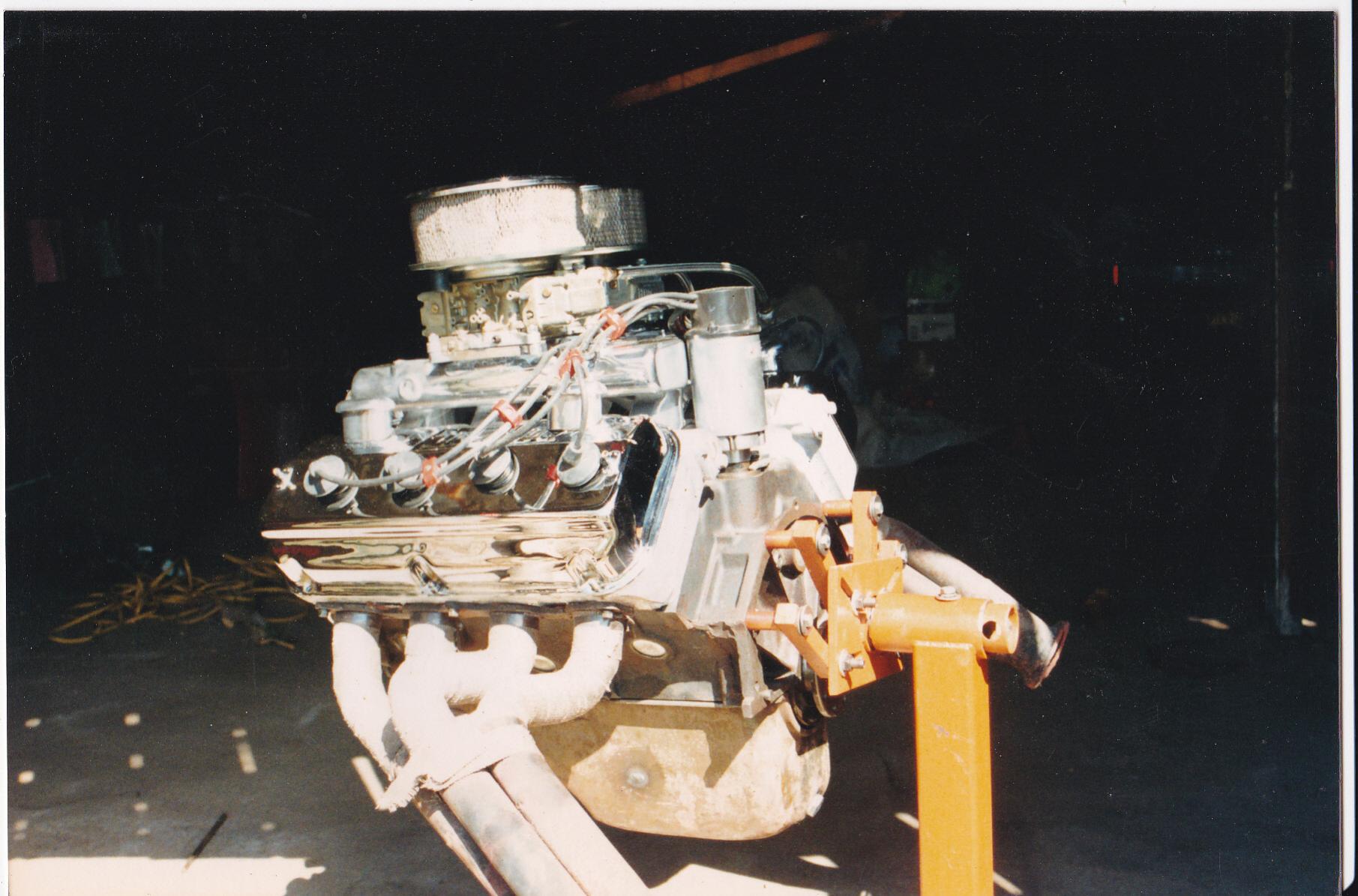

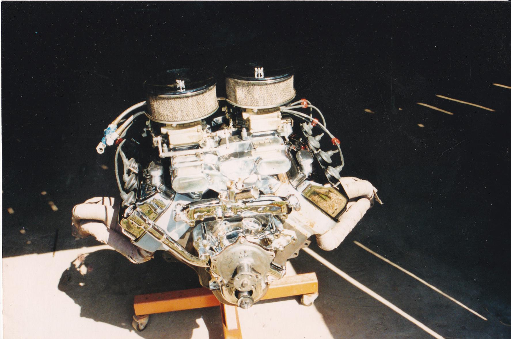

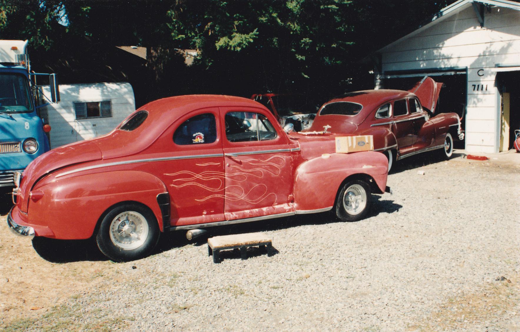

    I like this thread and My 48 ford, even with the design flaws from me and the factory lol.

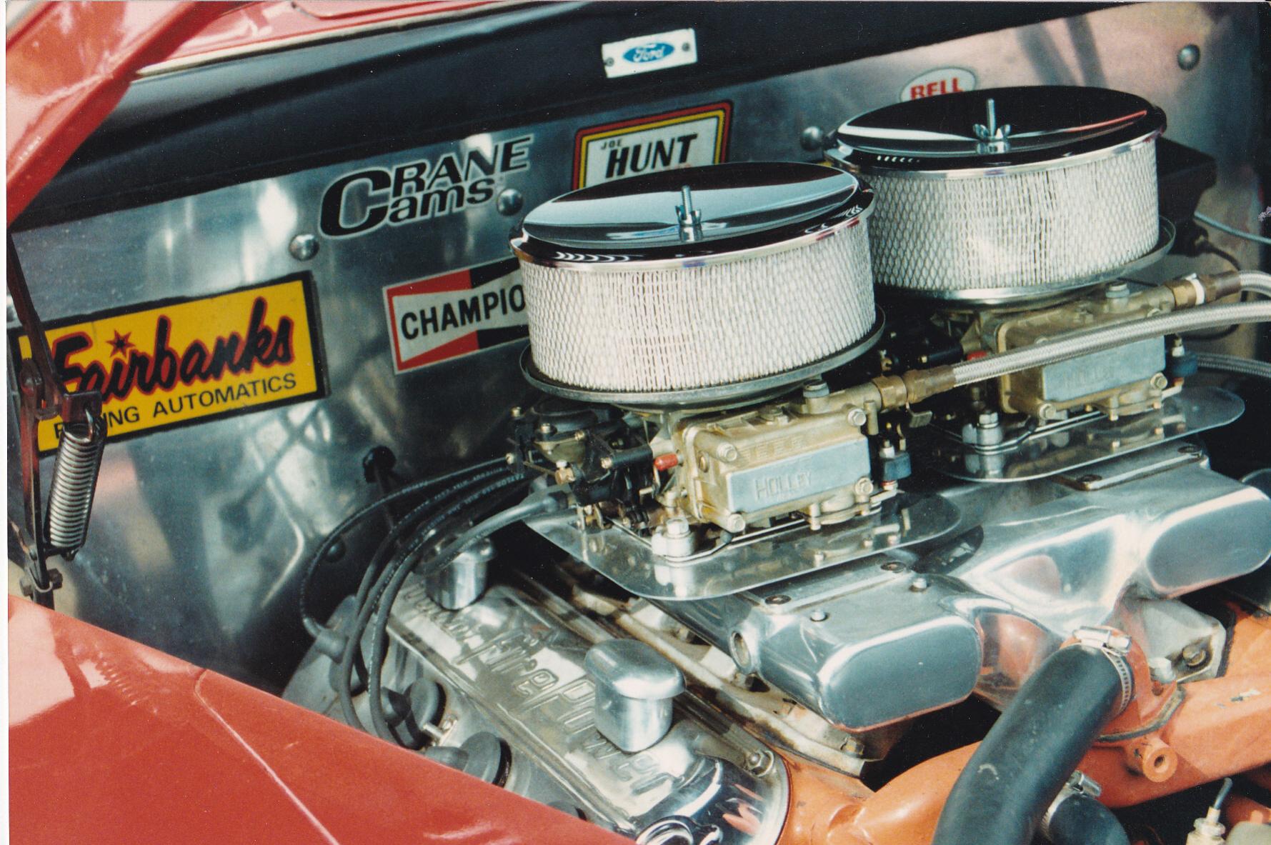

    I bought this Hemi powered business in 1990 for $8000 and drove the hell out of it for 3 years. after a 3200 mile road trip I lost the transmission 10 miles from home. and managed to drive it to my shop. I decided it was time to rebuild the motor and trans. when I found out how hard it was to find rebuilld parts (before internet) I thought it was a good time to do the chop/ 3 window conversion that I'd been thinking about.
    I started Aug 19 1993 and am looking forward to finishing it before my 20 year anniversary aug 19 2013 lol again
    EVL401 and 509garyd like this.

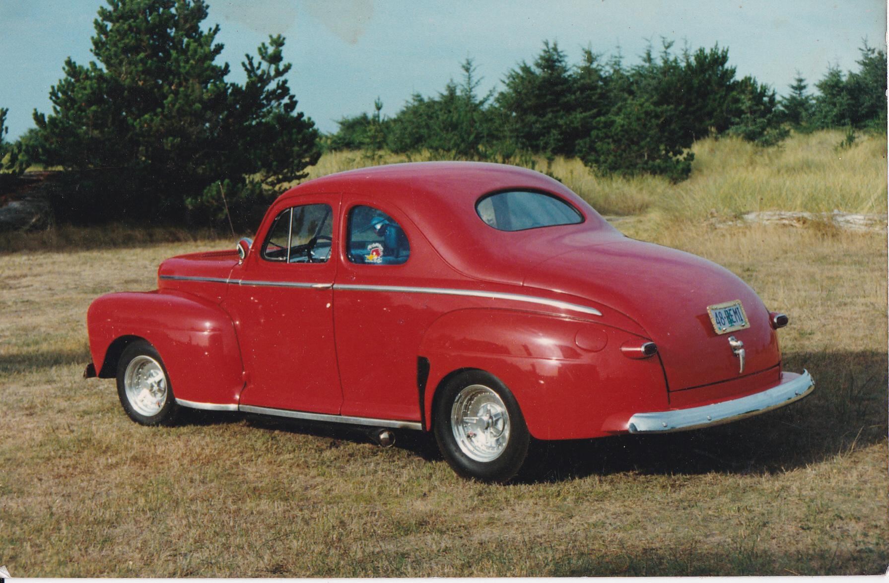

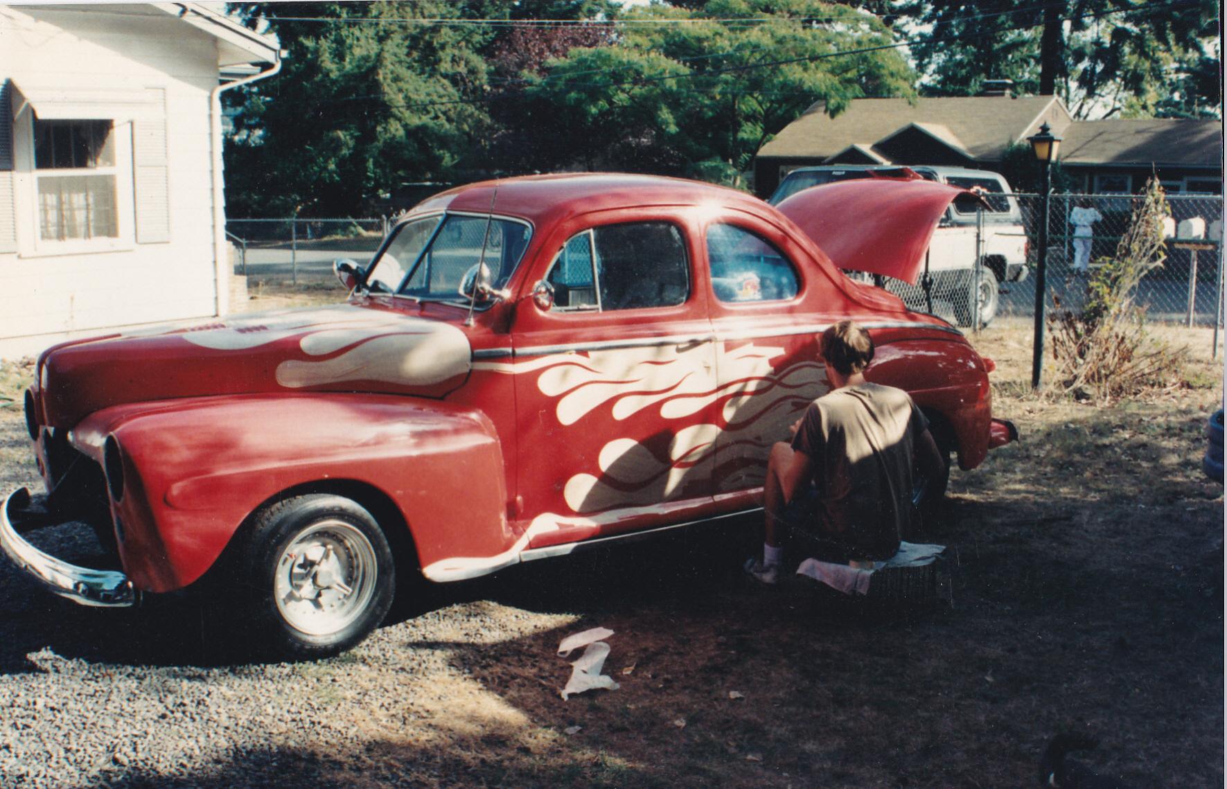

  23. It was a nice car, ran well, but I didn't build it so it just wasn't mine. I tried a flame job. still wasn't happy

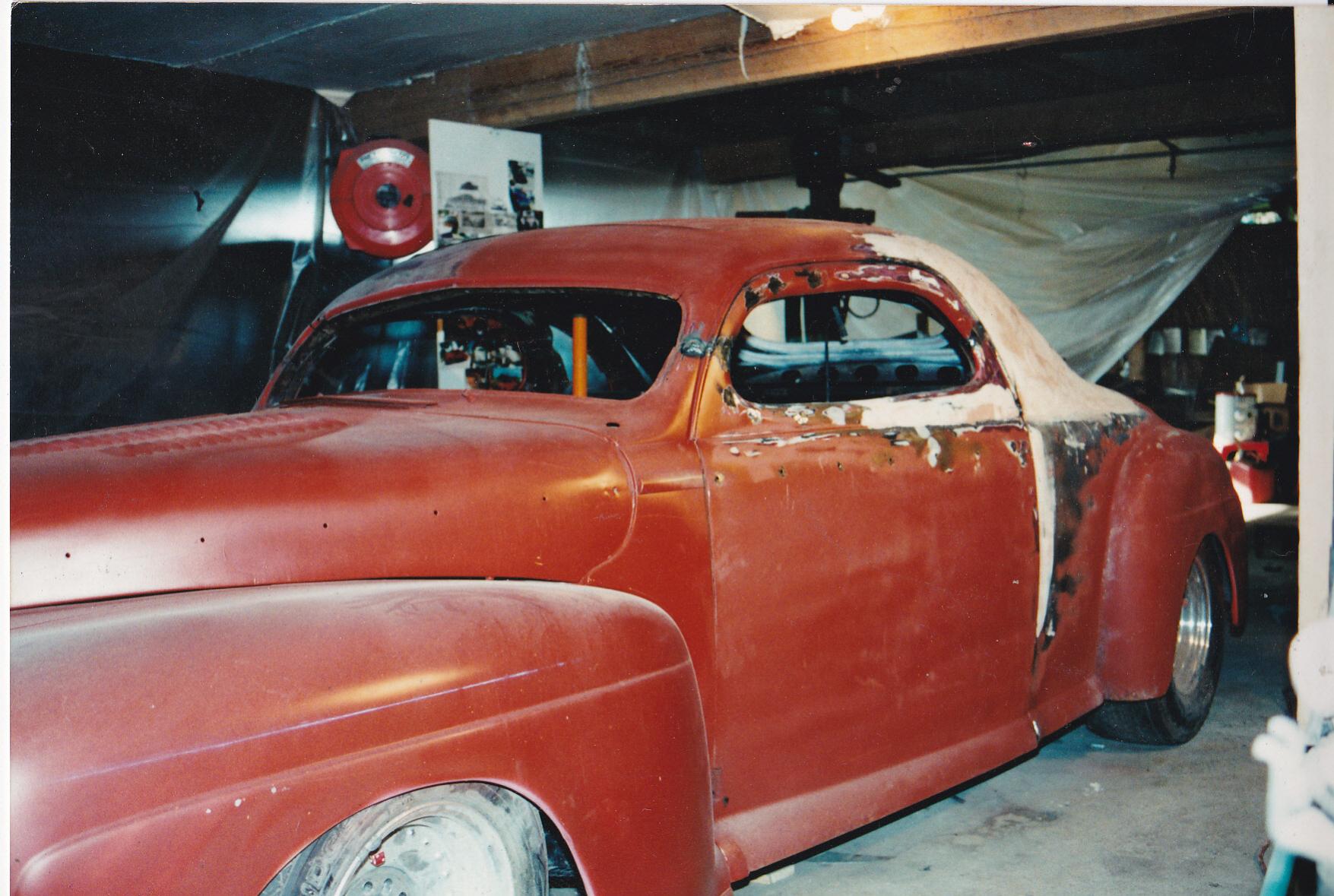

  24. time to personalise my car. without a plan I was going full custom (when I started)
    Did I mention it had a Hemi???
    EVL401 likes this.

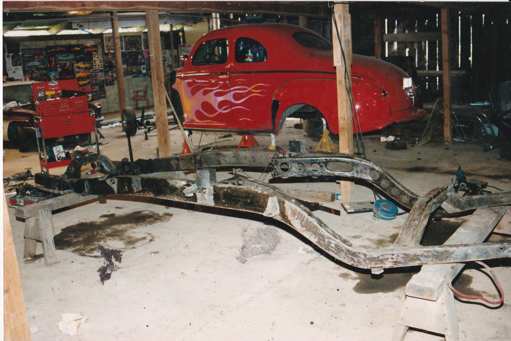

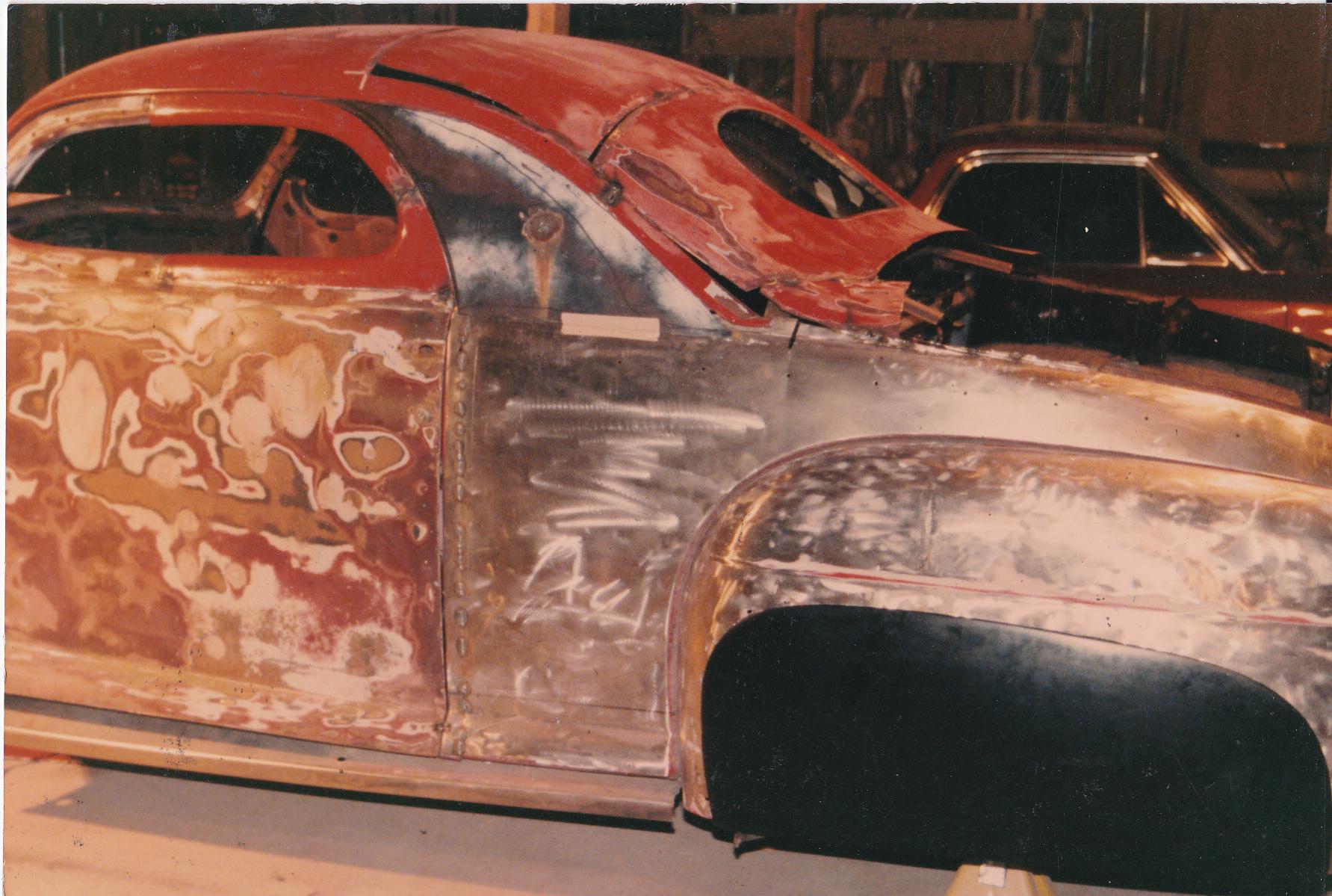

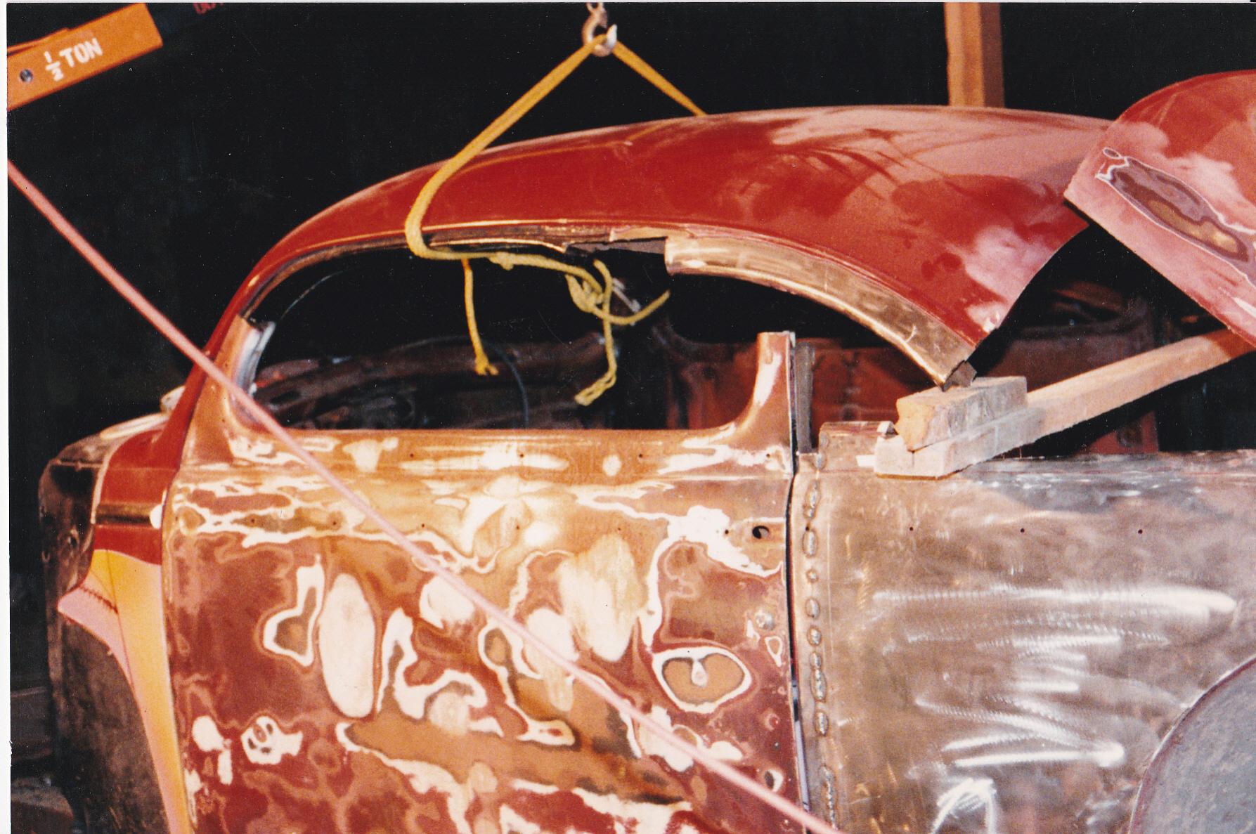

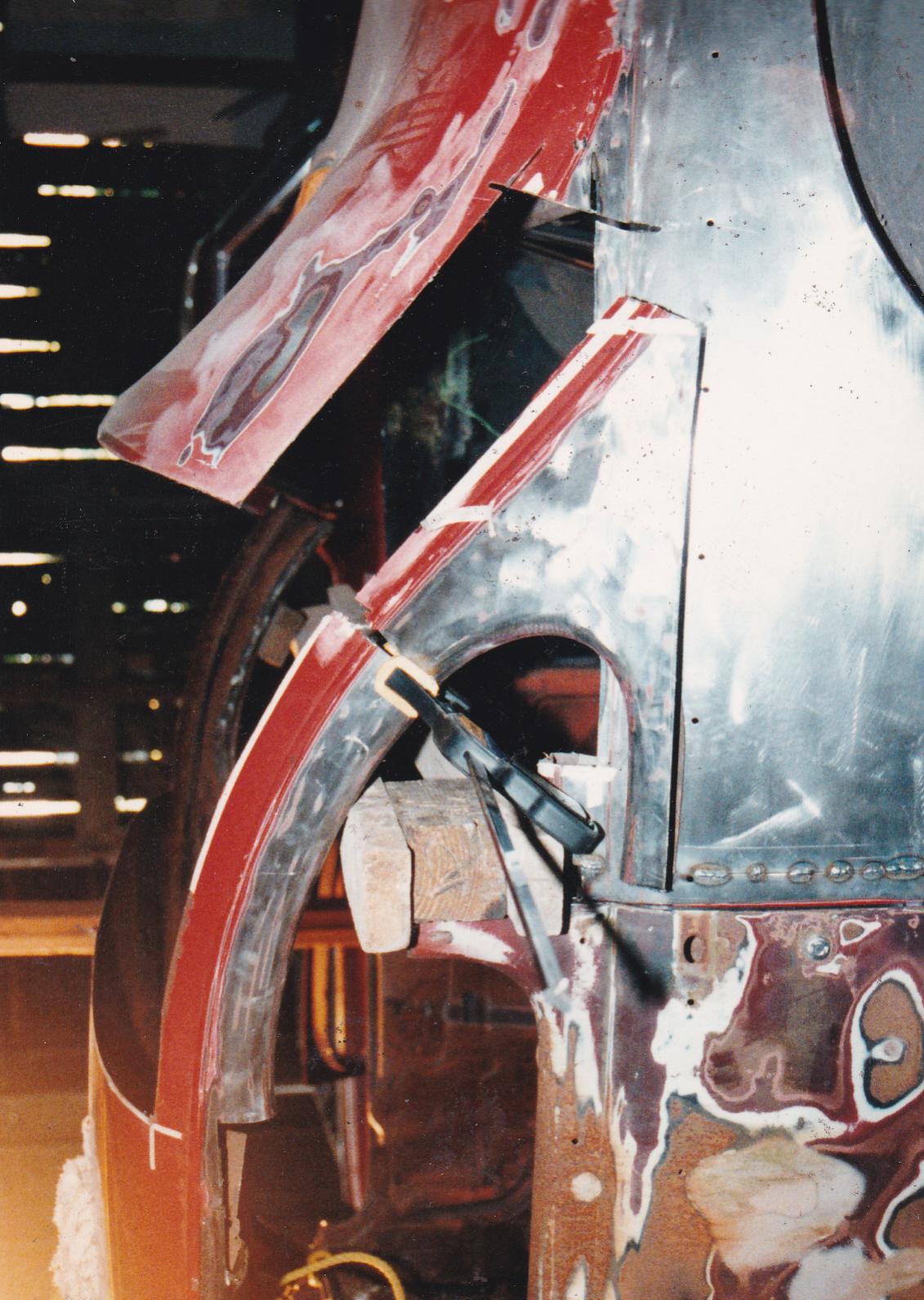

  25. I found a 2 door sedan parts car and another frame that hadn't been hacked up.
    My plan was 6 inches out of the A pillar and move the B post back 8 1/2 inches for the sedan doors

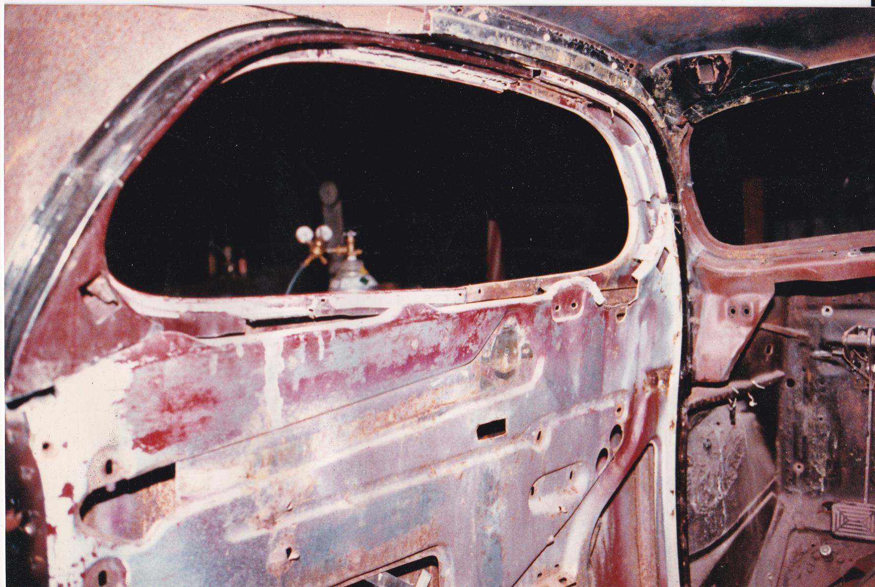

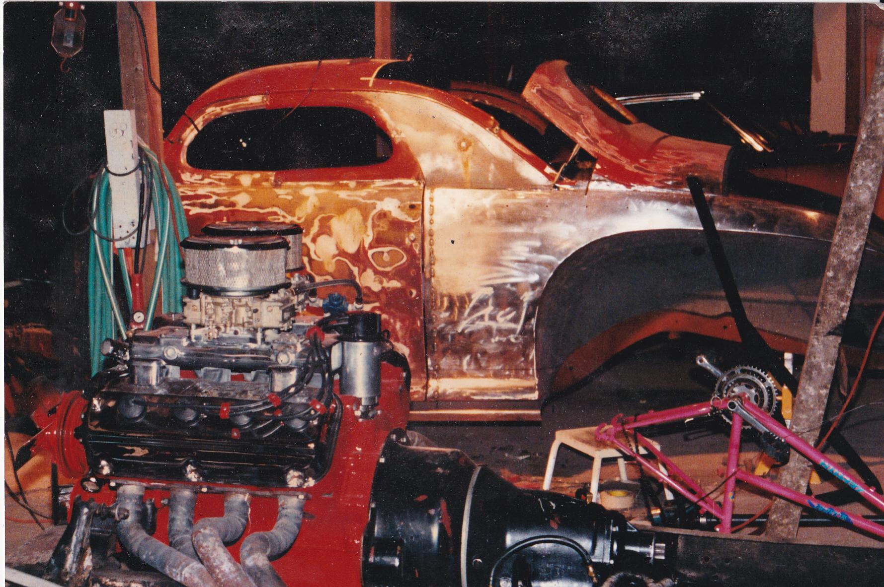

  26. I knew what I wanted it to look like and I had enough pieces. I don't have any metal shaping tool besides a few hammers. so I have to go to my s**** pile for bends and curves

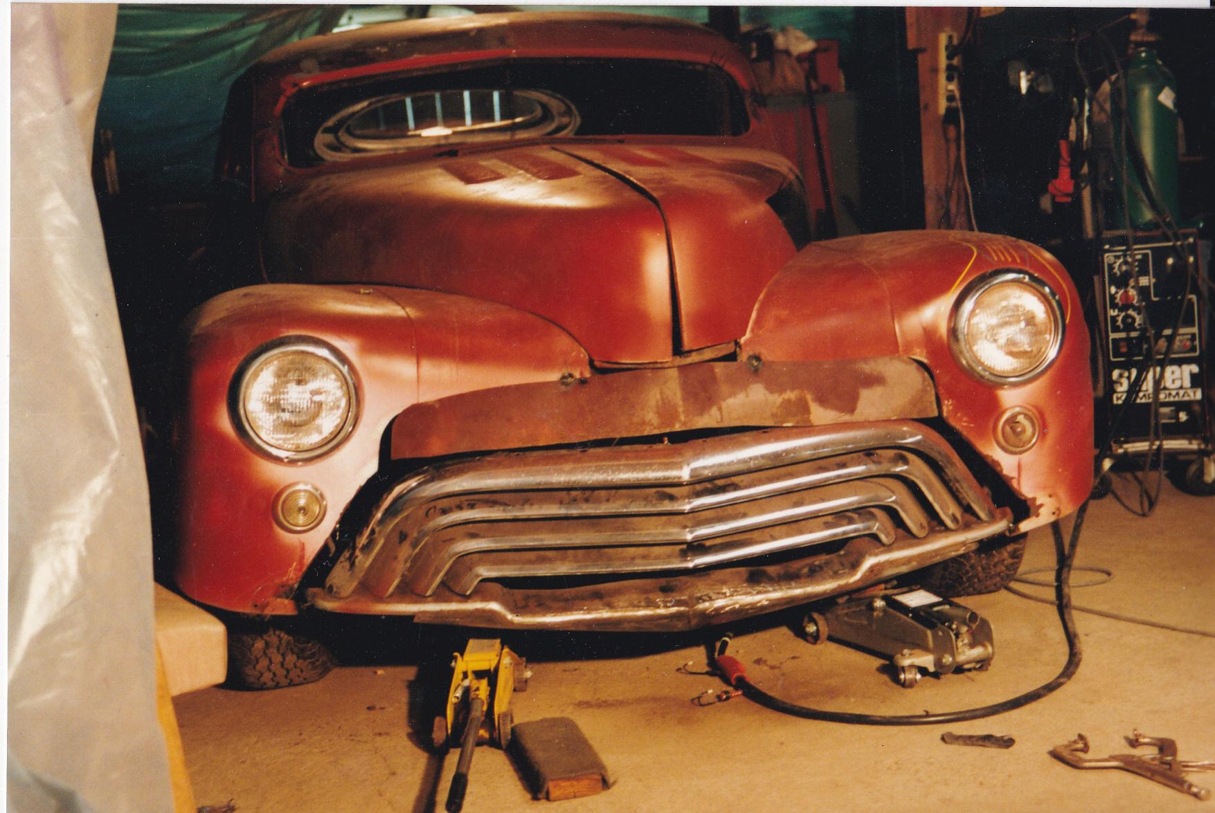

  27. the full custom was going with the Olds grill and Buick head lights. biggest problem and best solution was the lower Olds grill pan with the front part of a spare ford roof for a front roll pan
  28. I tried 3 different roof sections and ended up with a 912 porsche with sliding sunroof (honest this was a cool idea in 1990) as were the box skirts

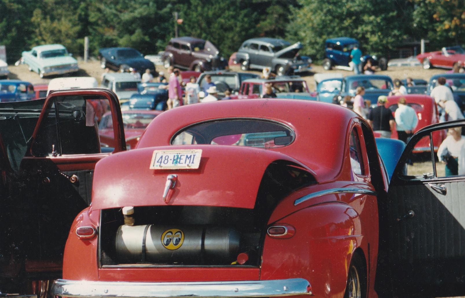

  29. Around back I had the required frenched 59 cad tail lights mounted even with the bottom of the deck lid
