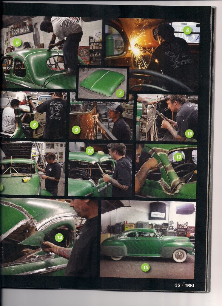

    another in the works................................photo from: Traditional Rod and kulture

    Man it shure helps to start with a nice one, I had to battle alot of rust on mine, the chop on a club coupe is alot simpler than on business coupe. Glad to see another one on the road.

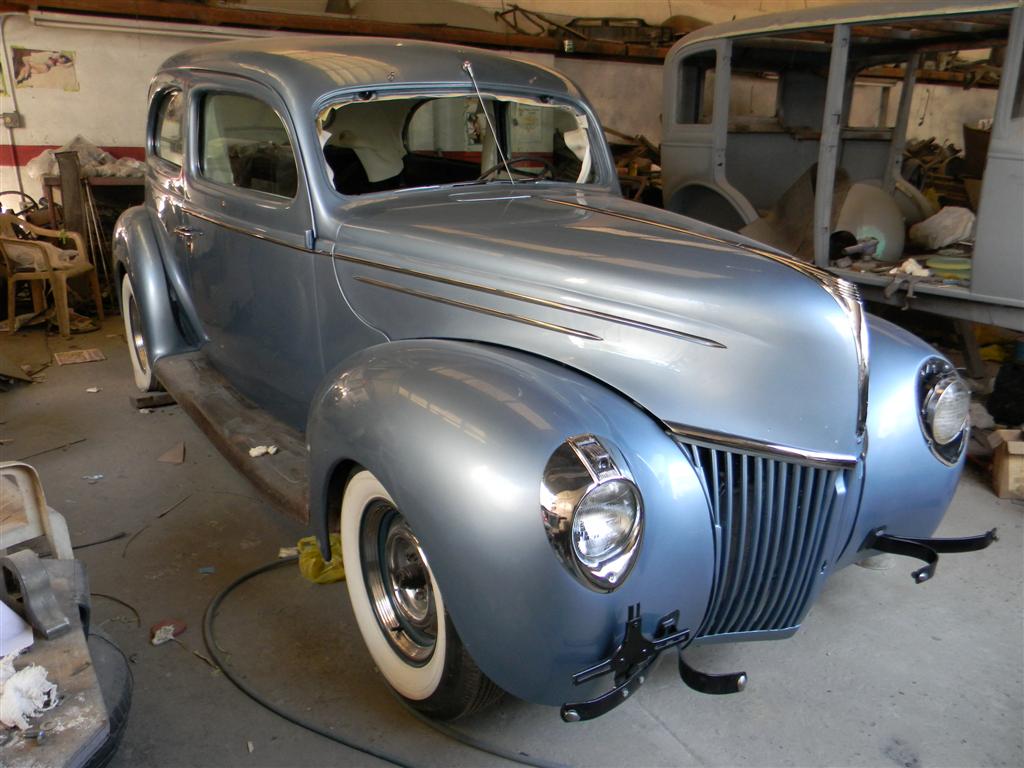

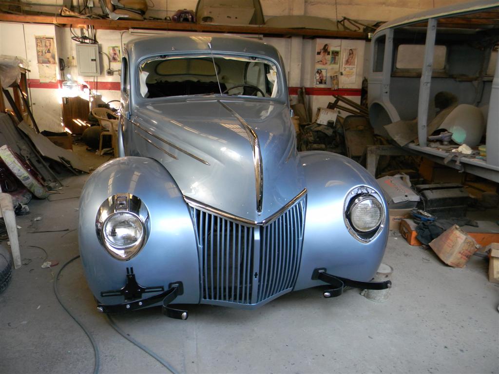

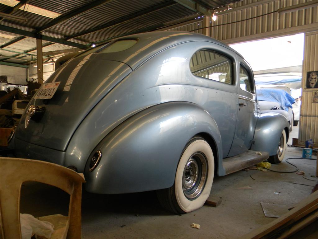

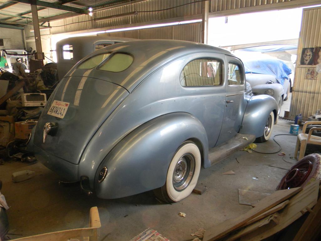

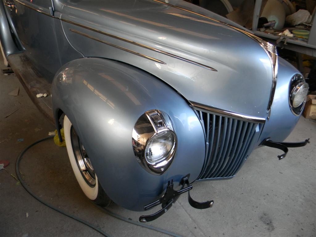

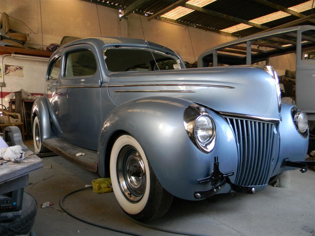

    Here are some pics of Miguel's old 39 sedan. He wanted me to post those pics. He is restoring it for a friend and it's the reason for his 46 being in the backburner.
    EVL401 and 509garyd like this.
  14. magoozi
    Joined: May 20, 2009
    Posts: 1,800
    magoozi
    from san diego
    Ya, I sold my old 39 sedan to Rex from the Gearheads, he asked me to do a quickie paint job on it but we got a little caried away and did a full resto on it. The color is 1984 nissan quest azure blue with a tiki micro flake on top, should have it done this week.

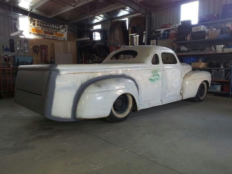

    Bump for a great thread. And something some of you may not have seen, An Aussie 46 coupe Ute custom.

    Darn, you can put alot of moonshine in that rig

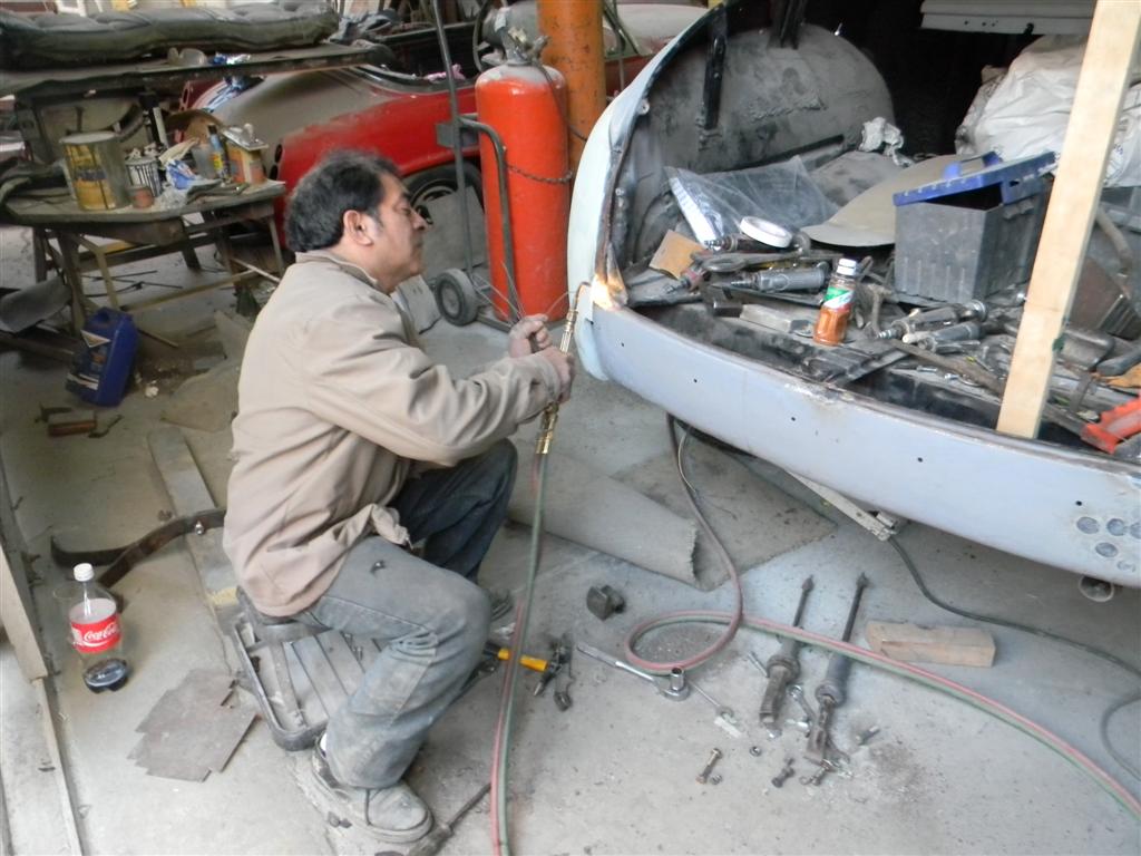

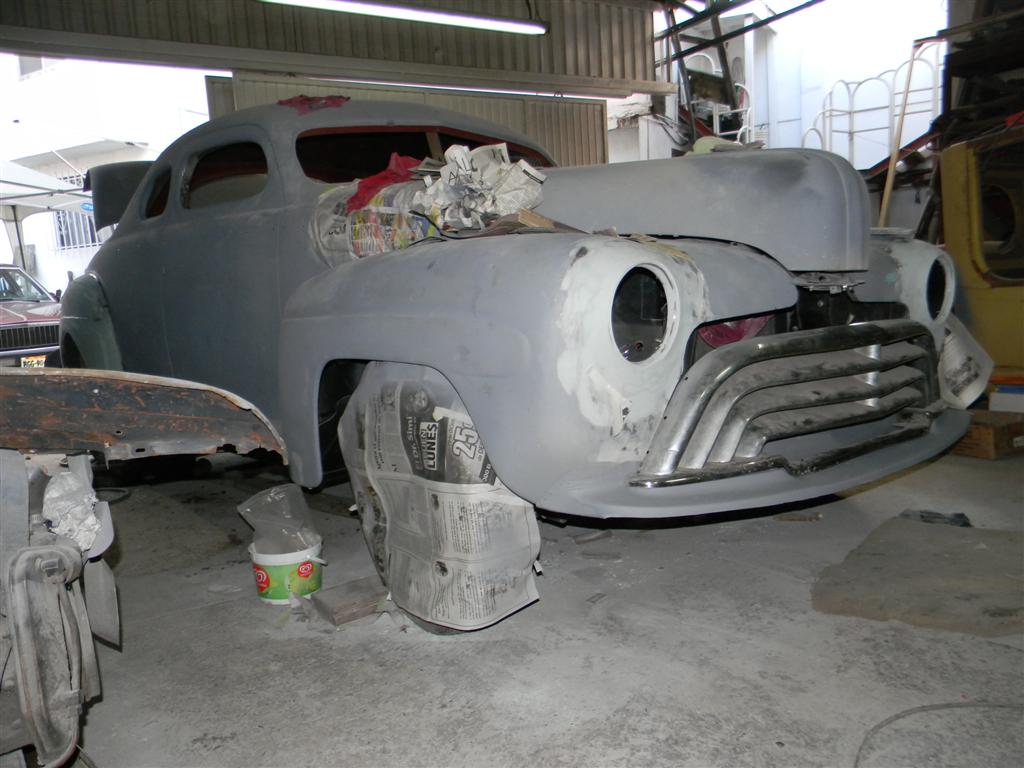

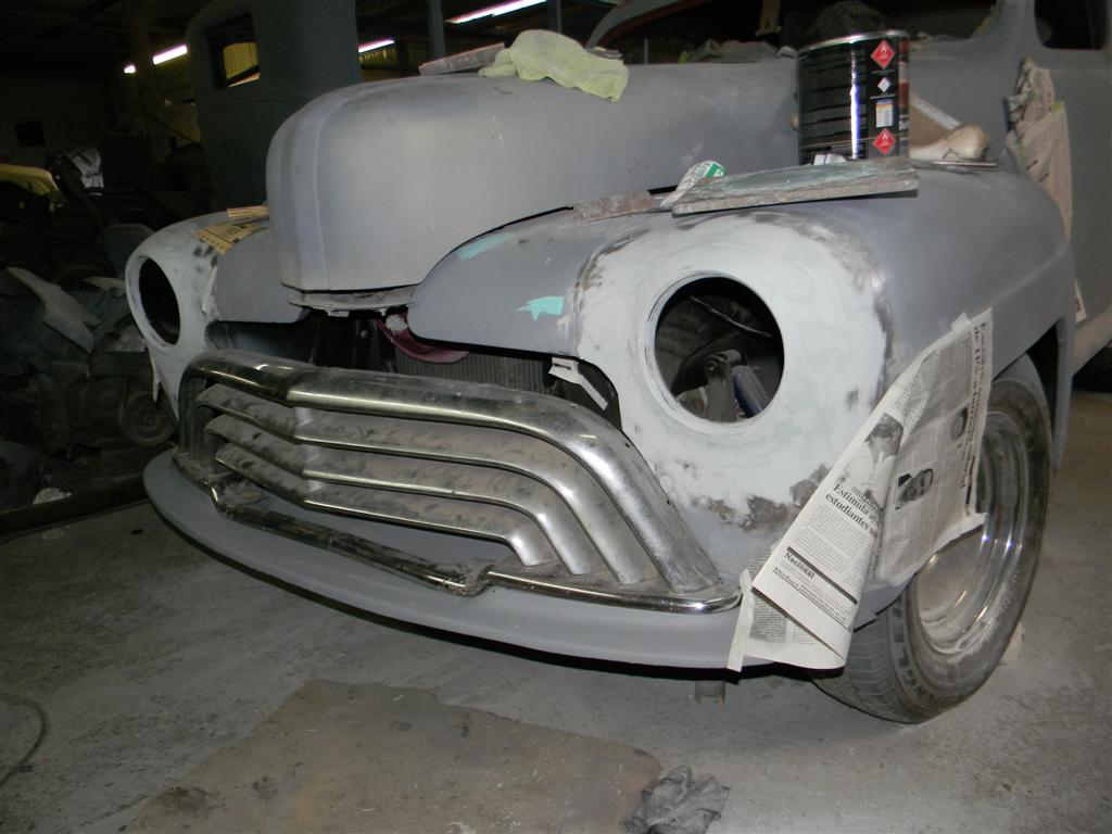

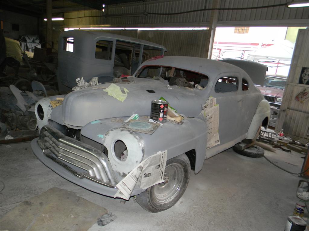

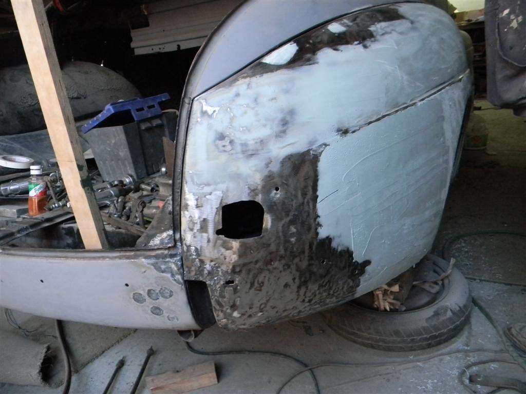

    Miguel's 46 is making progress again
    EVL401 likes this.
  21. magoozi
    Posts: 1,800
    magoozi
    from san diego
    Ya , we are finaly back on it, My favorite grill for these cars is the 47-48 olds grill. The lower front gravel pan is a fibergl*** item that my friend Gene Winfield makes for 46 to 48 fords, fairly easy to install and saves a ton of work.

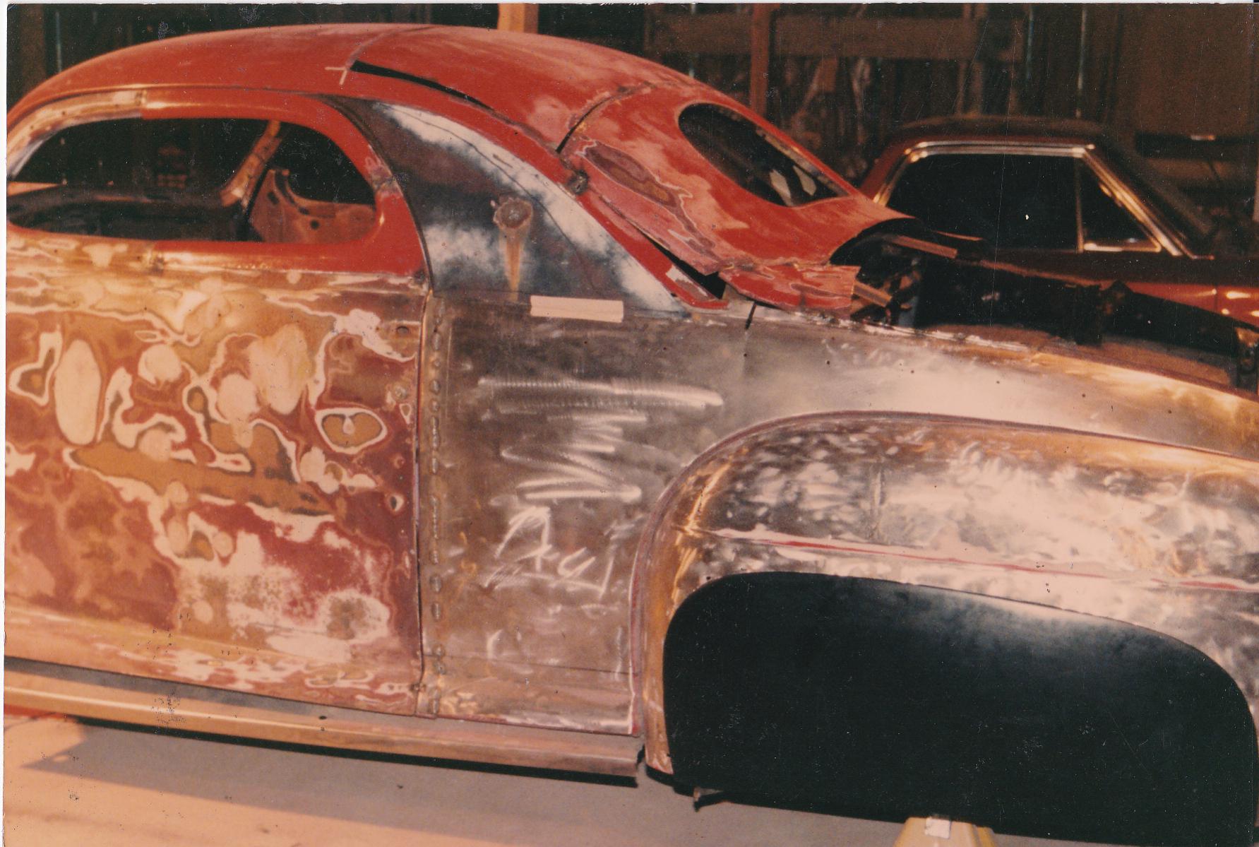

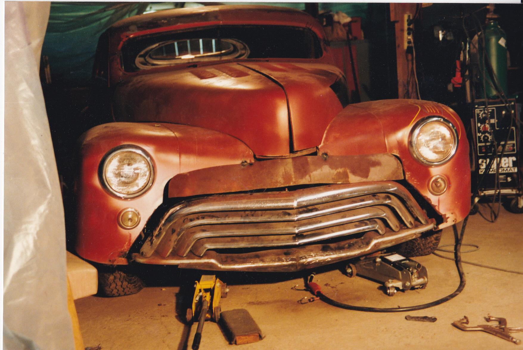

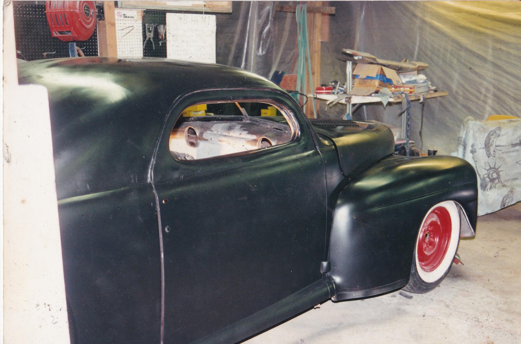

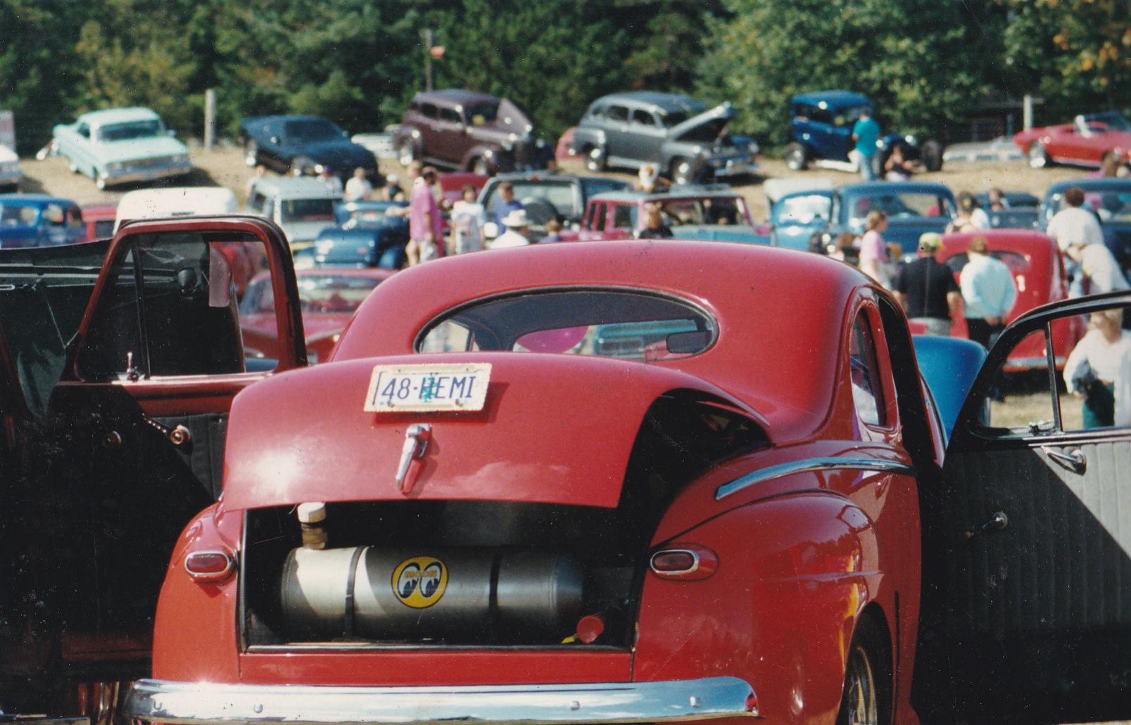

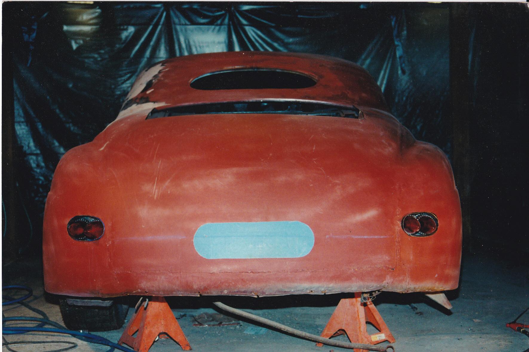

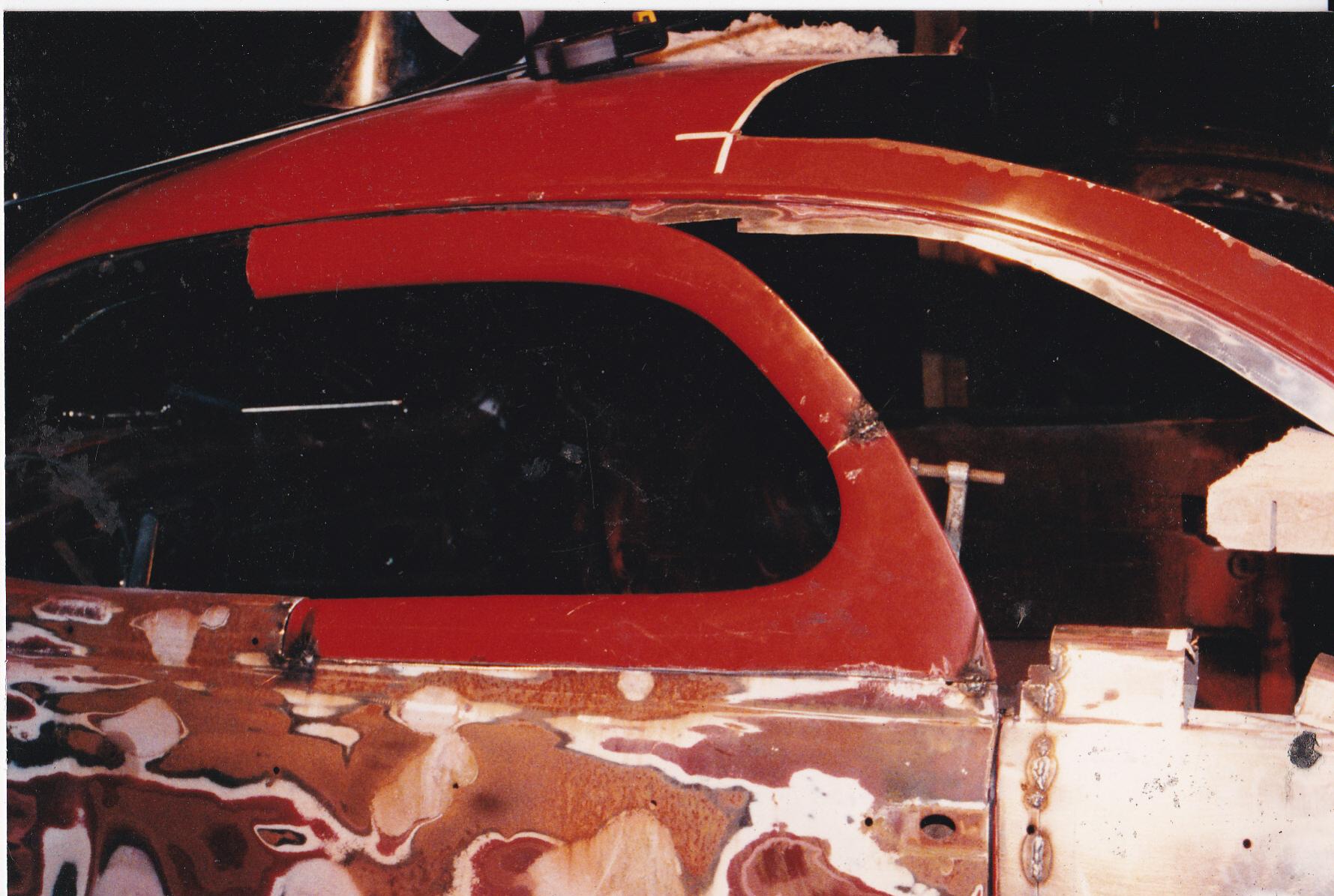

  22. my thing is having enough room to check proportions during the build and at 36 feet,the distance I had to my pondering chair. I made changes then changed things again (probably why it is still a project.)
    If I put the Old grill in and today I would take a little out of the hood and fenders to retain the proportions. I did use the Olds lower grill pan and made my front roll pan using the front section of roof off my parts car.

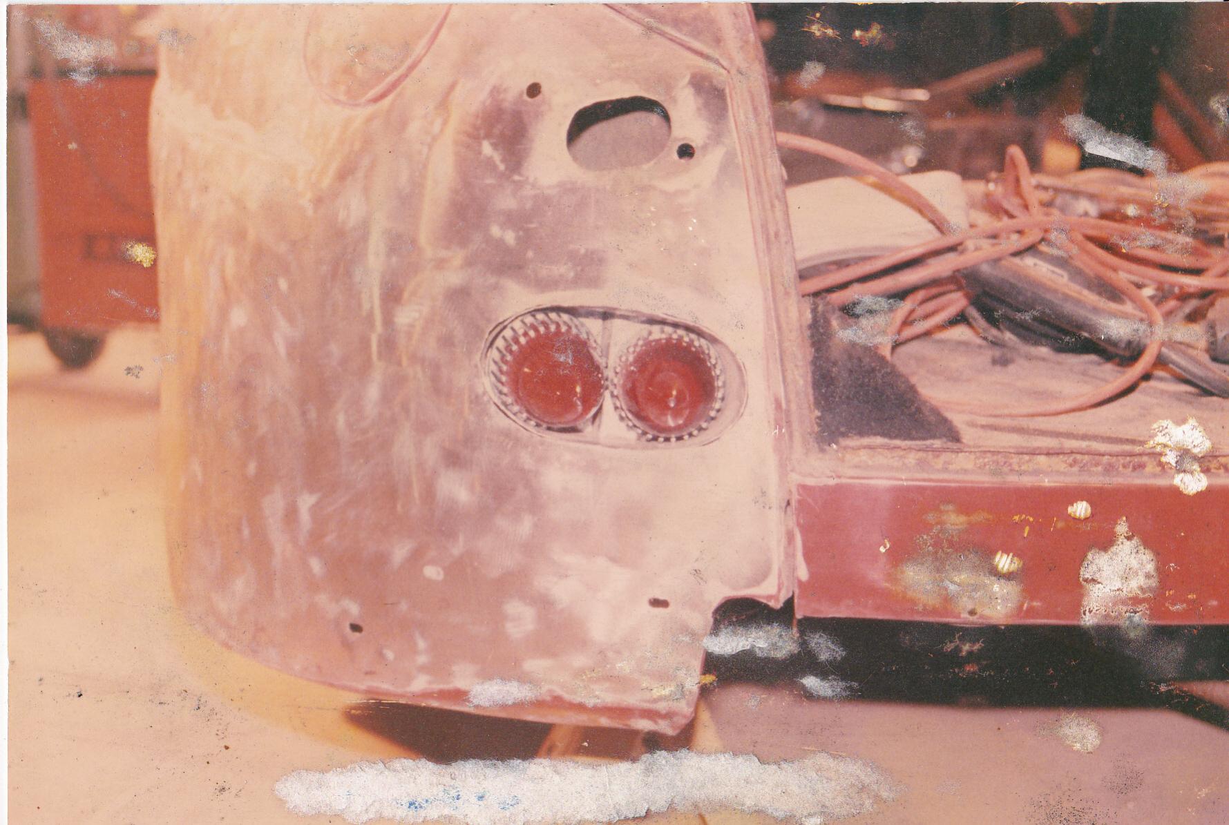

    the back was a challenge because I didn't like the fat body and small roof moved forward. my solution was remove the running boards and raise the rear fenders. I widened them a couple inchs while I was at it because off the HEMI under the hood. it allowed me to line the rear pan for a roll pan

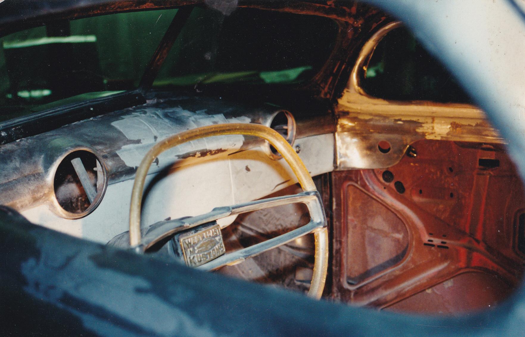

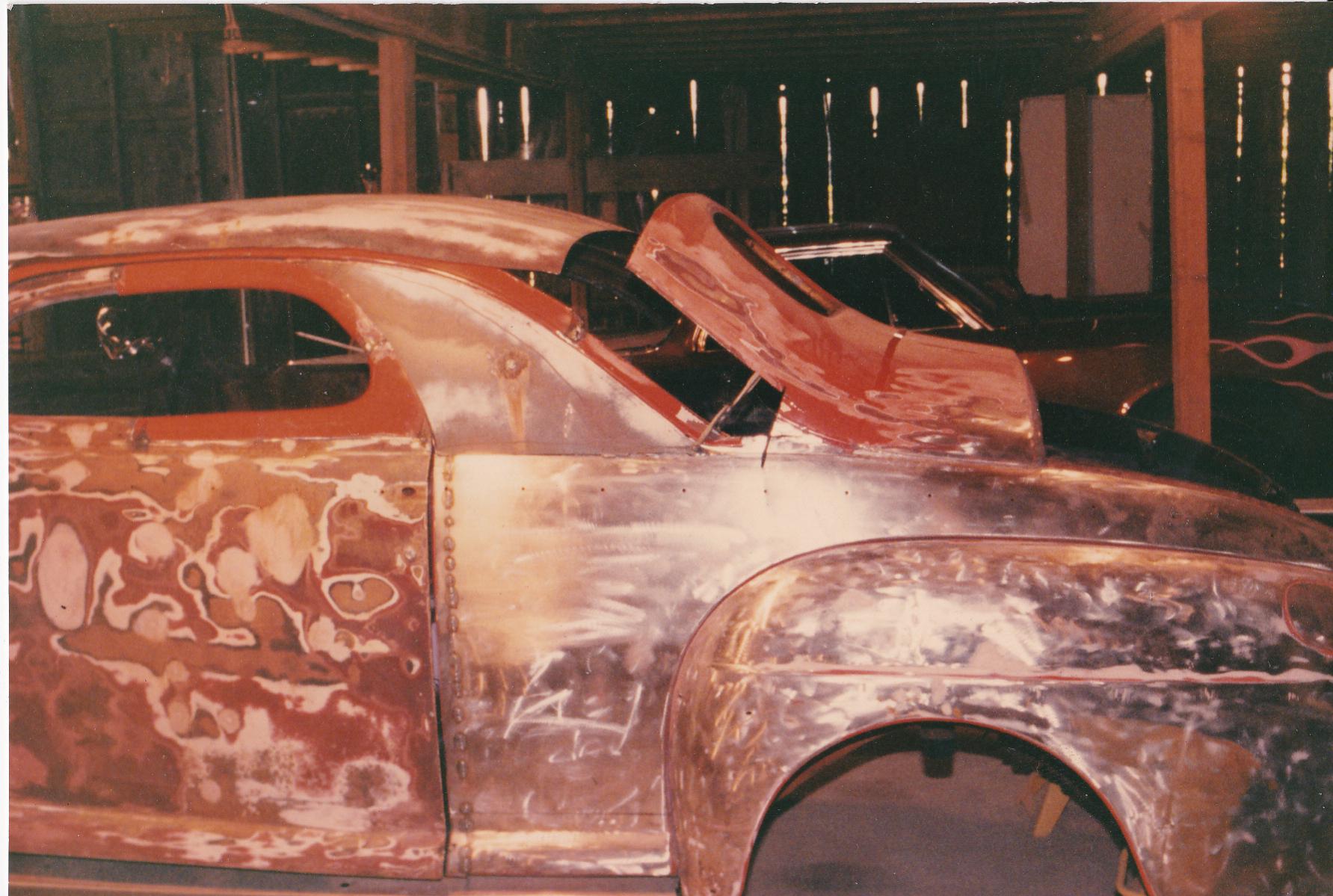

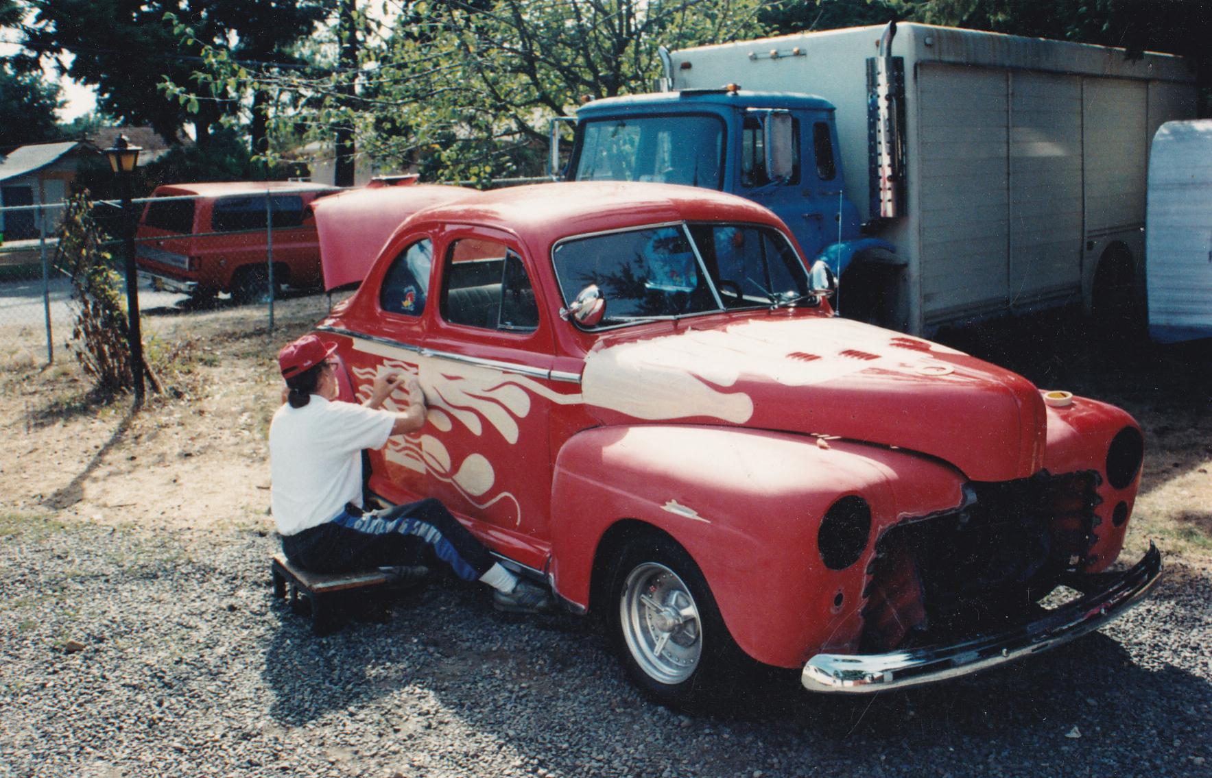

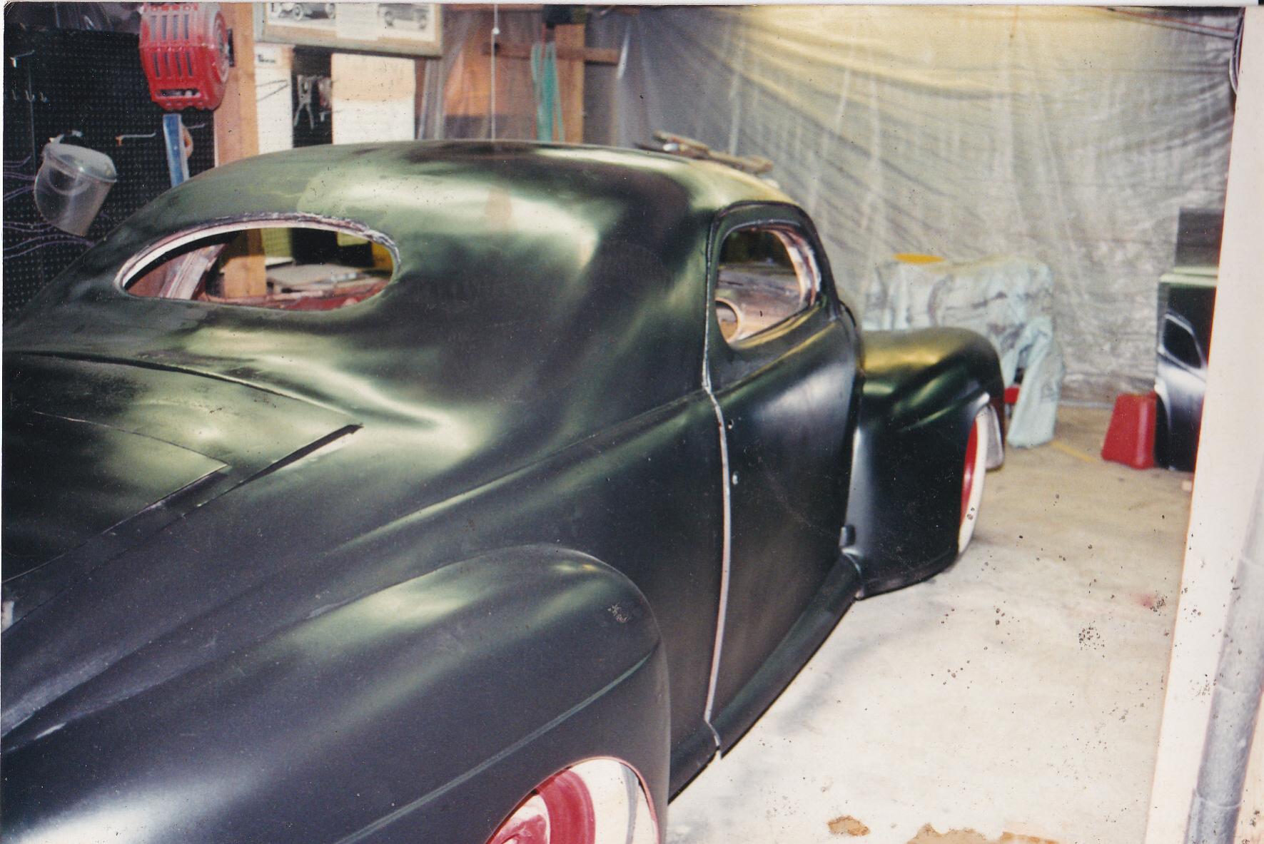

  24. while I have the old photos up. I'm not promoting the 3 window concept. I did mine because my dream of owning a 40 Willy's went up in smoke when they started building gl*** replicas.
    EVL401 likes this.

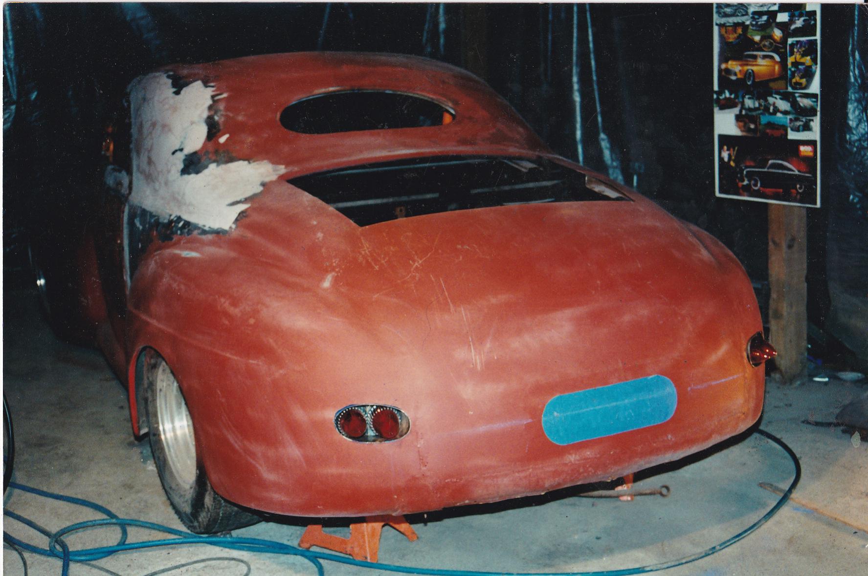

  25. I don't think my build goes with nostalgia even using no new parts.whoops oh yeah got that stinkin 67 912 Porsche sun roof (which was O.K. in 1993 when I built this.
    my favorite parts is the skinny *** and the wrap around 48 Buuick dash and window trims

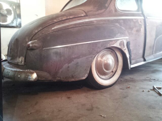

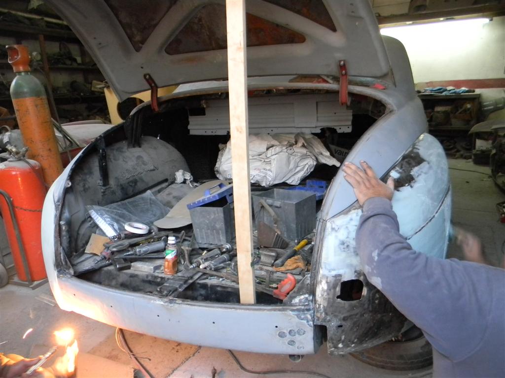

    I am going to run the stock tail lights but we lowered them aboat five inches, you do have to trim a little off the top of the tail light housing otherwise it droops down.

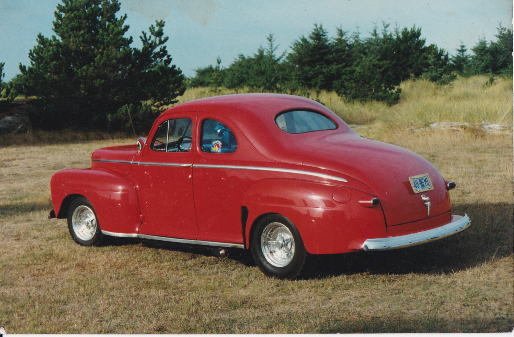

    I am a huge fan of the 1941-48 Fords. As stated numerous times here one of the big draws of this particular Ford is the price. I own a 47' Tudor Sedan that I bought at a great price and did a few minor upgrades. For under 4k I was on the road and cruising. The big attraction to the sedan body was how big the car is inside. I have three daughters ranging in years from 12 to 2 yrs. old. I have been giving some thought to giving the sedan a chop. But as someone stated chopping a tudor sedan can be quite a pain. The few I have seen done have not looked that good which is why I left the car as is for now..... Any suggestions?
    I loaded a picture of what the car looks like. Hope it worked.
