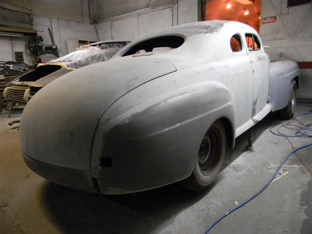

    Well we are finaly back on it, the hardest part to do on a business coupe is the rear sail panel, when the sail panel gets leaned forward , your end up with a half inch gap between the top center of the deck lid and the sail panel, we added on the top lip of the deck lid to make up for it.
