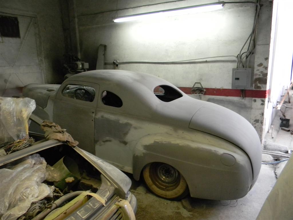

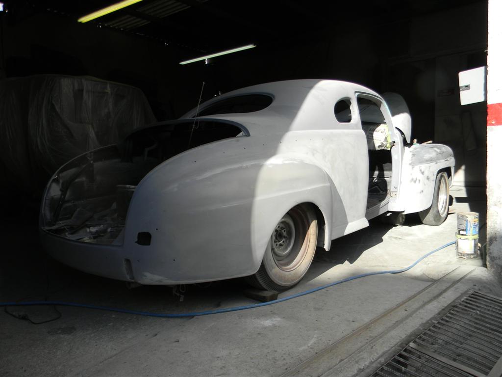

    Well looks like I'll be missing my Santa Maria deadline, but the car is almost ready for paint, I was going to bomb it around in primer for a while but decided to go ahead and get the paint job done, the car is going to be candy apple red and i am using a dark copper orangy gold base coat, I don't like using a silver base coat because the candy apple red ends up looking kind of pinkish, we took the doors off and decklid so we could paint the inner trunk lip, door jams and inner door surrounds, and trunk gutters, with a candy, you have to shoot everything asembled and there is no time for detail work. I'll try to get grease machine to post some pictures next week

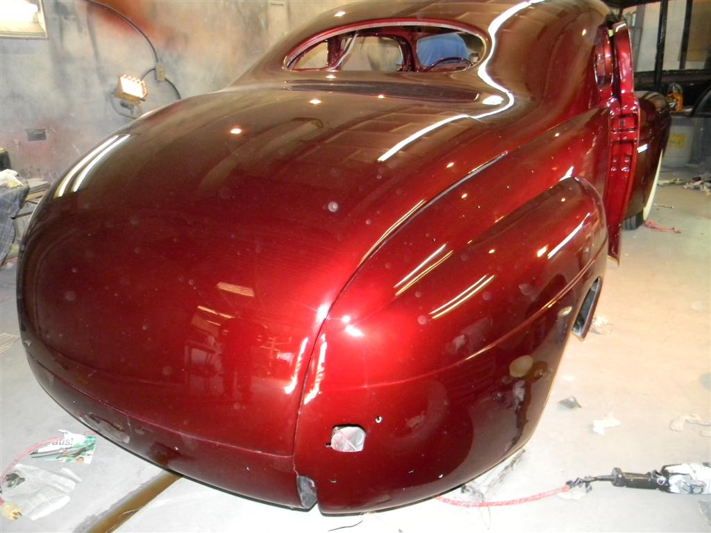

    If you guys noticed, we lowered the mounting whole for the rear tail light aboat three and a half inches, this changes the angle of the tail light housing so a section will have to be cut out to correct this and at the same time , you end up with a shorter and more sutle tail light, we also removed the trim on the top of the tail light, I dig the stock tail lights and with a little work , they can be made to look good and is a different aproach to the useall 50 lincoln tail lights or the 46 bumber guard ones, all three aproches were used on traditional customs back in the day.

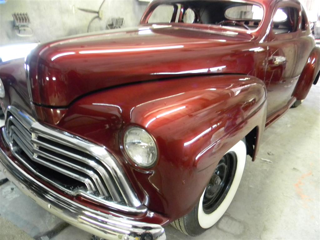

    update on Miguels 46. Turned out real nice!!

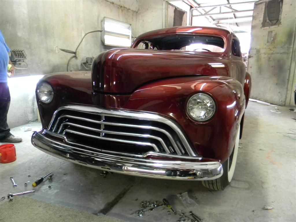

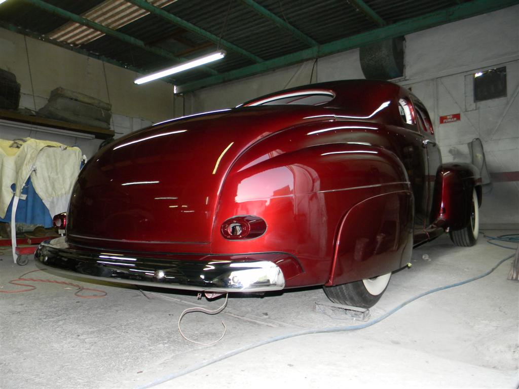

    Thanks Rikster, I think leaving in the original lower piece on the grill helps alot, otherwise , the grill looks too thin for the poportions of the front clip, the lower nose piece was made with the front section of a spare hood I had.
    I too love the look of the olds grill on these cars, it gives them a bad ass attitude and makes them look like a piss off prehistoric fish. thanks again for the compliment for I value your opinion alot.

    Miguel, I never really noticed it before until I looked at the painted car today and went back to see the primer version. But what was done to the front wheel opening? It looks like it was flattened. In a similar fashion as on the Jack Stewart Ford, but then with nice round corners.
    Did you do that, or was that on the car when you bought it?
  23. magoozi
    Joined: May 20, 2009
    Posts: 1,800
    magoozi
    from san diego
    Rickster we filled the top of the front fender radius, this is an old custom trick that gives the illusion of the car being lower and matches the bottom edge of the rear fender skirts and yes we flatten the sides of the front and rear fenders a little and took out the factory bow, the front gravel pan is a mariage of 47 ford and oldsmobile. the rear inner fender supports were narrowed also so they would match the new contour of the fenders. Rear tailight pods were lowered and narrowed I'll get Grease Machine to post some updated pictures of the car, still trying to figure out how to mount the rear licence plate, your imput would be of much value to me.

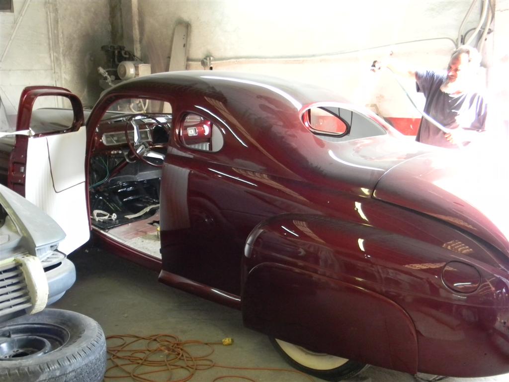

    more pics update.
