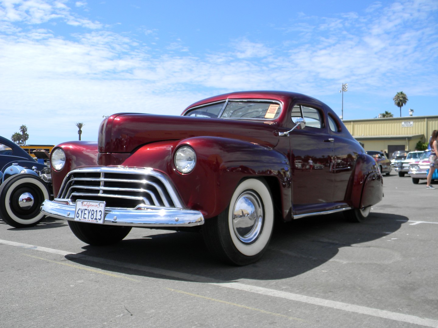

  12. Greasemachine
    Joined: Feb 3, 2007
    Posts: 153
    Greasemachine
    from San Diego
    First time out! At the Ventura Nat
    EVL401 likes this.
  13. Chris
    Joined: Jan 5, 2005
    Posts: 14,500
    Chris
    That coupe is *****IN!!!! ^^^^^^^^

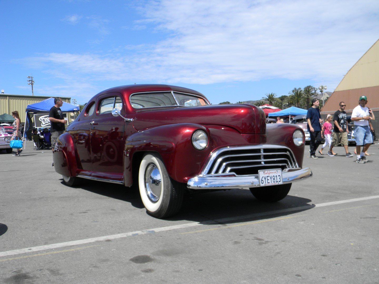

    If you notice, the car is 46 but I am running 47 trim, ford did'nt make a 47 business coupe so I'll have to lengthen the quarter trim and shorten the door trim belt mouldings, I like the nice smooth look of the 47-48 trim. color is a dark bronze with burnt orange effects on the base coat, tint is candy apple and then clear coat, we color sand alot which gives the paint a nice depth , much like a laqure

  23. Rikster
    Joined: Dec 10, 2004
    Posts: 5,795
    Rikster
    It looks fantastic outside in natural light magoozi. Congratulations.
    I only feel that the tires are wrong for the car. They look to be to tall which put the car up in the air to much. Looks like they are tires for a late 1950's car. To much black outside the white wall section.

    Thanks for the compliments Rickster, ya the tires are more for a caddilac and I do plan to change them to some lucus tires that are a bit shorter, lucus has the nice wide whites with the pie crust design so when I get some more money , I´ll change them out.
