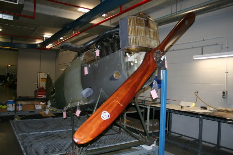

    Apoligies to the Aussie blokes who have seen this on the site here at home, but I thought a few of the US blokes might find this interesting.......
    Fabric covered bi-planes are a thing of beauty. They remind me of a time of T models Fords stripped down for racing, a period in time that most don't assocciate technology with. A time of excitment with new found speed and power. A time of the waxed moustache;)
    These blokes were the real pioneers of horsepower and speed.
    It feels really weird to know that I will be working on 1 of only 2 original Albatross' remaining in the world, a machine that , in its time, was the most feared peice of steel, timber and fabric in the skys.
    There's a great story linked to the shooting down of this aircraft during the war, and we are hoping to find the bullet holes when we undo a restoration that was carried out in 70's.
    We have a problem with the doped fabric continuing to shrink well after the application time, like 30 odd years after :( Being a mostly timber frame, the fabric is twisting the timber as it shrinks. To prevent the timber frame splintering, we have cut the fabric on the wings, and are currntly investigating different techniques for covering fabric aicraft. I'll try to add photos as we work through the conservation of this rare aircraft if any one is interested. Moderaters, feel free to delete if considered to far O/T

    MCQUEEN, unfourtunatly, the "bags" need to be shrunk over the frame to even look right.
    Another shot, I'll take more throughout the process. The bare frame should look kool

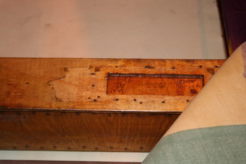

    TBit of an update. Yesterday we started to remove the fabric on one of the lower wings. we just started at one end and couldn't believe our luck, found the original manufacture date stamp within the first minute [​IMG] 3.8.17
    This aircraft was downed December 1917, mking it only 4 months old. This was sort of like an ID plate, with a thin sheet of clear lucite tacked over it. Two small pieces on the corners are still there.

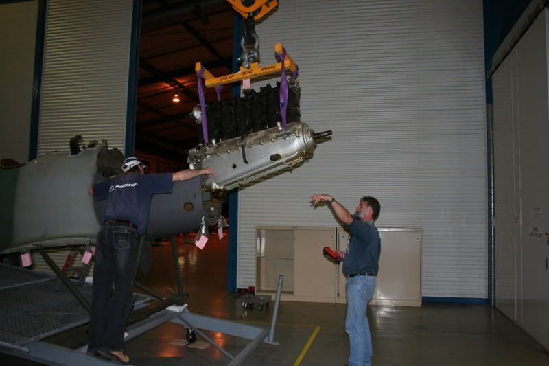

    A little more progress the last few days, Engines were removed from both aircraft......
