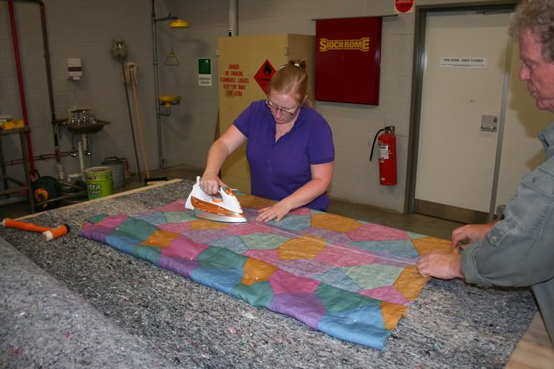

    After the fabric had been laid out, we measured off the original fabric and put all the seams at the same measurements as the originals. This took a little longer than it would have just to slap it together as the fabric fell, but then it wouldn't have been 'right'.
    Here Jesse from our textiles lab and our Curator sew the seams for one of the lower wings under side skin.
    Next, all the seams were ironed so they would lay flat.

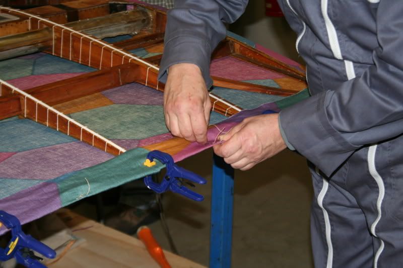

    The next step is to flip the wing over, and trim the fabric down to size. The leading edge, wing tip, and wing root are all glued down using a glue similar to PVA wood glue. This is then 'set' with an iron.
    The fabric is then pulled again towards the trailing edge, and, just when you thought you were done s***ching, yep, more s***ching [​IMG] This time it's the trailing edge around the fabric wrapped wire. These are just holding s***ches to keep the tension on. The full length of the trailing edge had to be hand s***ched. Glad this wasn't a Tri-plane!

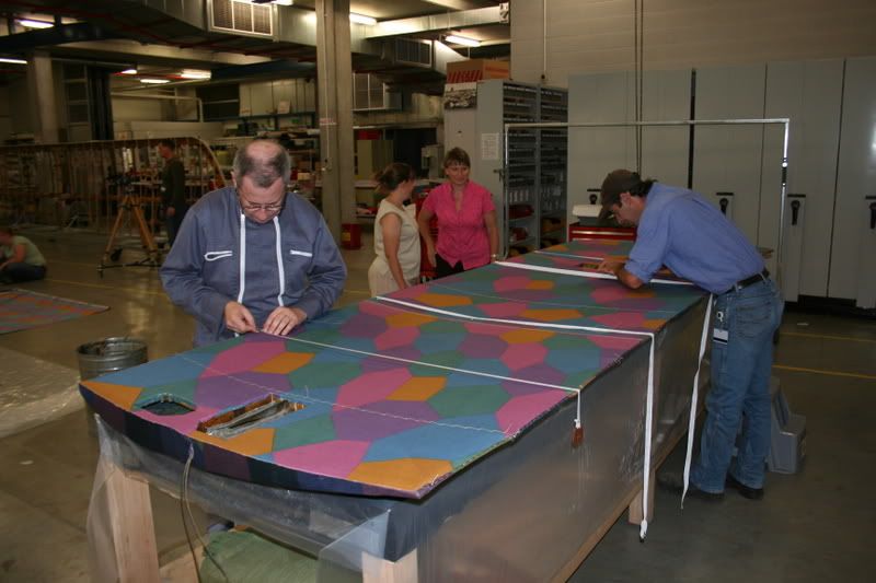

    Once the wing was completely covered, we tacked the fabric down to the ribs on the underside of the wing with small br*** brads.
    After double double double checking position, we cut out the fabric for the access hatches.
    Then, yep, more s***ching. This time the fabric to the thin cotton strips that we sewed onto the ribs way back in the beginning. The white cotton strips hanging over the wing are just a spacing guide for the stiches, to get them nice and even.

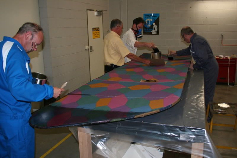

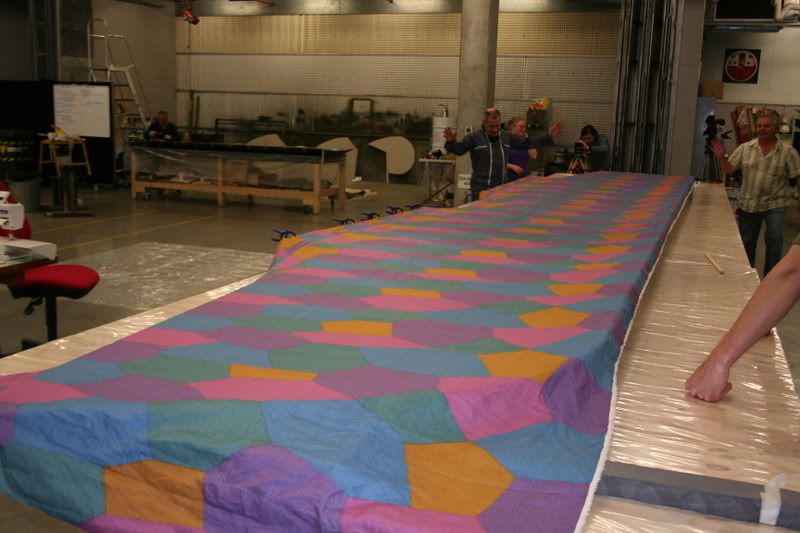

    Here's one of the lower wings after having to coats of dope. You can see the fabric has just started to tension up, but it actually looks worse than what it did before any dope was applied.
    Here's the upper wing, all 9 meters of it, with the plain non printed fabric on the top side
    And the lighter underside printed fabric on the lower side
  12. jimbob
    Joined: Jun 29, 2004
    Posts: 1,222
    jimbob
    After 2 coats of dope, strips of fabric are then doped over all the s***ching. After these are stuck down, another 3 to 4 coats of dope are applied to the fabric, until you end up with something looking like this, a finished wing, well, nearly finished.
