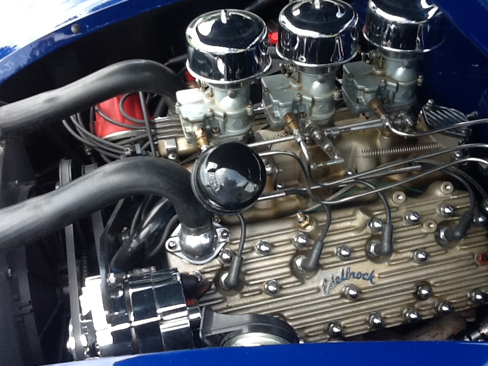

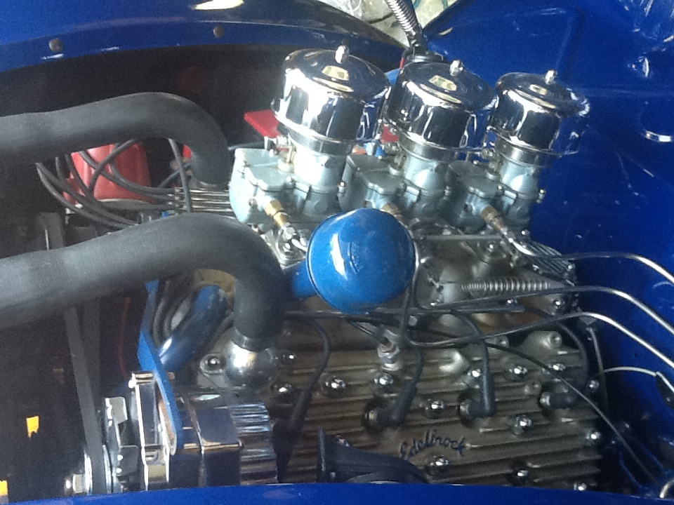

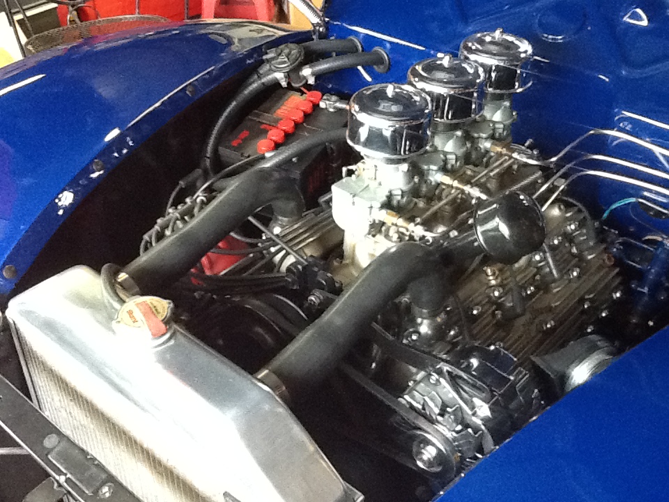

  4. Bigmac48
    Joined: Apr 3, 2017
    Posts: 680
    Bigmac48
    from Dundalk Md
    image.jpeg image.jpeg image.jpeg View attachment 5005998 image.jpeg image.jpeg image.jpeg 48, probably won't help but here are a couple of my 3 two set up with an alternator .tried to delete duplicate pictures , sorry

  11. BJR
    Joined: Mar 11, 2005
    Posts: 11,582
    BJR
    3 carbs are useless on a flathead Ford motor. On a bigger V8 they work, like a 389 Pontiac or a big block Chev or Mopar. But on a flathead way over carbed.
