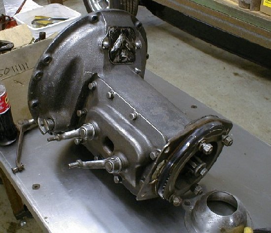

    Here is my `46 Sideshift-box with a `32 Mount. The cast-piece is from a `32 box , the steel-plate with rubber , can be bought new. Bolt-on , no modifications needed.

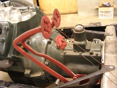

    Close-up
  6. I was confuzed by this one also when I was trying to mate my 39 box up the the 32 k member. It's just like in Klazurfer's photo's, the plate (once again avail new) bolts right up to the k member. I don't know how the application will change with an open driveline thrown into the mix but I'm assuming you'd have to hack away at the k member and use 33 up style mount with the ears on each side or better yet use an easier to find f1 pick up style crossmember and save hacking up that deuce crossmember...

    Buy the rubber-and-plate portion new from a repro parts dealer, and the cast piece comes from a 32 to 36 Ford only. I don't think anyone repros that piece. And it is required, because it seals the back end of the tranny and holds the bearing in. Also holds the front of the torquetube in place.
    If you are going to an open driveshaft, don't use these pieces. You will need the tail, output shaft, and accompanying pieces of a F1 pickup trans. But there will be no "bolt together" way to install it in the 32 K member. Gonna need to fab some mounts then.
