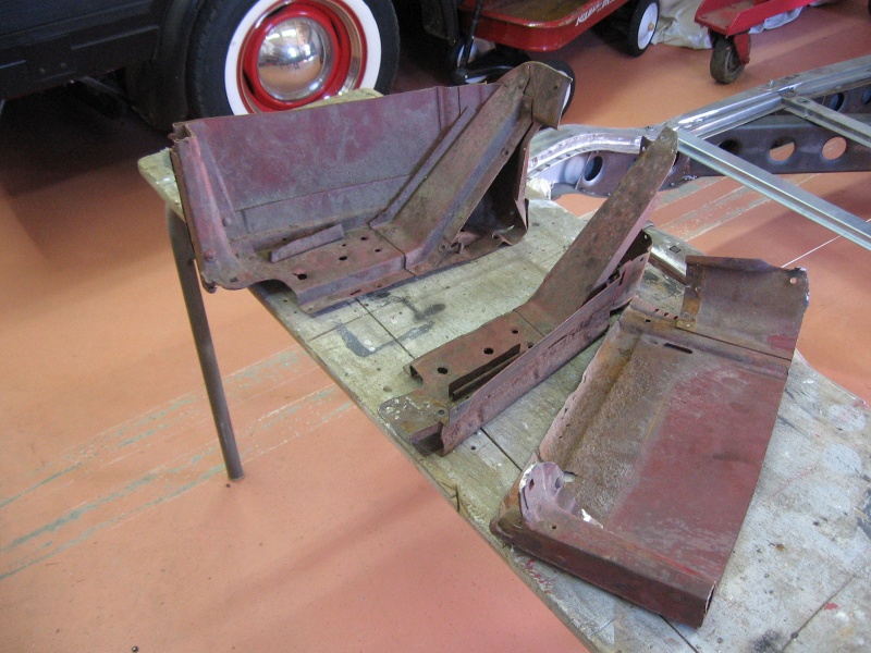

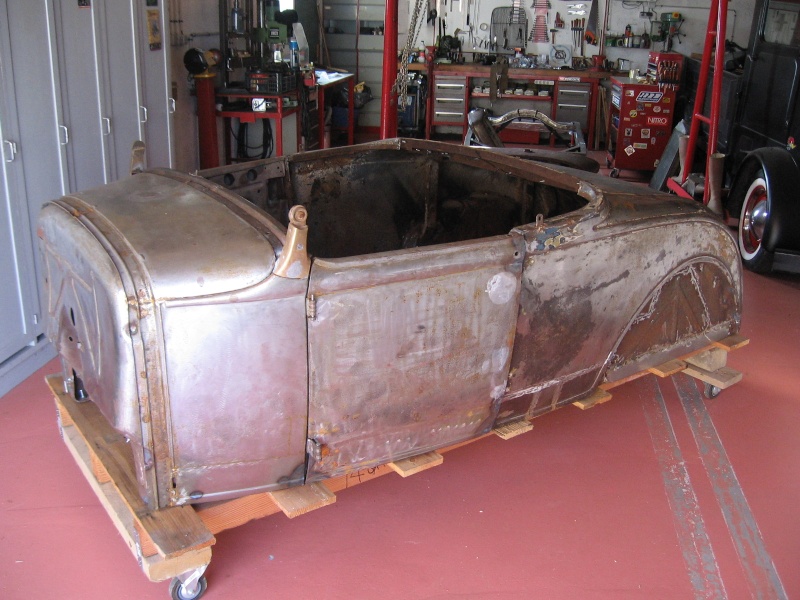

    After one year of waiting and searching. I bought this body A 30/31.
    It is not in good condition, it is built with pieces of several car, some different parts will be changed. But no choice, I should not p*** up.
    A new body is too expensive to import, and they do not have souls like a vintage. But for sure, there will be many more hours of work...
    before sandblasting
    after sandblasting :(
    the pinch are not so bad.
    first approach with the ch***is, the grinder will enter into service soon ... :D

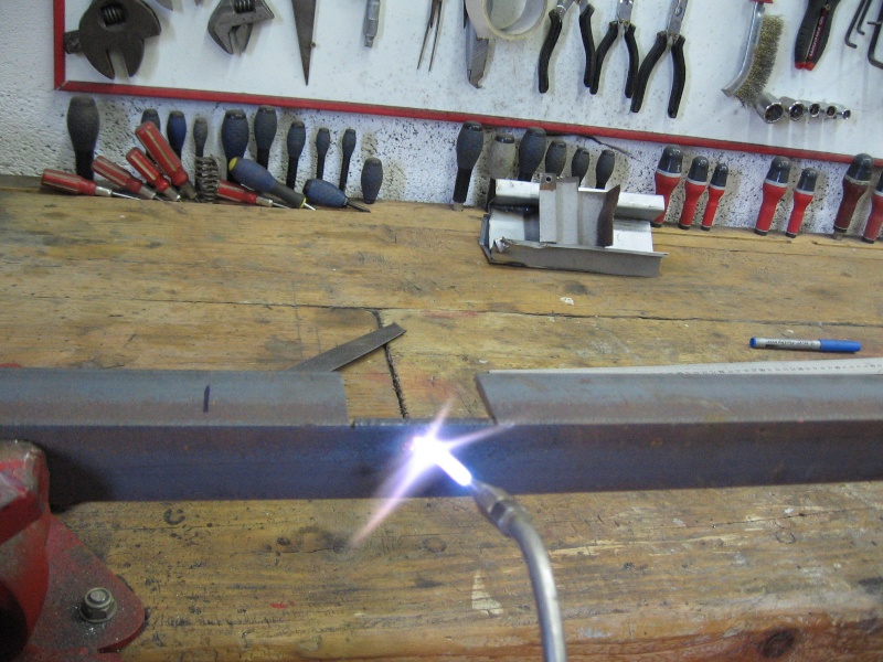

    the best friend of hotrodder is the grinder :D

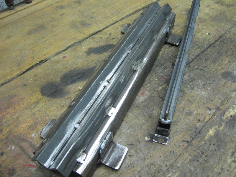

    cut sub-rail extension, for a light channel.

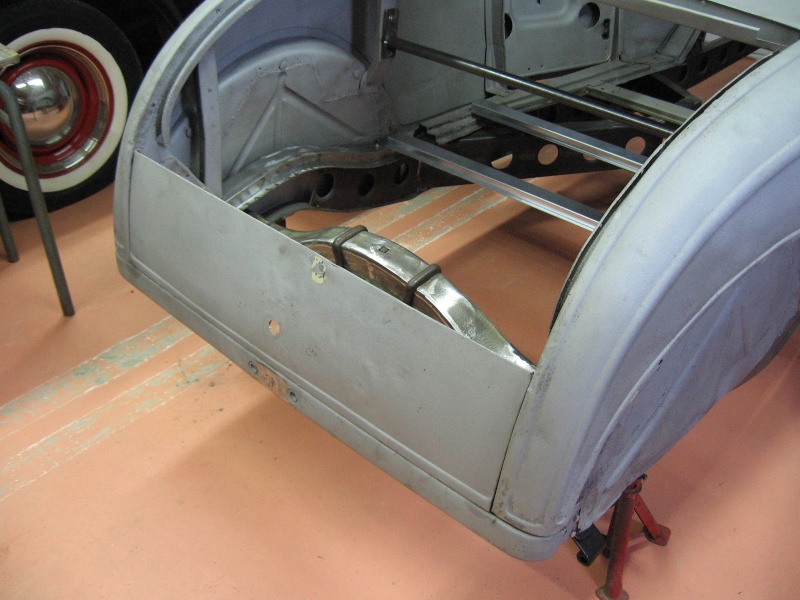

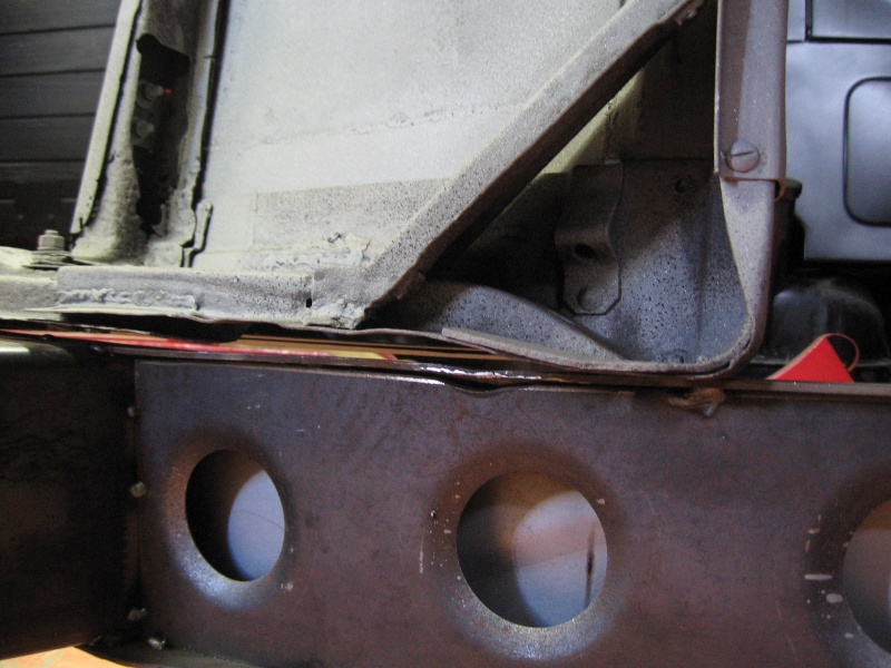

    and the rear now...
    the body takes its place on the frame. :) we can see the poor condition of the sub-rail...:(

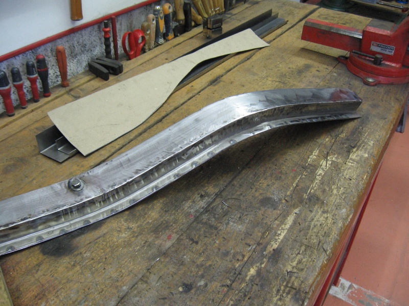

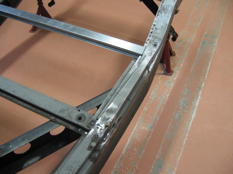

    Implementation of the new rear sub-rail.

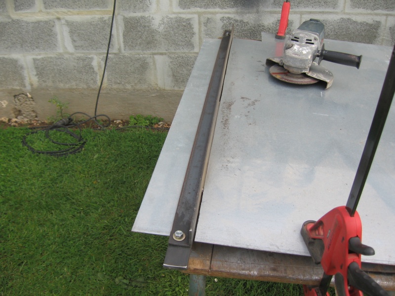

    creates a small simple folder with a piece of angle iron.
    :D

    Very nice work. the subrails came out great.
    You're a talented guy.

    Thank you, :) but this is the shrinker / stretcher that does the job. ;)
    this is a great machine.
