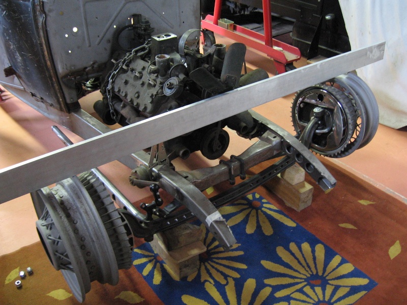

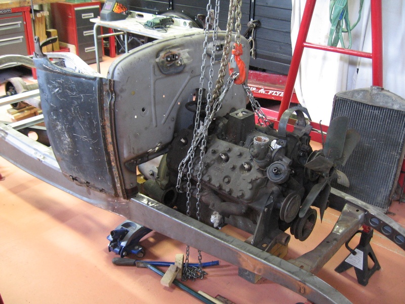

    I can now find a place for the engine, a big engine for a small place ....
  4. frenchjack
    Joined: Apr 3, 2011
    Posts: 67
    frenchjack
    from france
    Water pump modification, They are too wide.
    engine in place, this is a big step ...

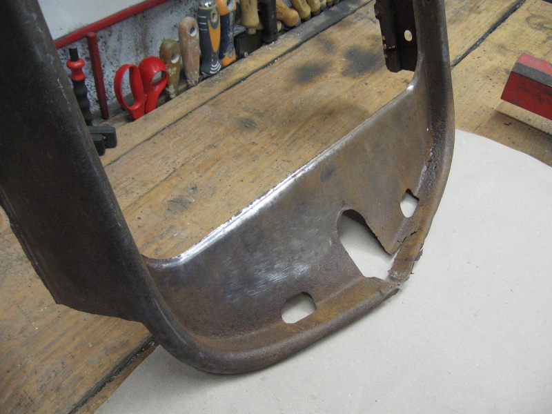

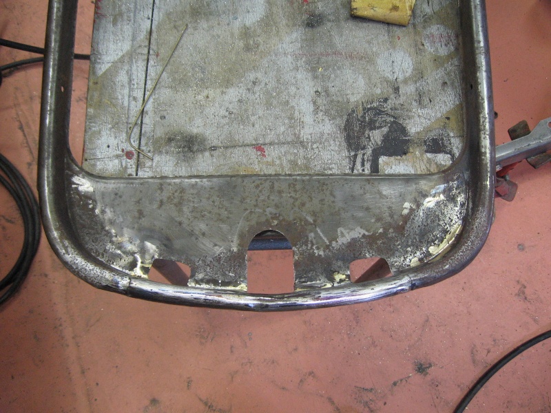

    Repair of the 32 grille shell
    509garyd likes this.

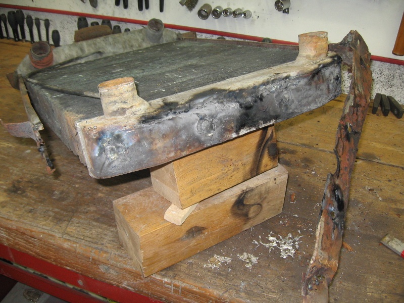

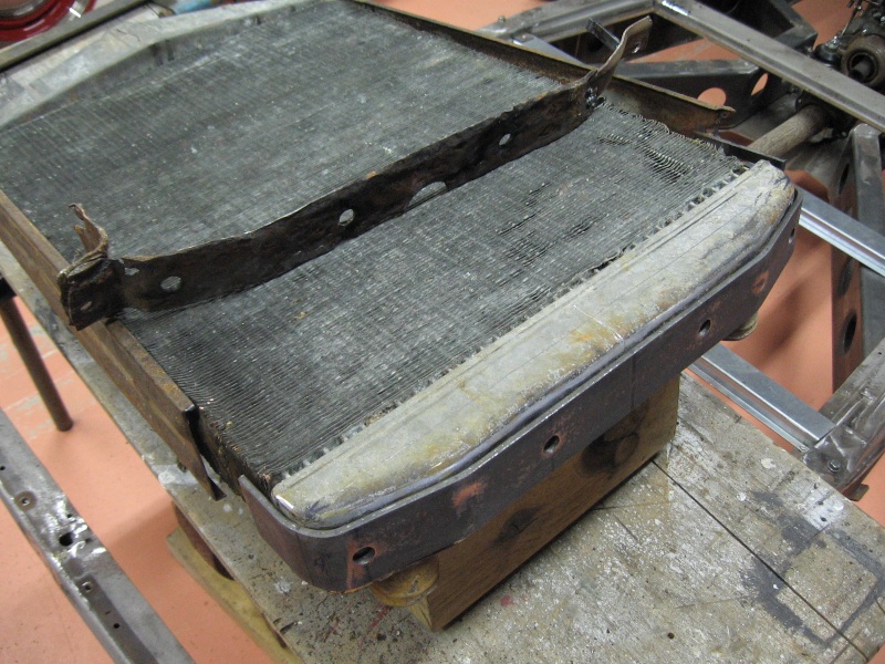

    The old radiator, find in a wood, long time abandon...
    Make one emblem with two in poor condition.
    I will must shorten the radiator and at the same time change the honeycomb (maybe this is not the same expression in English) the center of the radiator?<O:p</O:p
    Please, how many inch should I shorten it, to you?<O:p</O:p

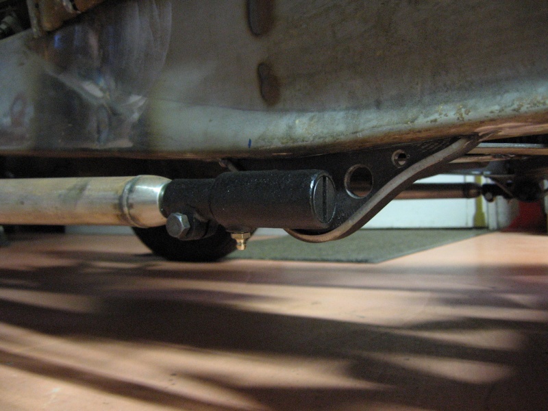

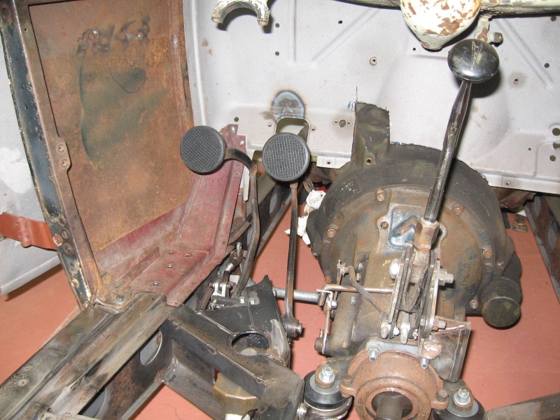

    installing brake pedals and clutch from 40 Ford.
    making bump stops with parts from taps. :D

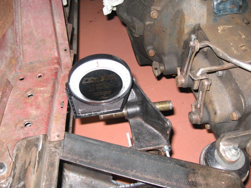

    Now that the pedals are installed, I can present the Schroeder steering box.
    A jig PVC plumbing :D to see the clutter and make a precise hole in the colw.
    For attachment,I got inspired of the " wade coupe" from master B.B***.

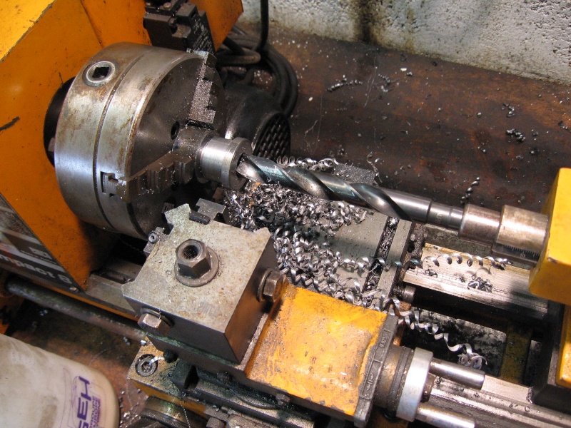

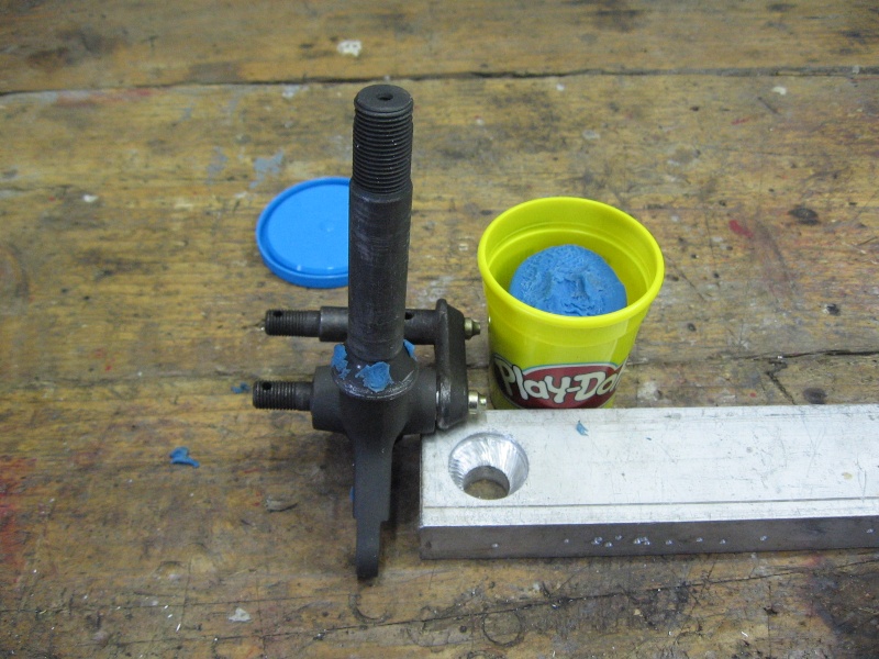

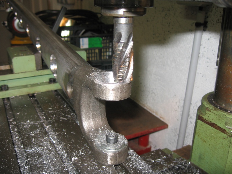

    Bad surprise :( the spring perch of origin are too short compared to the wishbone aftermarket.
    *t******* a 28.5 mm drill bit.
    *Test.
    *it 's OK :)
    Wishbone machined
    *spring,

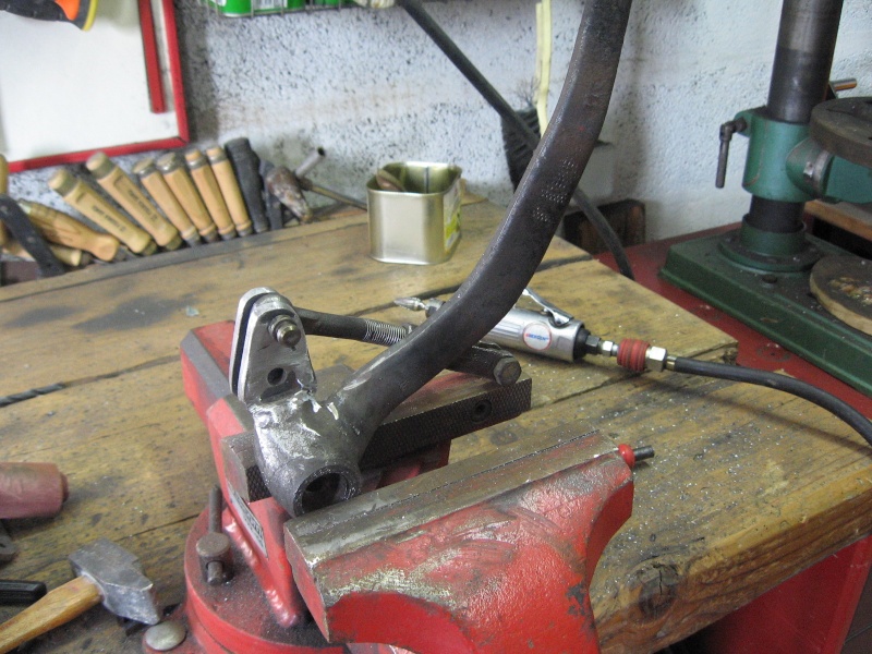

    from france
    Few months of research to understand and find the right parts with good threads :rolleyes:
    Finally found a good pitman arms with the correct diameter hole...
