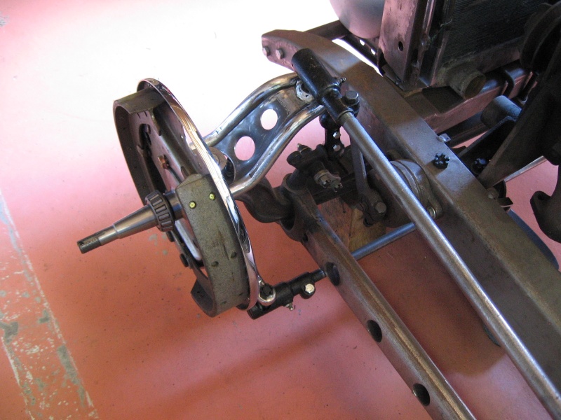

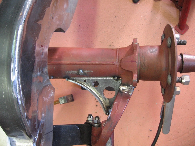

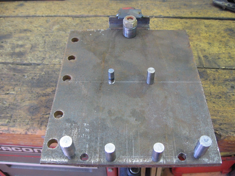

    As Master Tardel said, in his book. the Steering arm must have has a ratio of 0.85 to 0.96 per-report at pitman arm. For driving comfort. I must also align the drag link per-report the wishbone. Although my case was not quite the same ratio that Ford F1 housing. Only felt a road test can tell me if I should make a more or less long.
    Manufacturing a sleeve with inter conne 7 ° for the ball.
    Manufacturing of marble.
    Some heaters torch ...

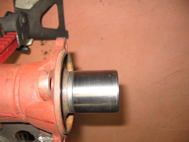

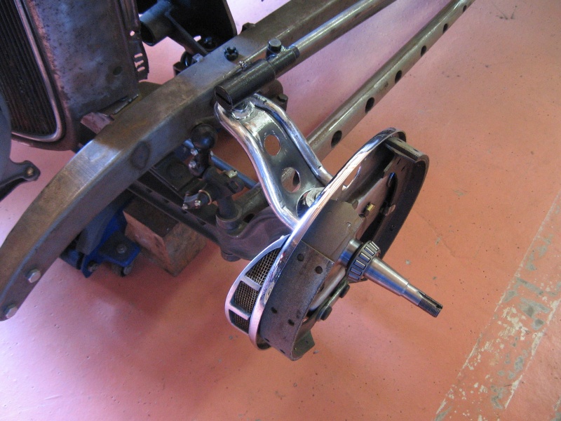

    Rear axle ford 46/48 (so large...) but not easy to find one early in my area... :(
    New bearing race.
    Anticipate the quick change.
    Finally on its wheels, it's a great time it becomes a car. I can, move it, in the garage. :D

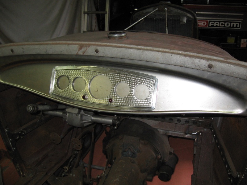

    Construction of a flat bar rolling machine with distribution rollers.
    test with a fine piece, it's crazy ! it work without forcing

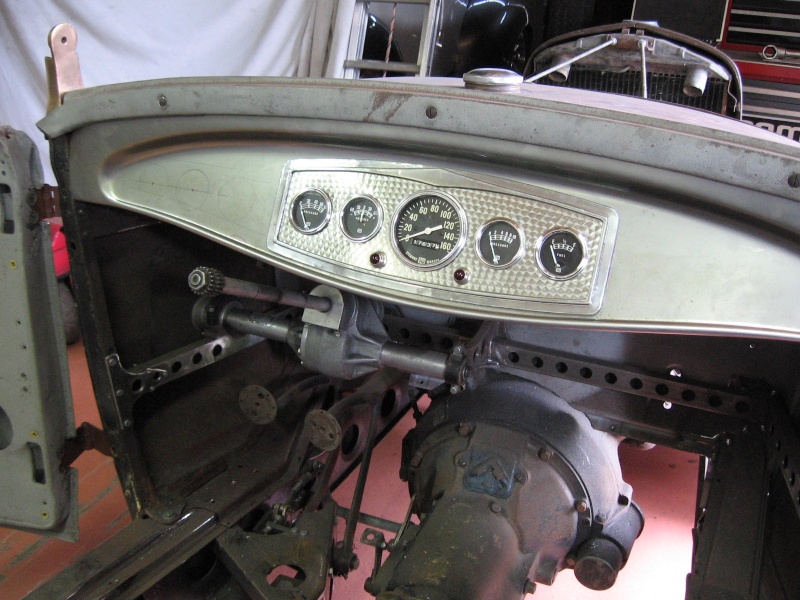

    reinforcing the underside of the dashboard
    I can now place my dashboard.I really like this dash. :) I waited a long time to find it and also find each gauge.
    normally the speedometer should be a 100 mph but a well-known seller never sent me the speedo after paying ... :(

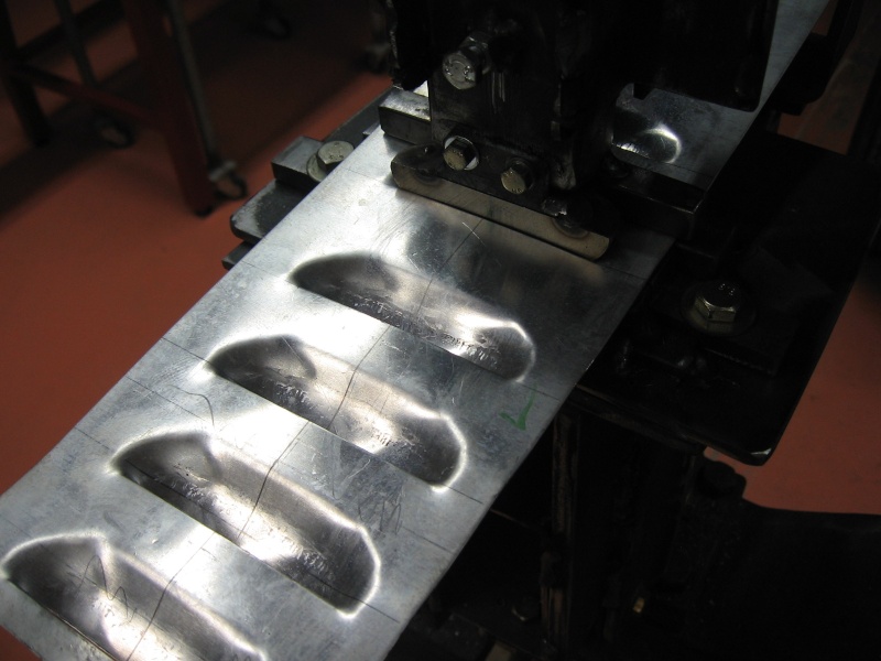

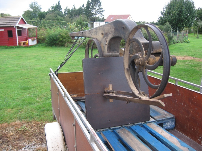

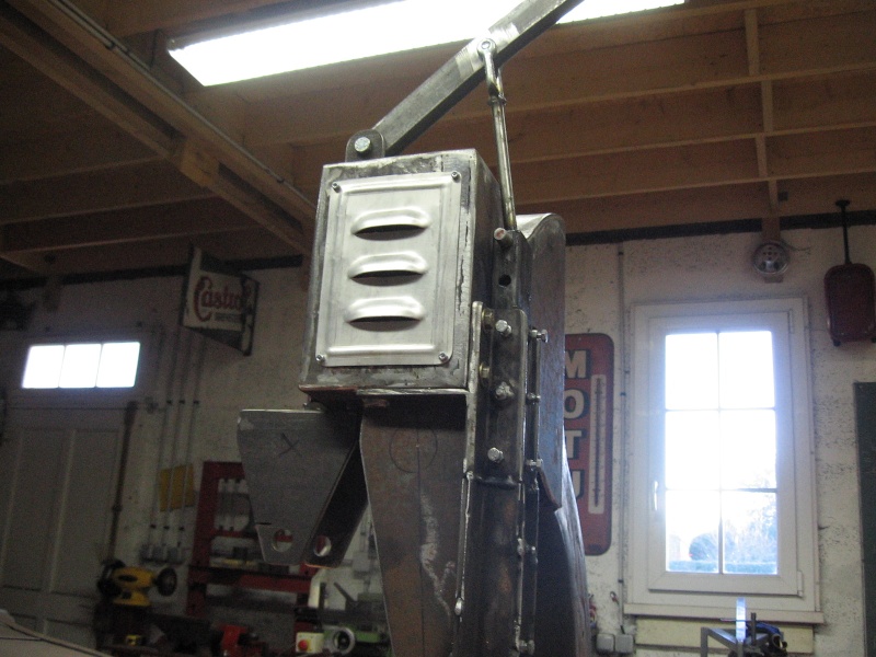

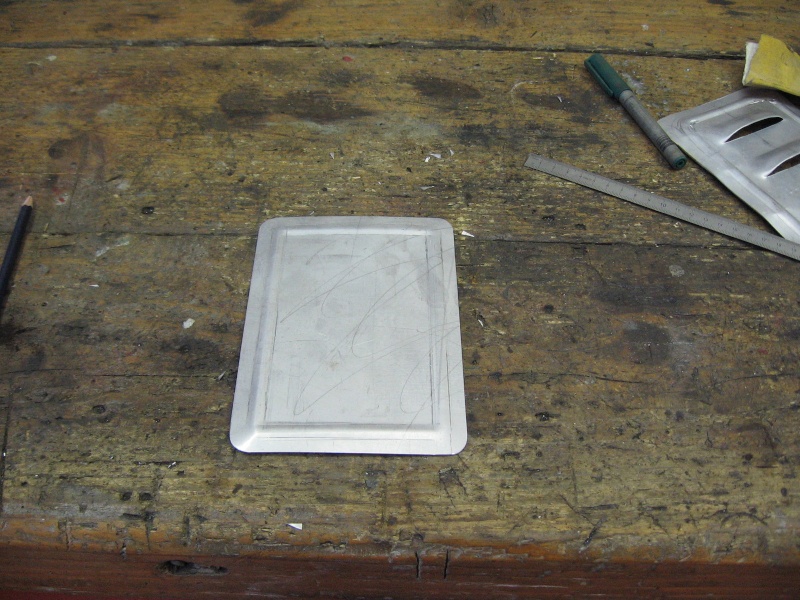

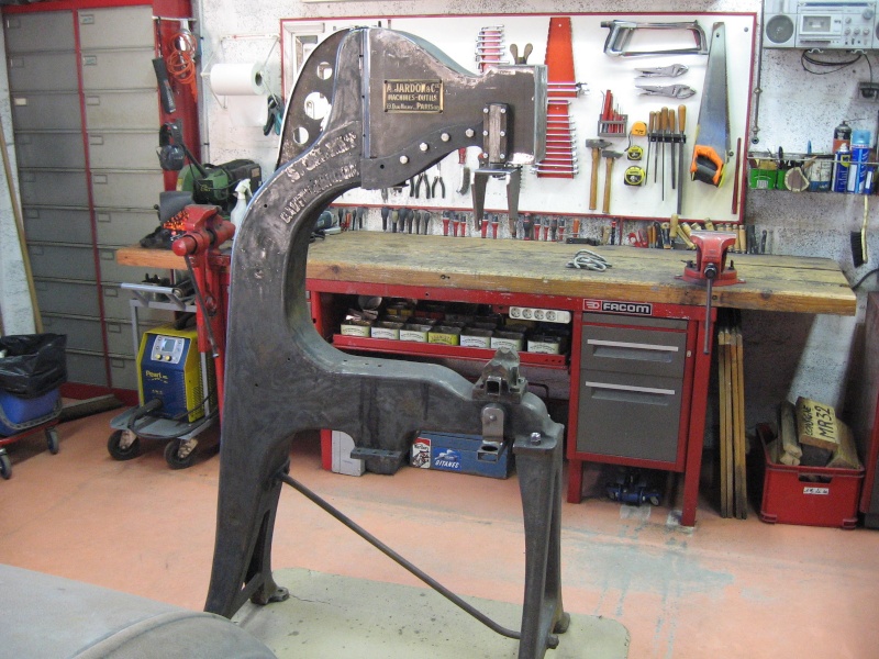

    new tool, with the base, a carpenter band saw :)
    English wheel on one side :D
    louvers press on the other side
    The mess :rolleyes:
    first test

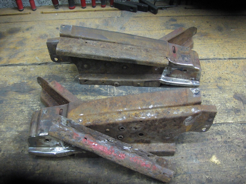

    With the holidays of Christmas, more time in the Garage ... bodywork session :D
    phosphorique acide

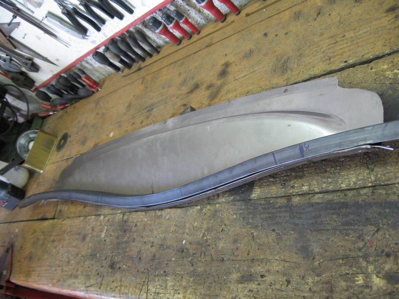

    New quarter panel (not perriod perfect but the old are verry bad)
    I broke my piggy bank :(

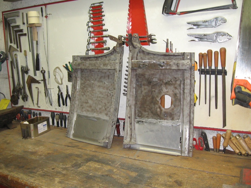

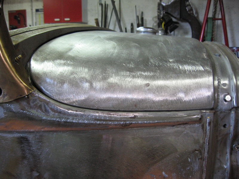

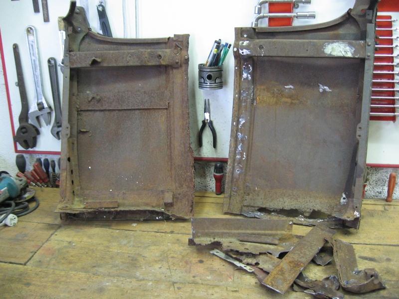

    repair of cowl
    someone has lived here !!!
    and more it stinks... :confused:
    reforming the line
    Jet96 likes this.

    Great build, outstanding skills and craftsmanship !....one question, you are going to reinforce the hell out of the left side cowl section and VERRY SOLIDLY fasten it to the frame to handle the steering input loads correct?

    To Kingford: Yes I will have to strengthen, the first installation seems to feeble.
    I have never seen in real, this ***embly. I try to watch the video or photo report of the rolling bones carefully ;)
