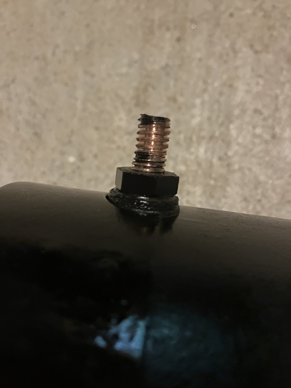

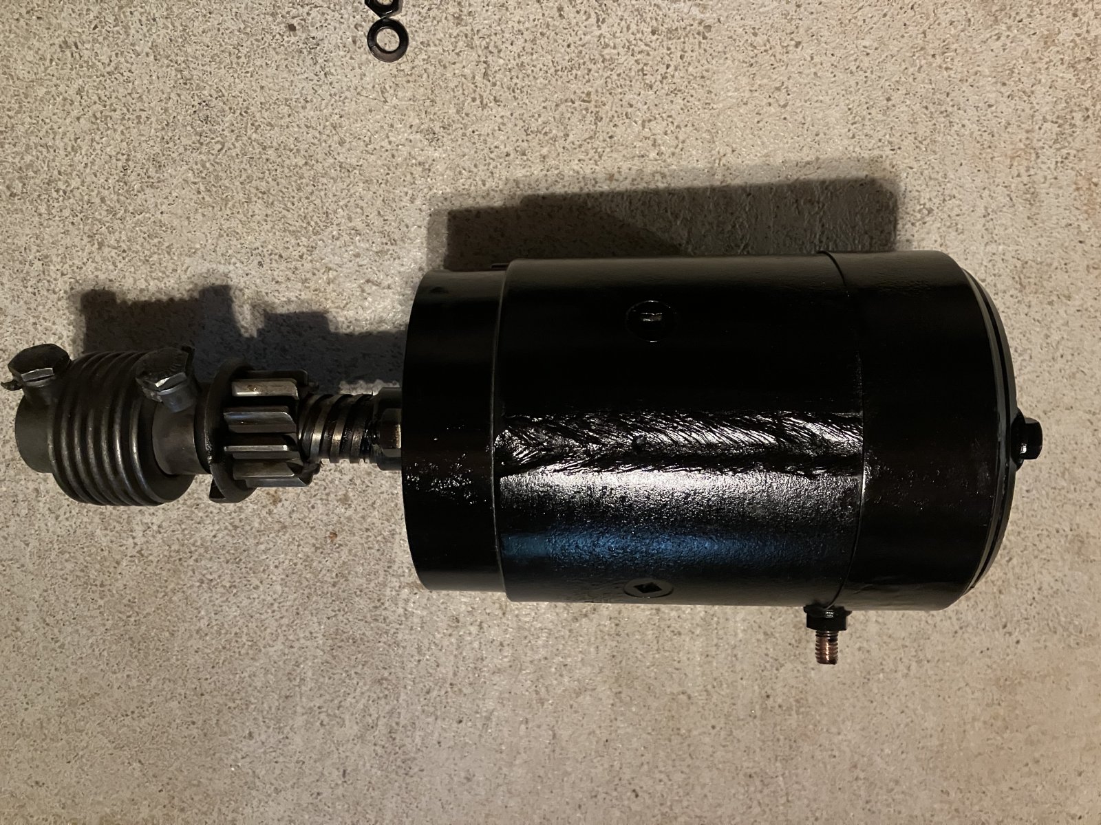

    Also I dis***embled the starter everything looked great so I cleaned greased and re***embled
    I then noticed that the terminal bolt was stripped I rethreaded it but I think what I will do is cut it off and install a coupling nut in place of the first nut and then either use a bolt or stud to attach the cable The thread under the first nut is ok IMG_4867.jpeg You can then hold the coupling nut with a wrench when you tighten the cable to prevent everything from turning IMG_4865.jpeg

    Took some time this week to get the generator projects off of my work table which is also my pool table (would like to actually use it for its intended purpose )
    Got the armature shaft cut down for the modified generator IMG_5234.jpeg then got the mock up armature shaft machined for the cutdown generator IMG_5232.jpeg it had one groove that didn’t clean up I think it will do IMG_5230.jpeg IMG_5231.jpeg IMG_5233.jpeg these projects aren’t actually finished but they will be going back on a shelf for the time being IMG_5237.jpeg
