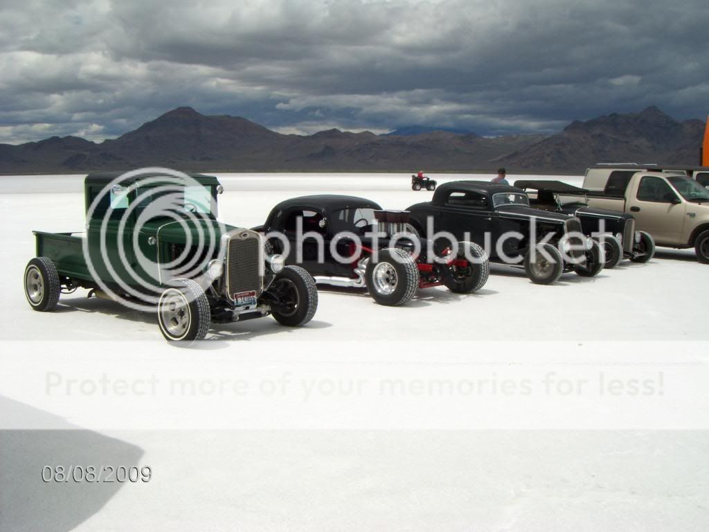

  29. rottenleonard
    Joined: Nov 7, 2008
    Posts: 1,993
    rottenleonard
    Here is a picture of dad's 31 with a AA frame, He cut out about 2 feet out of the center to reduce the weight and get back to stock model A dimentions as well as retain the tapers that are at the rear of the frame. The front suspention was a heidits unit intended for a model A, and fit perfect
    oneshot completed at the salt
    and one while he was in my shop building it,
  30. highwall
