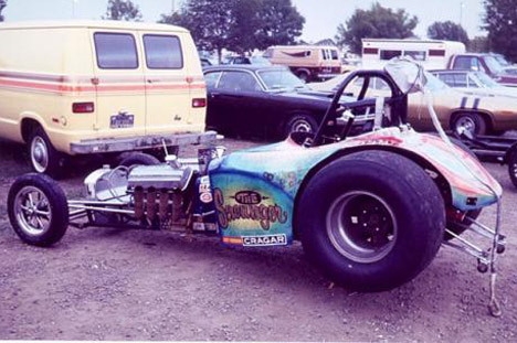

    I've always liked Rod Hynes cars, The Scrounger" and his Coors Light Altered.

    Rod is my hero , great guy and loves them short open wheel cars whether in a circle or straight line.Thanks for recognizing him.

    Well I my be able to help haveing built the first Beaver Hunter in 1965 and again in 2011 what is it you want to know? By the way the Scrounger was owned by Stan Luckas in the 70's in was ran as the Beaver Hunter for a some mounths

    The very shory wb 23t pick up Scrounger is very cool. I think it was also the Beaver Hunter at one time. As a kid I remember watching Rod Hynes in his fuel altered at LACR. I think that's what got me this sickness!! I've got the ex Bob Picket ex Bobby Lagana FC in my shop right now. My racing partner and I are building an injected altered using a 34 coupe fiberglass body.

    Anyone know what happened to the Scrounger or the newer Coors Light car?

    I think it became the Pandemonium at some point in time and he built a new chassis with a 23 T body?
