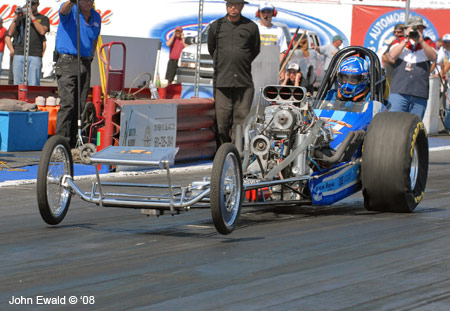

    The Murray and Scholl Top Gas Dragster of Columbus, Ohio. Ran from 68-72 (from what I have been told):
    Its about time to start a thread on my Dragsters restoration, Ive been collecting parts for quite some time now and its all starting to come together so I figure I will share with everyone.
    I bought the car going on just over a year ago from what I can guess. I ran into a friend of mine at a car show and after a bit of talk and showing me pictures I had to have the car, I always dreamed of a fe car but never persuade it as I have so many projects already.
    Here are a couple pictures of the car back in its prime:

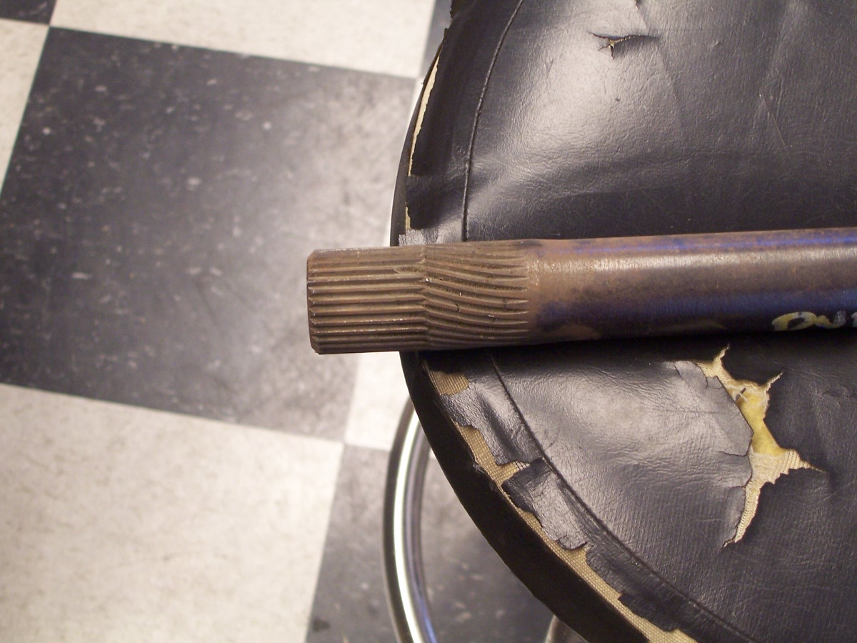

    Next came the rear end. I cut all of the old brackets and crap off of the rearend and cleaned it up a ton to get it ready to sit in place. After tons of measuring and math(using math I always said I wouldnt back in school:D) I figured out where the rearend needed to be, as well as the pinion angle. after I got it where I wanted it I even used a centering setup I rigged together to to be able to make sure the centerline of the mains lined up with the rearend/pinion etc.

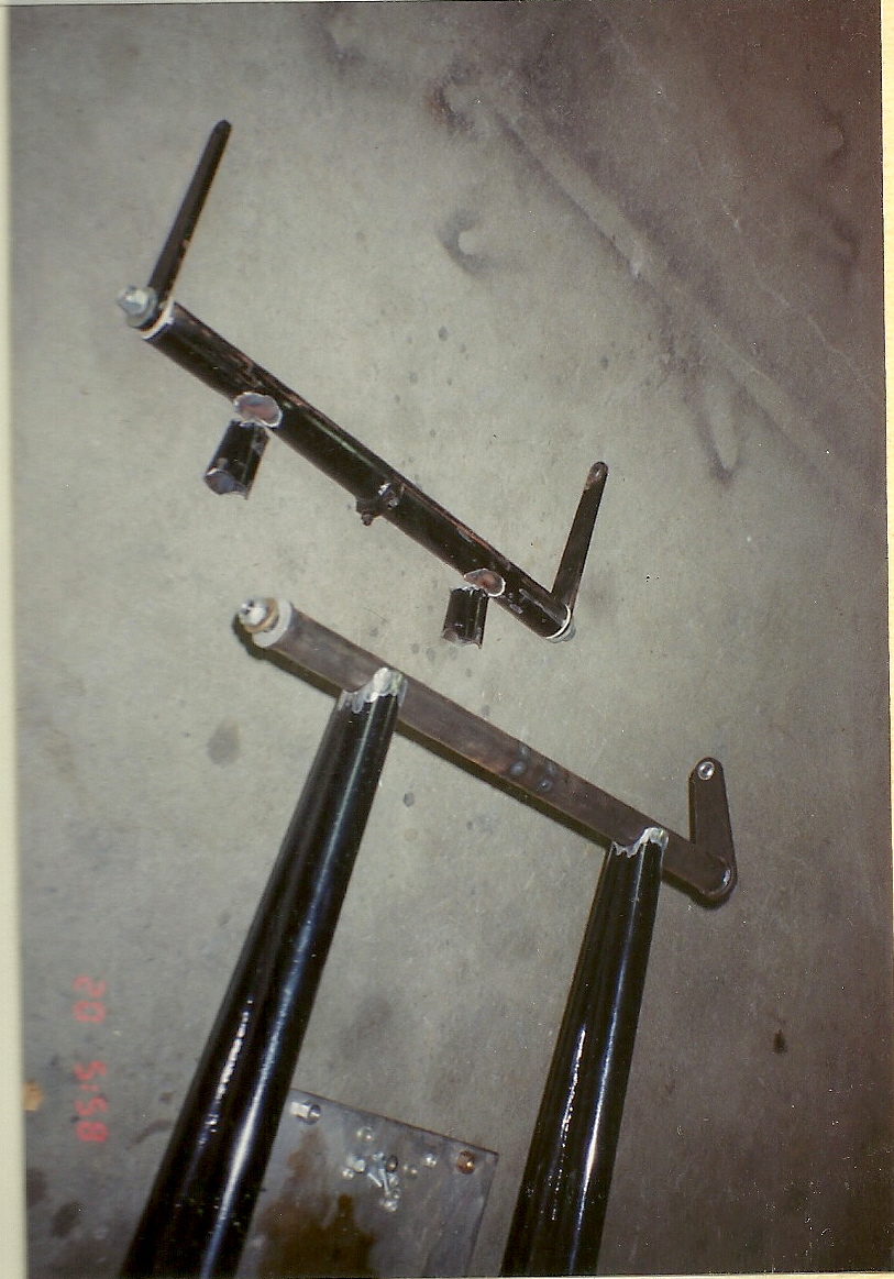

    We had just finnished the resto of the H/C "RATTLER" for the NHRA museum, on the way over both top framerails cracked/broke at the motorplate.
    as the pic shows why someone should not run old parts. This owner too wanted to "RUN" his car.

    Just be real careful, I know what dre is saying, the front crossmember of one of my GMC rails broke off on the way home while on the trailer...yeah, yeah, should have looked at the old welds better...lucky it wasn't a fast car. Fixed it properly, and the subsequent owner ran it up to 160+ in relative safety, with a small block. (My wife wasn't too happy with it either.)
