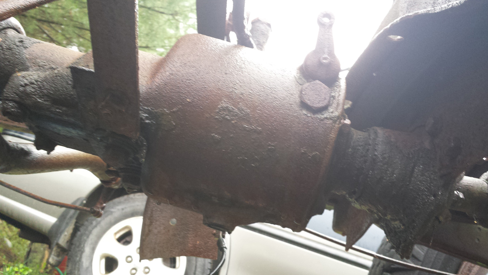

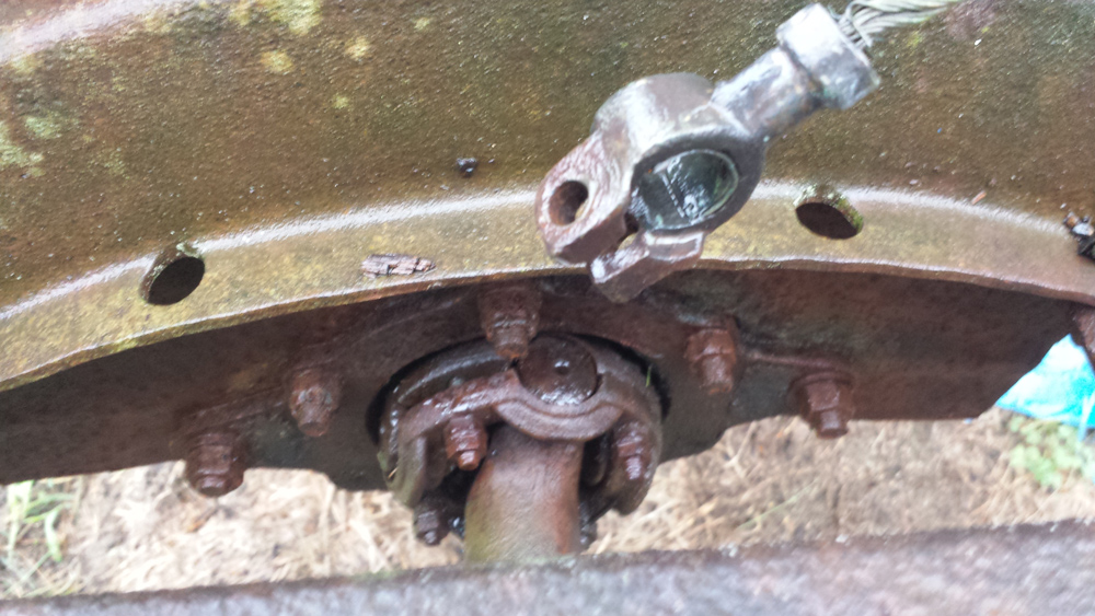

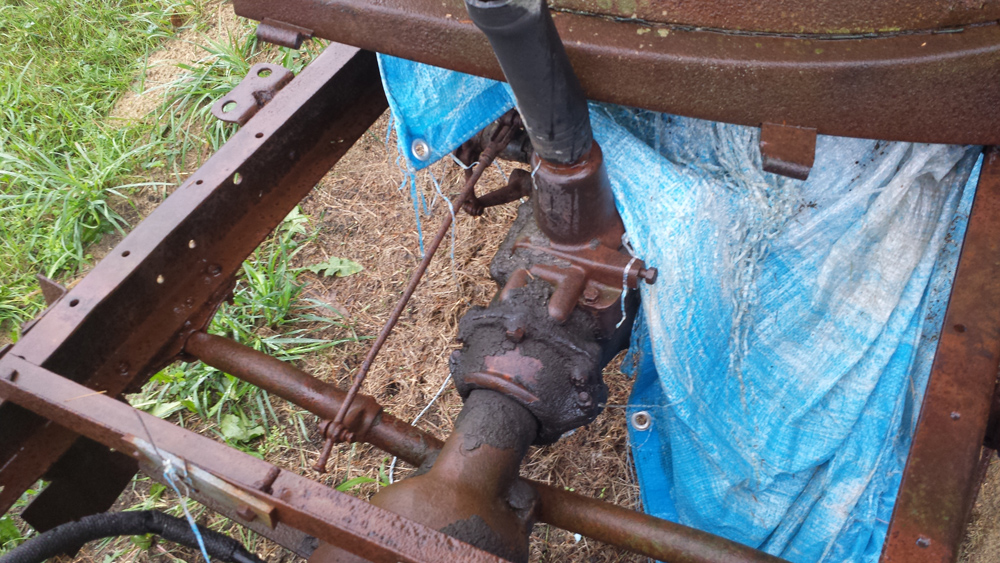

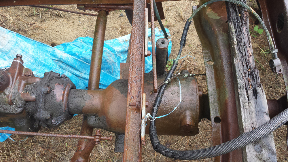

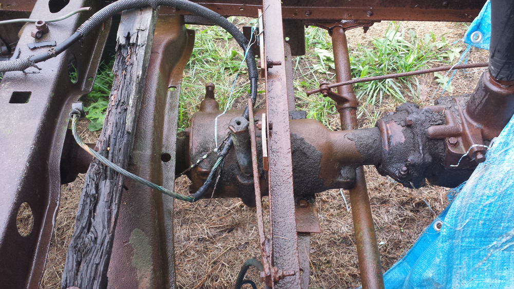

  12. I'm bumping this thread up and adding some pictures of one of these units. I may end up buying the doodlebug it currently resides in. It appears to be a 28 AA.
    If I end up buying it, I will be very interested in any specific info on converting to an overdrive but if I don't get it I'll try to figure it out myself and take pictures.
    I'm not quite sure how just flipping the whole unit around would work as far as mating to the transmission and to a torque tube. This one has the flanged front to the trans and an open drive out.
