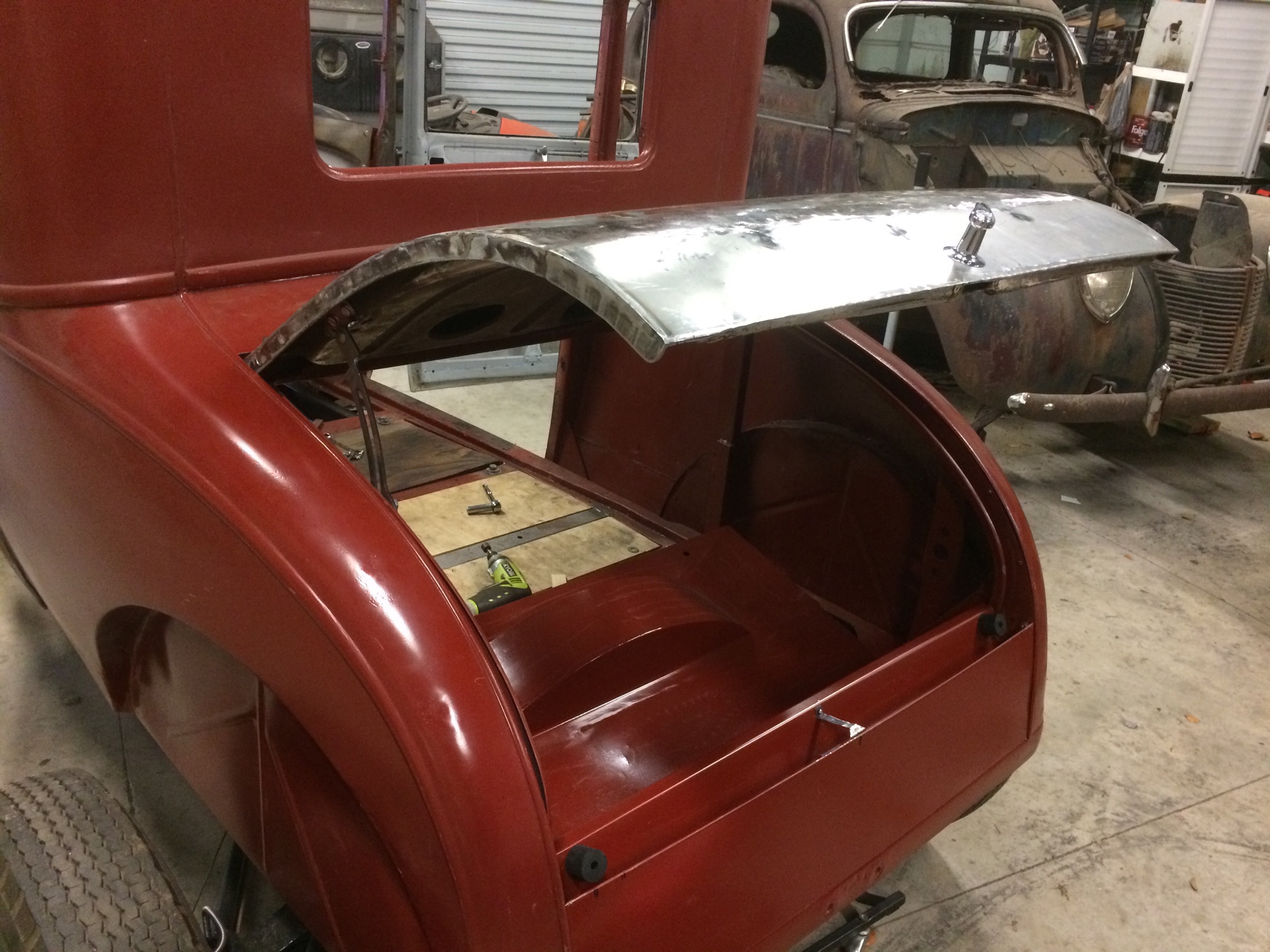

    Working on the trunk lid, took around 3 weeks to do. Man that was a lot of work!

    Your deck lid repair is spot on. Looks good.

    Aaron. I was just getting ready to do a search on how to do this trunk lid swap. At the exact same time I came to your thread. I could not believe it. It was like it was meant to be. Thanks for all your great how to's Aaron. Keep up the good work. Bob......

    Two options, new or old? I like the V8 one, but it hangs below the panel line.
    I know, I know, I shouldn’t even ask; old right?

    I vote old.....because I’m old..LOL...you cant get any cooler than that V8 handle!...Mark

    Old. Looks Good. :)

    Yep, old looks the best. Good choice

    Turn it upside down. V8 becomes A8 and doesn't overlap the panel gap.
