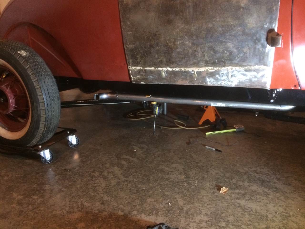

    You guys think running an exhaust like this (no mufflers) would be to loud?[​IMG]
  4. Tim
    Joined: Mar 2, 2001
    Posts: 20,242
    Tim
    from KCMO
    With a Flathead? Nah go for it

    Too loud? Is there such a thing? What? Sorry, I can’t hear you... speak up.

    Nope! :D But a pair of Porter's wouldn't be bad either.

    It's been kind of tough to figure out the routing of the exhaust so the Coupe still has clean frame sides and nothing hanging down under the car that looks bad. The brake master cylinder, rear brake lines, fuel lines, rear wishbone, and the 1939 X member make it tough to run it within the frame. I like the lake pipes look, but it's not what I really wanted. I want the dual exhaust to come out of the back so you can hear that distinctive flathead sound. I ordered some more pipe and some shorty gl*** packs . I have an idea of how to get what I want, and not have the exhaust look bad doing it. It's going to take a lot of cutting and welding pipe, but I think it will work good.

    Alright guys, finally got the exhaust done. It took a lot more time, money, and work to do it the way I wanted it, but it came out just like I envisioned.
