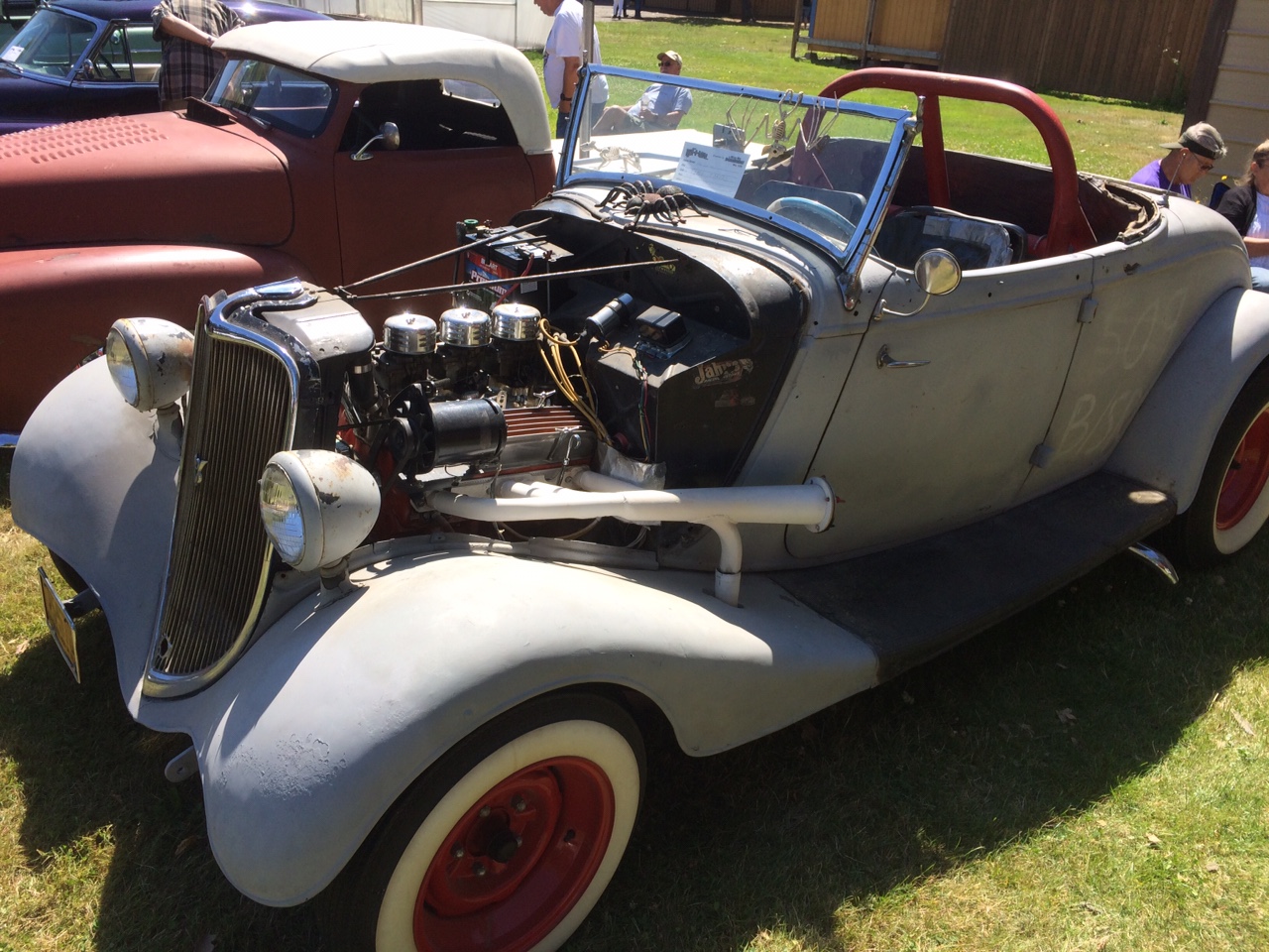

    At the Rust-O-Rama in Salem. Parked next to an old 33 Ford original hot rod. The Coupe did great on the highway coming here.
  26. Aaron D.
    Joined: Oct 27, 2015
    Posts: 1,038
    Aaron D.
    Picks of the 33
    [​IMG][​IMG]
