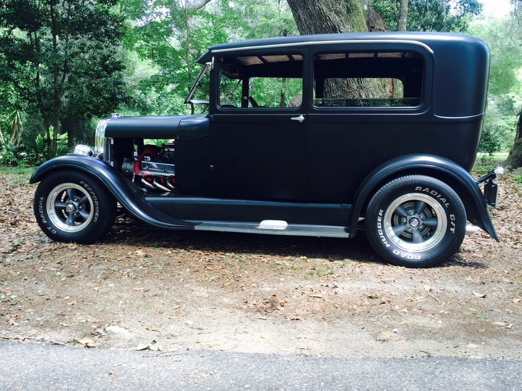

    Looking Good!! I know you will figure out this fan Deal. Is that tudor your ride? Thanks for posting.
