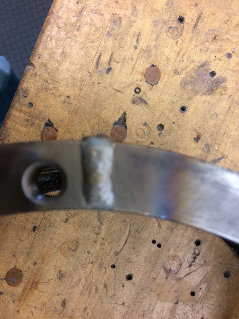

    After cleaning the diff housing I was cleaning the gasket surface and found a crack
    So I took it to work and had someone TIG it for me IMG_1484850472.695616.jpg
    Now the hard part, returning it to the machined surface[emoji15]

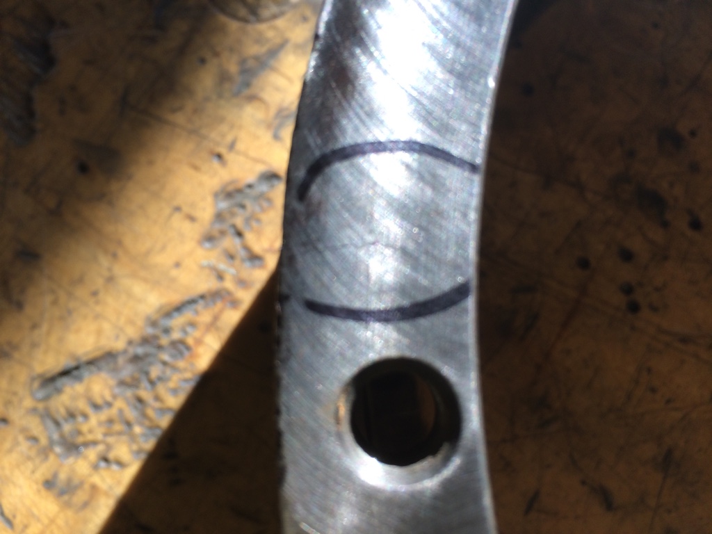

  8. Aaron D.
    Joined: Oct 27, 2015
    Posts: 1,038
    Aaron D.
    Thanks Barrnone, I smoothed out the weld with my Dremel and a stone.
    ****oning up the Banjo,
