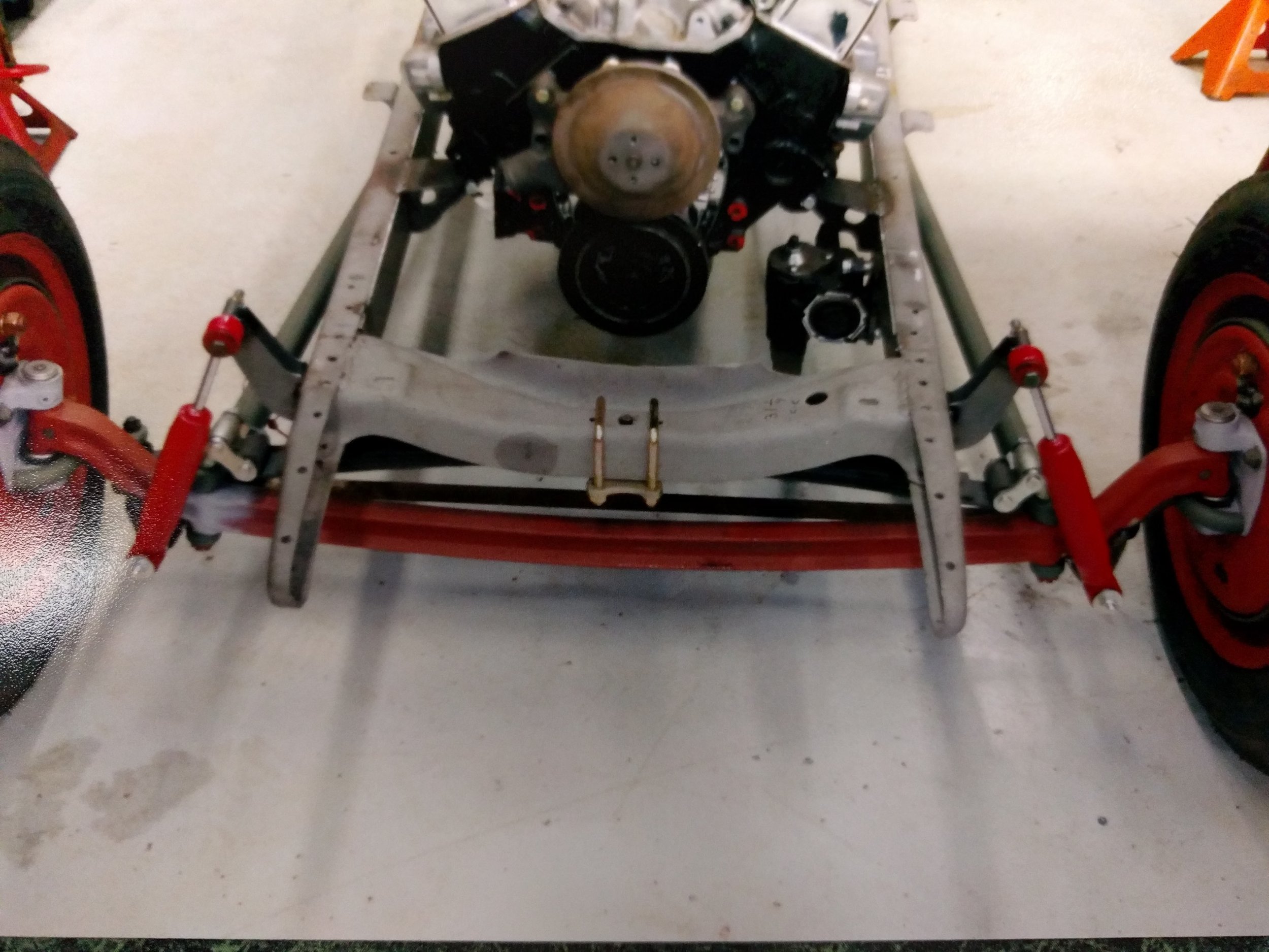

  15. THE FRENCHTOWN FLYER
    Joined: Jun 6, 2007
    Posts: 6,082
    from FRENCHTOWN
    I used one on my champ car.
    NARROWED 6 INCHES
    REMOVED THE SPRING PADS
    DRILLED IT
    SMOOTHED IT
    ADDED HAIRPIN BATWINGS
    Beg to differ, but I think it looks OK, even on a tiny car.
    Also, the F1 steering boxes (Gemmer) make a great upgrade to a Model A box.
