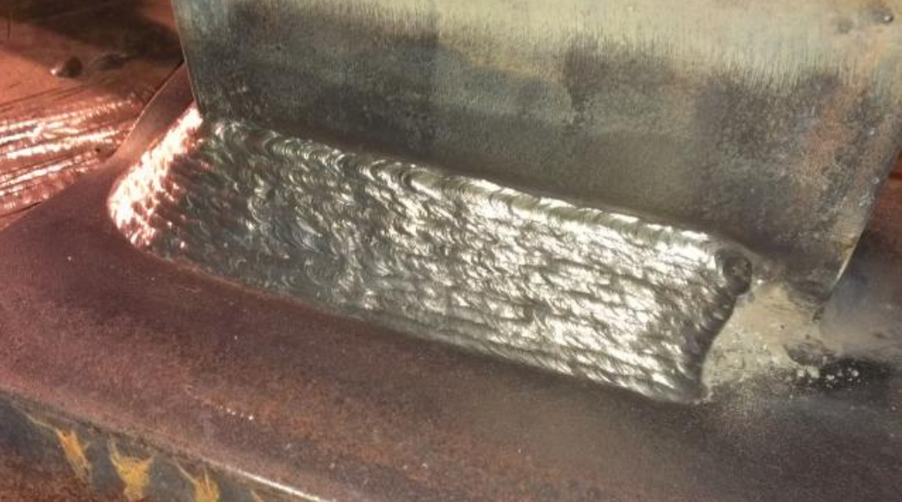

    Stacked filet welds
    Sharpone and chryslerfan55 like this.

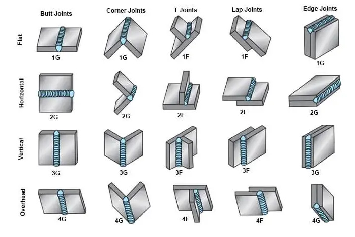

  12. tubman
    Joined: May 16, 2007
    Posts: 8,345
    tubman
  13. alanp561
    Joined: Oct 1, 2017
    Posts: 5,677
    alanp561

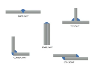

    No, your terminology is correct. Here are some pics of weld types with the number and letter combination that is used in the industry to describe the weld positions. If an employer wants a person tested for a particular weld position, these number/letter combinations determine what weld he, or she, or they will be doing. What I said about not using 7024 applies to 2G, 3G, 4G, 5G and 6G welds. You wouldn't use it for 3G, 3F, 4F or 4G welds, either. You can use 7024 for 1G, 1F and 2F welds as they are all flat down welding. Hope this helps.
