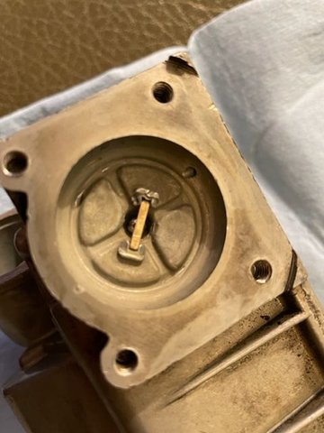

    This is exactly the problem, the umbrella just plugs the single hole and no fuel is making it in the accelerator pump.
    Drilling is a great suggestion except that big part of the umbrella doesn’t sit flat because the bowl is designed for a check ball, so drilling a hole would let fuel in but the check valve wouldn’t work to keep it from pushing back in to the bowl.

    Going by the description we’re talking about a Holley. You can’t replace the ball and strap with the later red umbrella as it won’t seal on the x shaped grove. You either need to replace the ball and step or change the float chamber.

    picture from the internet, comparing the check ball style float bowl, with the umbrella style.
    If there's enough metal left around the ends of the strap, you might be able to make a strap and find a suitable check ball, and make it work. Perhaps even use fuel proof epoxy to hold in the strap?

    That’s exactly what I’m dealing with!
    Time to reach out to friends and see if anyone has a bowl or a check ball we can make work.
