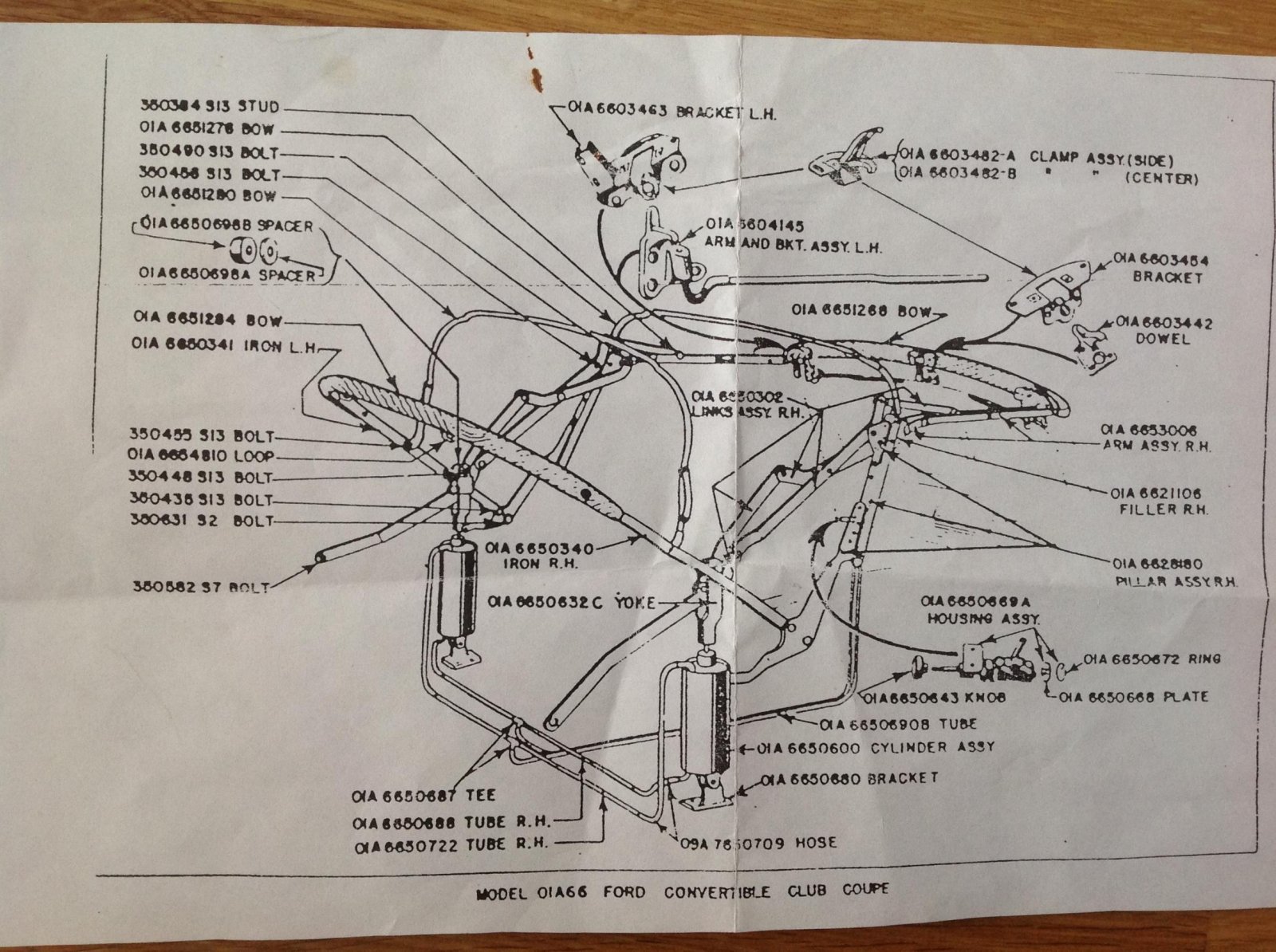

    I took the distributor off and went thru that. New points, inner caps, outer caps and wires. Pretty interesting piece of engineering Henry has there with that distributor. Finished the first cut on everything but the front clip. I can't decide if the paint is that old and original or an Earl Schieb redo from years ago. When I get done with the buffing there will still be some **** in the paint but I think it's going to shine good. The wife came out to the shop and we tried to put the top down thinking it was mechanical. Slowly proceeding to retract the top it we got it about 3/4 of the way down and it just didn't feel right so we stopped. Everything looked ok but discovered some cylinders down inside the rear quarters on both sides. We decided to put the top back up and do some research. Lucy went to google and was directed to a old thread on the HAMB from 2006 about the tops on 40 converts. Turns out the top is vacuum op/***ist. The canister on the firewall that I ***umed was for the Columbia is for the top. I'll do some more digging and keep you posted.
  28. 40FORDPU
    Joined: Mar 15, 2009
    Posts: 4,067
    40FORDPU
    I don't know what your "canister on the firewall" is for, but I know it's not for the top.
    The '40 top is vacuum operated, source of vacuum is from rear of intake manifold to a "T" one port of the "T" goes to the vacuum wipers, the other port goes to the convertible top vacuum switch located at the bottom of dash.
    From the switch vacuum is connected to vacuum pipes, found on floor drivers side under mat, from there to the vacuum canisters at the rear quarters on either side.
