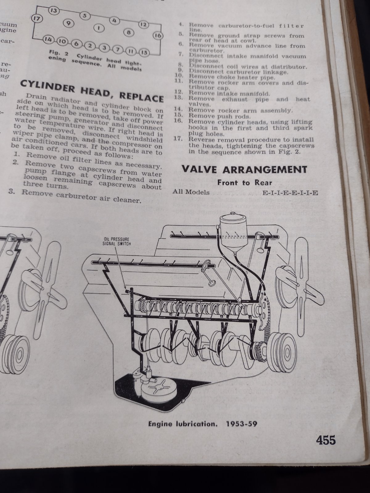

    IMG_20230713_132006358.jpg so you can see it is a byp*** oil filter and oils the timing chain....

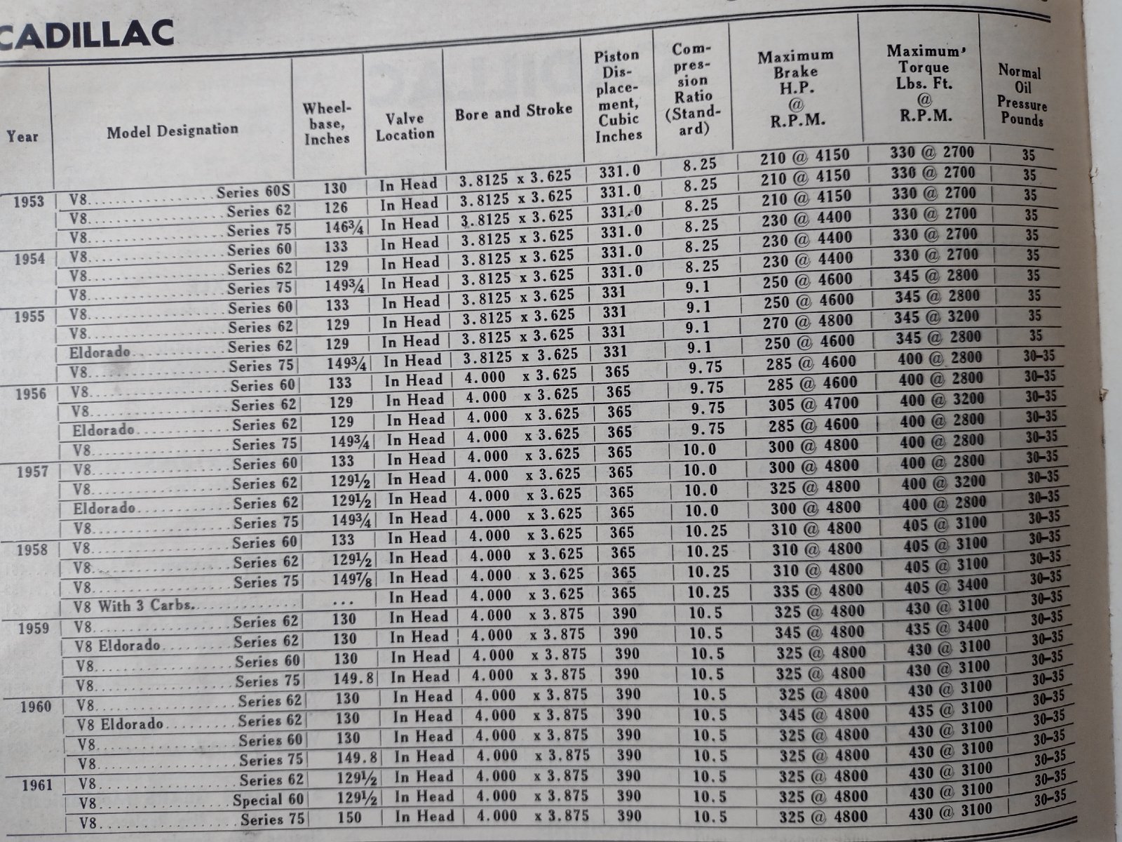

    I don't know why I can't find the casting number for the block...this would make you believe it is earlier than '57 which I am sure....I was thinking it was '53 but not certain. I had this engine awhile and I just don't remember...I know I went thru the exercize. Maybe the casting numbers on the heads can help you figure it out...at least what the heads are....

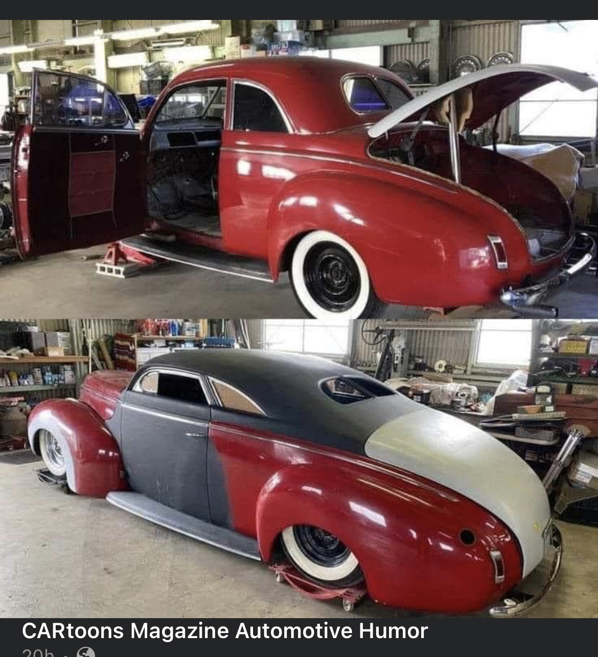

    Exactly! A buddy of mine sent me that same pic via text today. Maybe I should take these suggestions as hints? :D It is motivating for sure. :cool: Maybe there will be a kool one at the Gathering at the Roc this weekend to also help with motivation.
