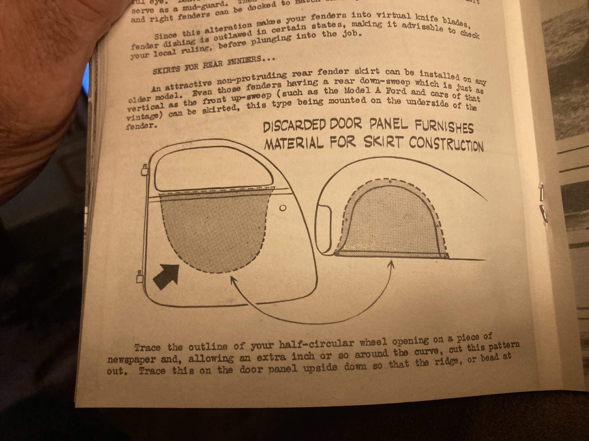

    I read somewhere that a way to make custom fender skirts was to use a door skin . Use the rib at the window opening for the rib along the bottom edge of the skirt . The door has a slight radius to it also . If I find the article I’ll post it .

    IMG_2928.jpeg From Dan Post Blue book of Custom Restyling 1944 , 1949

  4. drdave
    Joined: Jan 3, 2006
    Posts: 5,247
    drdave
    That is a clever idea!!

  5. topher5150
    Joined: Feb 10, 2017
    Posts: 3,753
    topher5150
    of course I got rid of my old doors :(
  6. Outback
    Joined: Mar 4, 2005
    Posts: 3,349
    Outback
    from NE Vic
    that would be so tempting to build a Carson topped vert out of :cool:
