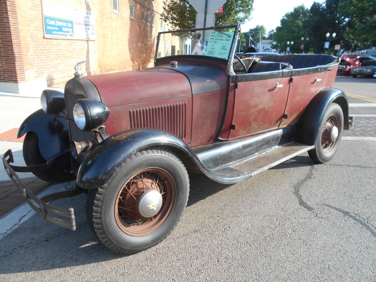

    I may not have mentioned it, but Spencer is stuck on a Phaeton or Touring so he can have Nora and Momma along on adventures. Kid has a sweet disposition. So I’m searching for a body that isn’t soul destroying and cruising the interwebs for inspiration. Something like these would do, methinks…

  23. Hitchhiker
    Joined: May 1, 2008
    Posts: 8,507
    Hitchhiker
    T touring tubs are still cheap and well within the budget. Wish you were closer. I'm about to drag home a really decent one that will be for sale.

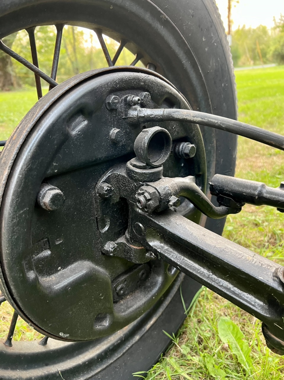

    What do I need to get good mechanical brakes on this Jalopy?

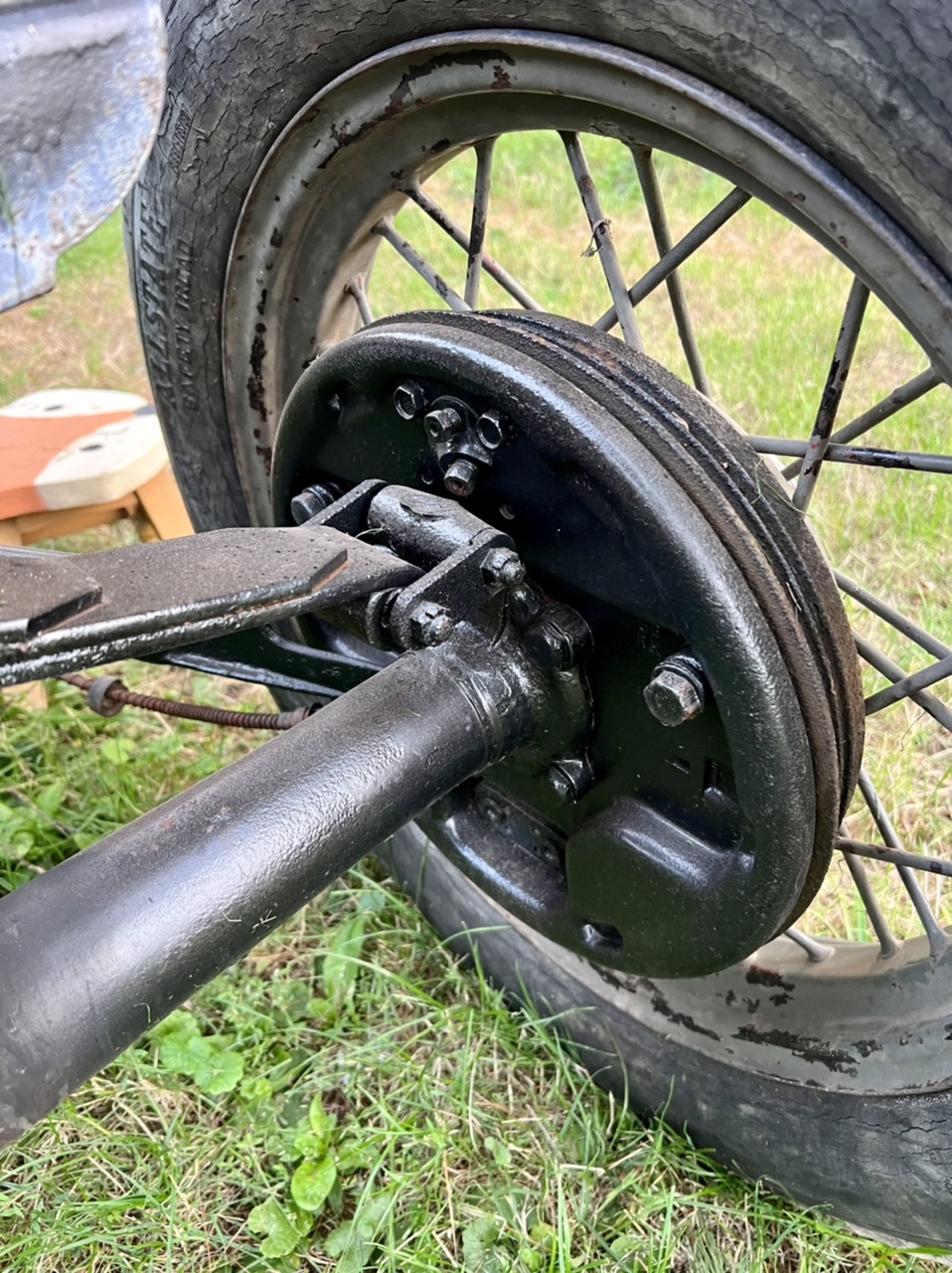

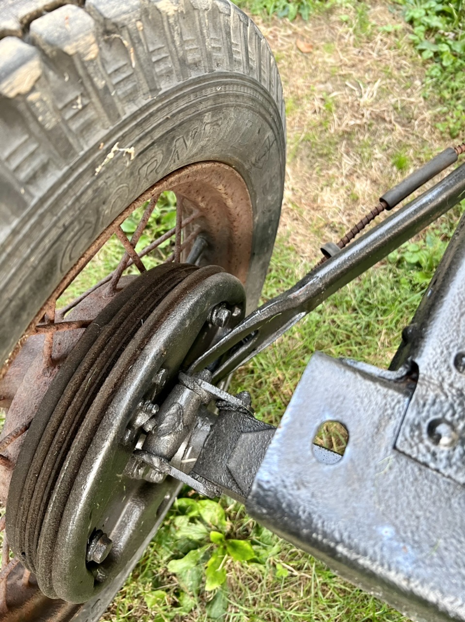

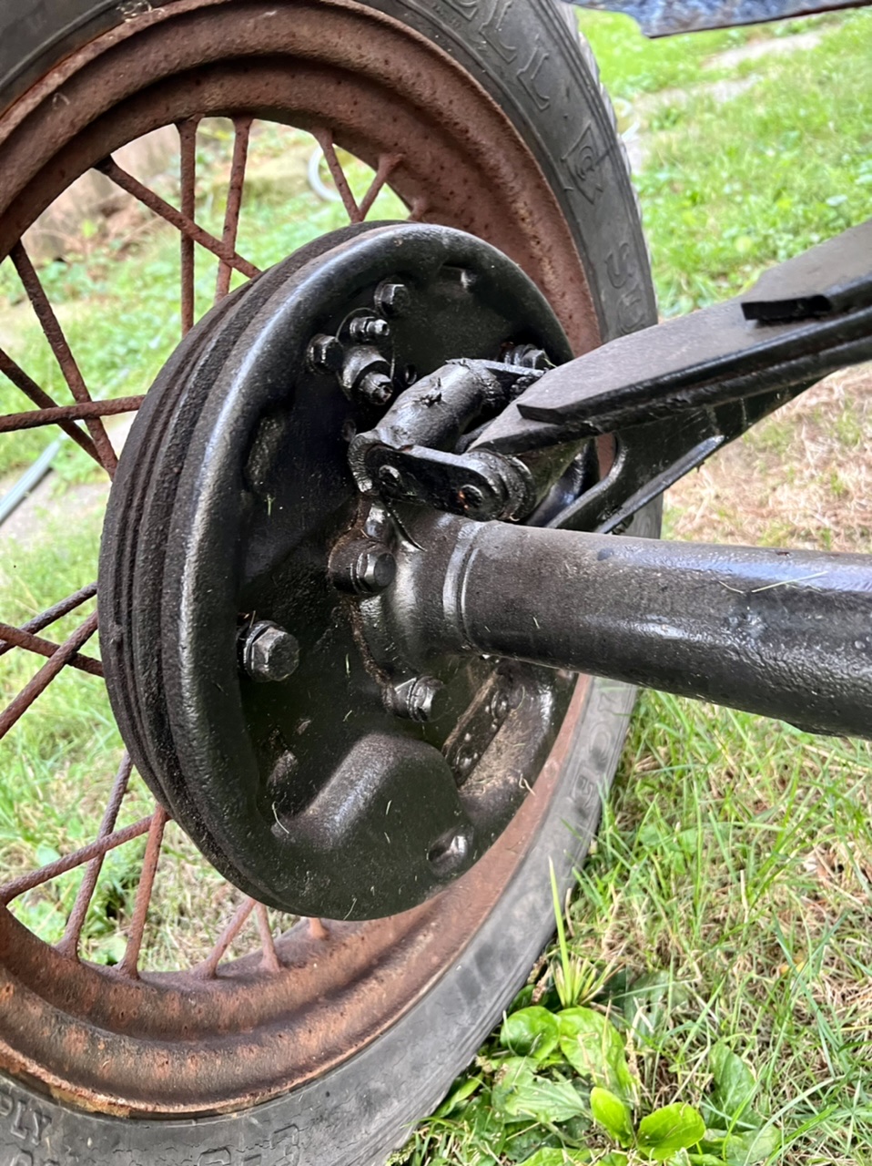

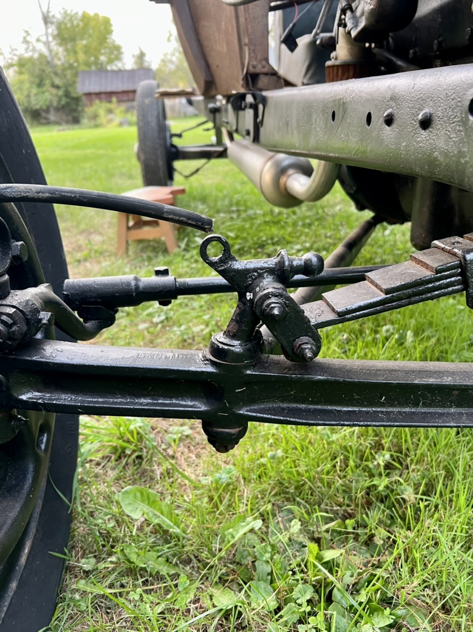

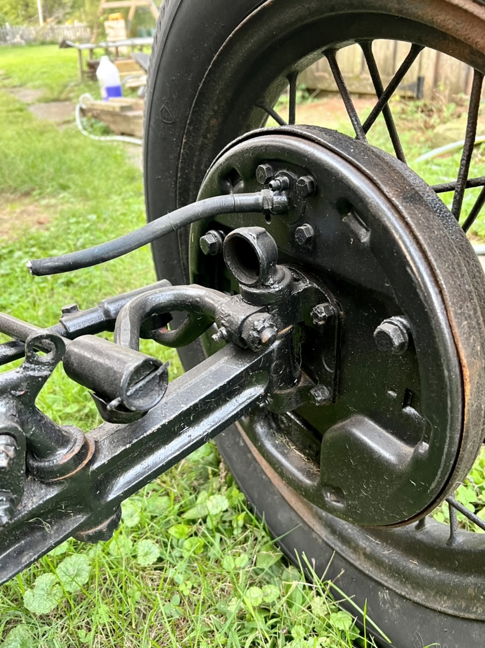

    Here’s where things are now…
    CF14D2CC-B47B-429F-A87A-9EA4E1361E87.jpeg 89D83E66-B8E1-4404-8F17-6F5DE4BFAA54.jpeg 796254DA-14DE-4668-BCBB-EA7BE21C941A.jpeg BE5A2519-31DD-4AFF-98FB-85D6C6868818.jpeg F6B8E5DB-E901-4429-BEEF-29187CF7AE6C.jpeg CBD3BA0D-A2EB-40BD-ABD1-7FEA9488A1D4.jpeg
  29. 62pan
    Joined: Jun 8, 2008
    Posts: 910
    62pan
    Those are 46 - 48 brakes. Since your going mechanical I would suggest doing the rears first. Use the new cast iron drums. This will give you brakes so your ch***is stops.
    Consider a complete 32-34 front axle and brakes. This is all bolt on and will give you cast iron drums and better brakes over the stock A. Go with Flathead Ted's floaters and your all set. You will need a spacer for the wishbone and A actuators plus the 32-34 perches. This will also help lower the car.
    For shocks look at the delco Lovejoy shocks. They are from the time period and can be found fairly cheap, plus they bolt on. 20180818_163941.jpg

    To be clear... this car has nothing but the 46-48 juice brakes on it. And an 'A' pedal. Nothing. So I'm essentially building brakes from scratch. I need all the rods, cross rods, actuators, etc. I didn't anticipate what that would entail until I started looking at what it would take to backdate things to pre-WWII tech. Sheesh!
    An entire 32-34 axle is actually a good idea, if I can track one down... Otherwise... is this right for fronts?: All 'A' except for 32-34 brakes? 'A' spindles, actuators, king pins, etc., will all jive with the bigger cast iron drums?
