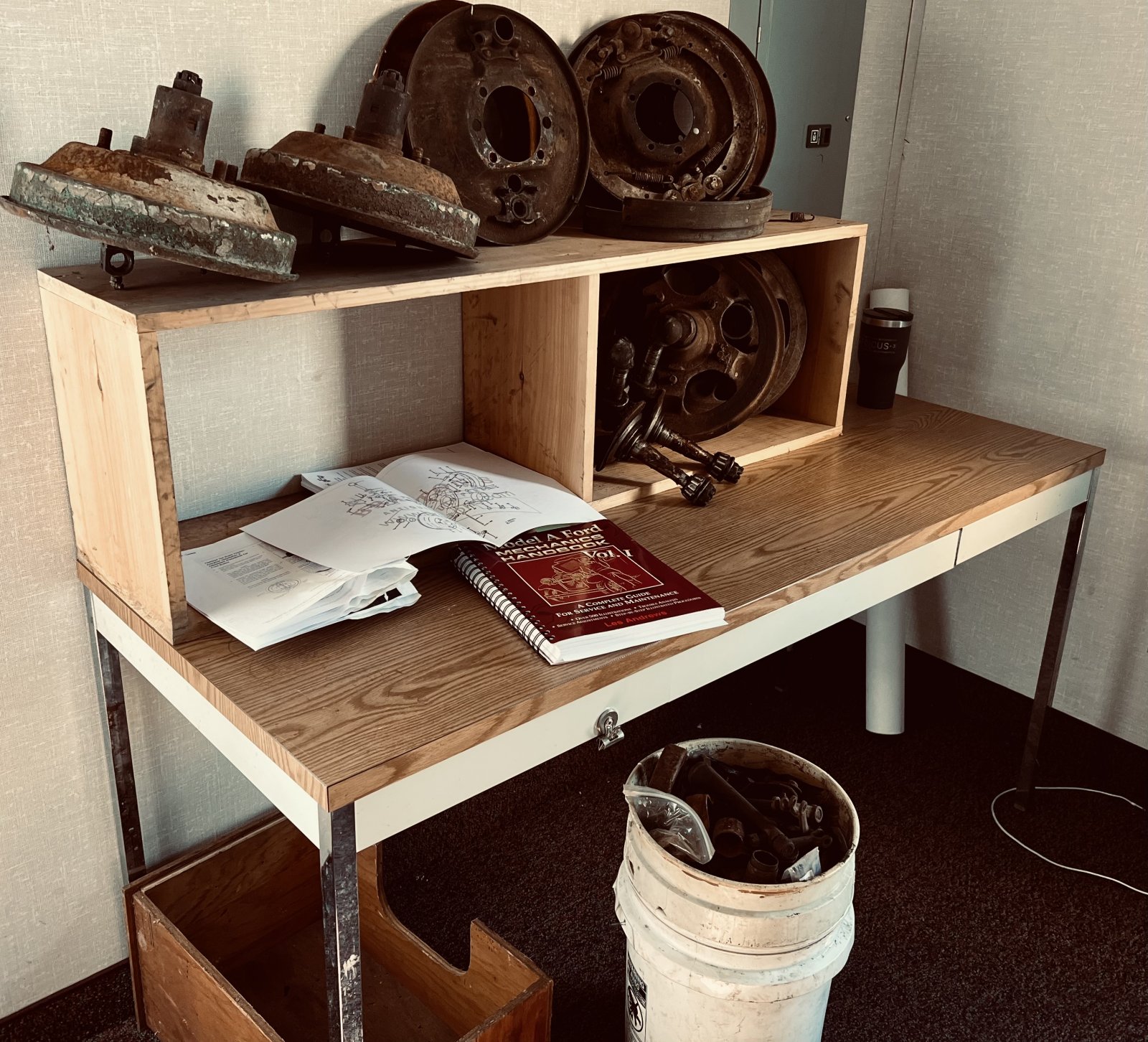

    We also picked up a stash of brake parts from Ken (62Pan) and Dave (Carter). Thanks to you both h so much. Im getting organized. I know I still need rods and ‘32/‘34 perches, but we’re getting there!

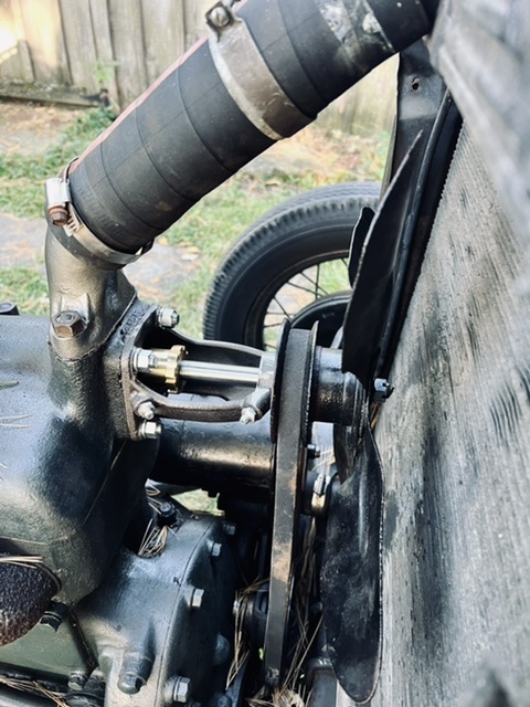

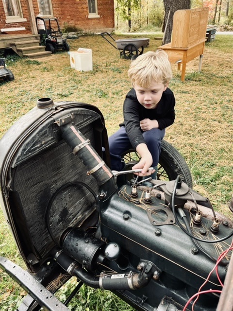

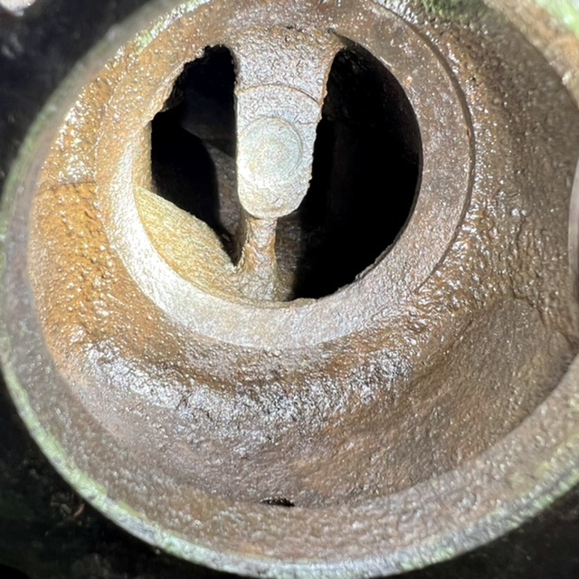

    Today I had my “fatigue” day, and Spencer and I dove into our projects. I didn’t get as far as I had hoped… I need to remember that things take a bit longer when working with an apprentice. But we did get the rebuilt water pump in and the cracked water neck replaced with an original part. Spencer does NOT like the smell or the feel of Kroil on his hands. Dad has made note.
    A89B2790-0715-4FAB-B400-4A2166EC0B61.jpeg FFC7DDBF-CC0F-4C1D-B736-B122A90B088F.jpeg 41A35EA7-981F-49F6-AE27-A0276A4432B6.jpeg
    Not too bad inside. This is my first look of any sort inside the engine.
    26CBFE3B-A80B-4EEB-B88E-527DB03B0780.jpeg FE27D9BA-7ACD-4915-BE4D-D6D26B24769A.jpeg
