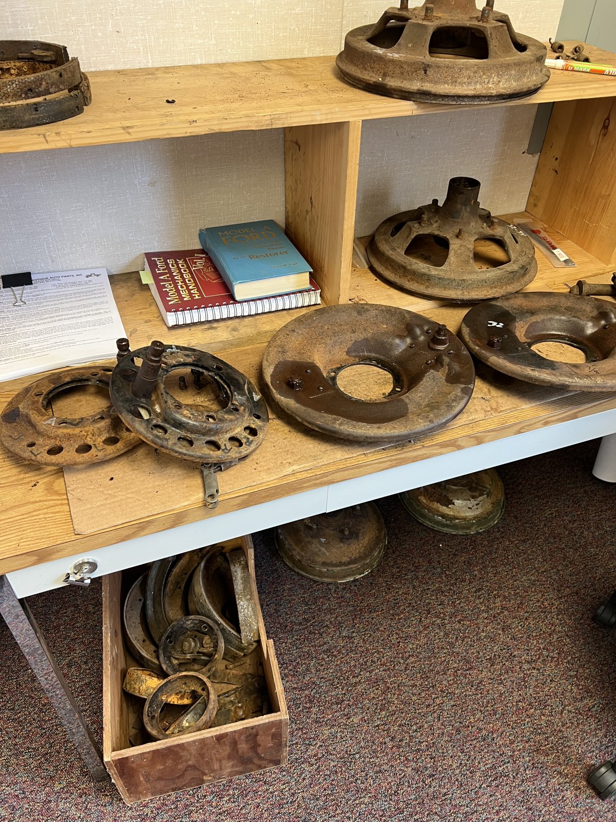

    Going through brake parts in my very limited spare time at work, getting ready to rewire things on my next day off, I have a pair of Delco-Lovejoy shocks that should work for the fronts if I can manage to rebuild them, still searching for a body....
    What about the banger??? What should we do? I have my thoughts, what say the brothers? Remember, gang... achievable!

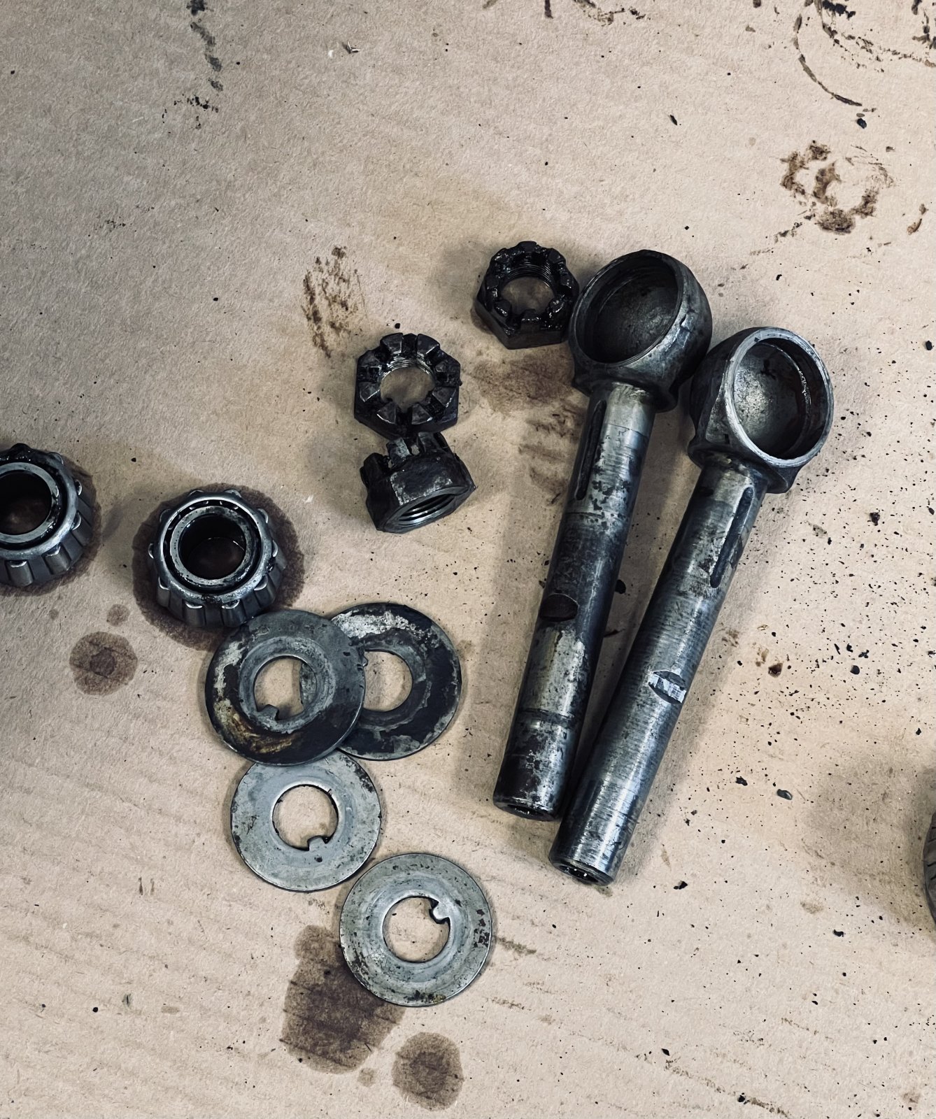

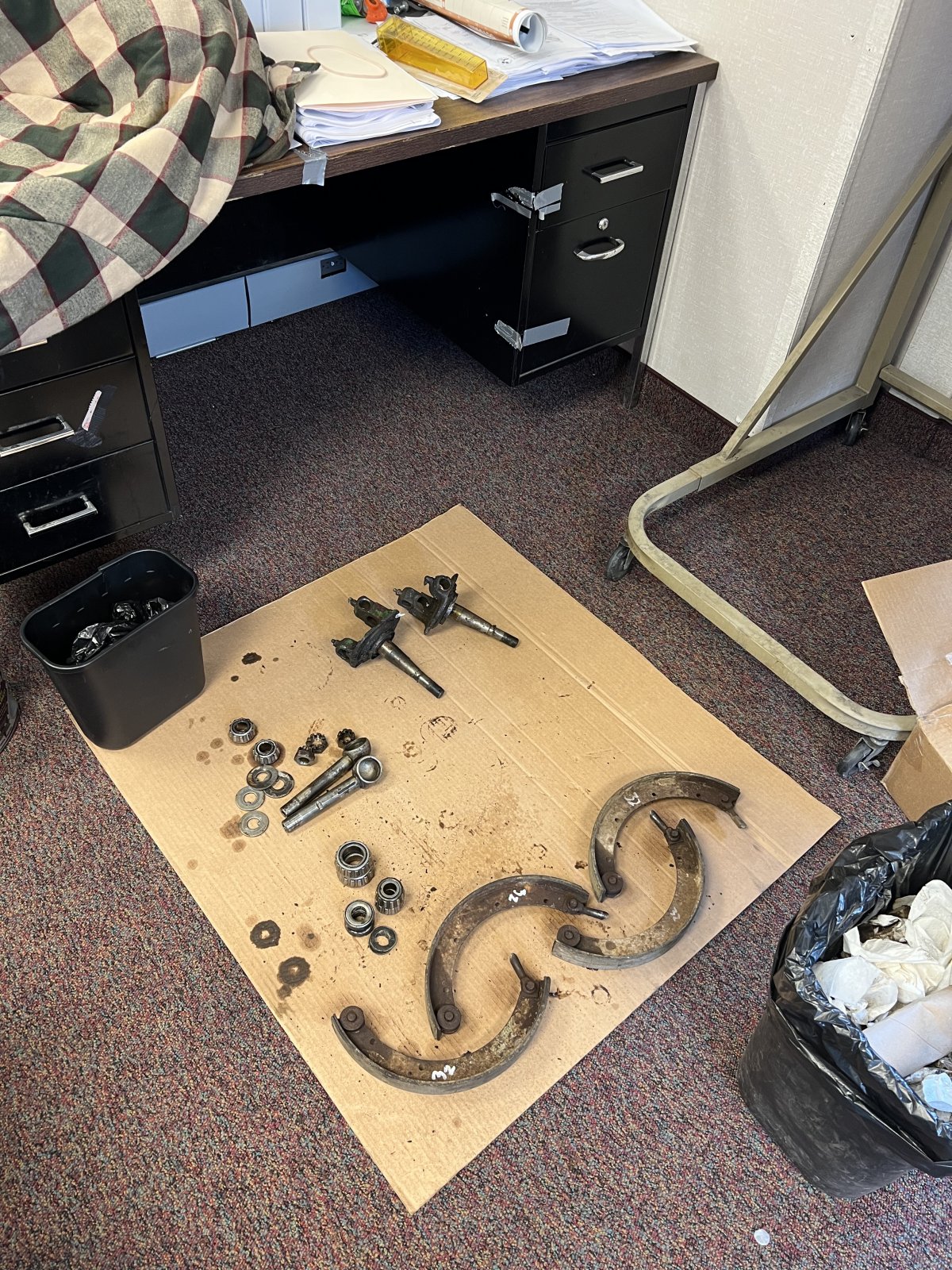

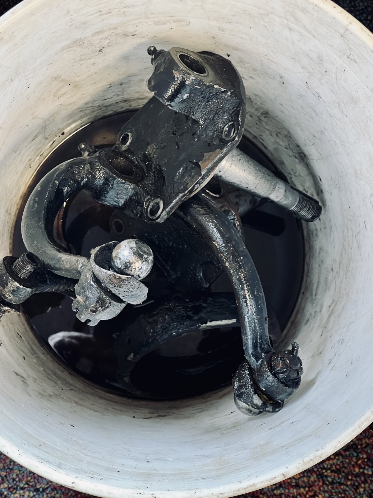

    Achievable… this jalopy probably would have been more achievable by starting with a ch***is that had functional brakes. But! We are making progress.
    So since we’re starting with nothing, we had some choices to make. I’ve decided (Spence could care less about this detail…) to go for A rears with iron drums and ‘32 fronts. Likely Ted’s floaters. With the help of friends, I’ve managed to just about collect everything I need in early Ford parts… minus consumables. That means I’m spending a lot of time restoring parts rather than building with my credit card. Which is as it should be. I’m also becoming very familiar with the functioning of Ford mechanical brakes. Useful skills.
    Where do I find the time? It’s good to have an office with a door.
    59182FE0-9379-464D-803E-40A12158F9E9.jpeg 237F326A-EF7E-443E-BA8C-A28A363041D5.jpeg F7458F6D-3253-4DF3-9C65-80CA391BCE68.jpeg 035924CB-1C40-42A9-A53C-2C143B278A11.jpeg

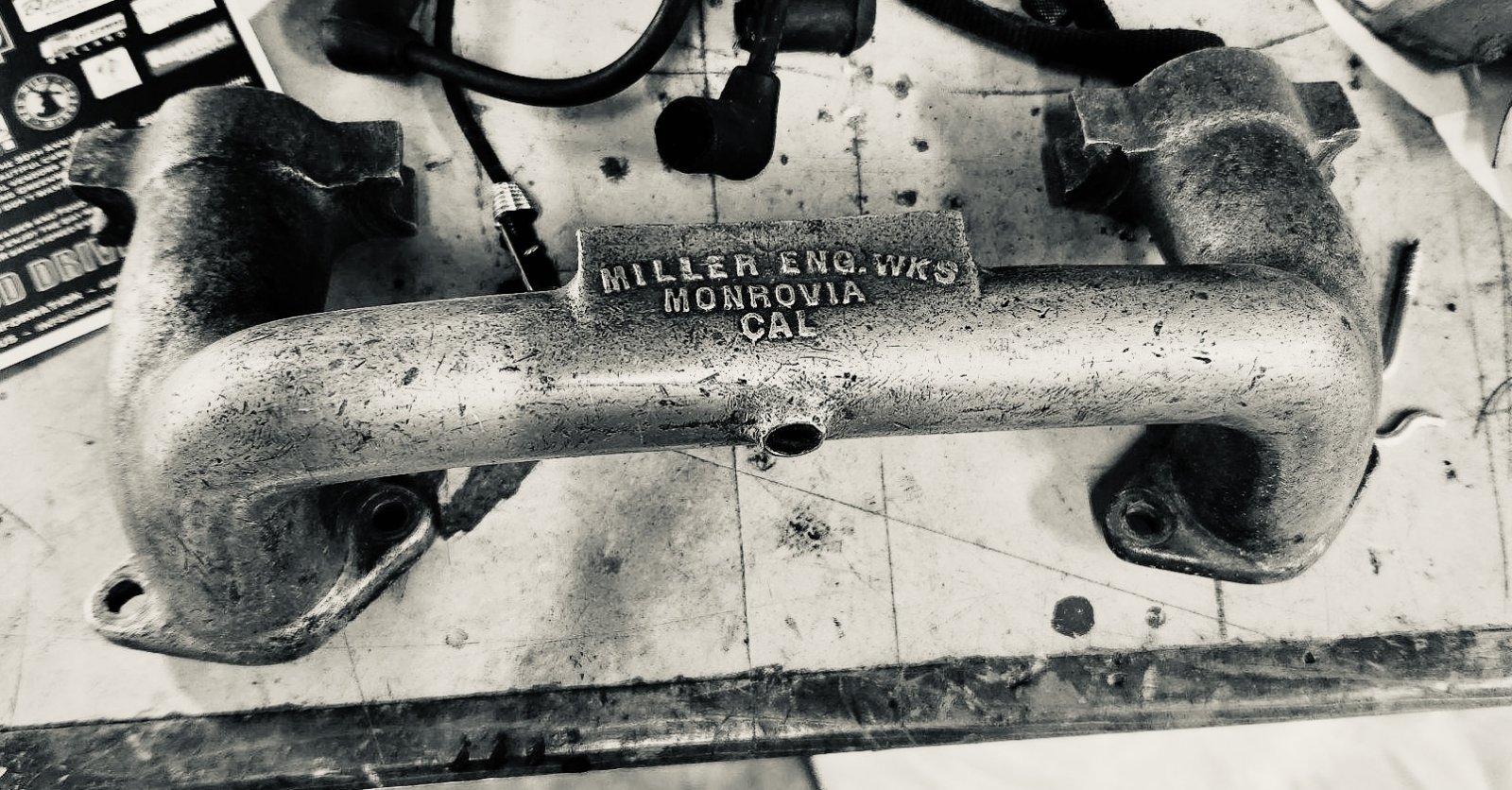

  26. RyanAK
    Joined: Sep 7, 2019
    Posts: 719
    RyanAK
    It’s in the post, so hopefully I’m not jinxing myself by posting a photo… this and a couple of Tillotsons to start. :cool:
