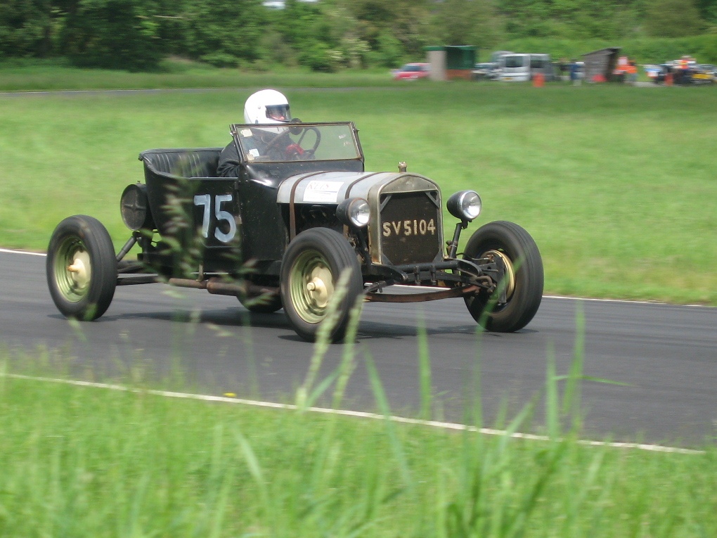

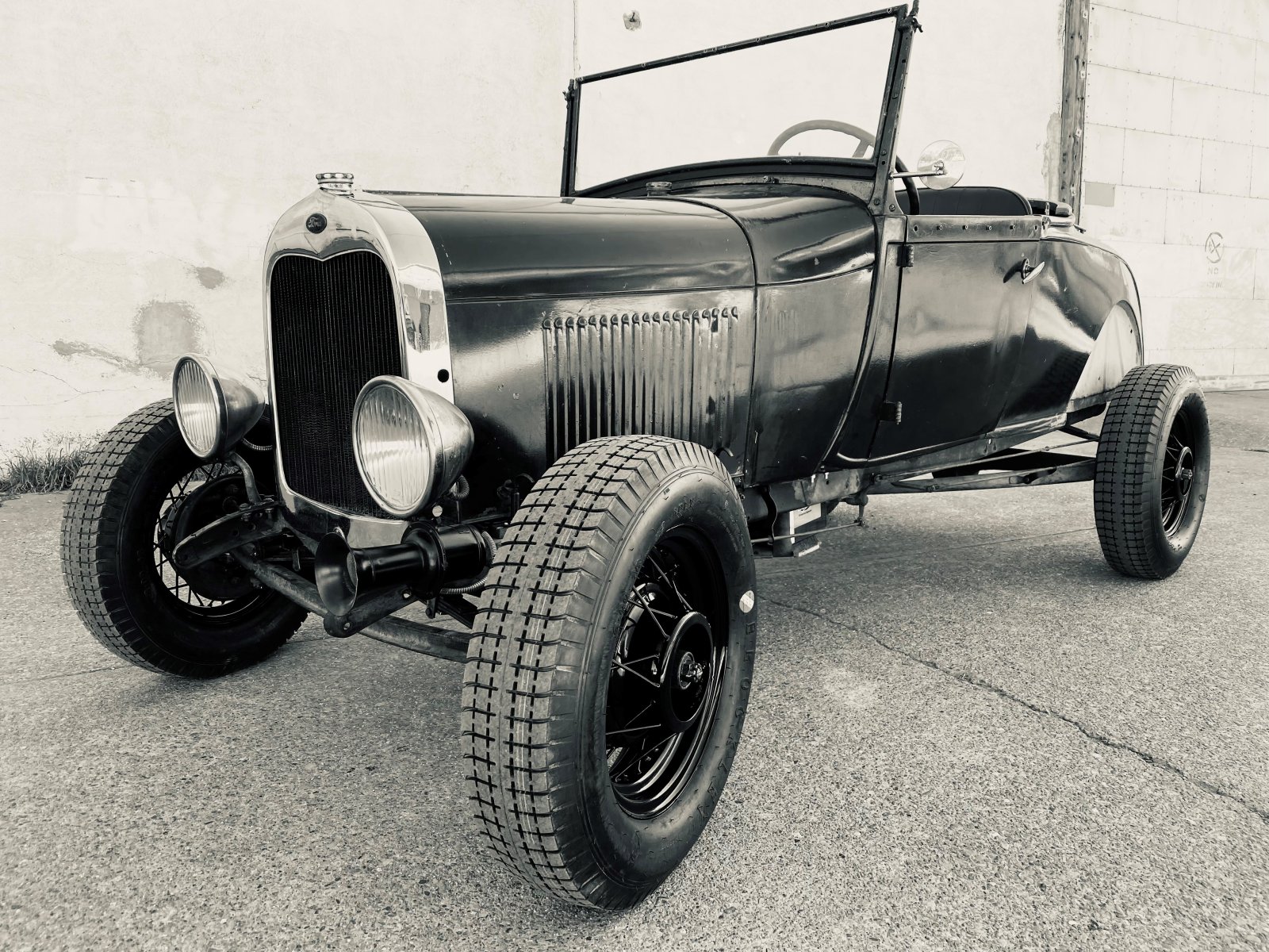

    That was probably me. I wanted something period correct, and also something different than the pie-crust Firestones I see on every car here in the US. I do like the look of them, and they ride well. Blockley was easy to work with, and shipping was fast. The cost was about the same as a set of Firestones from Coker. Probably less now with the favorable $ and rising costs as Coker.

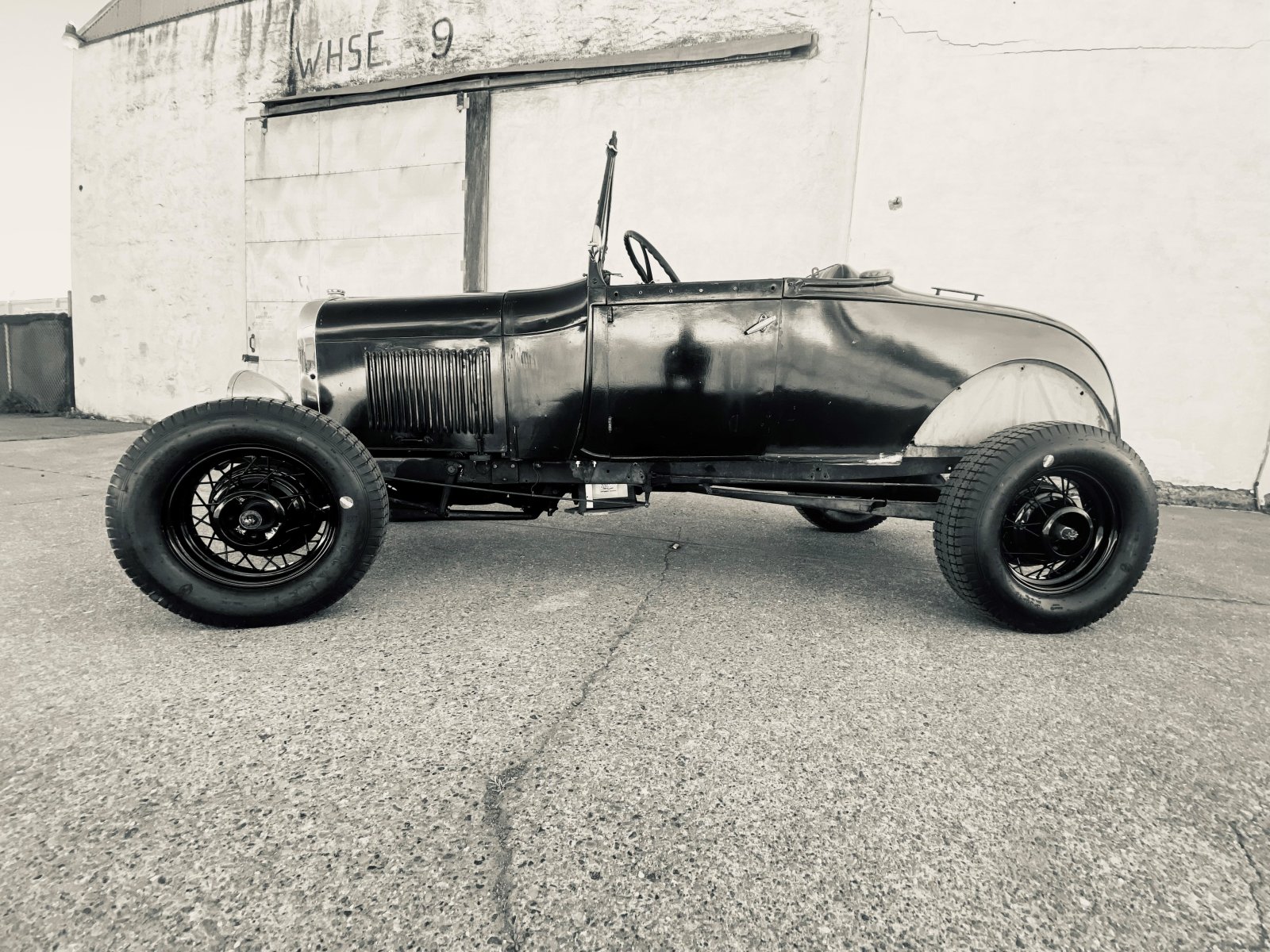

    I like ‘em. Even the 4.50 x 19’s I’m running on the front of the Coupe get warm and sticky in the wet. Confidence inducing. I ran the 5 block 16’s when I hillclimbed my old T modified. More grip than I dared use.

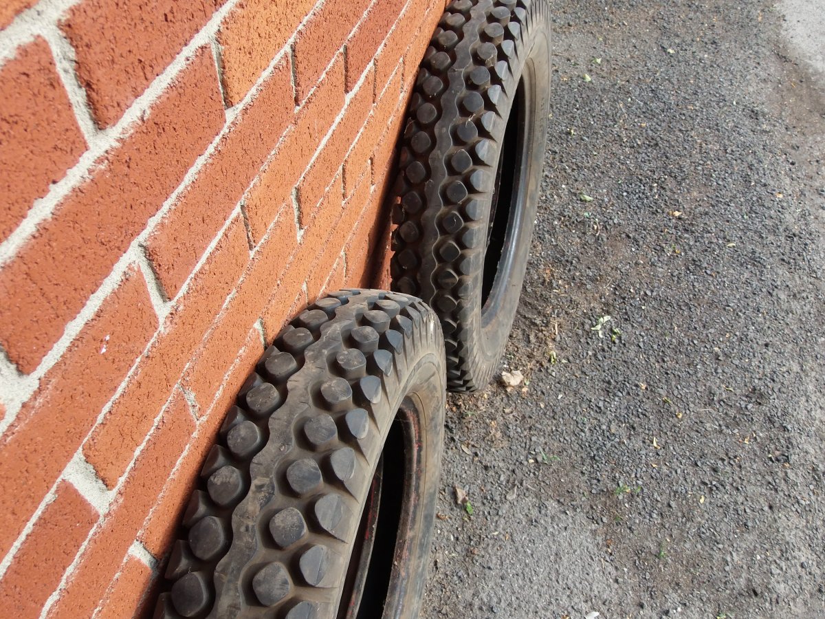

  5. Just to add my $.02,

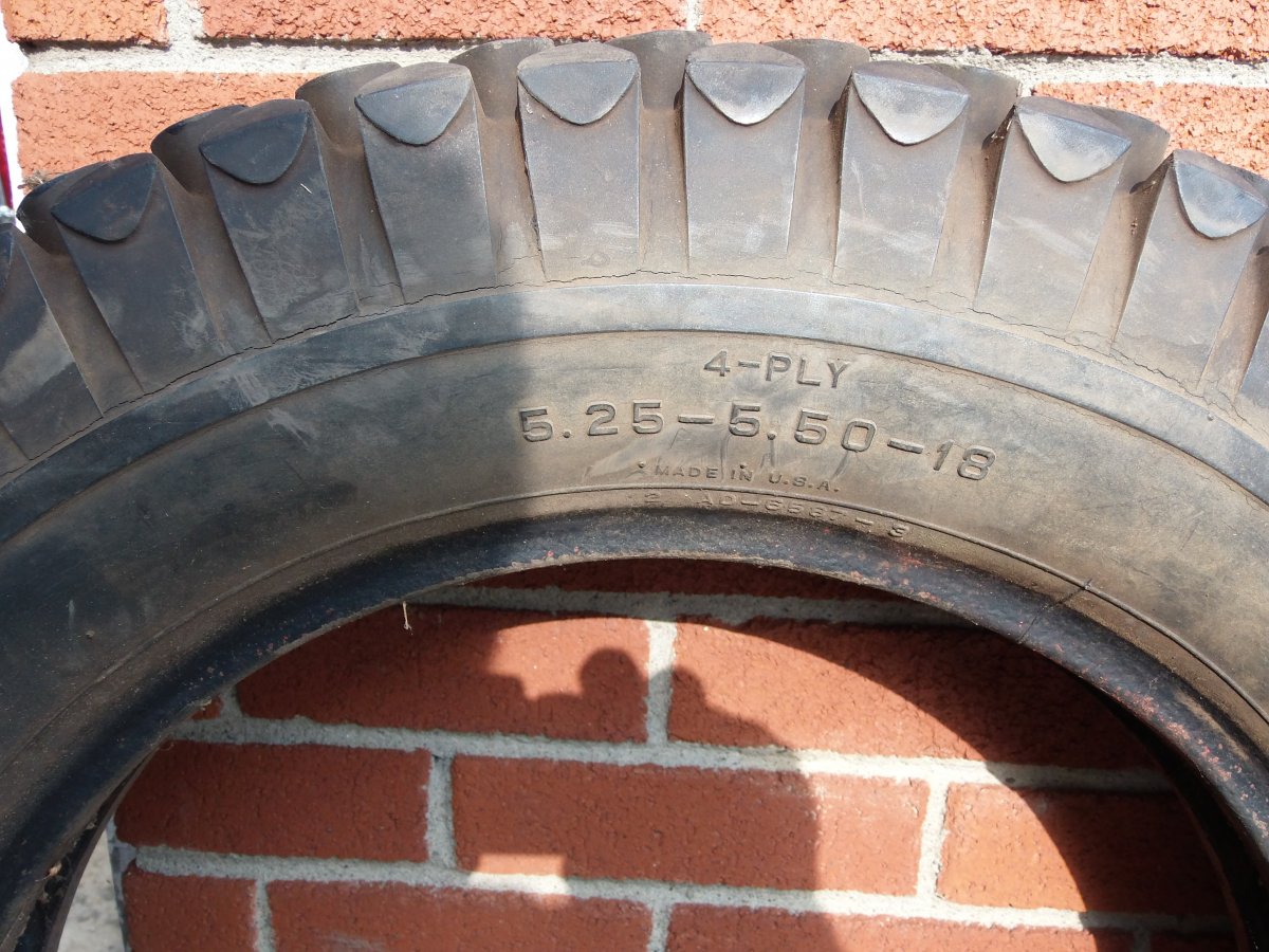

    Here are what "Knobbies" looked like for 18 inch wheels.
    In my opinion these could be run on the rear on '32 Ford wheels
    with smaller tires , like 4-75--18s in front.
    The whole idea of "biggs" in the rear was to get higher top end speed. P6150006-002.JPG P6150004-001.JPG

  7. Blockleys are a crossply.

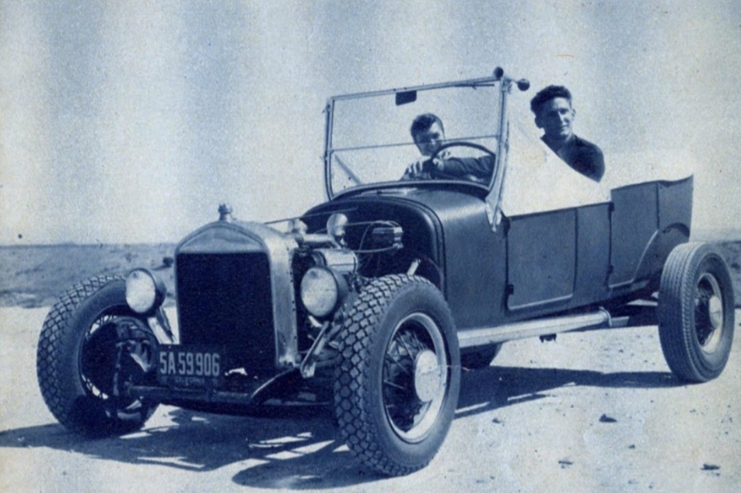

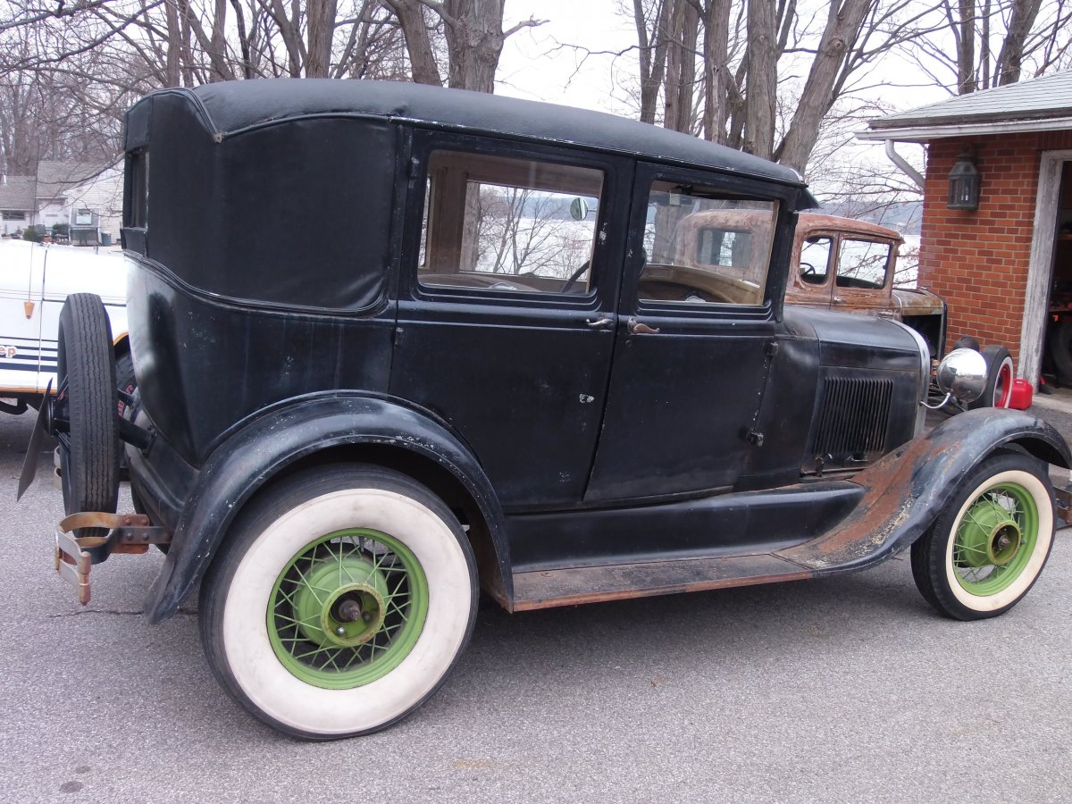

  8. Just an illustration, thinking "back in the day"

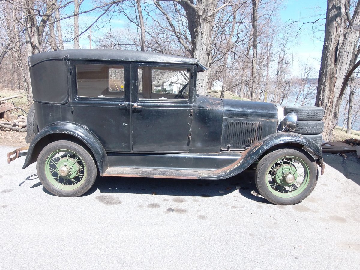

    These 2 pictures are the exact same car. the first is bone stock '29 sedan.
    The second is the same bone stock '29 sedan, after I became the kid,
    (not me but I always try to be the kid who played with cars earlier than I could!)
    that bought the car from the back of the used car lot in say 1937.
    He did nothing to the car except find 2 7-00-17 rear tires and 2 6-00-17 fronts,
    mount them on 1934 Ford wheels, and put them on the car. (actually what I did!)
    What this accomplished was to go from a top speed of about 45 MPH
    to over 55 MPH, (as far as I pushed it), with my wife following me to check the top end!
    I find that trying to be the "kid" is what I love most about this thing of ours!
    Hope I helped a little, Ryan!
    PS: those tires sold here on the HAMB, both the white walls and the knobbies. new a 001.JPG new a 004.JPG

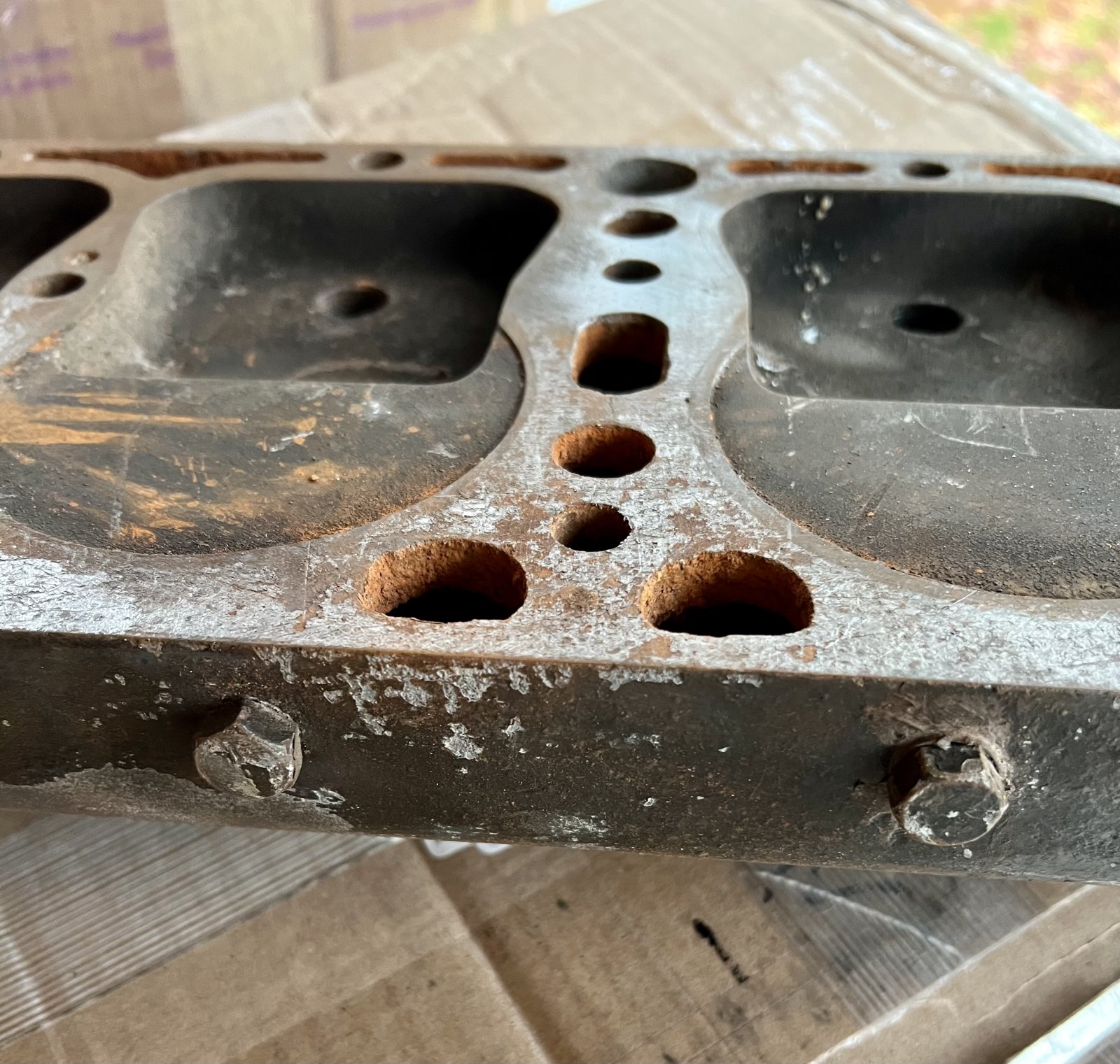

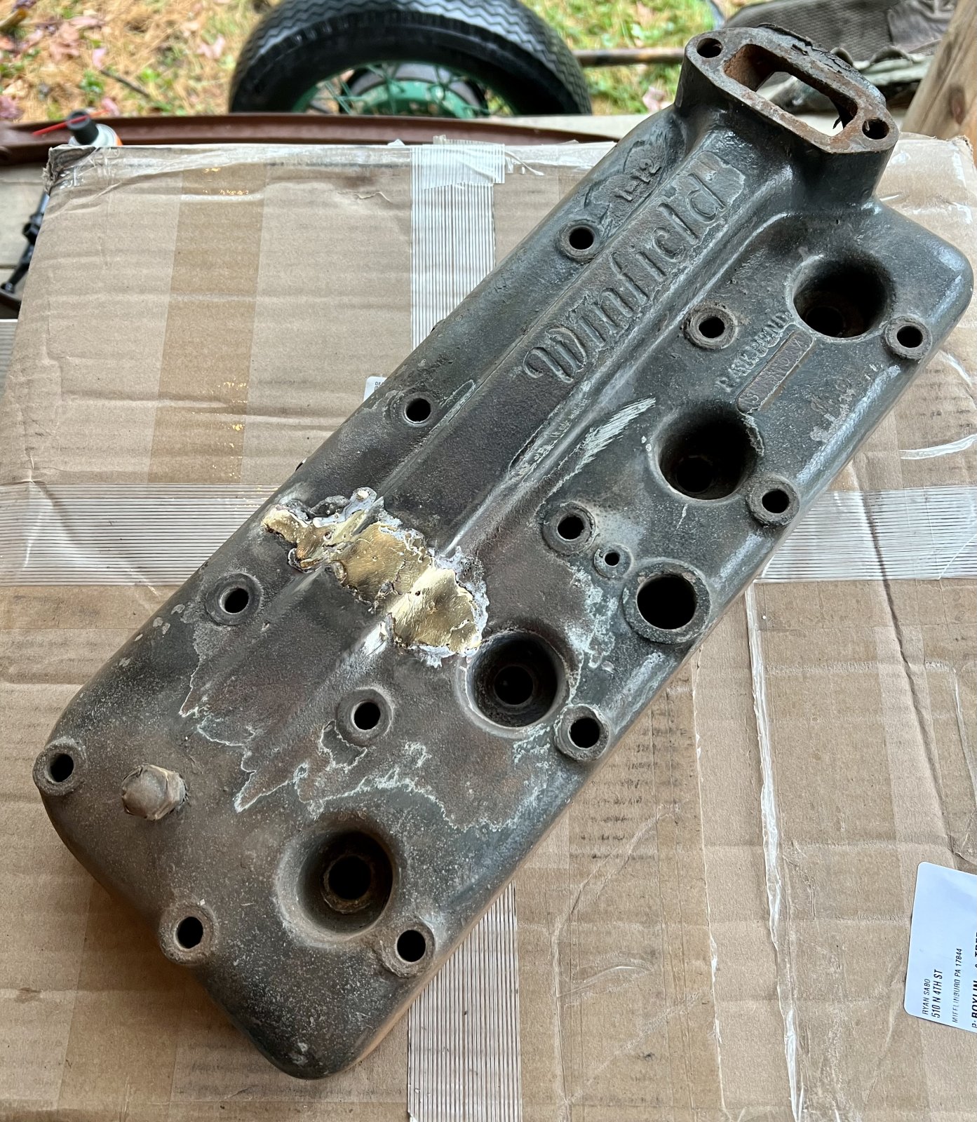

    Looks to be 6-1. Let's see the other side.

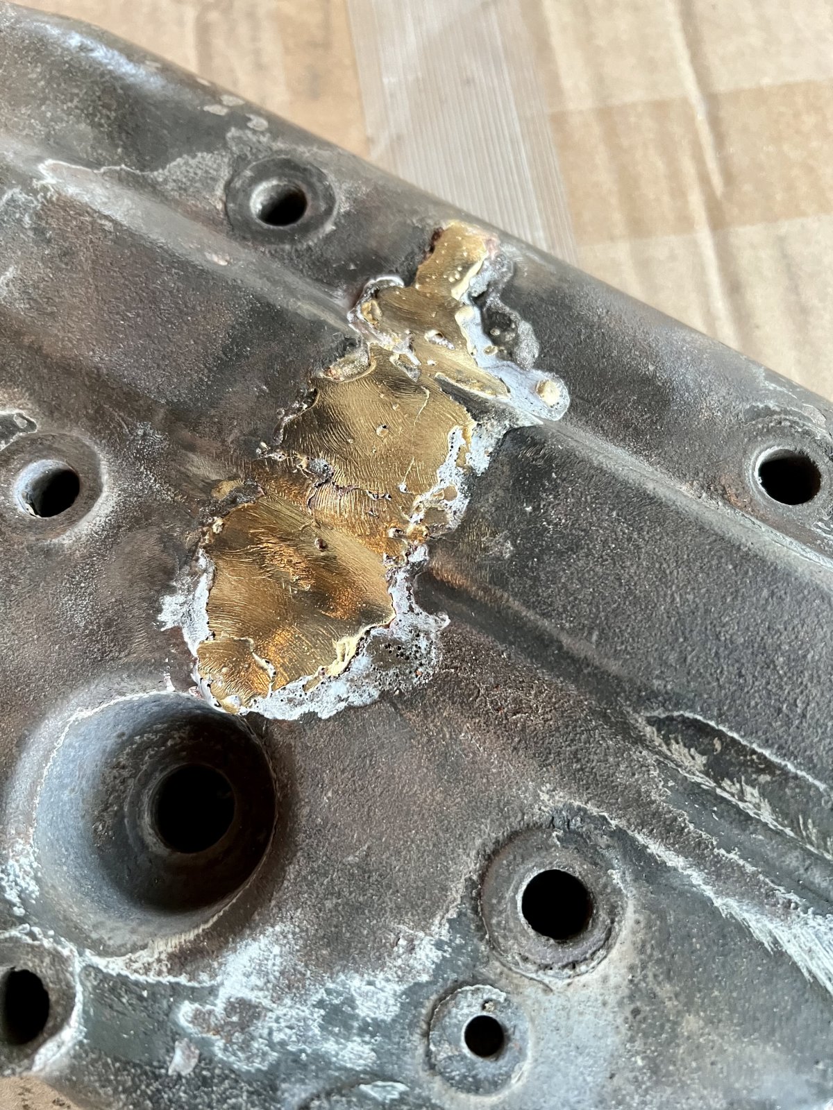

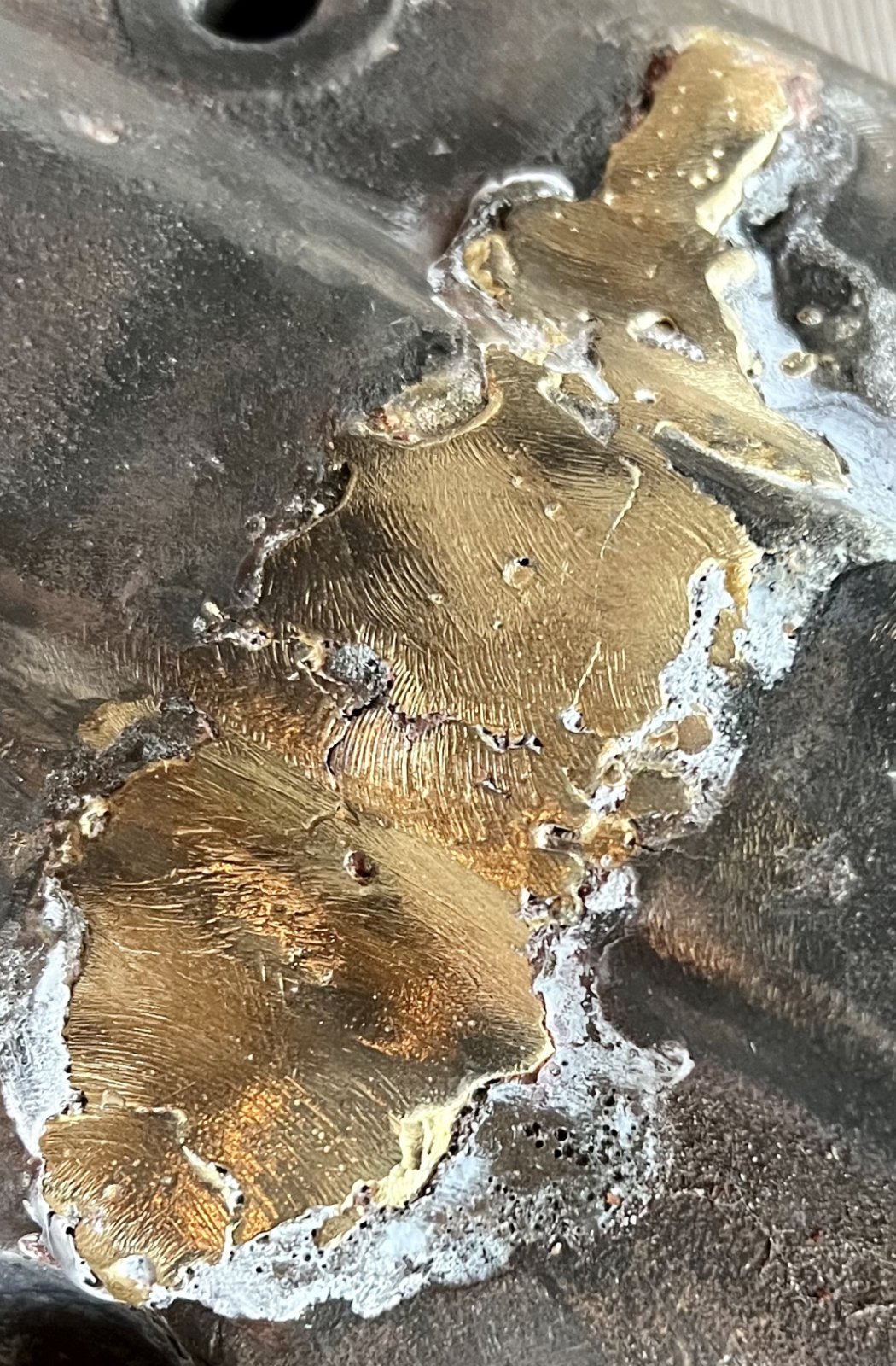

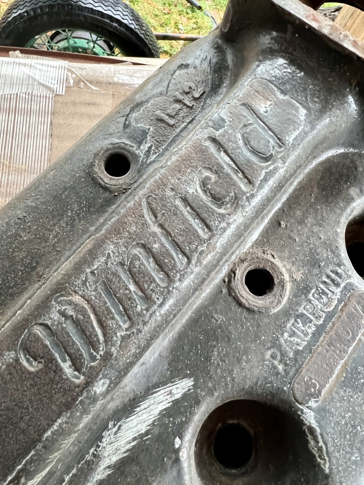

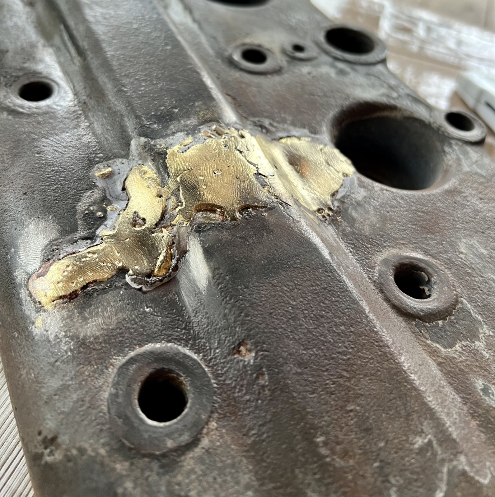

    I’m still learning, but what I can gather from talking with friends… Early chamber, 6:1. Looks to be 507 for a serial number. Has one water tap on top and two on the side. And… you know… that big ol’ braze. But we’re going to be ok. Everyone say it: “We’re going to be OK!”
    $250 shipped.

    If anything, that big old blob adds to the "pre war" authenticity

    $250? Heck, I would have taken a chance for $250. An original Winfield 6:1 is a good as it gets for a Model A, unless you're prepared to delve into the expensive and fussy world of overheads. That's my opinion, at any rate.

    It will run, will it still leak is the question. The one in my avatar cracked in the same spot. Never did anything to it and if sealed itself. If it was mine I'd leave it alone and see what happens.

    At $250 shipped it was considerably cheaper than a new Snyder’s head. And, you know… a period Winfield. The repair falls under the “just add more br***” school of thought. The water taps are curious…
    Somehow I’ve managed to get a Winfield head and a Miller intake for this banger for not much money. Model B distributor. The Marvel carbs may be a bit out of place with Ed Winfield and Harry Miller, but that’s the plan for now.
    Better view of the braze.

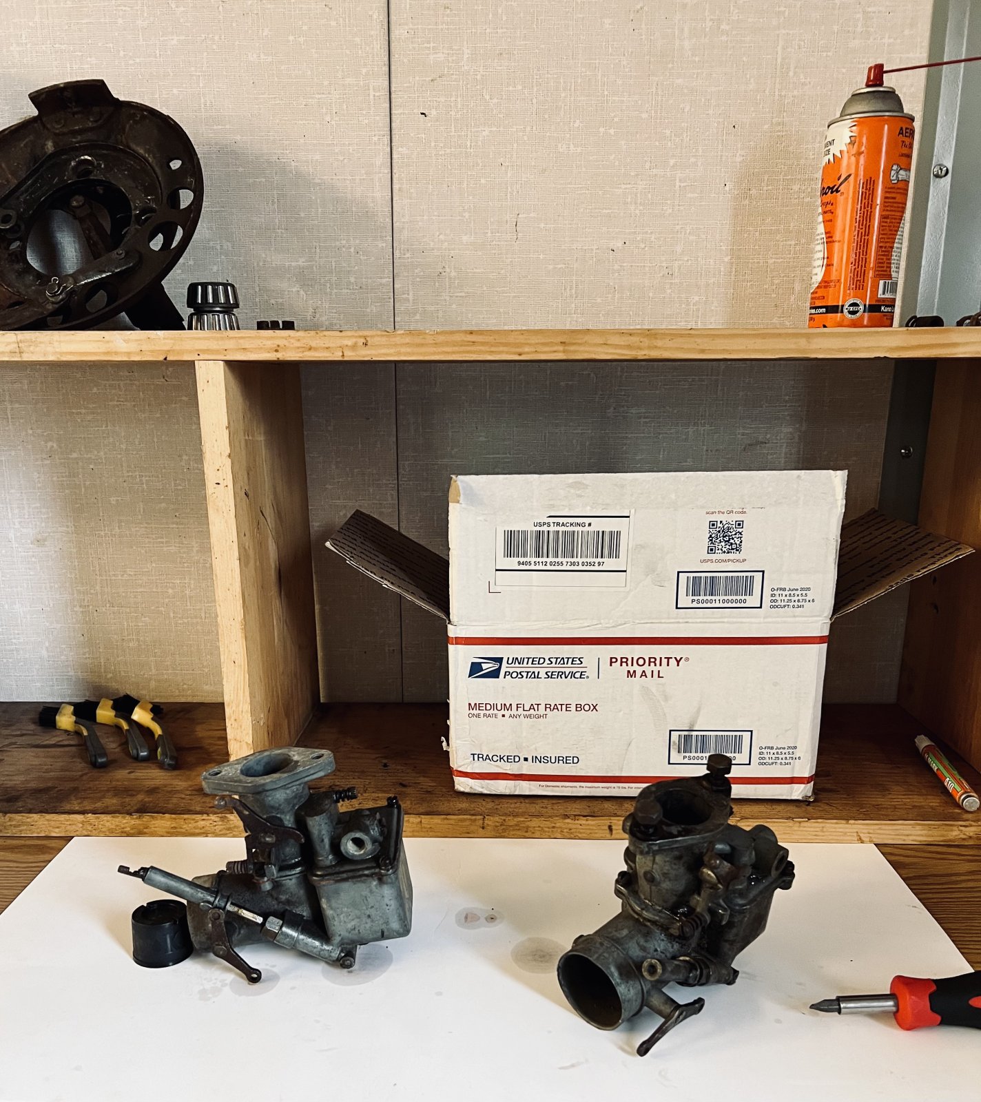

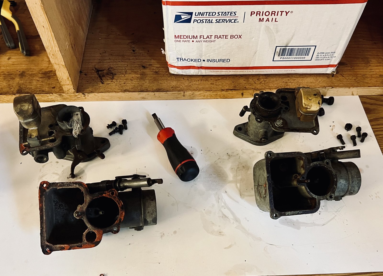

    My office at work has transitioned to a carburetor shop.

    Soooo, what you're saying/suggesting is, that you're now producing "useful" work? ??? :D .
    Use what you can, when you can...

    Well… these are Marvels. So depending on who you ask, it may or may not be useful. Ha. We’re making the best of our time, anyway. Also getting small steps done on the front end build.
