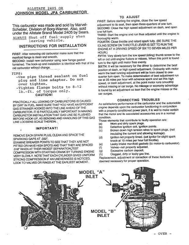

    For anyone interested, there's a pretty amazing write up on the dis***embly of these carbs over on Ford Barn. The author calls it a 'disection' and that's a good description. It'll give you a good look at how these simple carbs are set up. I actually think a pair of these are going to go pretty good on this motor.
    Marvel Carburetor Disection
    brEad likes this.
  3. Forgive me- which Marvel carbs are those???
  4. RyanAK
    Joined: Sep 7, 2019
    Posts: 719
    RyanAK
    Hey, Mac. These are Marvel-Schebler carbs that were sold as replacements for Model A and B Fords after Ford stopped stocking the Zeniths. This was also available at various parts stores, including Sears where it was known as the Allstate Model 2405.

    Renner's Corner has rebuild kits and gaskets for these carbs, along with some good information. Together with the 'disection' posted on Ford Barn, there's plenty of support to run these. The guys that like them, really like them. 9D1738EE-08AC-4D53-B495-F1BA90FF401D.jpeg
    The guys that don't see them as another pot metal discount replacement carb with all the issues inherent with that category.

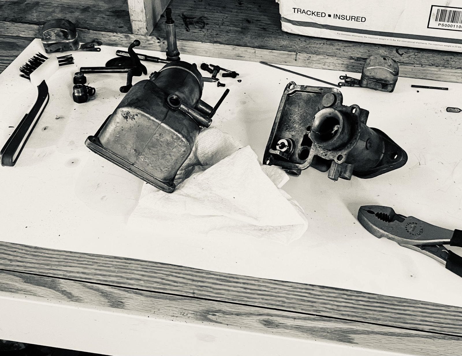

  8. RyanAK
    Joined: Sep 7, 2019
    Posts: 719
    RyanAK
    Real-time updates. I’m currently on a conference call.
    I think I need an ultrasonic cleaner. And courage to get the seat and jet out of these… :oops:

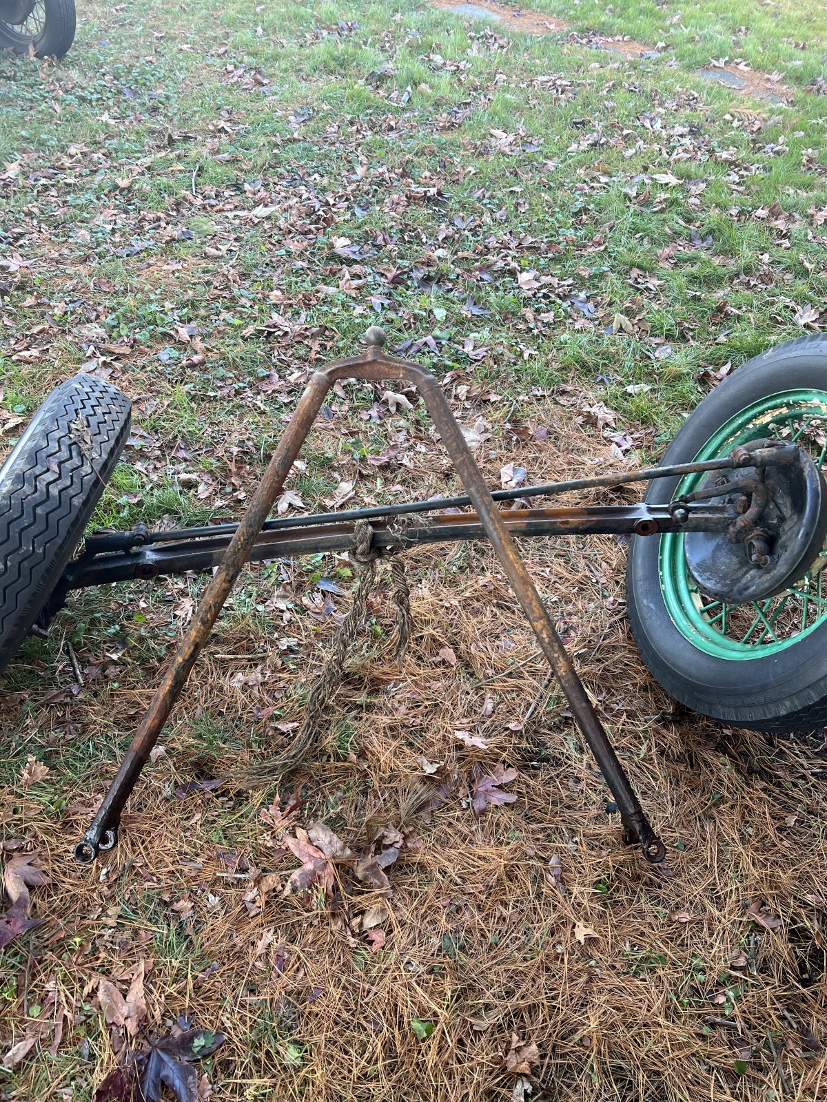

  19. RyanAK
    Joined: Sep 7, 2019
    Posts: 719
    RyanAK

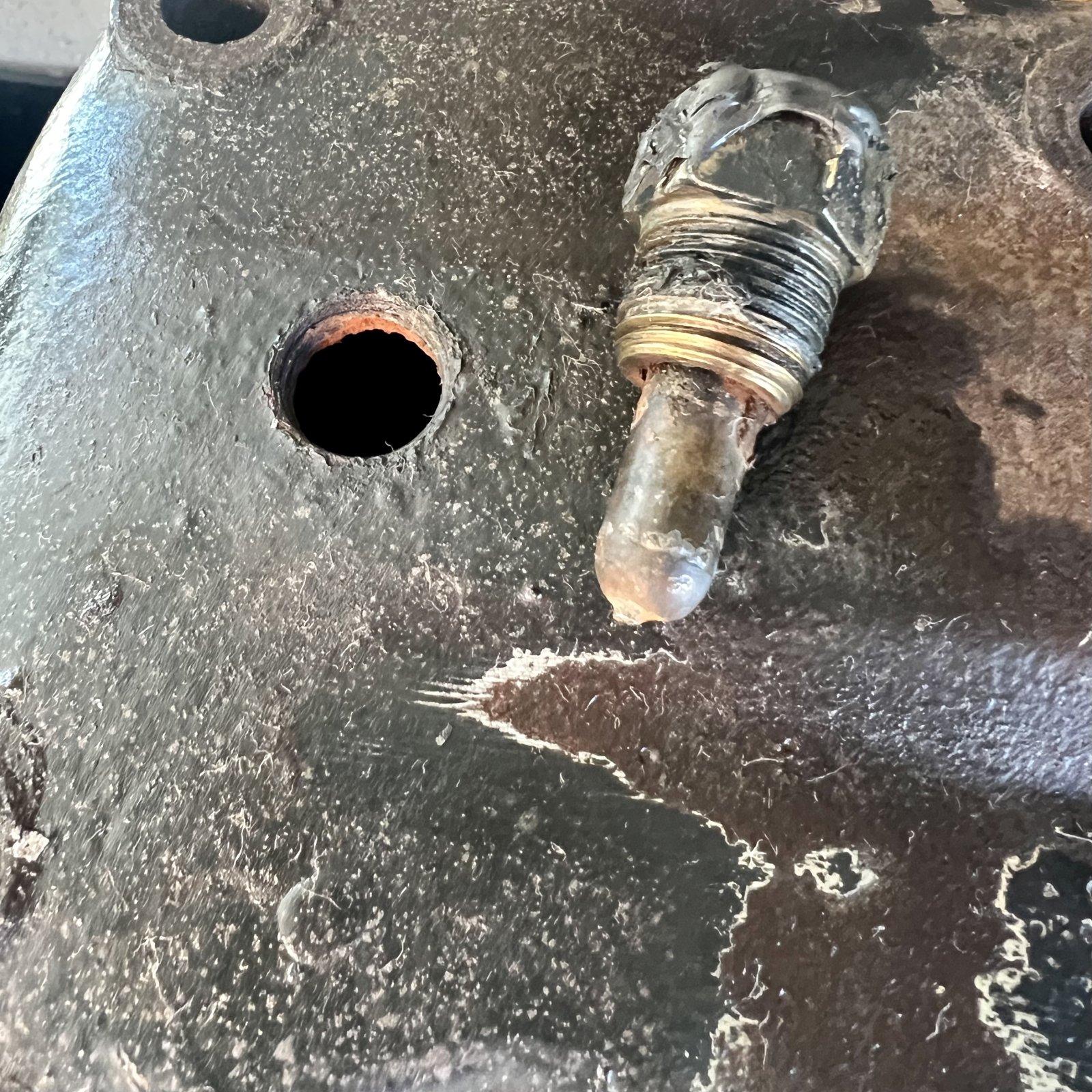

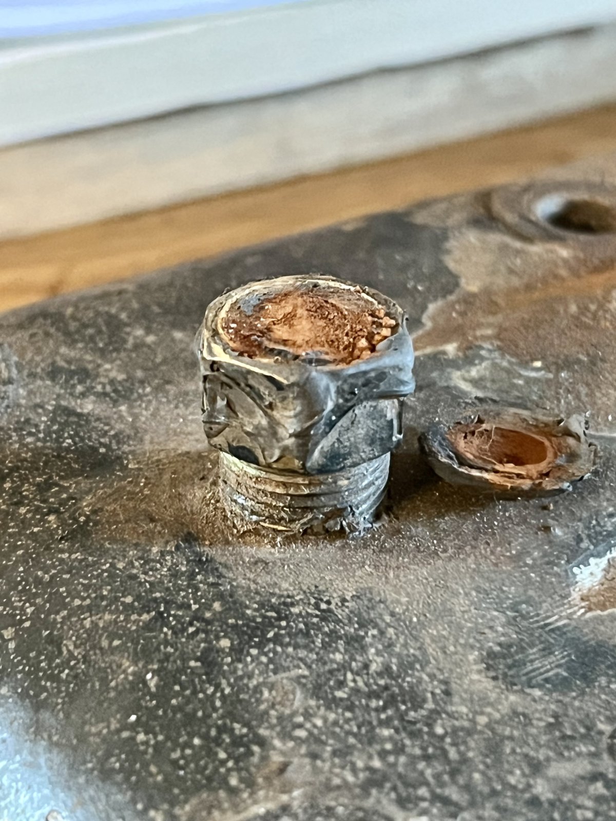

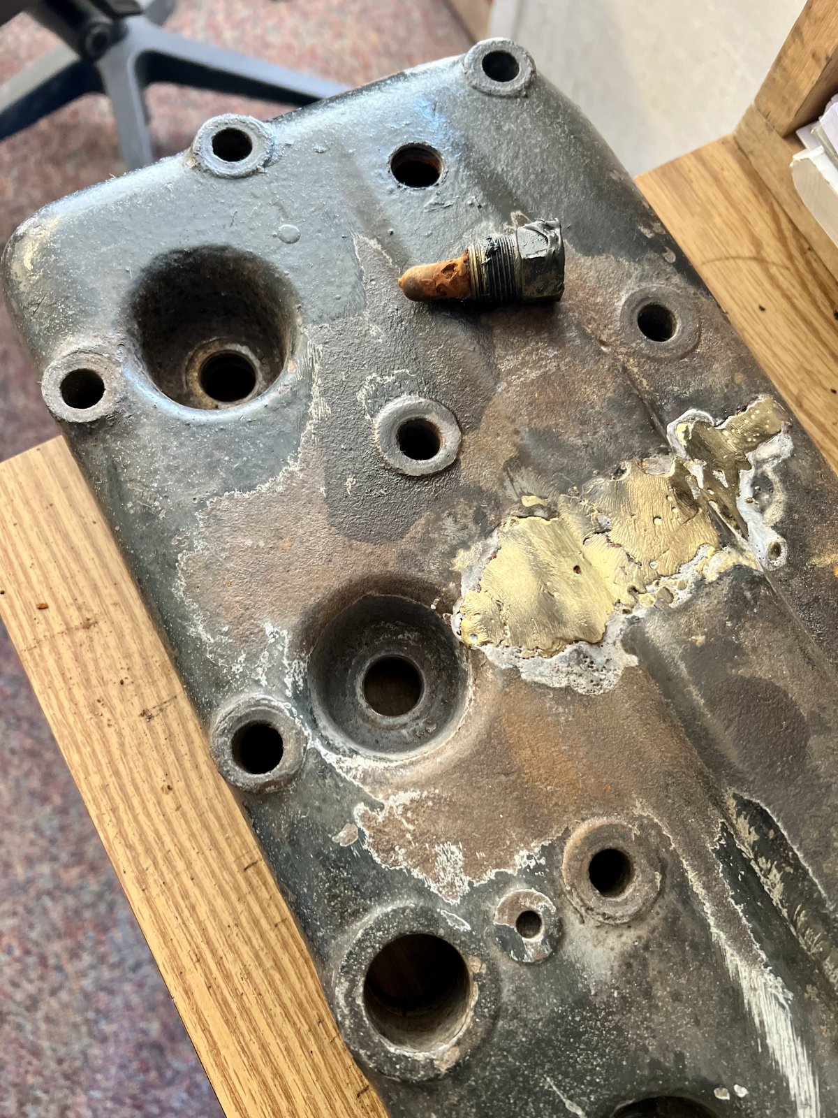

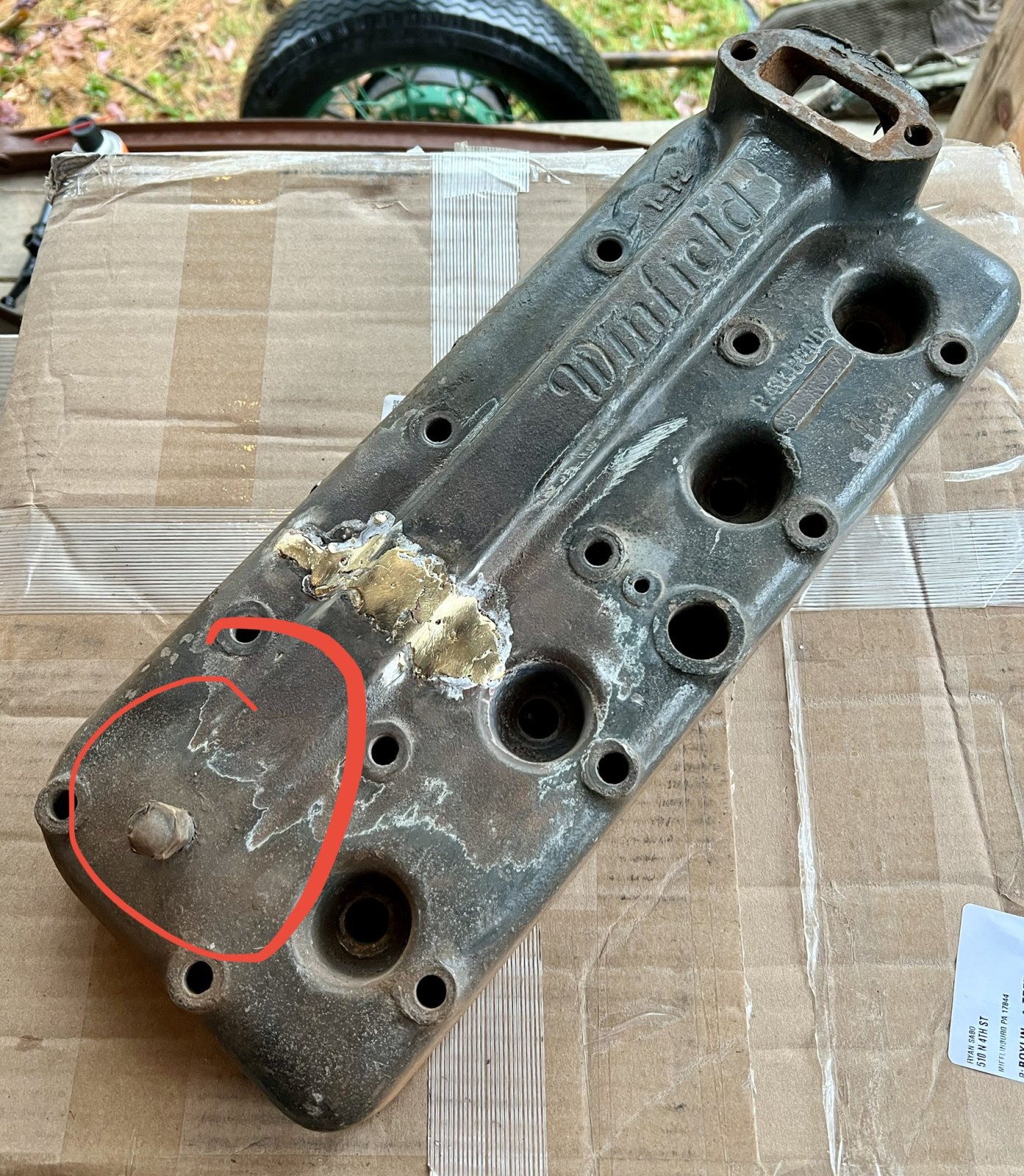

    Well the mystery of “what?” may be solved. That leaves “why?”.
  20. RyanAK
    Joined: Sep 7, 2019
    Posts: 719
    RyanAK
    Pietenpol was my thought, initially. What I thought was a threaded ****** and cap at the rear of the water p***age actually turned out to be some sort of thermocouple. There are another two taps in the jacket on the non-valve side of the head as well. I love stuff like this. If this head could only talk!
    Okie Pete and 41 GMC K-18 like this.

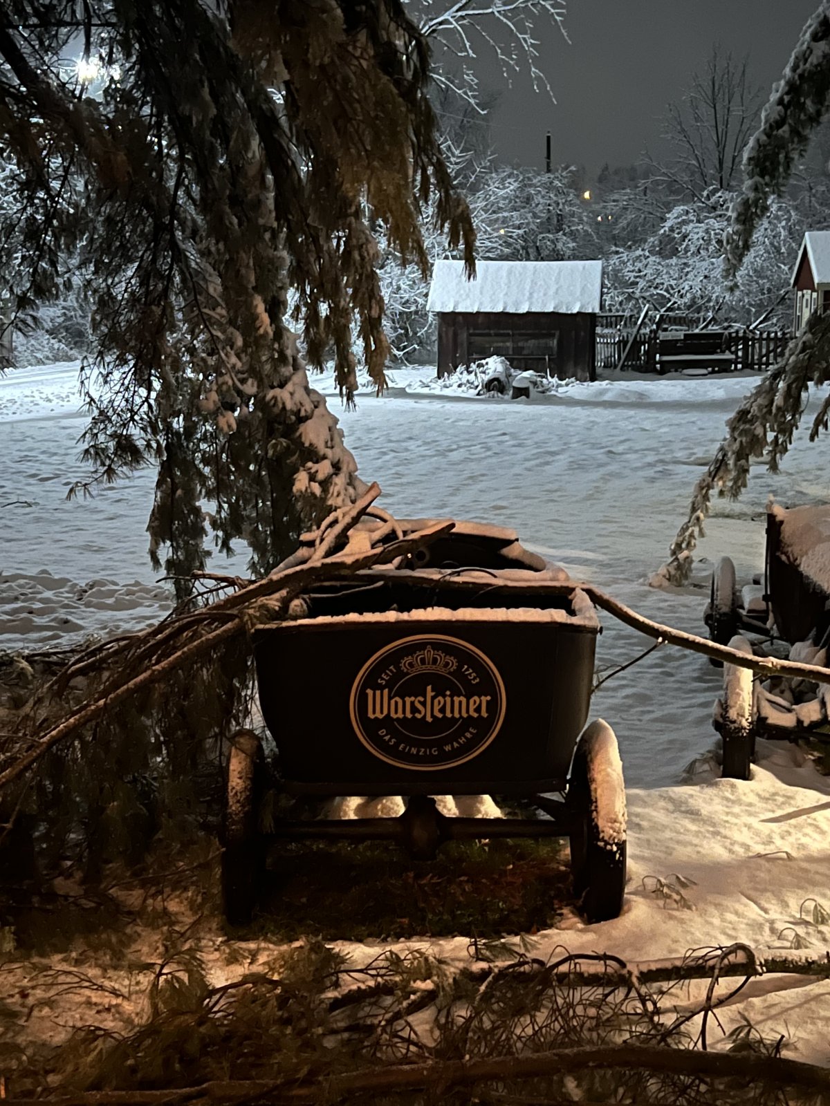

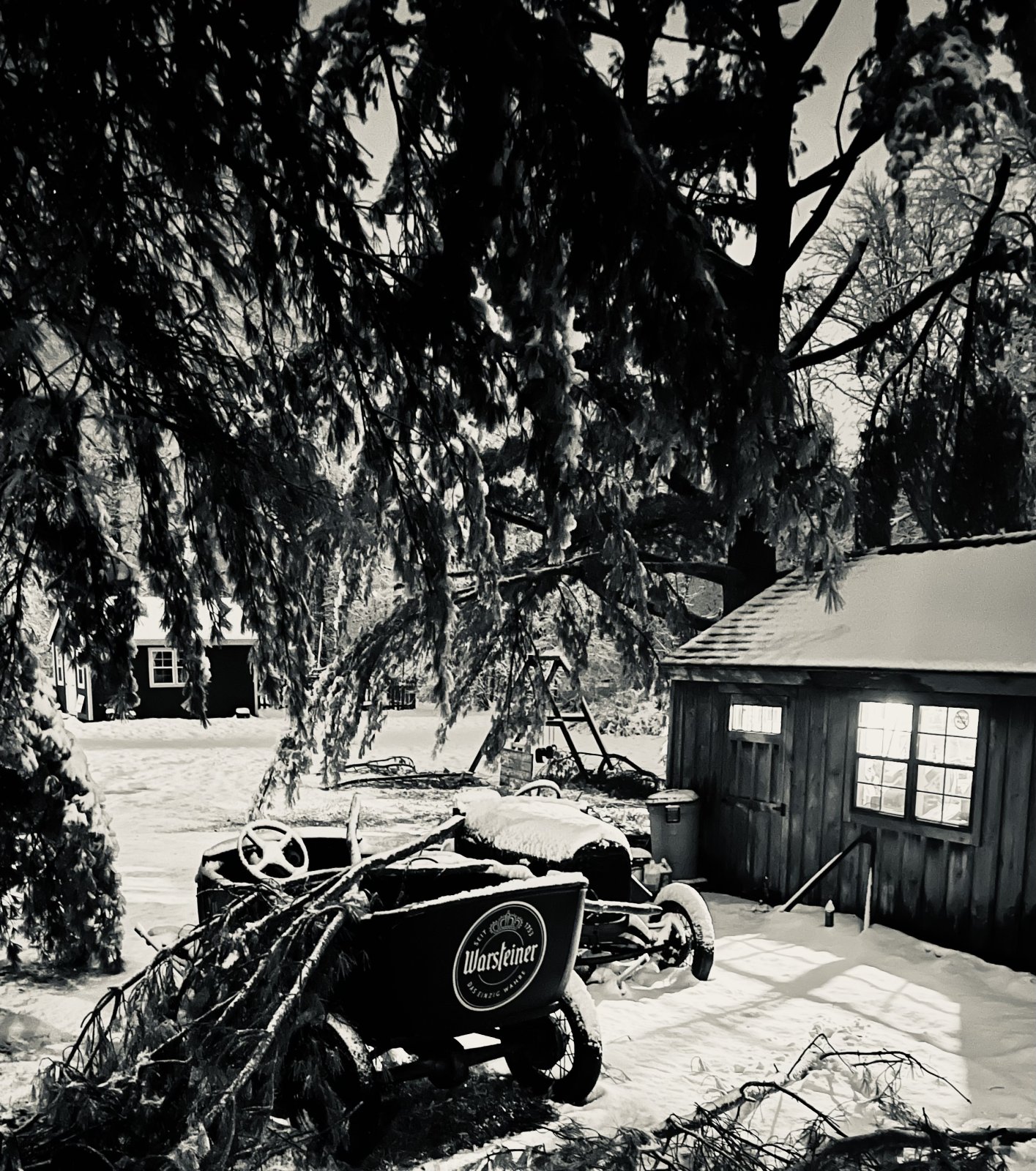

  22. RyanAK
    Joined: Sep 7, 2019
    Posts: 719
    RyanAK
    Maybe I shouldn’t be allowed to have nice things… :(
    I did check, and other than some scratches, no damage. That tree has never dropped limbs there before!
